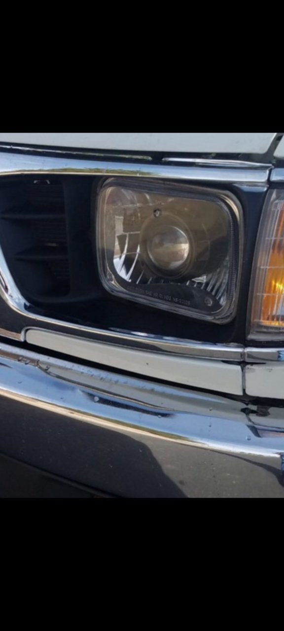

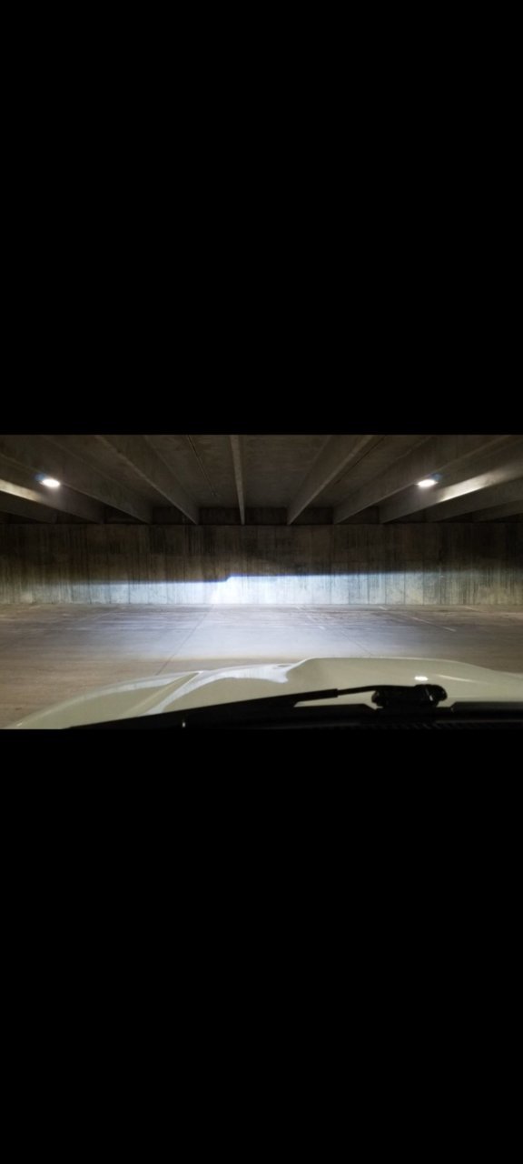

    V6 5sp,RegCab,TVS1320 Supercharger, 56mm pulley, methanol injected Haltech ECU, AC Tvs1320 supercharger,(MUST DO) every 125,000- 150,000 needs rebuild Projector headlights HID 5 speed manual Amsoil for all drive train Smaller 56mm custom pulley, (MUST DO) 2004 DESNO fuel injectors, zero ping ping, 2004 side door mirrors Dick Cepek Rims, Michelin tires LTX, ATM Pathfinders Dynopro ATM ( that last 100,000 miles) Now running Dynopro ATM mud and snow tires KN cold air intake Cat back dual exhaust with ss exhaust tip, Raised exhaust tail pipe to 2" below body line Optima*dry cell battery,red top Alpine sirius radio, 200 watt amp, focal is165 split door pod speakers Focal door speakers Subwoffer behind seat Viper alarm, Electric Locks Dark tinted windows, bucket seats corbeau lg1 Tacoma Rubber floor mats TRD fender extenders, Bilstien shocks, King shocks JBA UCA trailer iv hitch, electric brake control, Drilled slotted brakes, High carbon steel (MUST DO) EBS green stuff 7000 series pads(MUST DO) TRD engine oil cap TRD stick shift, Marlin crawl shift kit. Rear sliding window 2002 4Runner functional hood scoop cut into Tacoma hood, 4Runner dual overhead map light Gentex Auto dim + Compass + Temp, garage,rearview mirror Snow Methonal kit stage 2 Custom 3 core aluminum radiator Linex bed liner Haltech stand alone ECU, Intake supercharger gauge. Stainless steel brake lines, Custom leather wrapped steering wheel, Haltech stand-alone ECU,
    Parking lot walls work the best,
    These are retrofit projectors.
    NOT LEDS

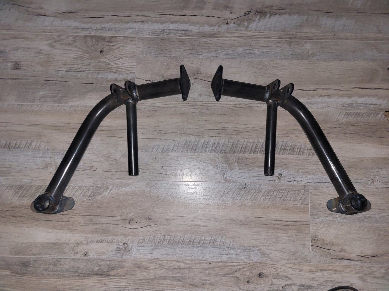

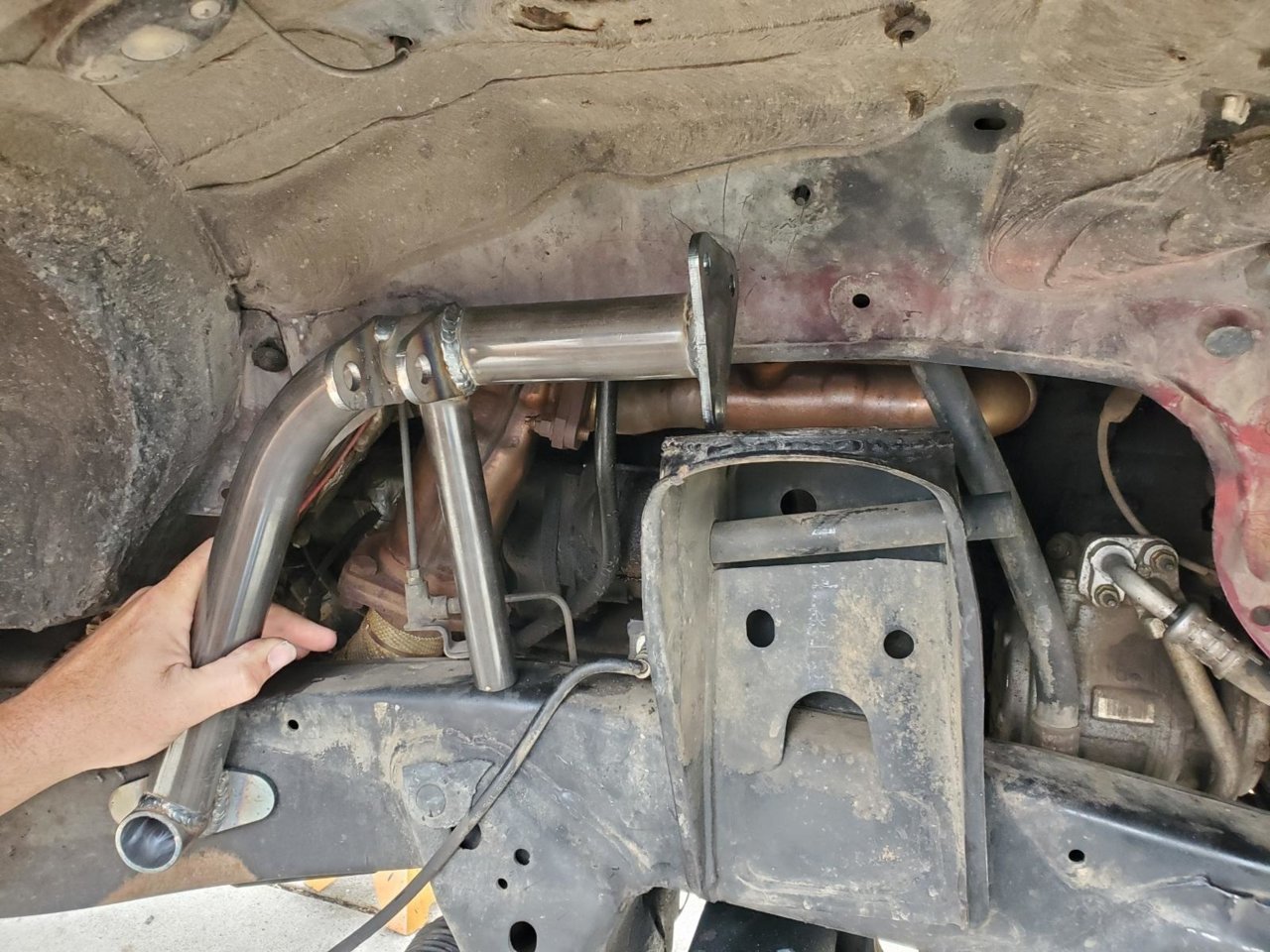

    Still gotta drill some holes to plug weld, but I should be able to start burning in some stuff tomorrow.
    Reh5108, erice, vtroot and 4 others like this.
  11. Dec 17, 2022 at 7:49 PM
    El Taco Diablo
    El Taco Diablo Professional Pinstriper
    Nov 6, 2017
    #235223
    13,979
    Matt - KN6DZP
    Hughson, CA
    Impulse Red DC, 5vz-fe, 4wd swap, LT, dual case, F/R locked
    Just 3 tons of fun!!!

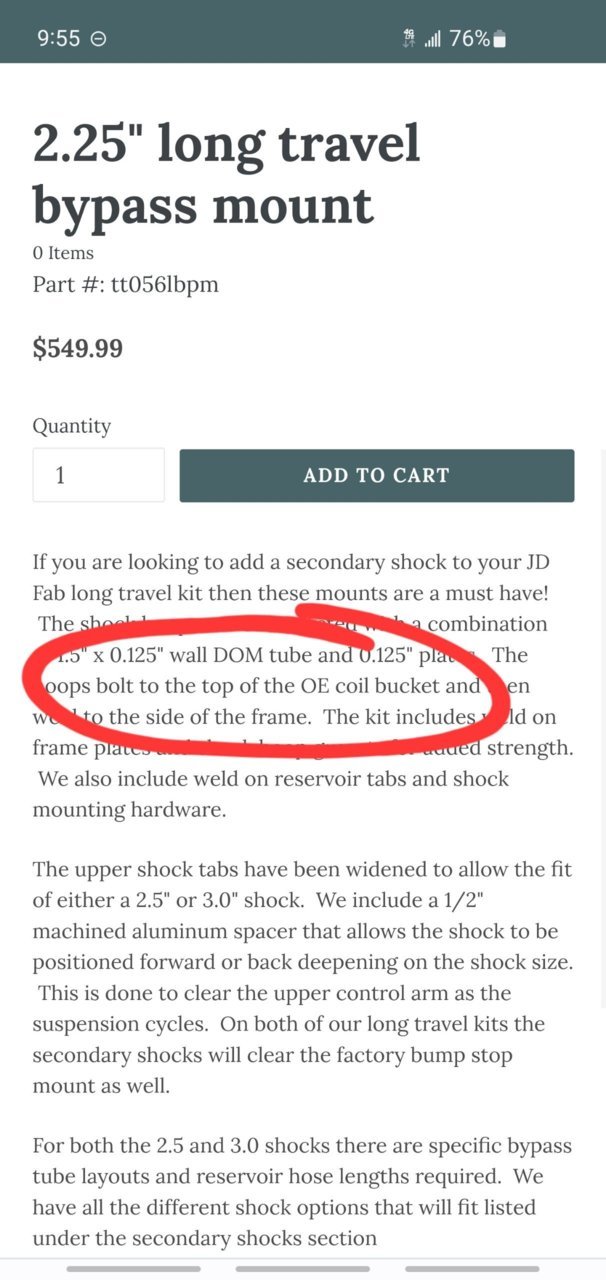

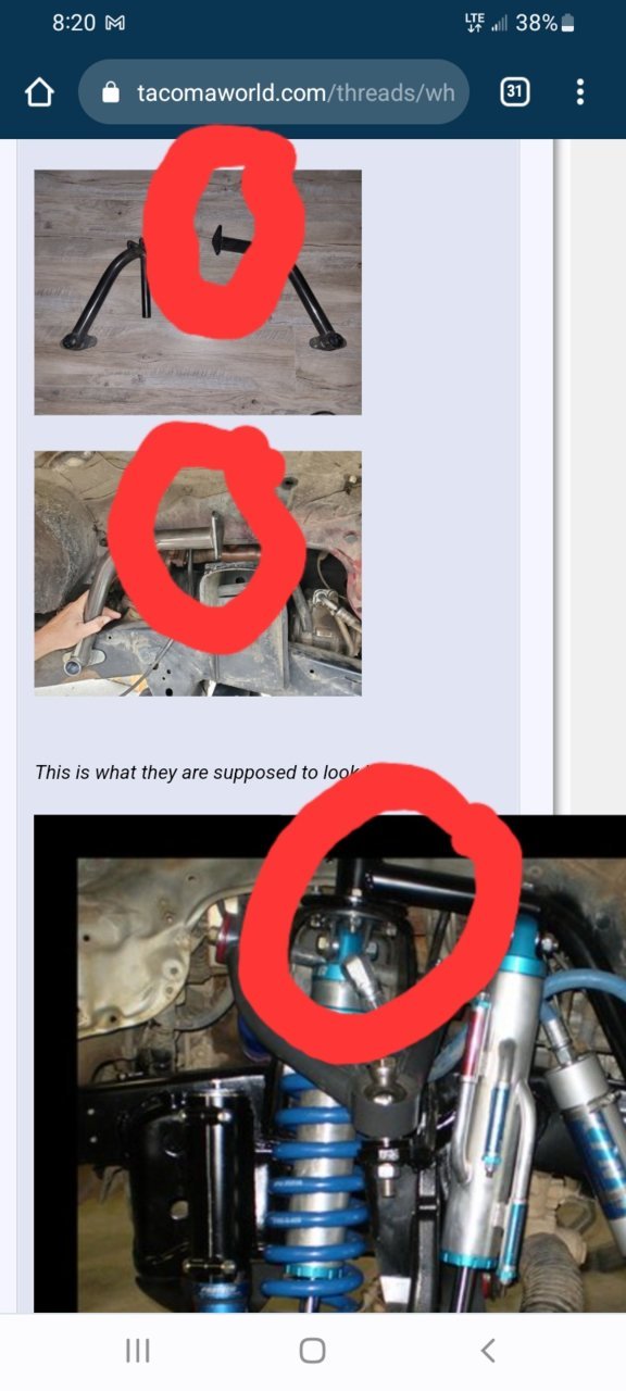

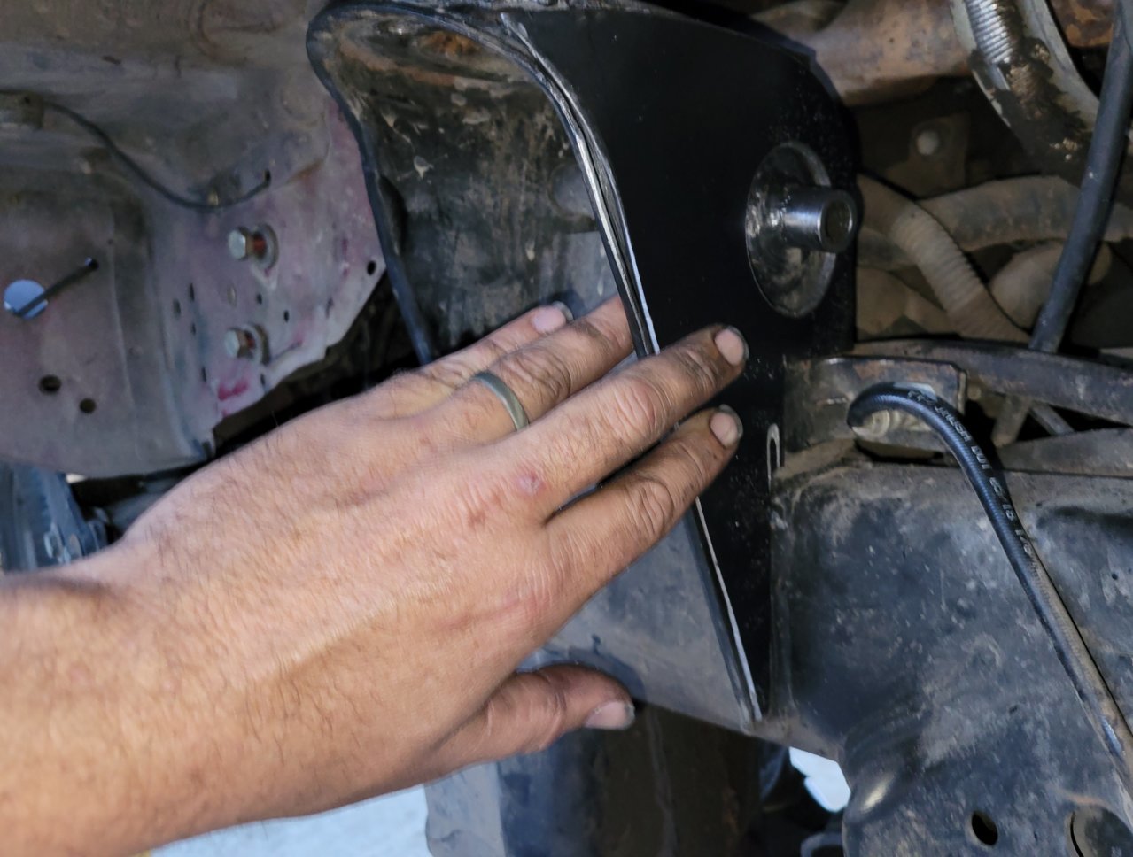

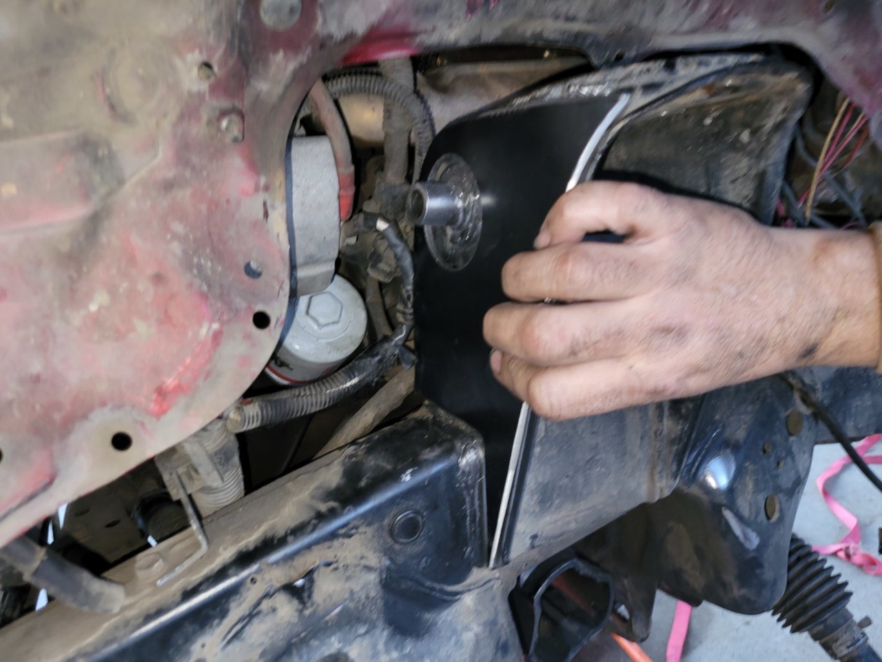

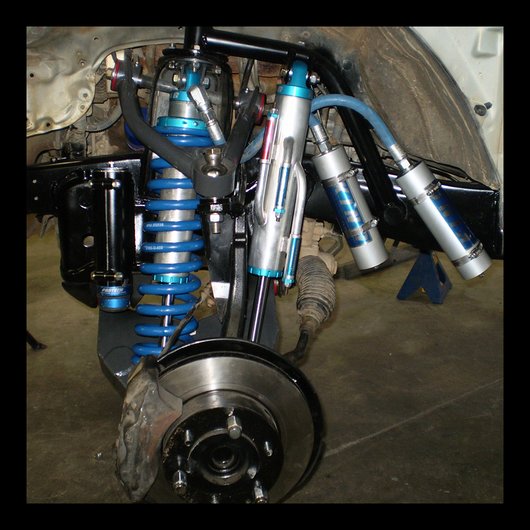

    Anyone have any ideas here?
    This is what they are supposed to look like.
    Anyone have a clue what I'm missing here?
    The pic (with the Kings) is JD Fab web page.
    The 2 pics above that are what I got from JD Fab.
    vtroot and Twolines like this.

  13. Dec 17, 2022 at 9:13 PM
    CrippledOldMan
    CrippledOldMan Well-Known Member
    Jan 25, 2019
    #280651
    2,566
    David
    Salisbury North Carolina
    2003 TRD Crew Cab
    None
    in the pic with the shocks installed, it looks like the top plate is horizontal, and the pic of the parts you show are vertical. Unless I'm blind and can't see. I'm sure someone with waaayyyy more experience than myself will chime in. But your parts don't look right when compared with the installed shocks photo.
    Yetimetchkangmi and Kwikvette like this.
  14. Dec 17, 2022 at 9:19 PM

    Theres no perpendicular tube where the triangular plate meets the spring pocket...it should be attached to that and facing down.

    Ya, I'm wondering if someone else has these hoops that can tell me if there was a design change and I'm missing something (in which case I can fabricate it) or, if this is just the completely wrong hoops.

    Look at the pics again, id say somebody was smokin too many doobies the day they made those hoops and took those pics. Theres a whole piece missing in the top 2 pics. Not trying to be rude.
    Edit- i see now the top 2 pics are ur pics of what they sent u. Either way there is a piece missing between horizontal tube and the plate.
    Yetimetchkangmi likes this.
  18. Dec 17, 2022 at 9:50 PM
    Twolines
    Twolines Well-Known Member
    Dec 10, 2022
    #412691
    359
    03 double cab
    2.5" lift, all new chinese light plastics, led lights here and there... want to make a daily "overlander" modeled after "overland under budget"..
    My guess is unless somebody screwed up those could be for another model where it mounts to the side of the pocket?
  19. Dec 18, 2022 at 12:13 AM
