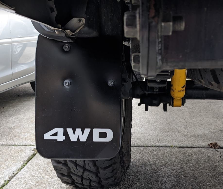

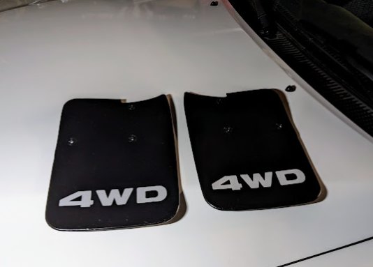

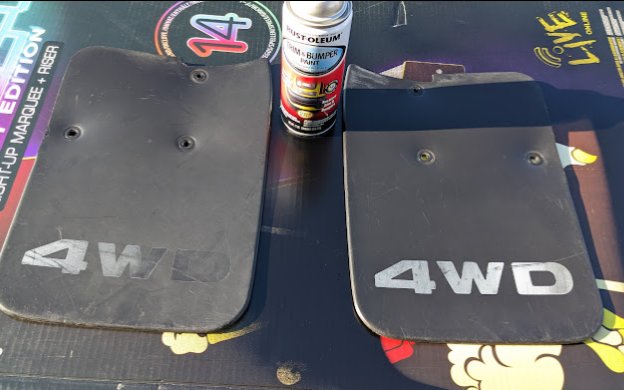

    Awesome. Yeah I definitely like the idea of vinyl. Reflective and easily replaced if needed.
    Before this little project, I did find a single seller on ebay claiming to have the original 4WD mudflap part numbers in stock, not the current iteration which is blank. Seller is 'partscontainer'. I did place an order but they play games with holding shipment and cash while claiming to have shipped and blame the carrier. Thankfully eBay stepped in and refunded my purchase price in full. Anyone looking at their auction listing, stay away.

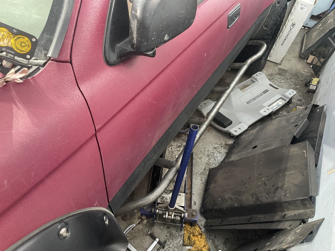

    I don't know why but all I'm seeing is this in that 2nd pic... lol

    Ya, I spaced it out about 1/16th wider than the combination of misalignment spacers I'm going to need to use on the heims. Figure when I tighten it up, it'll squish it to where it needs to be.

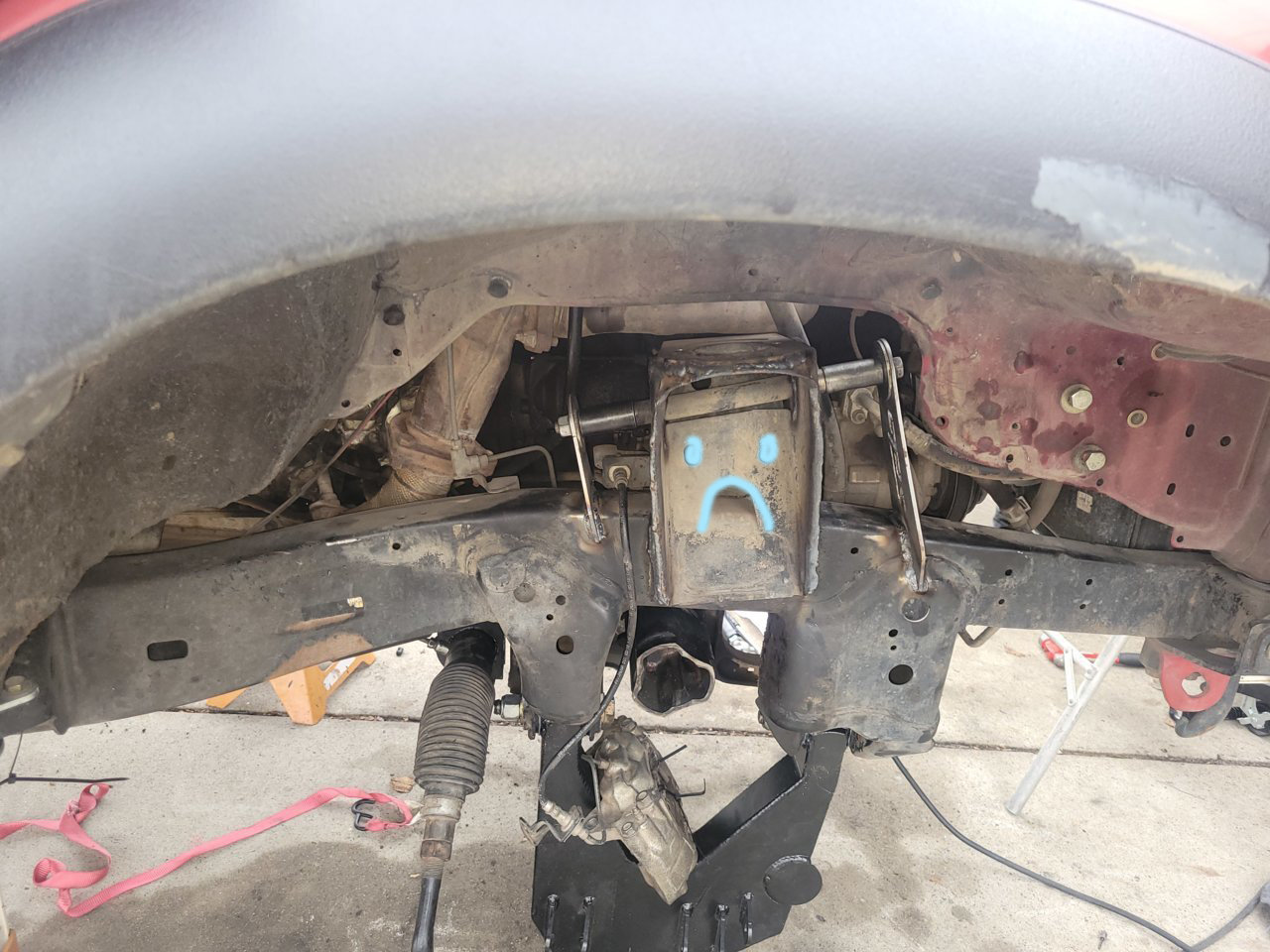

    Looks like the kit you got is for an aftermarket coil bucket for a 10" shock likely.
    And I would be worried about that tall hat you out on there as it's an increase of leverage on the stock cool bucket. But send it.

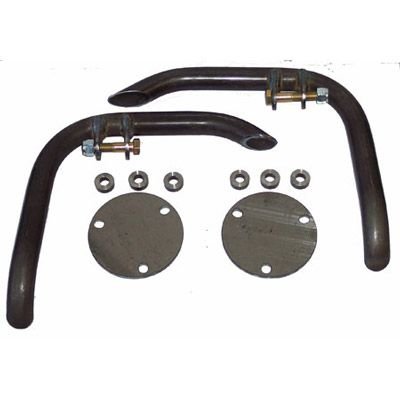

    It's actually, apperantly, made for an extended coil bucket but for an 8 inch shock still. He said his coil bucket is raised up so you can pre load more without coil bind.
    The attachment on top of the coil bucket is pretty much the same attachment as JD Fab used to do, and Total Chaos still does (except this hoop has another attachment to the frame)

    How so though? I always felt like a solution like this would prevent coil bucket failures we have seen far more than reinforcing the bucket itself. You now have another point of rigidity that would have the effects of something like a crossover, but with much less interference IMO. But I'm no engineer.
    Did you basically just modify what you had? I had no idea someone had a prefabbed solution similar to TC.

    (The benefit of this design over Total Chaos is as far as I know TC does not have the second leg that attaches to the frame... the one that comes down right near the upper bypass shock mount)
    Yes, I modified the JD Fab version https://jdfabrication.com/collectio...ta-tacoma-95-to-04-weld-on-bypass-shock-mount the actual part is just no longer what is pictured (as I found out).
    Dirt King and others make various bypass hoops as well.
    I trimmed the bracket plate and then tacked it to 2.5 inch 3/16 wall DOM. The DOM was just the right size to bevel and then it nested in the OE hole on the top of the coil bucket. That way we were to use it as a kind of self centering/locating piece. Once the hoop was tacked where we wanted it (on to that DOM piece) we full welded it on the table. That way when we went to fit it up, it went right where we wanted it.
    The DOM piece on top of the coil bucket is welded from the top, skipping where the three bolts are. I didn't want the bead to interfere with the top plate bolts. But it is full welded around the inside of the OE hole in the top plate (under side of the top plate).
    There is also a top plate reinforcement from @eimkeith in there (that was done last year). We also fully reinforced the sides of the coil bucket with 3/16 plate.
    As far as the fit of a future bypass shock. The distance we have between the closest (to the coil bucket) bypass tab to the coil bucket it's self is just about 1/8 to 1/4 more than @Robmonster117 has on his, with bypasses installed. So I know I'll have room for them. (Thank you for the measurement Rob BTW)

    :thumbsup: Yeah I like that additional leg going to the frame for sure. I am also running Keith's top plate gusset too, so might go with this route too. You need to get to the back side of the top can in the bay? I remember welding Keith's support was a bitch to get into as it was. But you are rocking the BL now too right? I am sure that's helping too.

    We were able to get the VAST majority of it done without having to come from the engine bay side. But there is a little bit like 1.5 inch weld on each side, that we did come from the back side.
    The body lift is helping out A TON with all of this. I don't think I would have wanted to do this without that extra inch of clearance. We did have to trim a little bit of the fender to clear that piece I made on the top plate. (I could have made it a bit shorter, probably 1/2 to 3/4 shorter) But I wanted to leave it taller than where what was left of the bracket came in to meet it, so we could get a fat weld on it.
