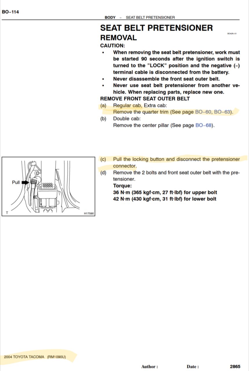

    I can't wait to get the new seatbelt in the mail and find out once and for sure.

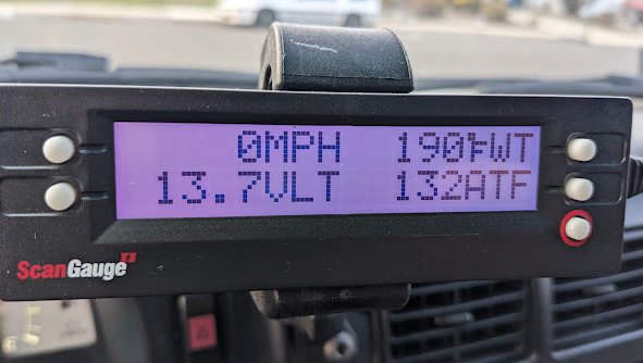

    So we're currently having temps in the mid 40s to mid 50s, went for a quick drive today (not even 5 miles) and couldn't get the ATF temp above 135. I'm starting to wonder if the sensor in this donor trans is bad. I recently put in an ATF cooler so not used to the temps but 135 really seems low. Going to have to keep an eye on it. The 4Runner ATF shares the same temp sensor PN# as the Tacoma so that isn't it. Odd.

    I don’t think that was enough time for the trans to fully come up to temp, especially with lower ambient temps. I would give it at least 20 minutes of driving and highway speeds before I’d expect to see it up at the 170-180 range, and maybe not even that high if you’re not putting some load on the transmission, going up hills, etc.

    Will give it another go tomorrow. Thx.

    ,my tundra takes 40 miles of heavy towing to hit 180.. most of the time 150 is the norm regardless of outside temp after driving for an hour. my dads 02 also doesnt run hot.. i think the sensors just in a odd spot in the transmission fluid circuits.
