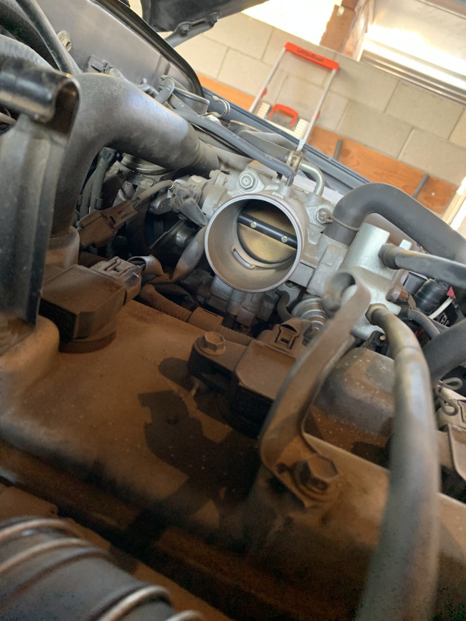

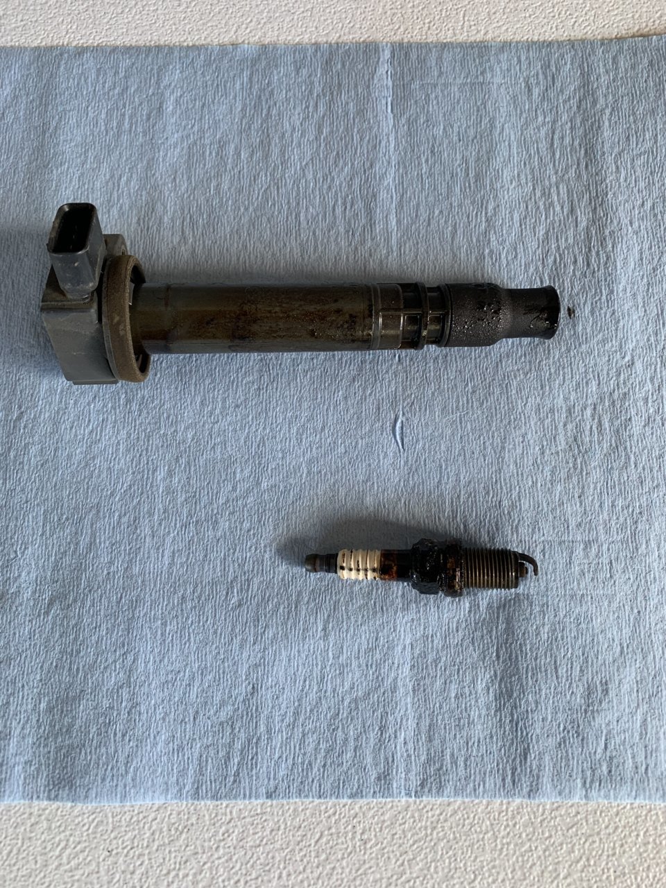

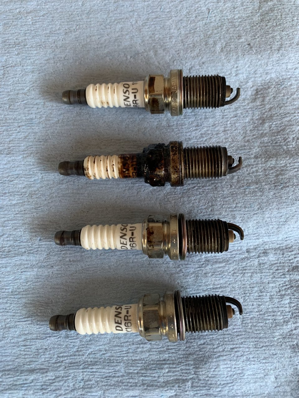

    Like some others recently I also received the p0303 check engine code. I changed the spark plugs with OEM plugs and cleaned the coil packs. I may need to change cylinder 3 ignition coil soon. The others seemed in really good shape. I don’t think my Dad ever changed these plugs since they are denso. 199k miles. Got the oil flushed and changed. Also cleaned the throttle body while I had the plenum off.

    Did the light go away? I had just changed my coil packs before the accident. I took them off and returned them so I don't know if my light would have came back.

    yes, sorry light is gone. The truck is running great now. I’m just suspicious of that dirty ignition coil. I should probably replace all of them soon.

    Looks like leaky valve cover gasket. Seems to be baked on oil

    I am also worried about that. I didn’t see a puddle of oil in any of the holes. That cylinder 3 plug was not torqued down at all. I was able to thread it out by hand. Could that loose plug have something to do with that? Or more likely it’s the valve cover gasket?

    usually loose will be more of a sooty mess. that looks like baked oil. but its a picture.. usually the smell sets the two apart

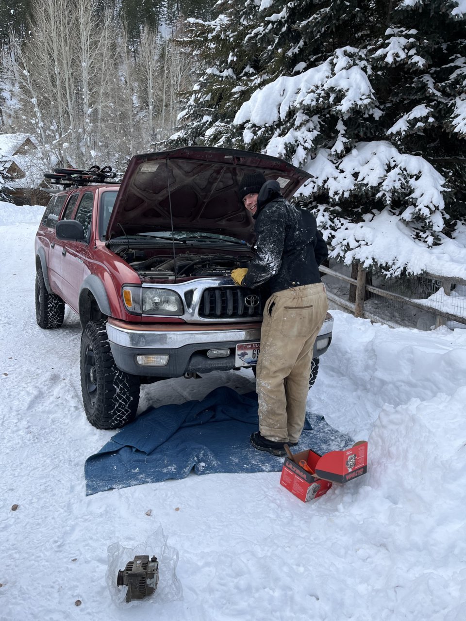

    Kid’s home for Christmas, and conveniently his alternator went out just after arrival. Replaced that in the driveway this morning. Fun to work on the 1st gen w him.

    I wish I could Like this post more than once. So many fond memories of dragging my car to my Dad’s for service. Never did hold that drop light correctly.

    It’s super awesome to share with him. He’s able to do most things solo now, so when I get to work with him it’s really cool for me.

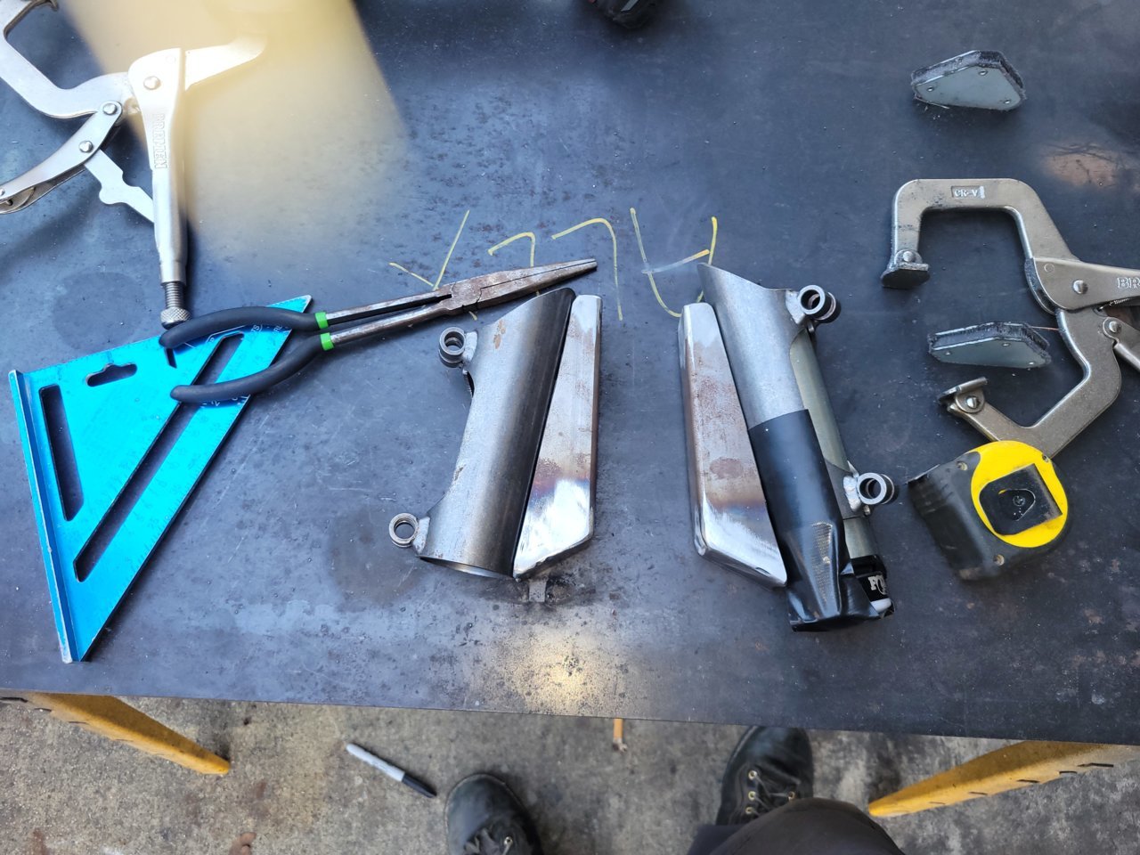

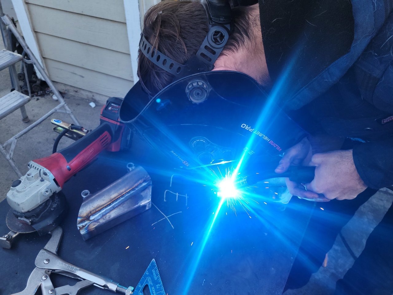

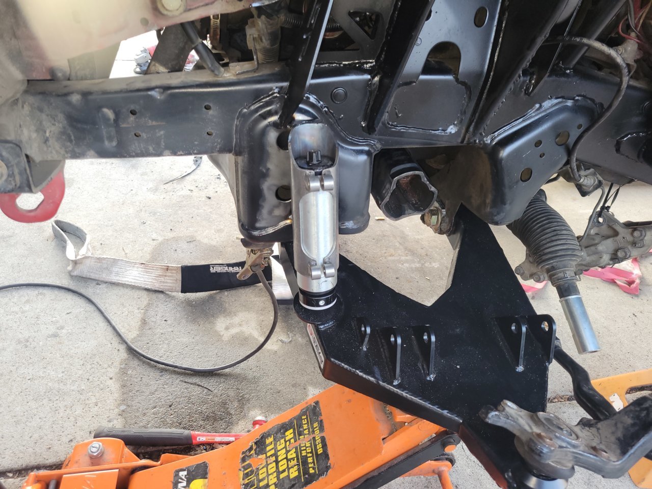

    Some stuff got done today.

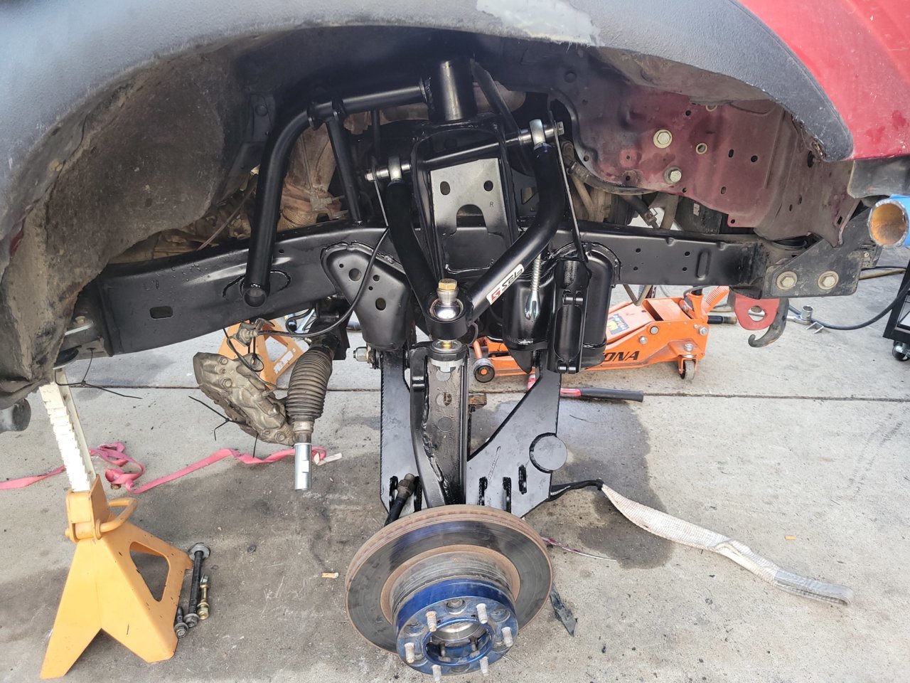

    Gotta clean up the fender flares... But I reached a milestone :thumbsup:
    Caster is set
    Toe is set
    Chamber is close, but won't know for sure until I set ride height.
    Have to clean up the fender flares for sure... but full stuff and lock to lock is clear.

    What are you looking at for travel numbers when strapped and bumper?

    Not sure yet. Waiting on the parts to build the CVs so I haven't set the limit straps yet.

    What psi is a common number to run on bump stops?
    Fox shocks are 200 psi... but I can't find where they specify a number for their bumps.

    Gotcha. I'm definitely going to interesting in travel numbers of the solo kit. I'm pushing 13 inches with my MCM kit and short body coilovers.
    I started with 225psi front the rear. Likely I'm going to drop the front down to 175psi to help get a little more compression out of the front suspension.
