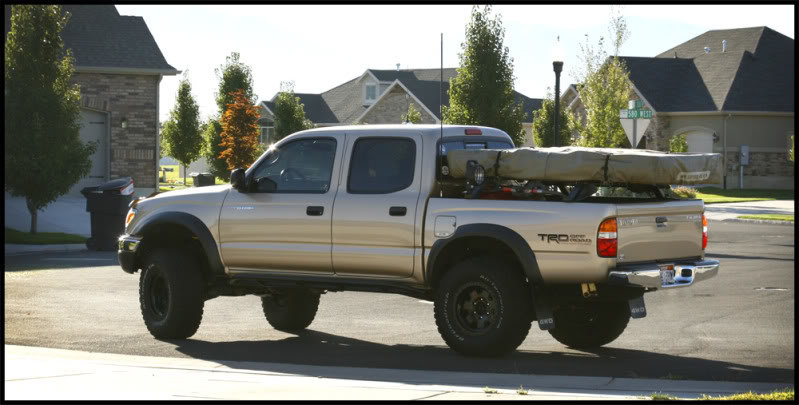

    I had the same thought you did Monte. I thought i'd be fine with just the Dakars at first until I added bumpers and other stuff.
    You can see the sag in this pic and this is before bumpers and other stuff. Granted I had my bedrack and RTT along with camping gear but it sagged pretty good. Prior to this trip it was worse, but in this pic I had added the 1.5" All Pro shackles to help keep me off the bumpstops.
    Loaded even heavier here with more gear in the bed along with the weight of the topper and pulling the trailer. This is after the AAL. Even with all the weight it still sat pretty level.
