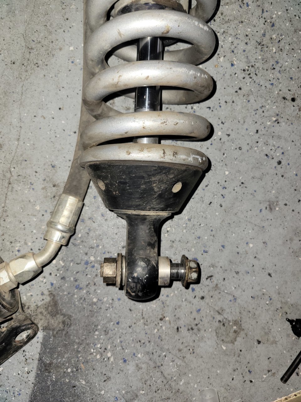

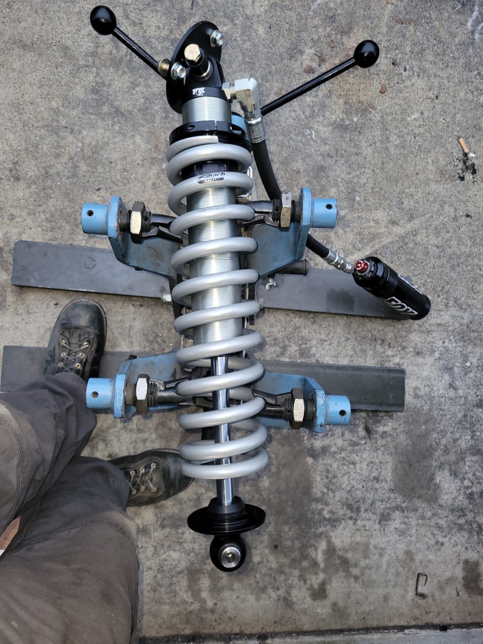

    Speaking of... what size coils are you running with 8 inch shocks? I was sent 16 inch coils, but these things are going to have my preload collars halfway down the shock.
    The coils are not compressed in the picture. I'm thinking I need 18 inch coils.

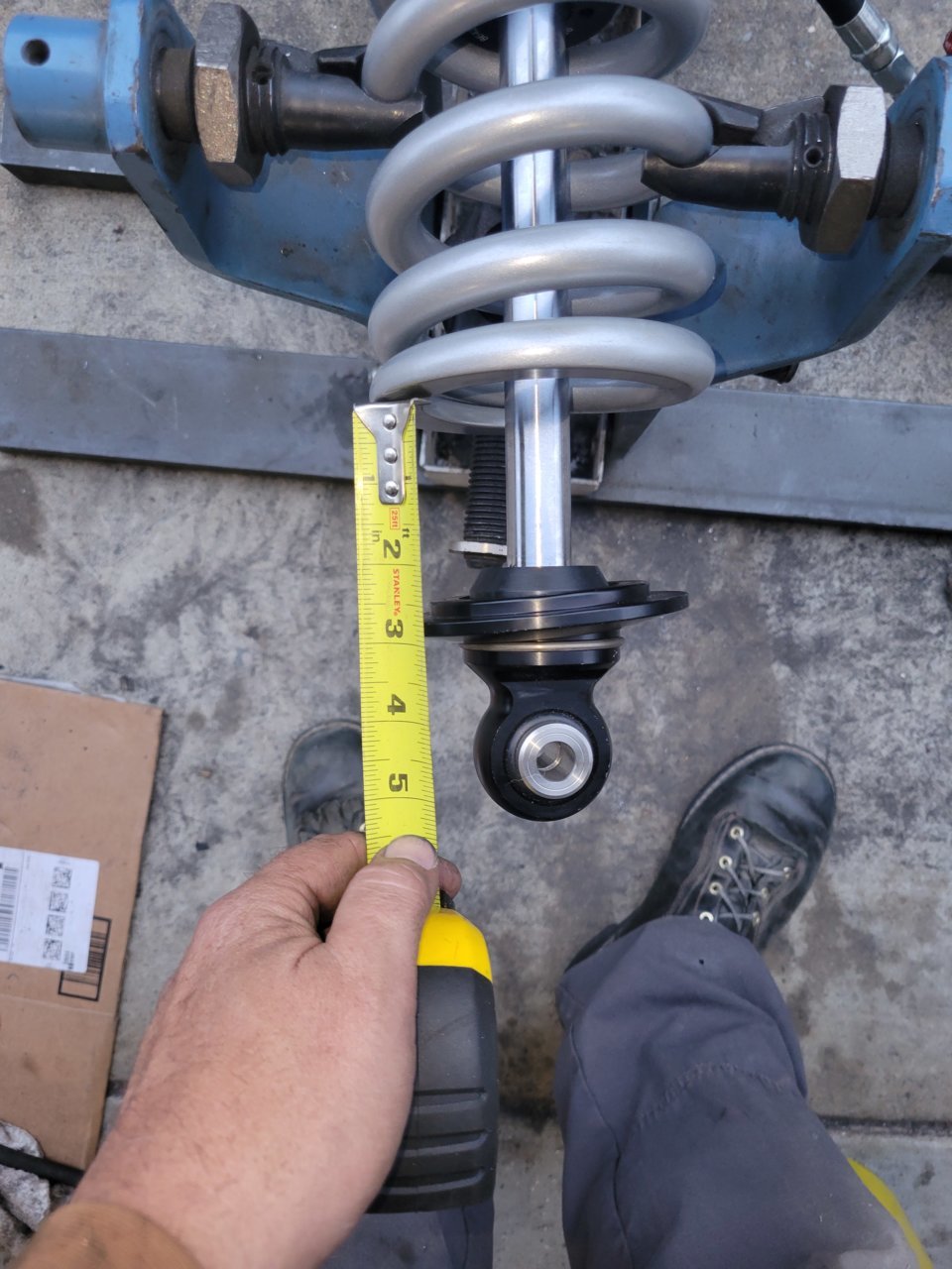

    I'm running 18" 500# springs. They have about 2 inches of preload since they're short body coilovers.
    PXL_20220501_170532316
    by Cory Bechtold, on Flickr

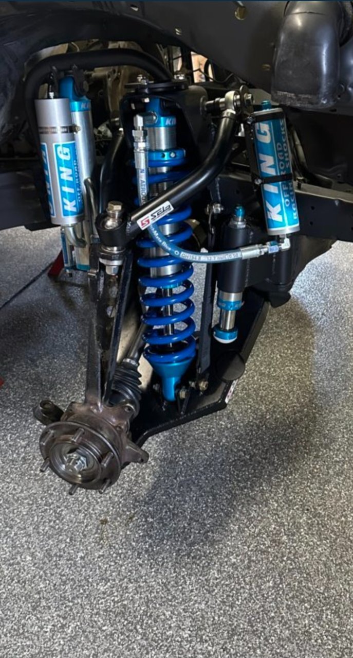

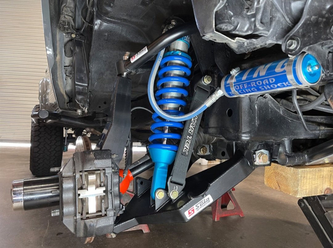

    Judging by the looks of the install on their 4runner... I'm thinking there is more than one combination that will work.
    It's running 3 or 4 inch rod ends with tall spring retainers, and no modifications to the coil bucket.

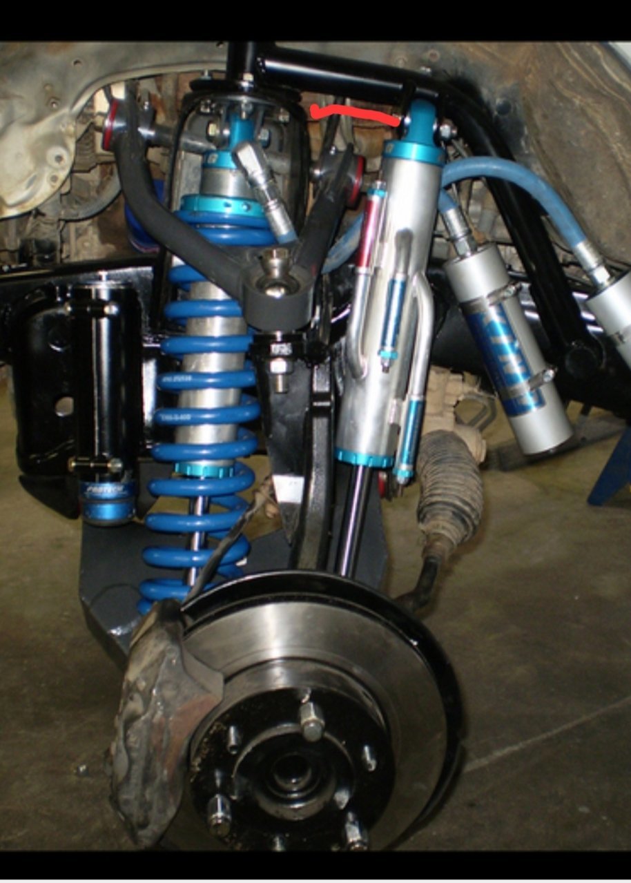

    JD Fab was using the same body length, short spring retainer, and short rod end, with what appears to be what I have here... with their 8 inch kit.
    Their kit now modifies the coil bucket. But this picture is from their old set up.
