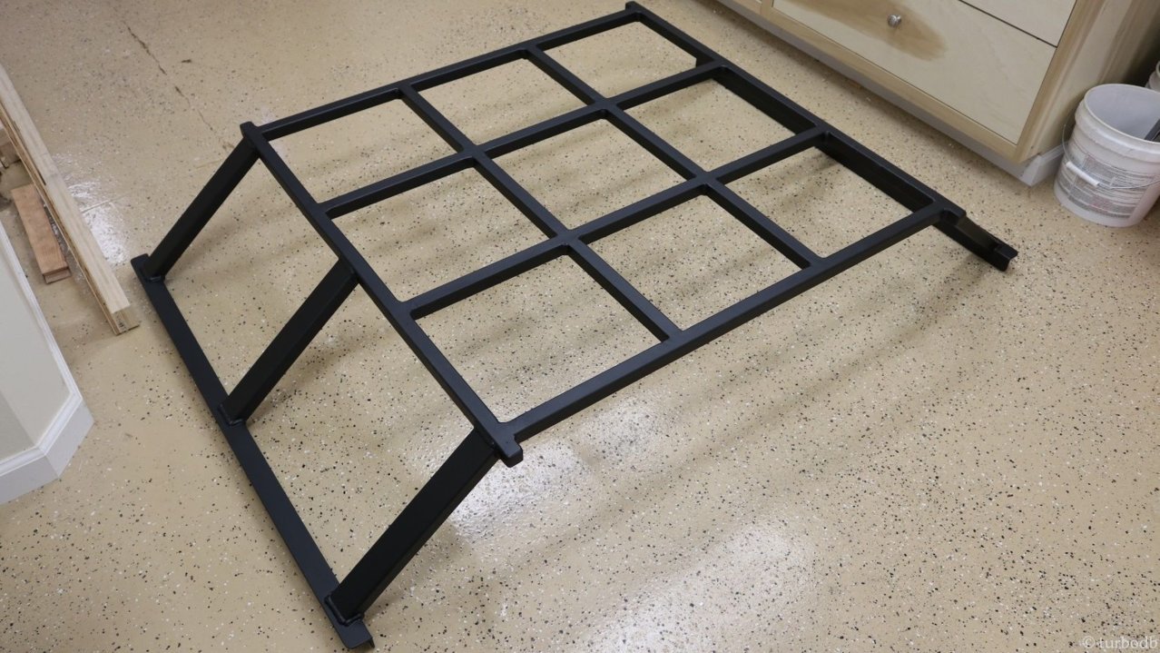

    Here's a DIY kit I sell, if you're interested. Not too expensive, since you do the welding. Uses a combination of 1x1 and 1x2 for strength, and puts an RTT at cab height.

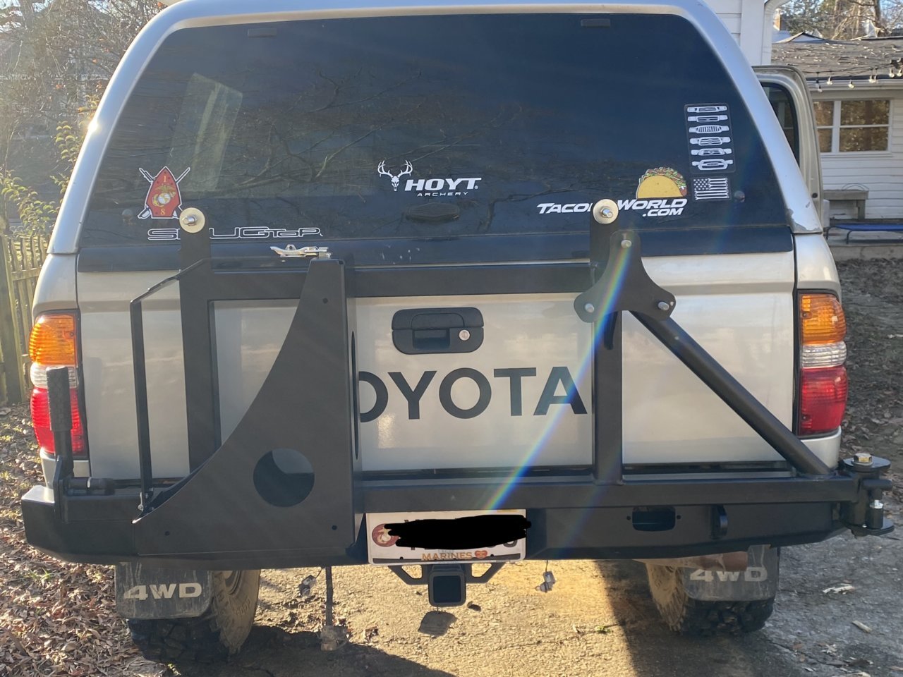

    looks like the 4xinnovation swing out. Did you powder coat?

    That’s it! And yea I had it powder coated

    I bought it from a guy off of here
    i bought it from a TW member, Cboy808

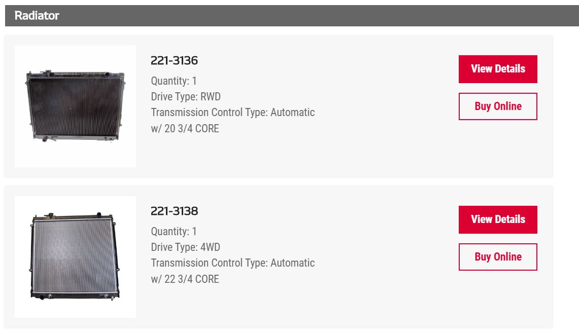

    So my 20 year old stock radiator is still running with no issues (knock on wood). I'm thinking about replacing it but when pulling up Denso's site I see this -
    Given I've swapped to 4WD, would 221-3138 be the one to order or just stick with 221-3136 (these are 6cyl part#s)?
    @El Taco Diablo , @04Pre_Runner , @frenchee , @mjhenks and anyone else who has made the swap and may have replaced their radiator.
    Thx.

    Should be fine with either. The shorter one won't hang as low below the the frame rails is all.

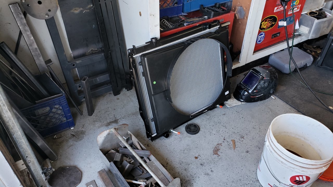

    I'm not sure on part numbers, and don't have the truck with me at work, so I can't measure. But here's a picture of the last time I replaced mine. Almost positive it's the taller one.
    Like @Blackdawg said, the taller one will hang a little farther below the frame rail, which could, in theory, make a difference with skid plates. Also, I don't believe the shroud will be right if you go with a different size, so keep that in mind as well.

    Also... yours was a Prerunner... which would be the same as a 4wd.

    I thought about that... checked again and PreRunner selected, its the same part as the base option.

    I do remember there a bunch of different sizes and stupidity with the way they have their radiators. That makes it confusing.
    I'm almost 100% certain I just bought the taller radiator and taller shroud from O'reily's, last time I replaced mine. But that was when I was yanking my Champion piece of shit, so I had neither a stock radiator, nor stock shroud to measure off of.
