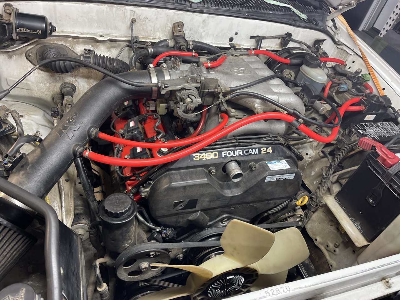

    Installed a SoftTopper yesterday.

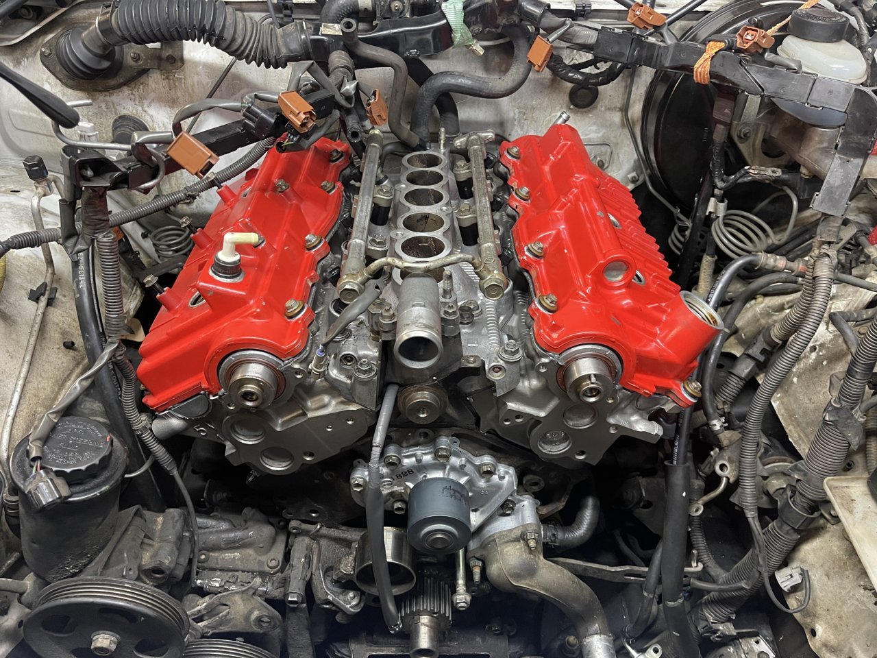

    The valley where your fuel rail is so clean. I assume you recently did the valve cover gaskets before this job since your covers were painted? What paint did you use?

    Ya I took some simple green and a wire brush to it before I reinstalled it two days ago. It was much dirtier than that lol.

    It's less Tacoma and more mod
    It looks like you did a really nice job when's the first fire up?

    Fired it up about an hour ago! Started first try, seems to idle fine. Just burping the system right now.

    And I didn’t realize the picture order was you building it back up, that makes more sense. I’m balls deep in cleaning mine right now, got at least 4-5 hours cleaning the valley alone.

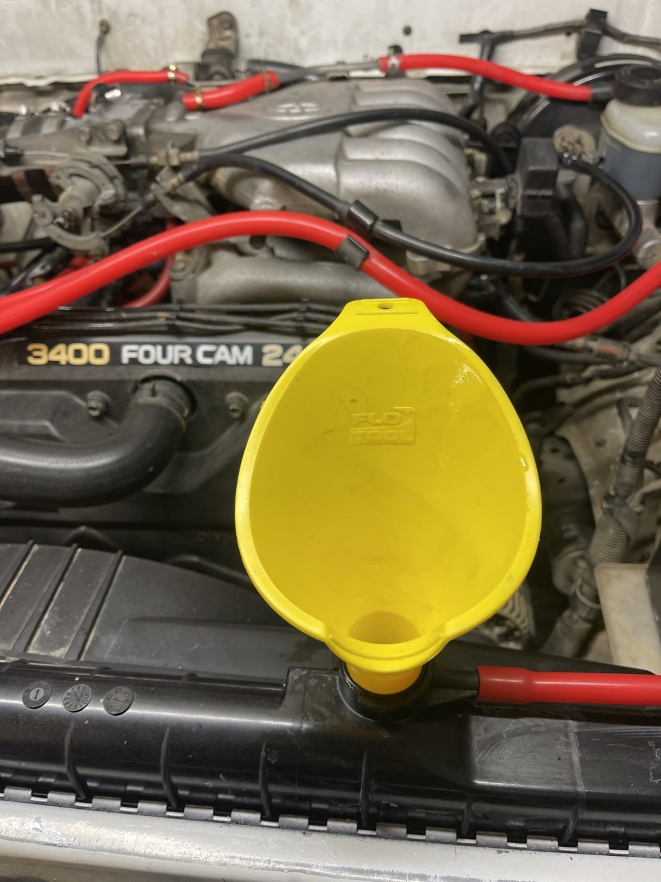

    Need a funnel to really help with this, also have your heat on full blast to push any pockets out of the heater core. Having blowing hot heat is a good indicator that majority of the air is out of the system.
    Also another quick trick is fill up your coolant overflow reservoir and go for a drive then park it. If there is a pocket of air, it'll push up as pressure decreases and make its way to the top into the overflow and pull coolant from there back into the radiator.

    Fill the resivor to the FULL mark or literally fill resivor to the top?

    Between the "Full" mark and Top of the physical container.
