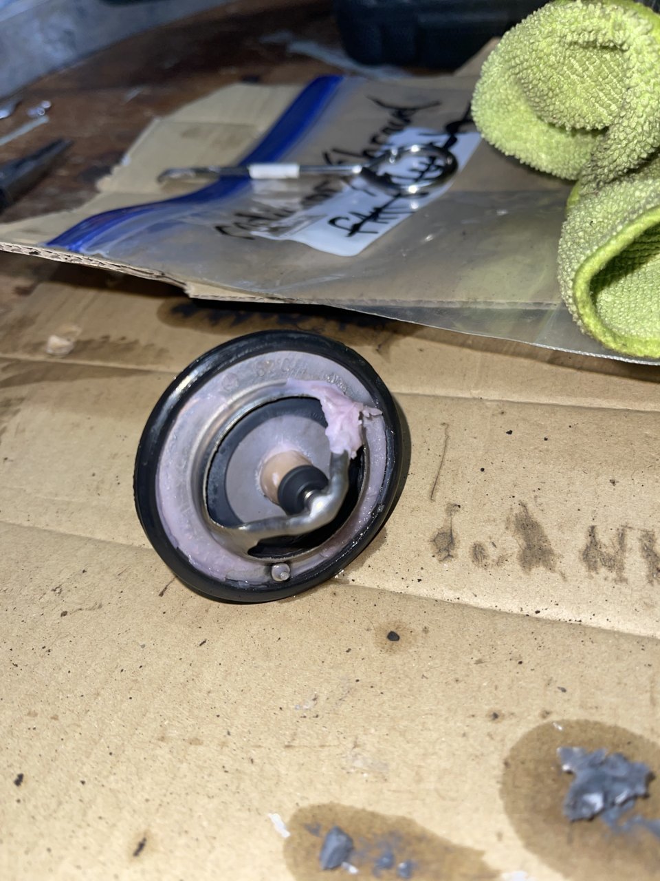

    Few months ago I put in head gasket sealer (big mistake). Ended up clogging majority of the coolant system. Ended up getting it fixed for the most part at valvoline with their pressure coolant flush thing. I was able to drive it again but I still had a lot of this pink paste left over and it’s especially noticeable with a cold system. After getting hot it kinda seems to liquify. I wondering since my truck sat in the cold weather for almost a week this process had time to get even worse. My motor is still pretty warm and this is what my thermostat looks like.

    While you have it out, go put it in a pot of water on the stove and boil it to see if you can get it to open up. If it moves, thermostat is working.

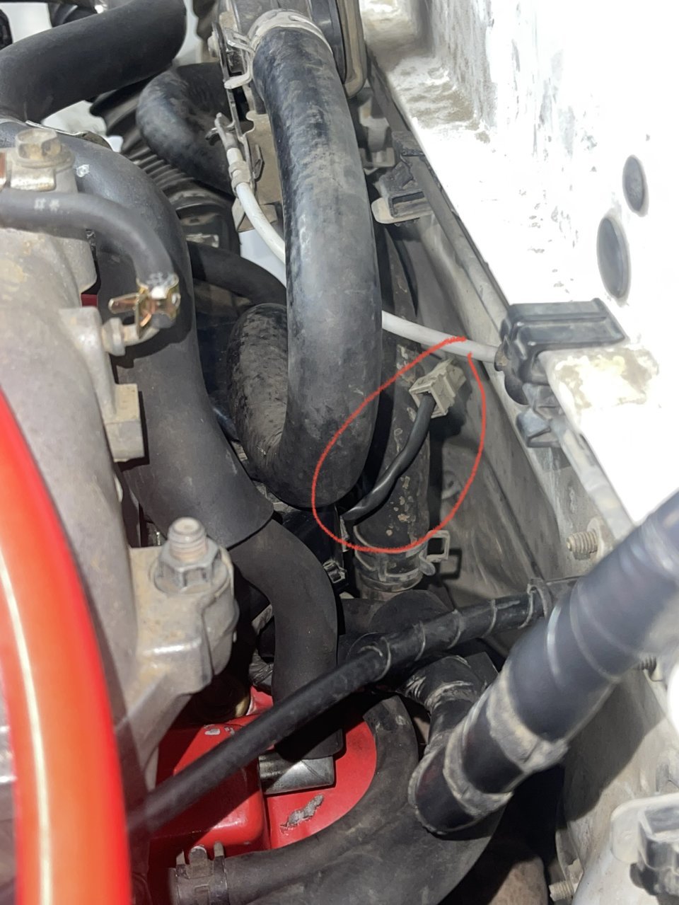

    Is this what we’re talking about? For the life of me I can’t find where it might go.

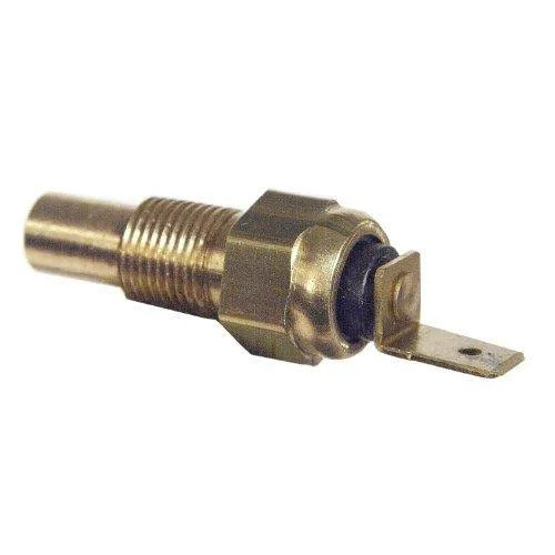

    There's a copper blade sensor coming from the lower intake manifold (between the injectors). You'll have to look below all that cover to see it. That harness plugs to it, I think its call a coolant temperature sensor. Look similar to the attached picture.

    Just found it right before I read this. Does this affect the thermostats function at all??

    Thats the one, theres a temp sender on the bad of the lower intake mani

    that the gauge connector, the one in the front is the ECU one

    If you have that HG stuff clogged in your thermostat, I'm willing to bet the propeller fins of your water pump maybe be gunked too. And radiator too at this point.
