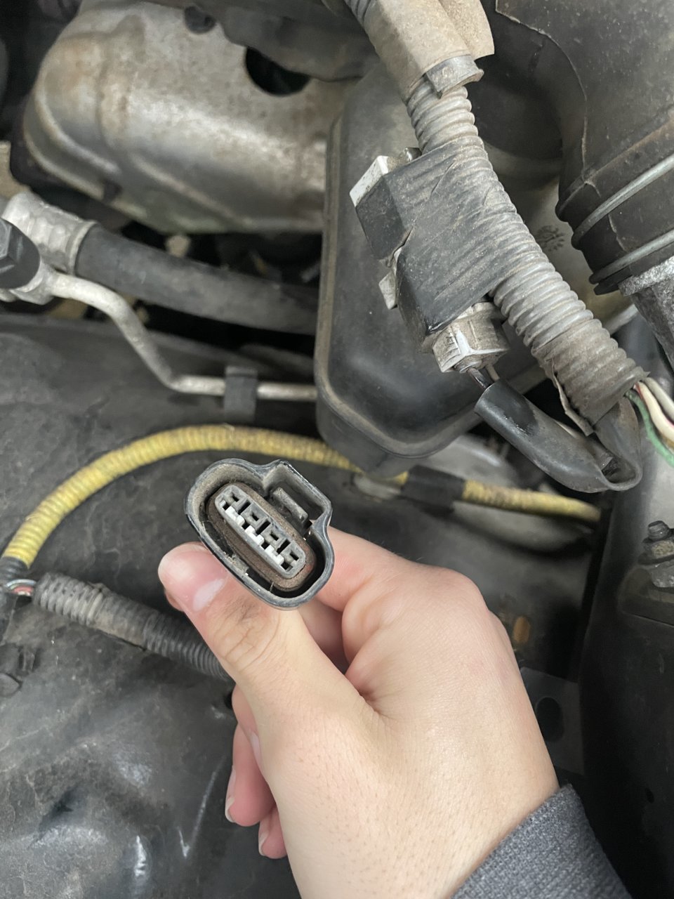

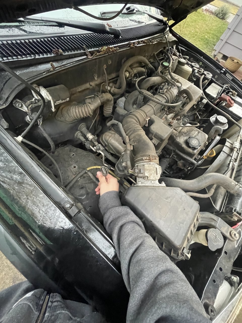

    I was just looking in my engine bay and noticed this connector was unplugged. I also saw another connector was taped to part of my air intake (see pic). Anyone know what thing connector is for?? Thank you!!
    (Also created its own thread. I just figured it might get seen better here.)

    It's for cruise control but you don't have it

    Oh okay. Thank you!

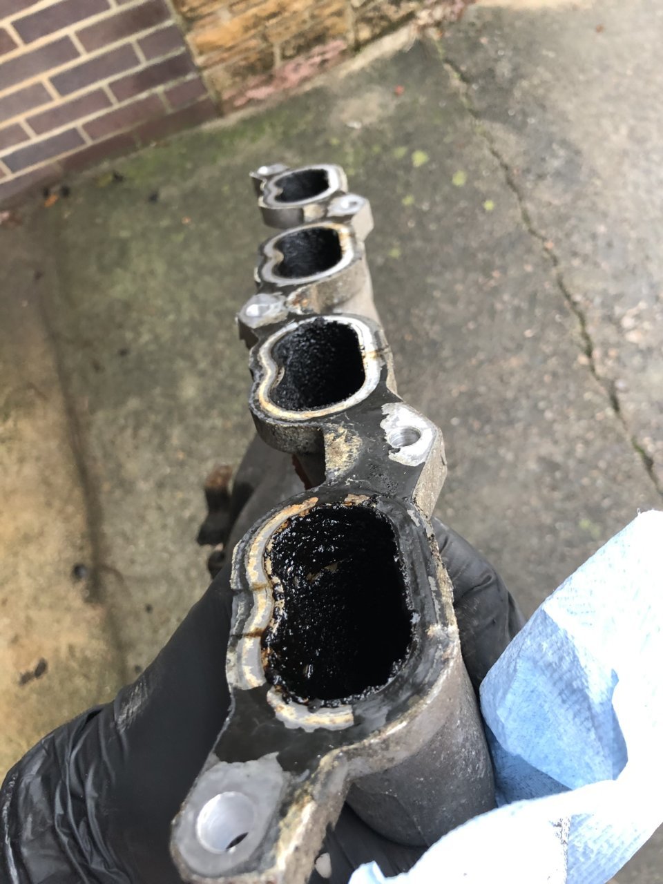

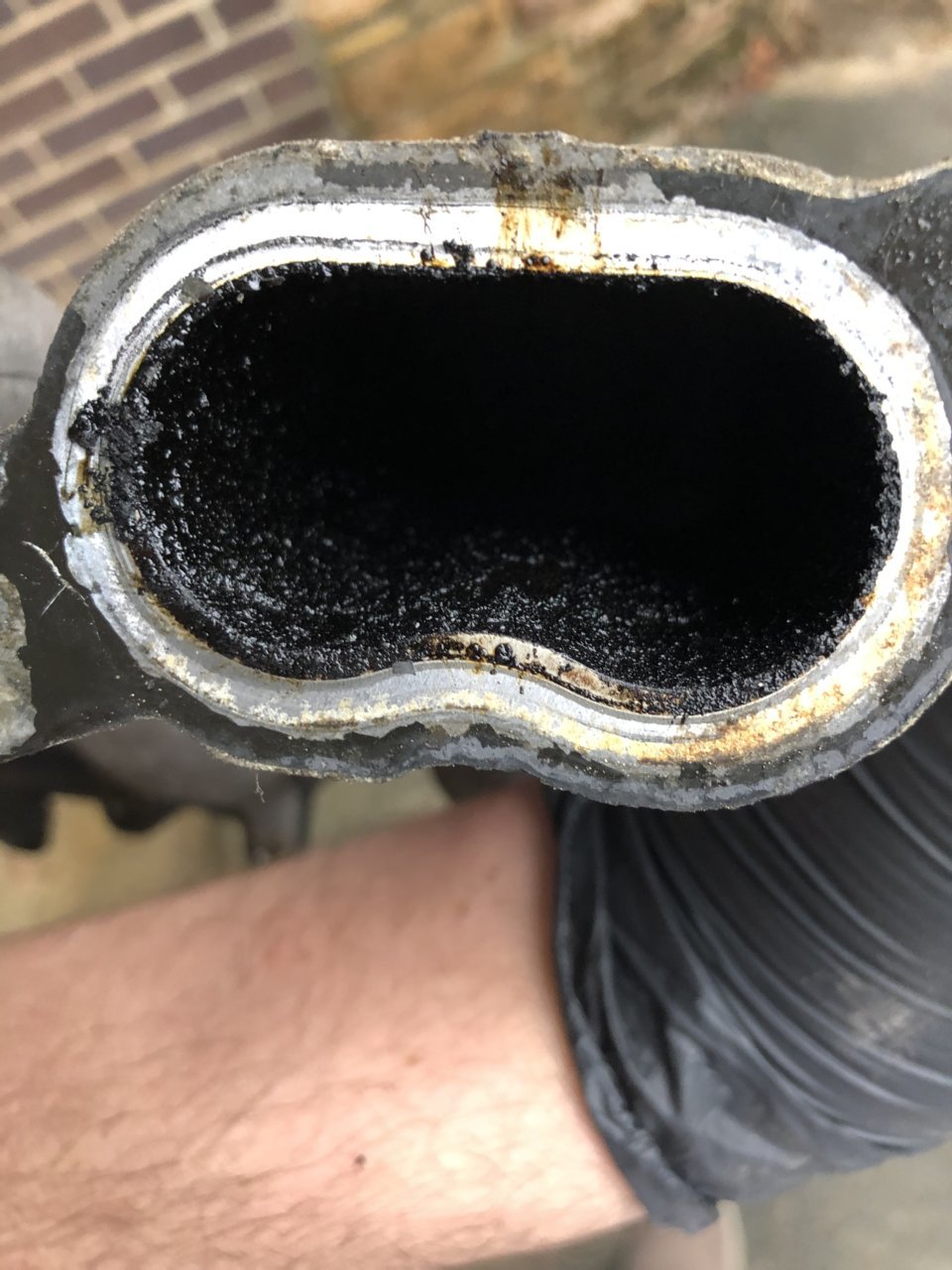

    Got it mostly cleaned. Plenum and TB too.
    ECFA9CBA-6A5B-4A21-8332-F65B60A5FCE4.jpg 3FF8B2D5-D170-4472-A746-C1F38D15B86D.jpg C102CEDF-5E2D-4FEA-9D6E-13FDA2140FEA.jpg
