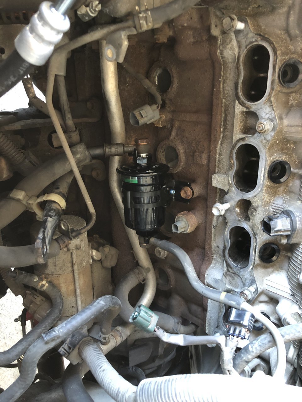

    I decided not to relocate my fuel filter. After all said and done I figure trying to fit it on the fender was too much candy for a nickel. It seemed cramped under its own fuel lines and you have to permanently modify one of the lines coming off of it to work. Since it ain’t an item that needs changing all that frequently, I don’t think I’d mind pulling the intake off again to get to it, plus it’d give me another chance to give the intake a good cleaning if it needed it. Fuel filter is staying where it’s supposed to be. Now I just wait for LCE to send my injectors back and I’ll have this thing back on the road.

    You should also be able to get to the fuel filter through the driver side fender. It's not super easy and definitely pretty tight, but doable that way also without having to remove the intake manifold

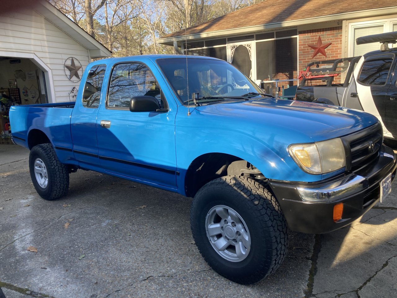

    4D5B6CC4-6597-46FE-9C80-9454B0899393.jpg Pulled it out of the garage and cleaned up all the trim. Just waiting for the paint to cure enough to polish it. I figured the Sun hitting it would help with the curing.

    @Jakuku Pahwheenis Can confirm.
    Source: I did it earlier this year.

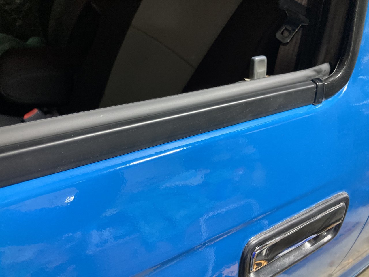

    F53FEB51-C658-4B1B-A0E6-ACFBBBD4A1F0.jpg Also added new window weatherstrips on both doors.

    That's a great color! Reminds me of the BMW Marina Blue

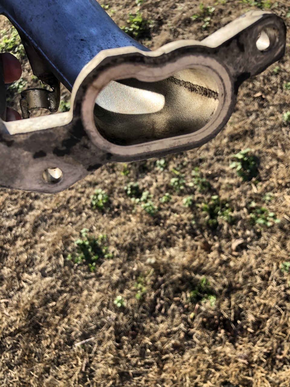

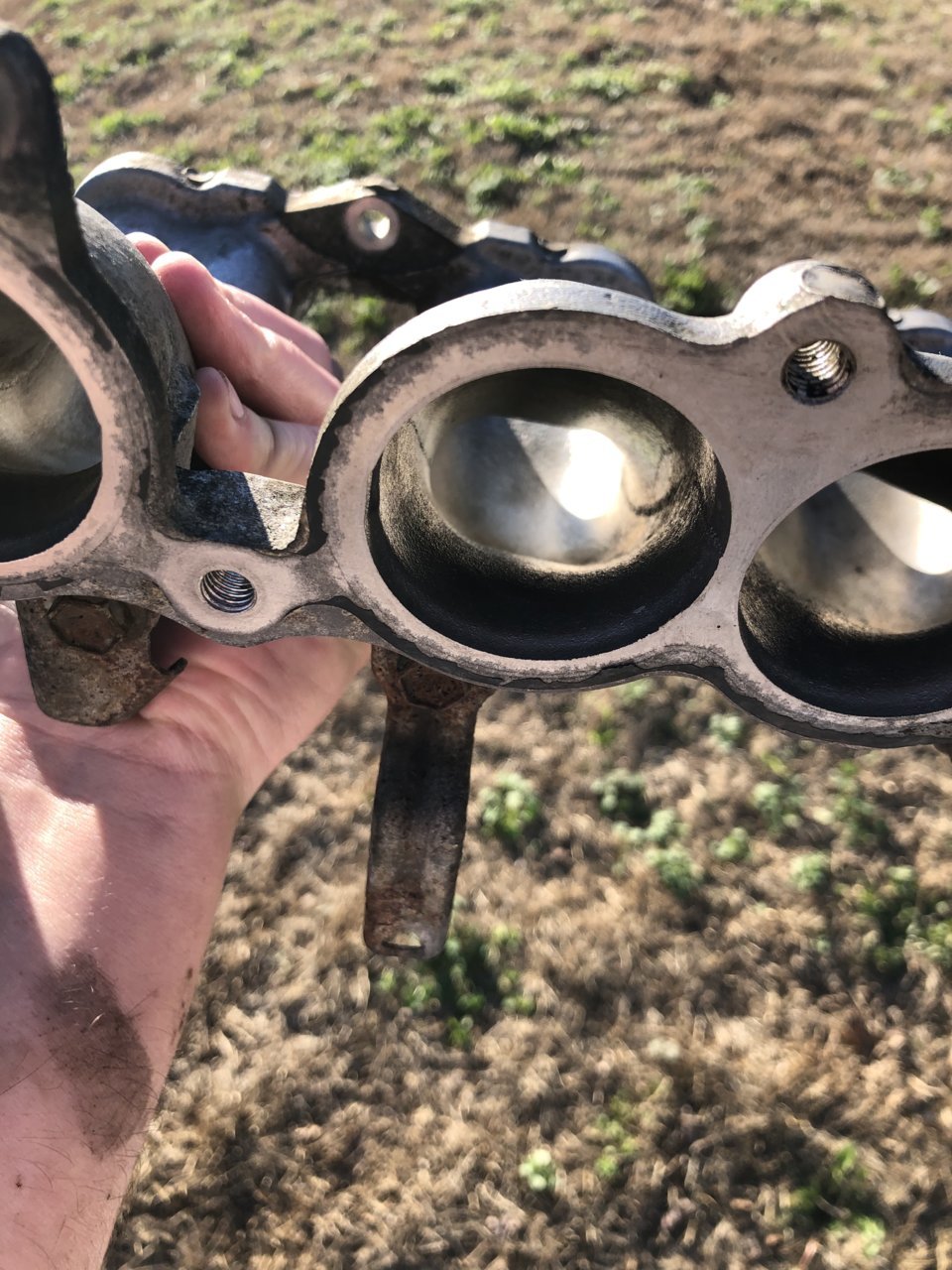

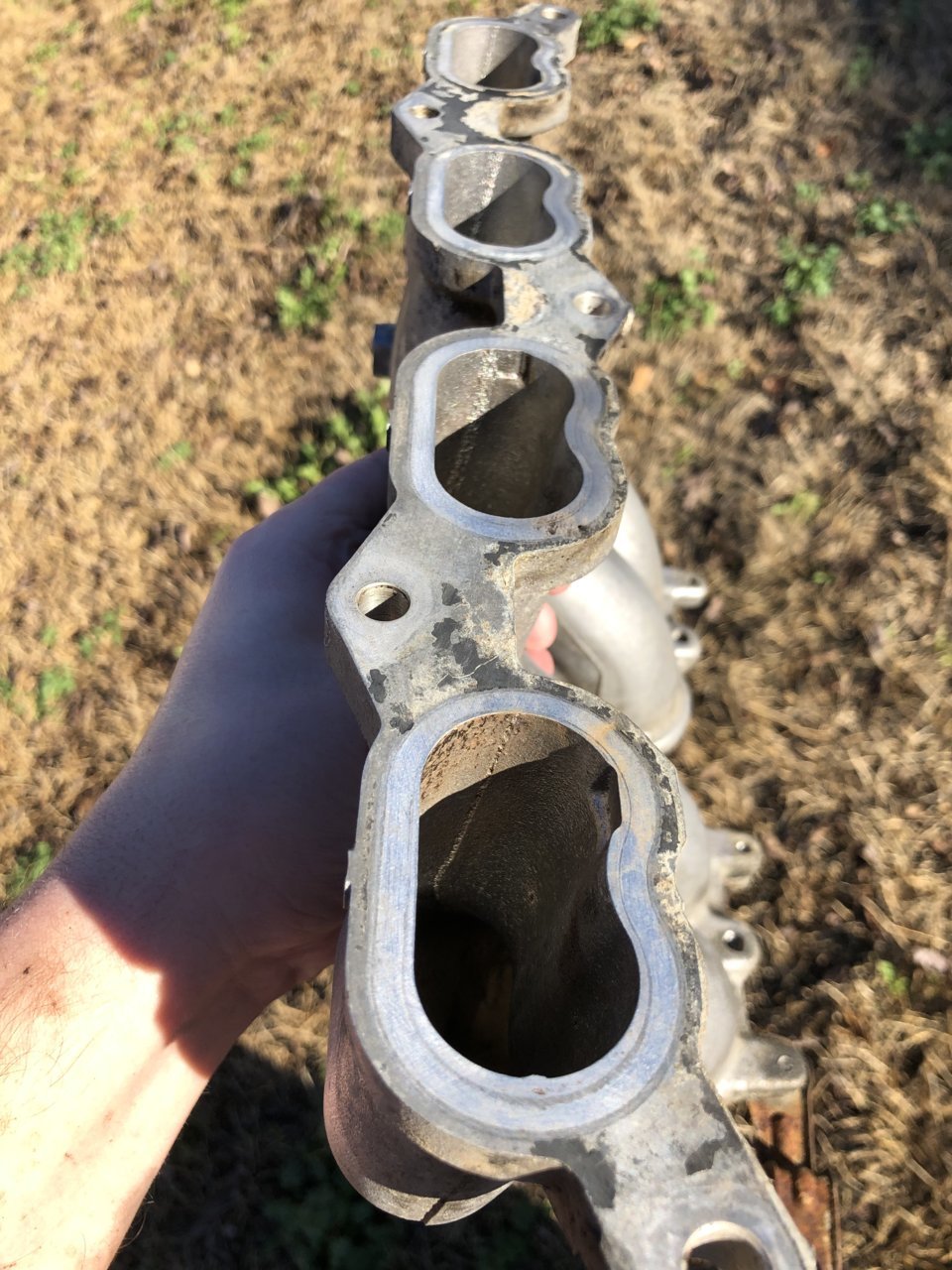

    What did you use to clean it? It's crazy how oily and gunky the 3rz's get. My 5vz really doesn't look bad at all in comparison. I was going to add a catch can but it seems unnecessary based on what I found and the mileage I am at.

    Something in a black jug called formula 8& or something. It was probably no stronger than soap and water. Poured it over everything and scrubbed out with a long brush made for dryer ducts. Used steel brush for getting all the little bits off as far as I could reach. Finished up with a few cans of carb cleaner for the last bit of residue.

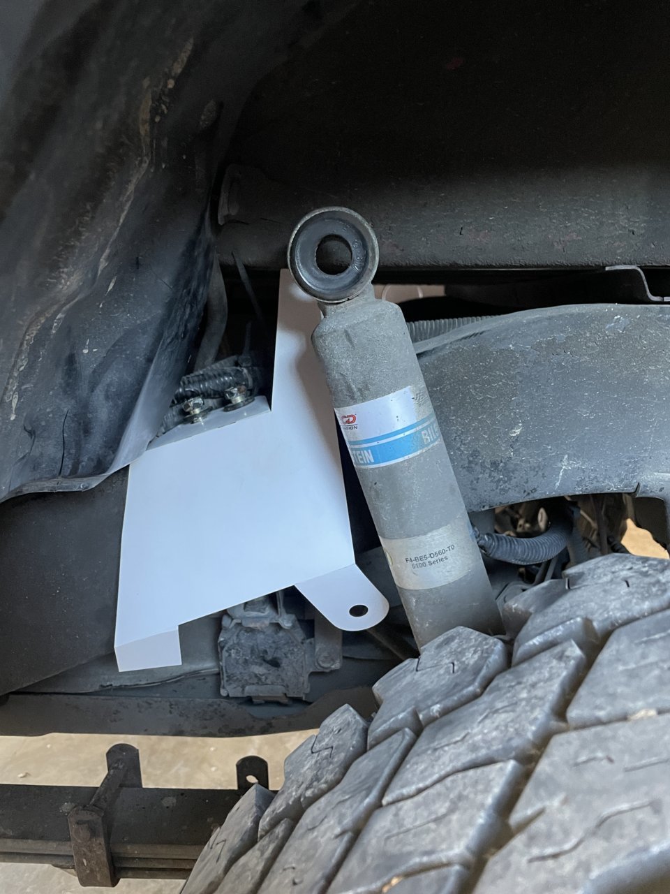

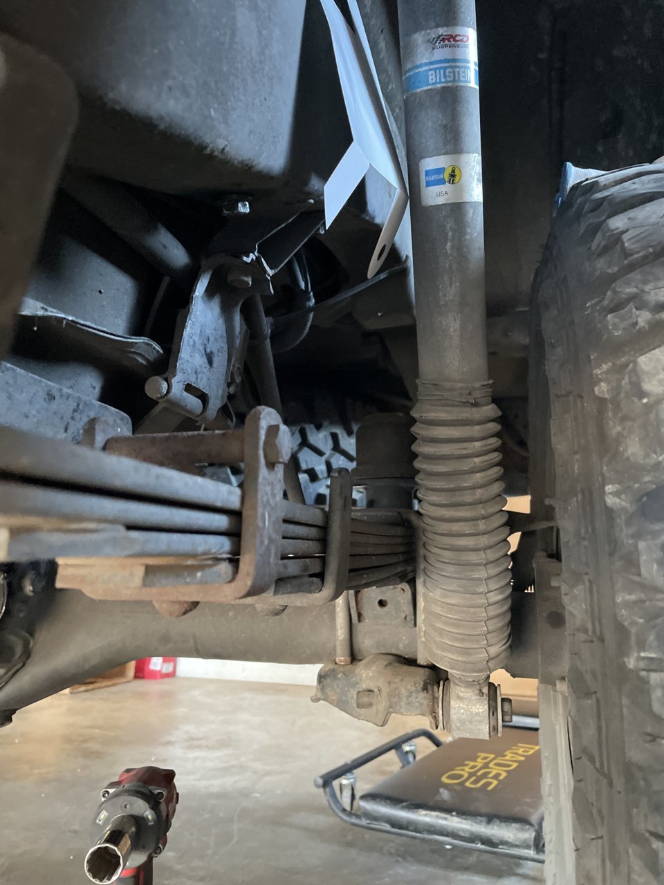

    Worked on prototyping a bolt on outboard shock mount for the rear.
    B5762931-2B76-42A0-B643-F8211F1DAC60.jpg 9F63249C-40E9-48DA-853E-5A2993BFFCC6.jpg

    I like how you're reusing the lower mount just flipped. Smart

    I’m planning on getting a pretacoma mount for the other side since they’re opposite.
