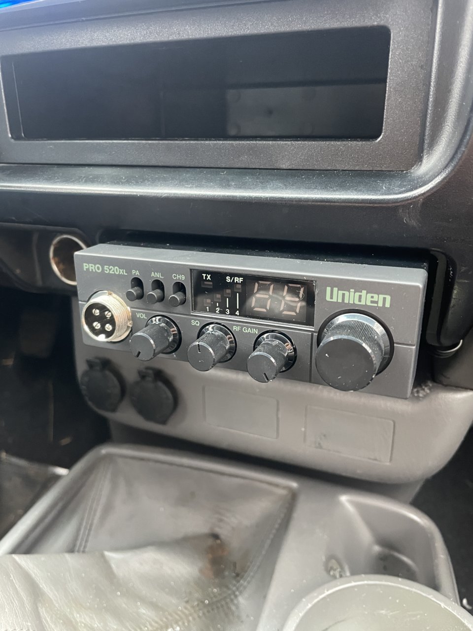

    Just installed a Uniden Pro 520XL CB Radio in my truck! Super easy install and works great!

    I've got the same gearing up for an install soon. Did you have to cut out the back of the trim piece at all? I have a right angle connection for the antenna, you do something similar or was there enough space without?

    I had to cut out the plastic directly behind the cigarette lighter. I just used a little saw and it was super easy. You could also use a dremel. A right angle antenna connector would be perfect. I didn't have that so my radio sticks out just a little bit. Not the end of the world but just a note.

    You can use a heat gun to heat up the plastic duct work behind it and it will bend in enough so the front of the cb doesn't stick out at all.

    I tried that. It worked a little. I was just worried about melting all the way through it

    I heated it really hot and used a 1x4 board to push it in without any issues

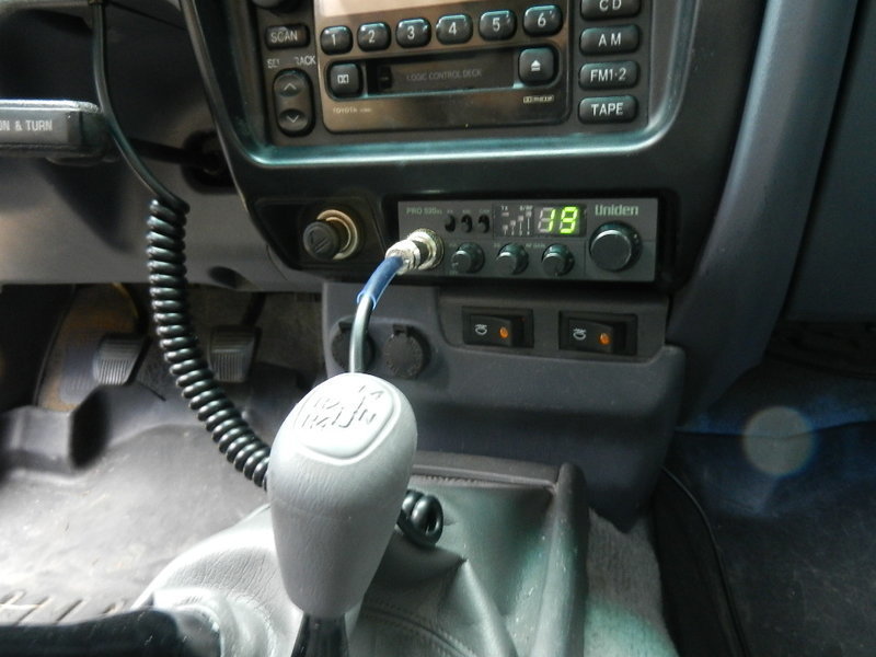

    My work was very crude back when I first installed it and my tools limited. I hit mine with the flame of a map gas torch and then poked at it with 1.5 foot long breaker bar to bend mine and didn't go through so you will probably be good. :rofl:
    I however DO NOT recommend this method. :anonymous:
    You will love the radio though, with a properly tuned setup I have always been told I am the clearest sounding in the group.
