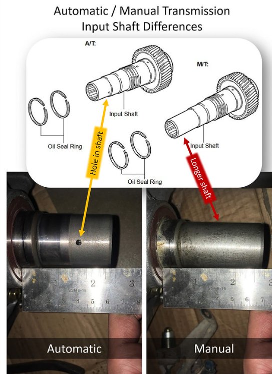

    I don't believe so. The spline count and shaft length is going to be different. I could be wrong but that is what I've taken away from previous threads. If you notice, in @turbodb's identification article, he has a visual reference of both the manual and AT cases.

    Spline count is the same and I believe you can interchange the input shafts.

    No, I'm saying they can both work on either trans.
    From what I've read, no one really understands why the lengths are different or that hole exists.

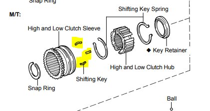

    @easleycrawler, if you do tear into the case be very careful with the shift keys. PITA to put back into place if they pop out.

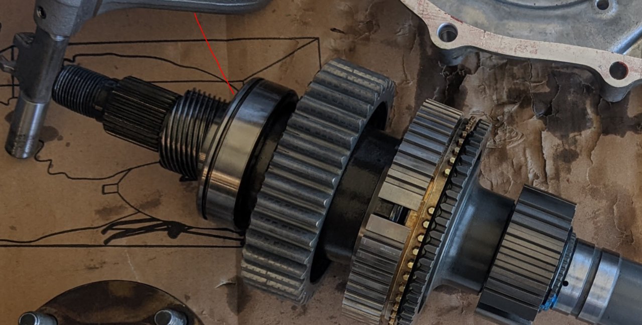

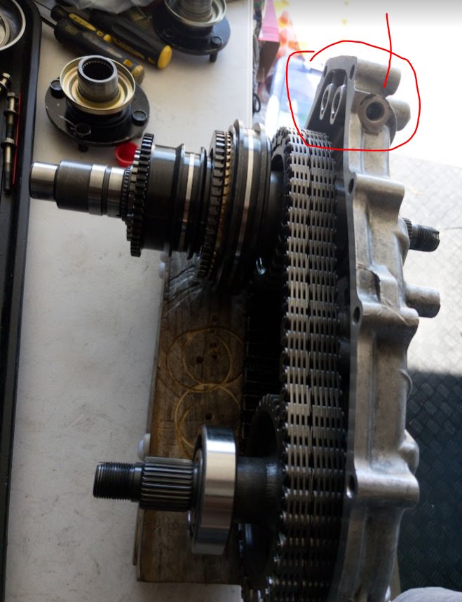

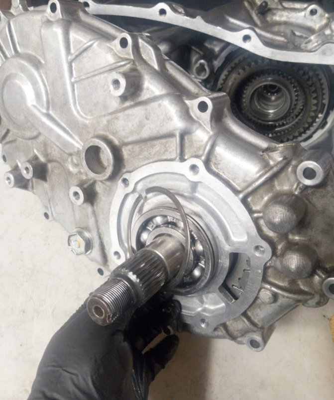

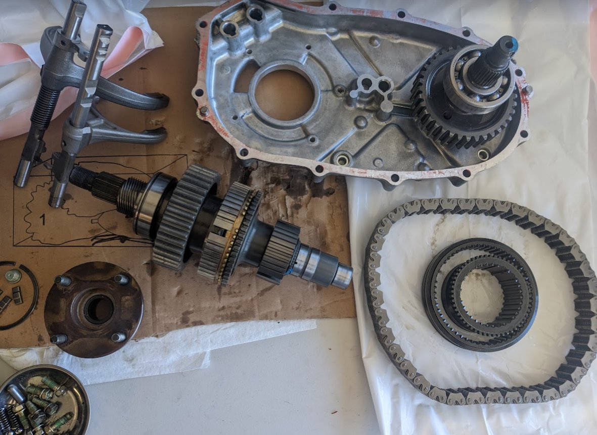

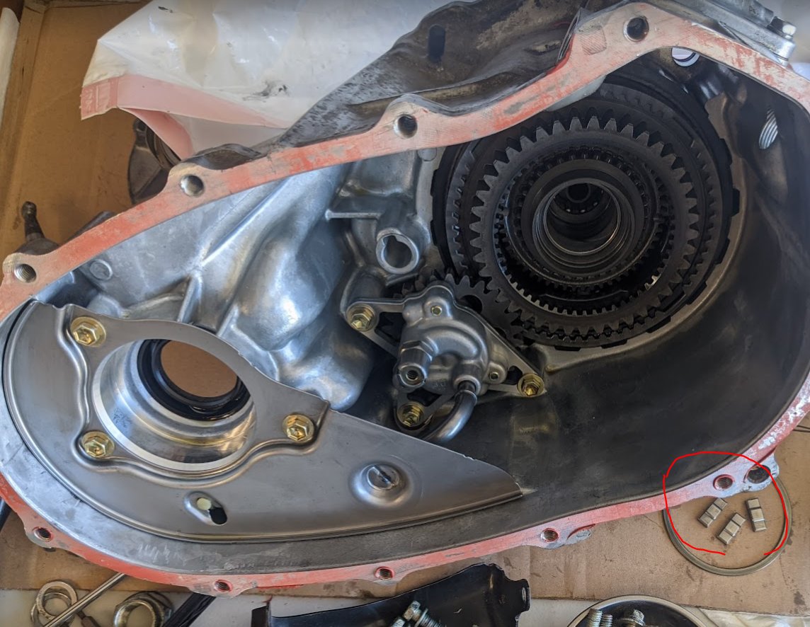

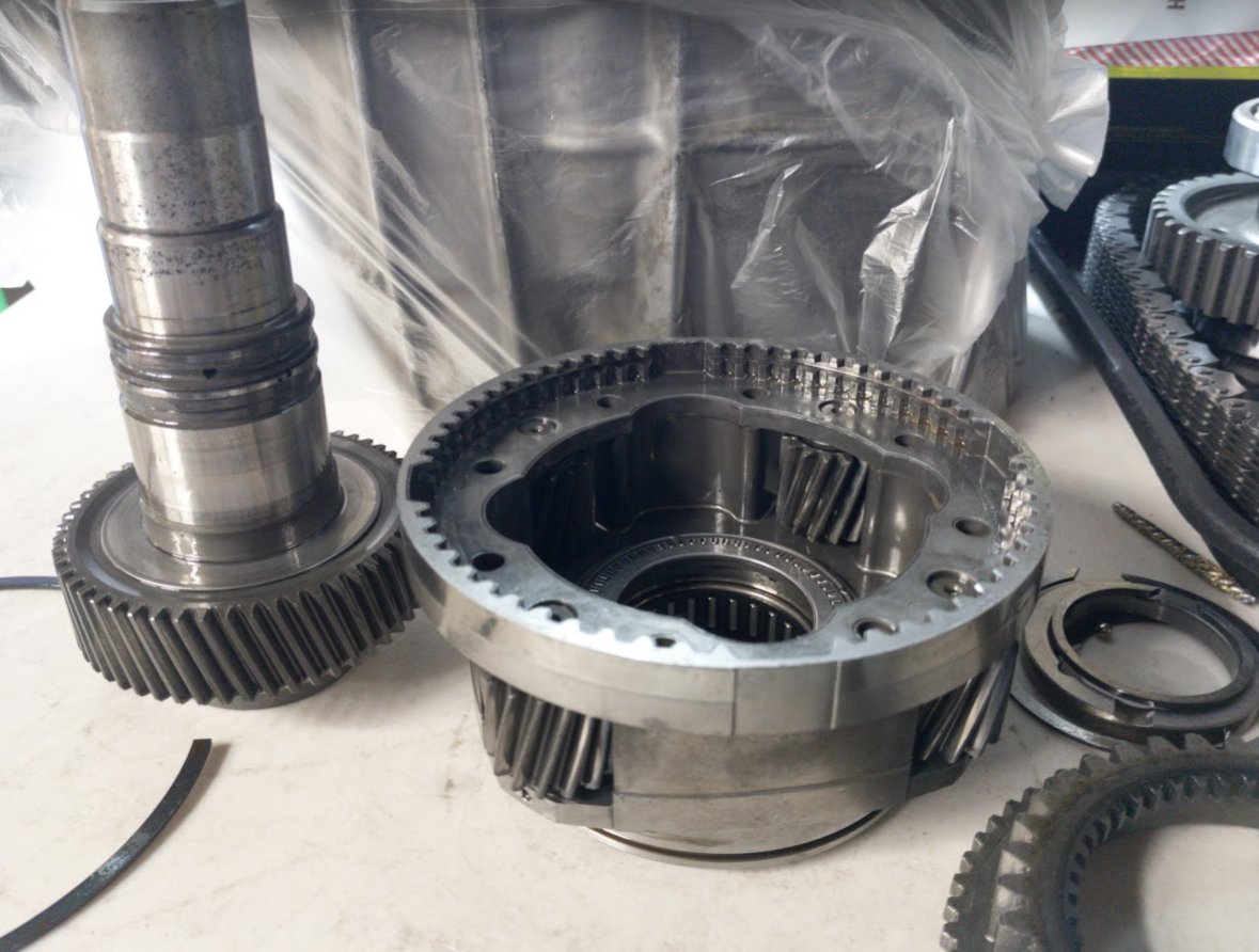

    Here are some pics from when I gutted my case. Like I said, PITA those shifting keys lol.
    Note those hair pulling POS shifting keys circled in red lol
    There are 2 large snap rings that hold the planetary assembly in place. Once removed, you can swap the input shaft.
    There is a snap ring that keeps the shaft in place. Once you have the cover back on, flange slides on and then the lock nut of course.
    I could go on and on with pictures so if you need any specific, let me know. Getting the shift rods and then the forks to line up in place is a pita, the horse pill and 2 springs can be a little picky with placement.
