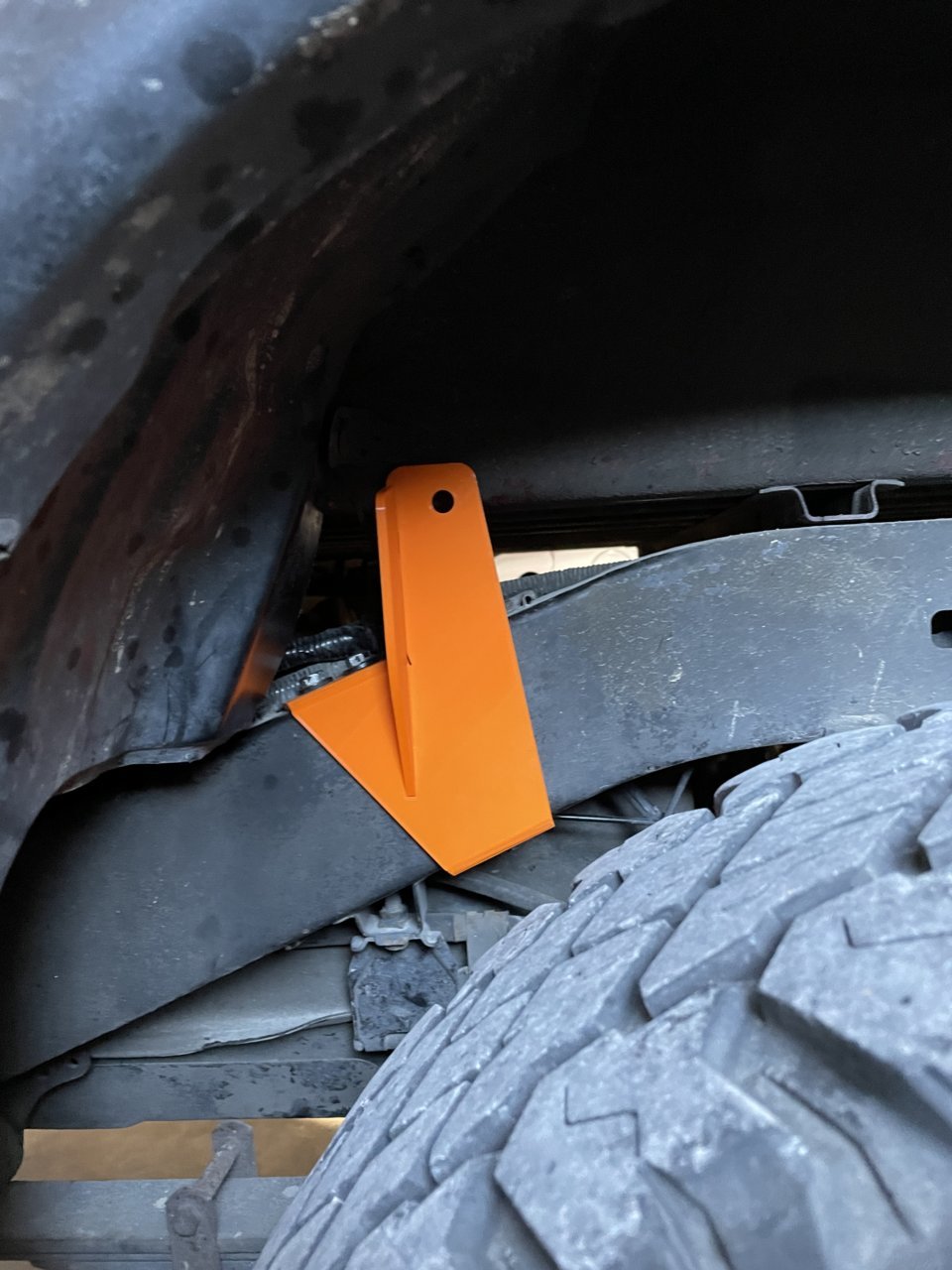

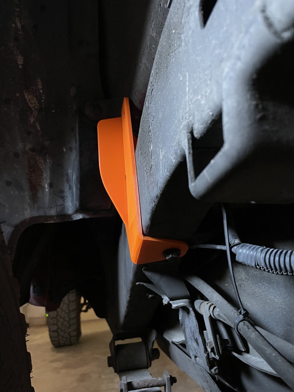

    Made some more progress on these bolt on outboard shock mounts. Time to make them out of steel!

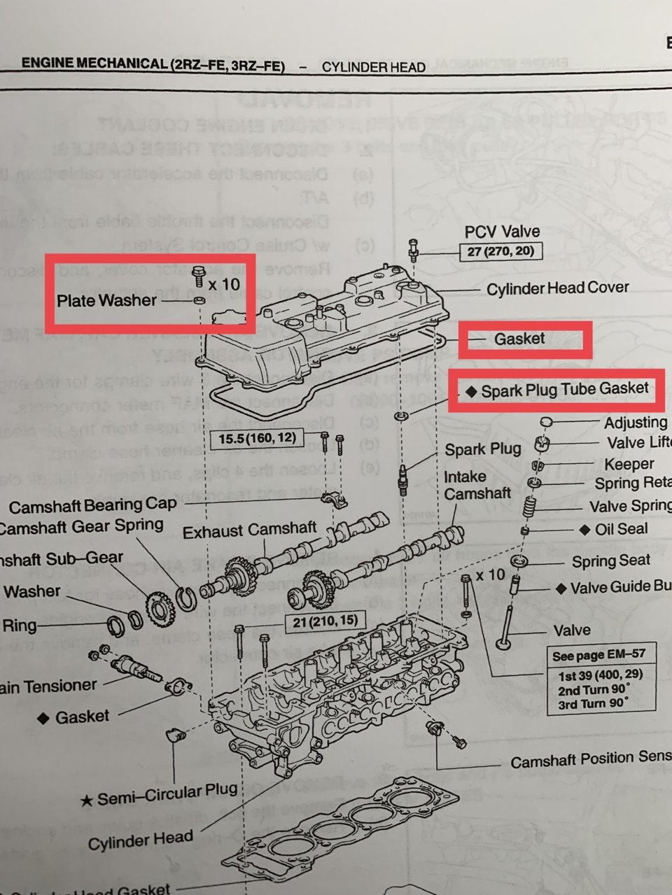

    I am preparing to eventually replace my spark plug tube gaskets and head cover gasket in order to fix the leaky gasket on cylinder 3. I have a couple questions:
    - are there torque specs for the 10 bolts and plate washers for the head cover? I can’t find them in the repair manual.
    - do I need new bolts and washers for the head cover since they are crush washers or can they be reused?
    -is there a gasket kit from Toyota? Or source these individually? Confirming part numbers below:

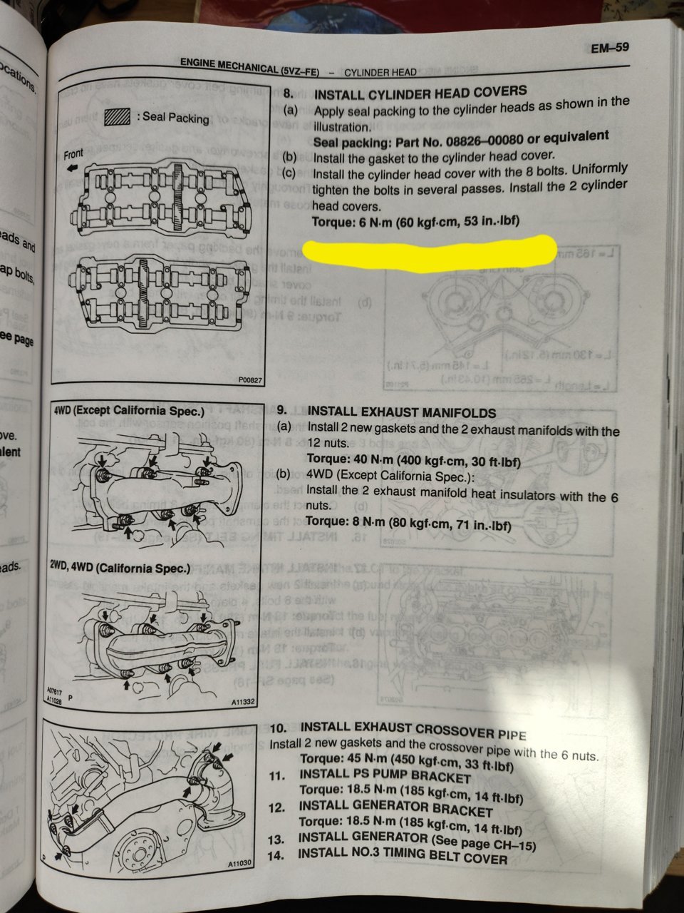

    Valve cover bolts are torqued to 53 inch pounds. I would get new washers since they seem to be some sort of rubber compound.

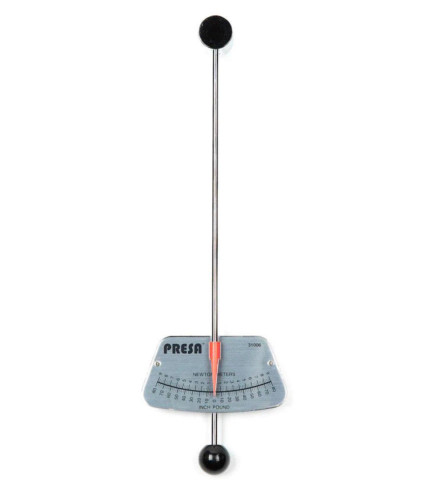

    Buy yourself an inch pound torque wrench. I have one of these guys.

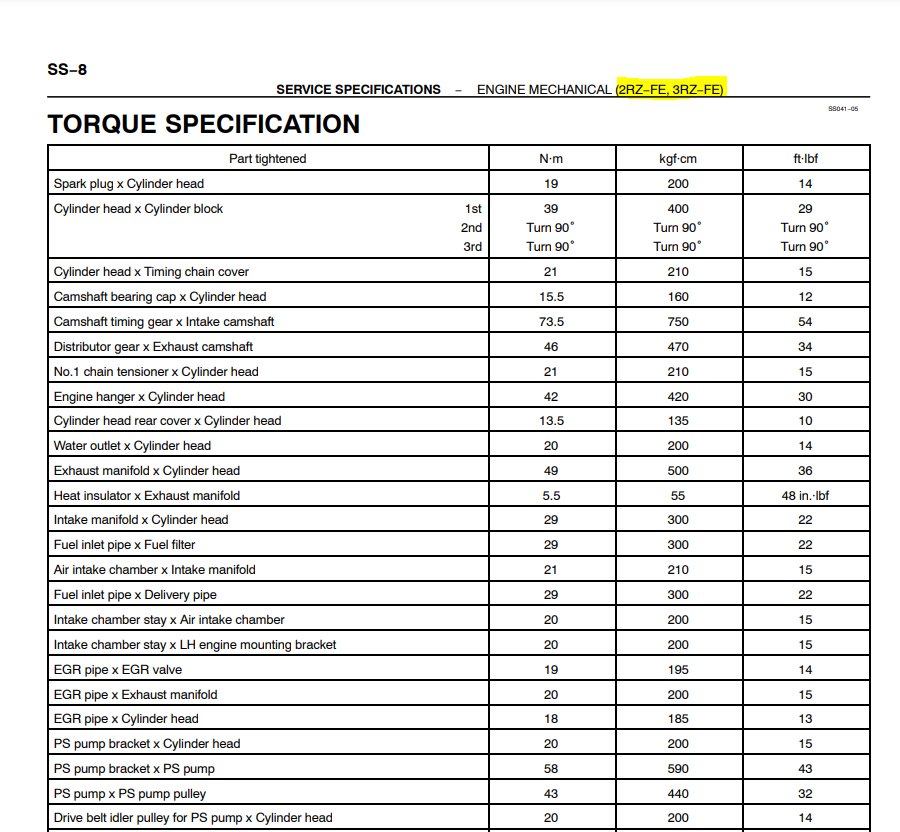

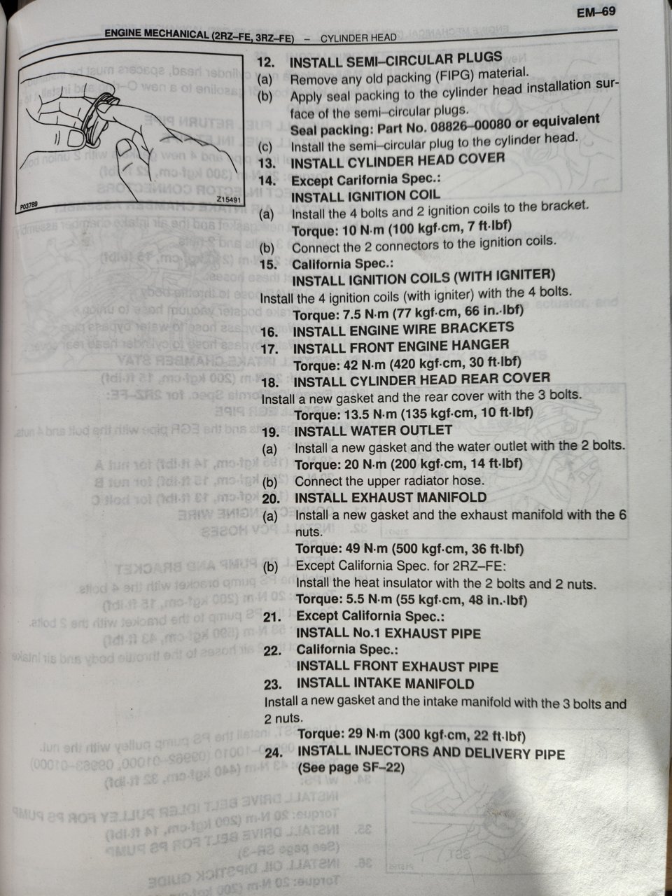

    Sucks that toyota doesn't seem to have a spec for the 2RZ/3RZ engines. 5VZ we know is 53 inch pounds but no mention of the 4cyl. I wonder why it was left out. I went back all the way to 1995 to see if there was a spec for it, nothing.
    5VZFE
    2RZ/3RZ

    very cool. I have never seen one of those.

    That's for the 5VZ. It oddly doesn't list it in the the 4 cylinder instructions...
    5VZ:
    2RZ/3RZ:
