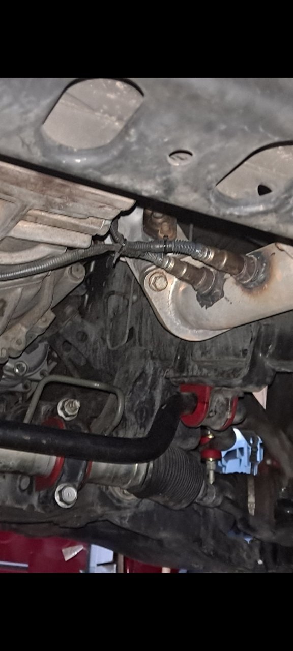

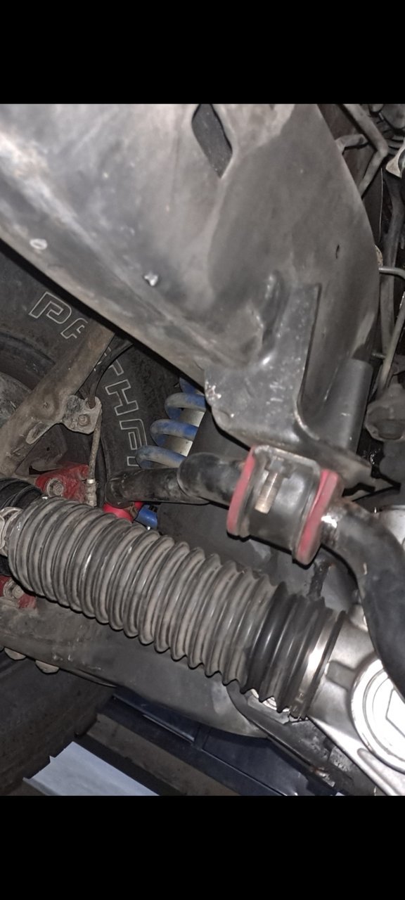

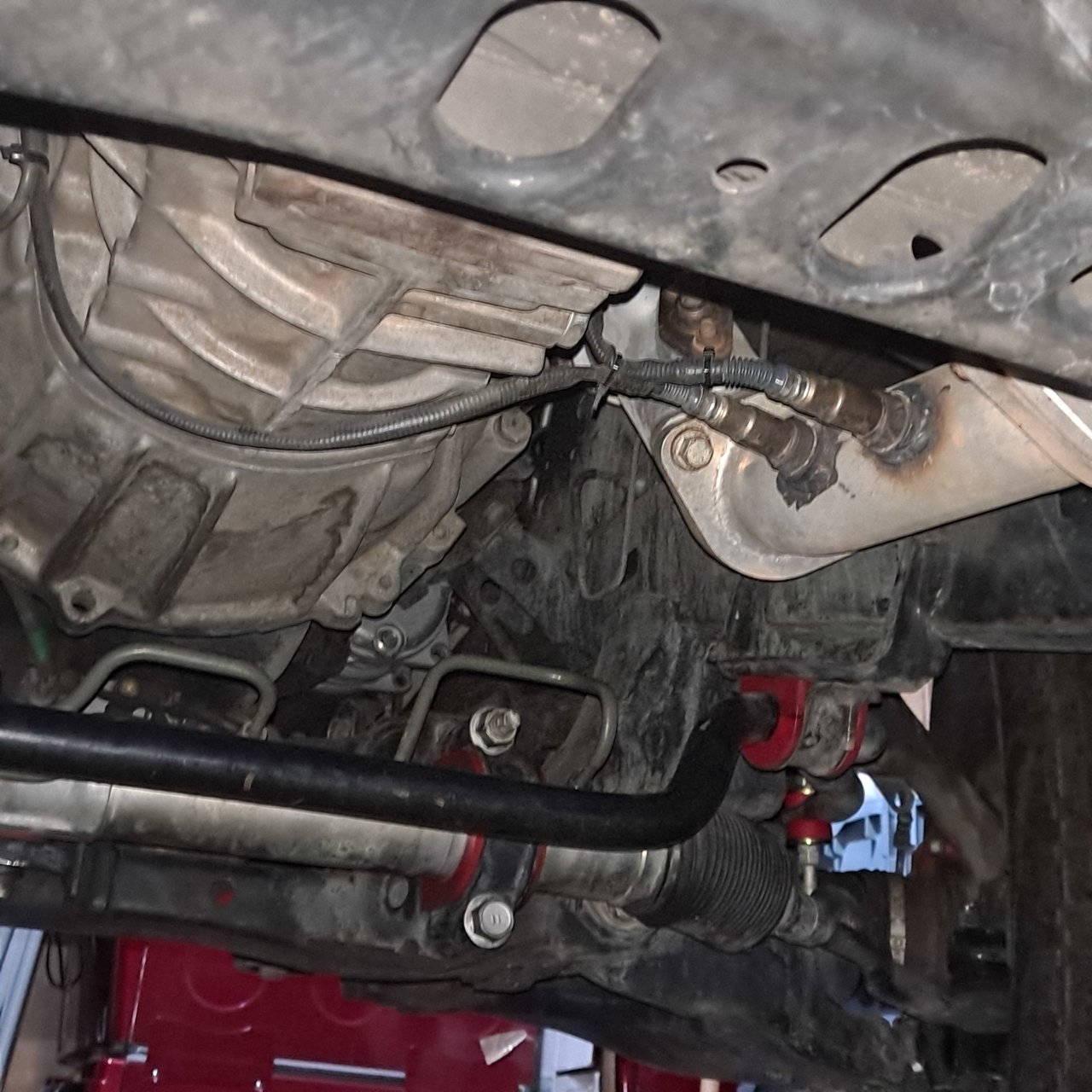

    Should be fine with copper then. Couldn't think of a reason why they're shaped like that or that it would impact anything.

    Did you pull the rack to put these in? I've been wanting to do it but don't want to deal with getting another alignment and stuff

    Just pop the outer tie rods out of the LBJ's and you don't have to worry about losing your alignment. You will have to pull the rack out a bit from where it mounts though

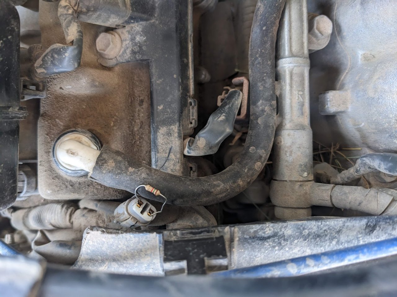

    Had the coolant temp sensor wiring break (or an animal got to it) but needed to get the truck started to move it....
    b17ybVdSH4FZ183FeufkETp4o1C7nur8hnV6YzkD_5aae3072a1dee2795cbcf468838830b0b08f4e6f.jpg
    EDIT:
    Since it was a pain to find....the part number for the engine coolant temperature sensor wire (pigtail) is 82219-34020 (8221934020). It should be around $10 from Toyota.

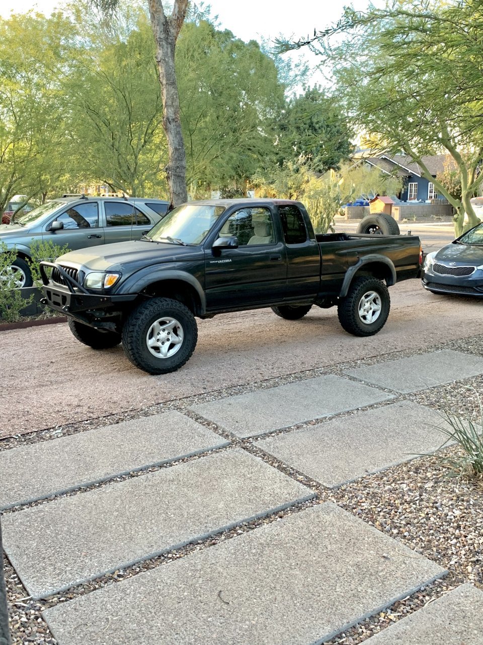

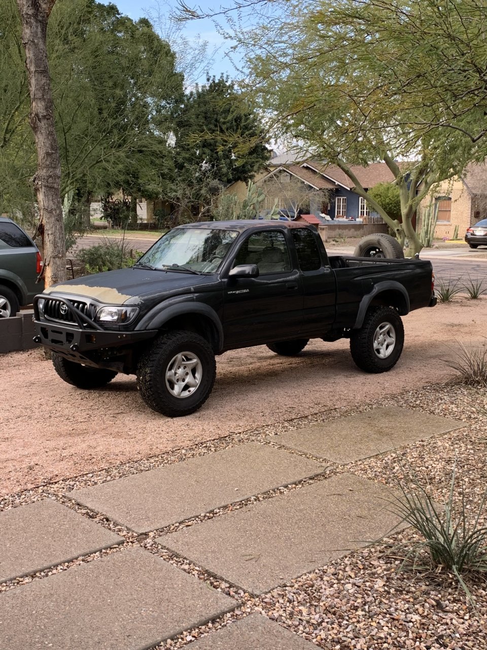

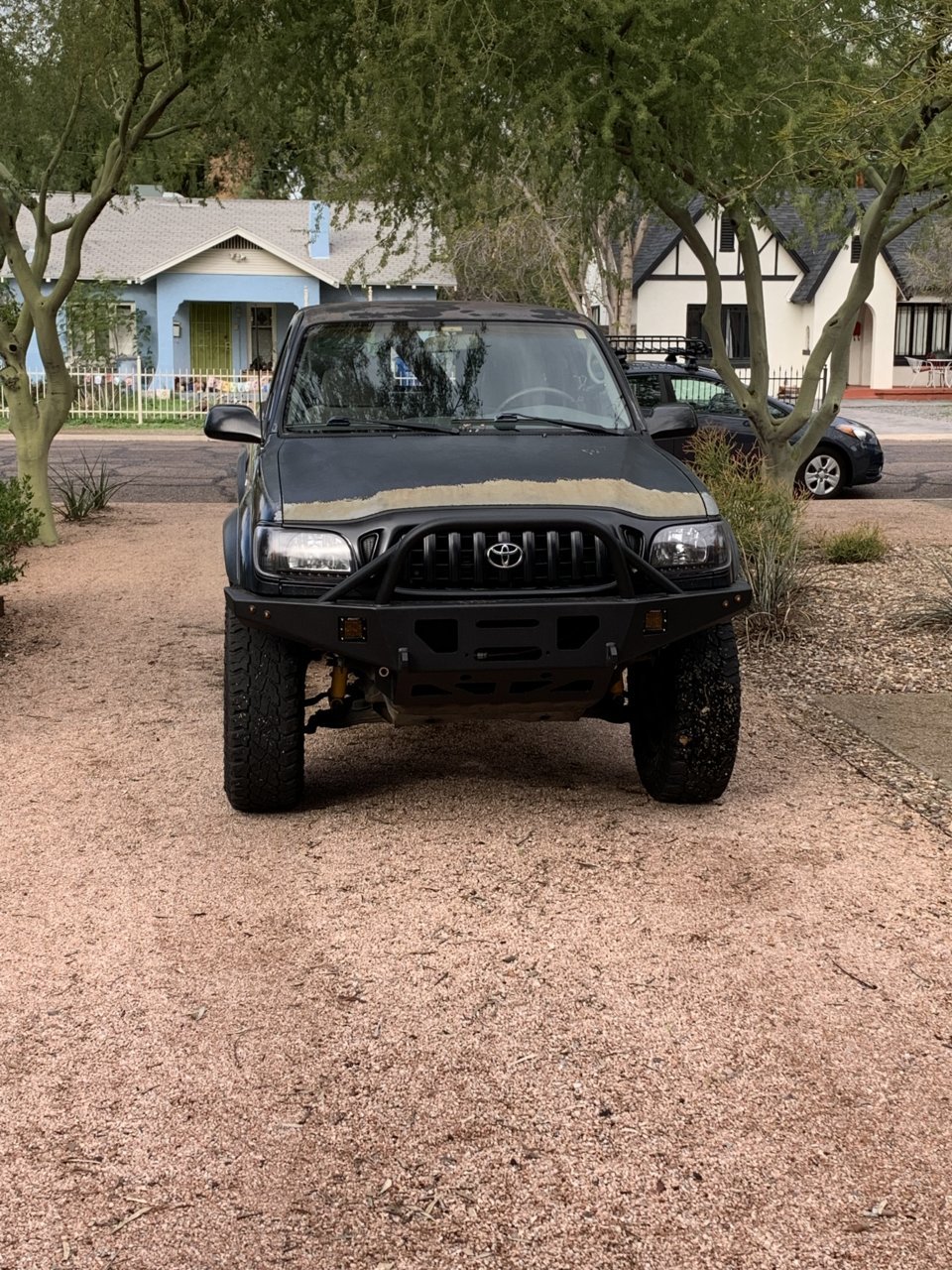

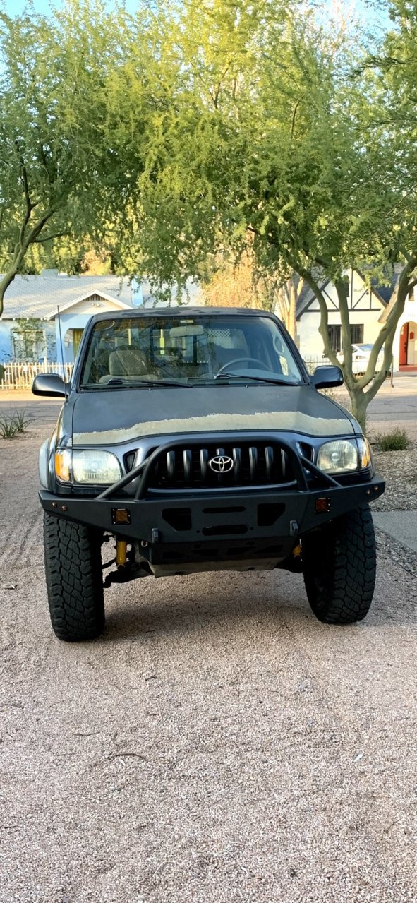

    Lowered my front lift a little today. Swapped out my 2883 springs for 2880’s. I haven’t tested it on dirt, but the ride quality on the road is greatly improved. The 2883’s were so stiff.

    Looks better too; no front diff, no cv axles, no transfer case, and no winch...those 883's must've been teeth shattering.
    Make sure to get an alignment, you're going to wear those tires unevenly and quick.

    Nice! 2880’s here as well! Where did you get your bumper?

    Oh man they were horrible. I was originally going to wait and see how it settled when I got around to adding the winch and sliders, but after considering the weight difference between 4wd and PreRunner like you mentioned I decided to swap them now. I just wish I had a spring compressor so I could progressively upgrade springs as I add weight.
    I am certainly due for an alignment. I have lower ball joints, tie rods, and the total chaos bushings waiting in my garage to get installed. I figure I will do all of that and get the alignment done after.

    It’s from relentless fabrication. They have a substantial lead time, but well worth the wait.

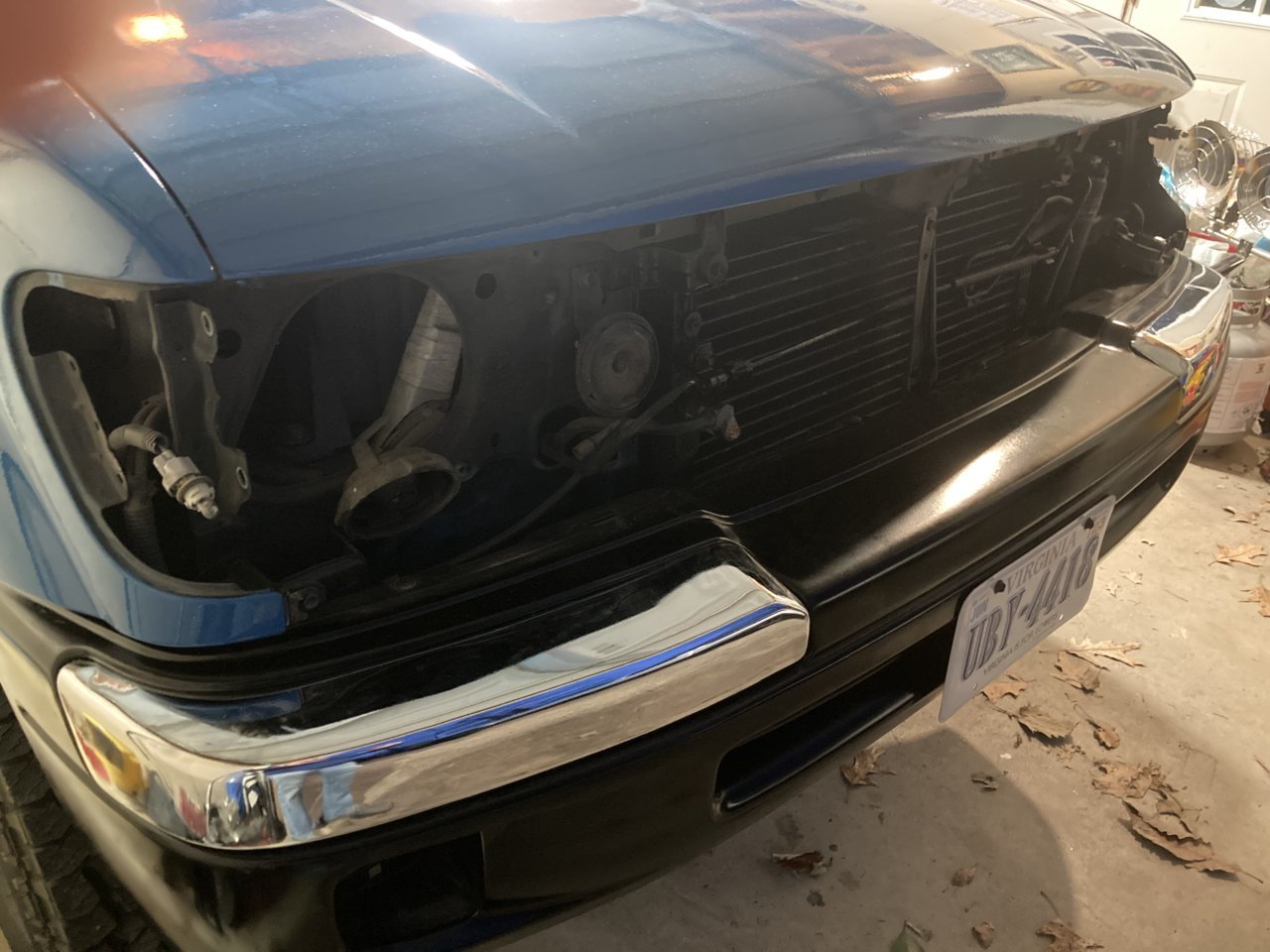

    D7888CE7-7EE2-4A2A-903C-BC11EF707030.jpg Pulled the turn signals, parking lights, headlights, and grill. I’m waiting for all the parts to arrive to put all new on. I’m switching my turn signals to clear lenses and adding Switchback LEDs to have full-time DRLs that turn Amber when the turn signal is activated.

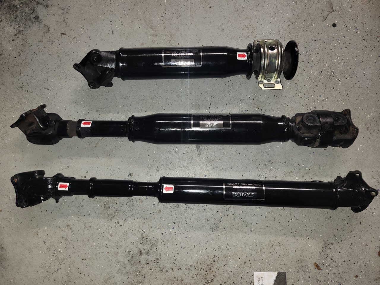

    Gunna be another busy weekend

    Did you at least go HD tubing?

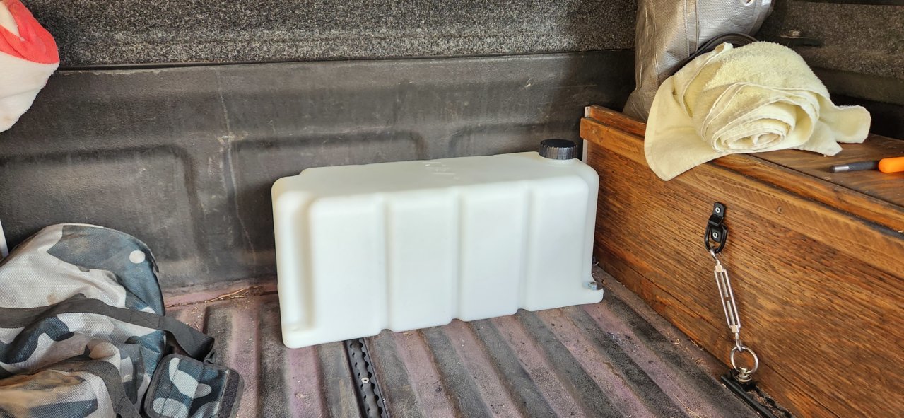

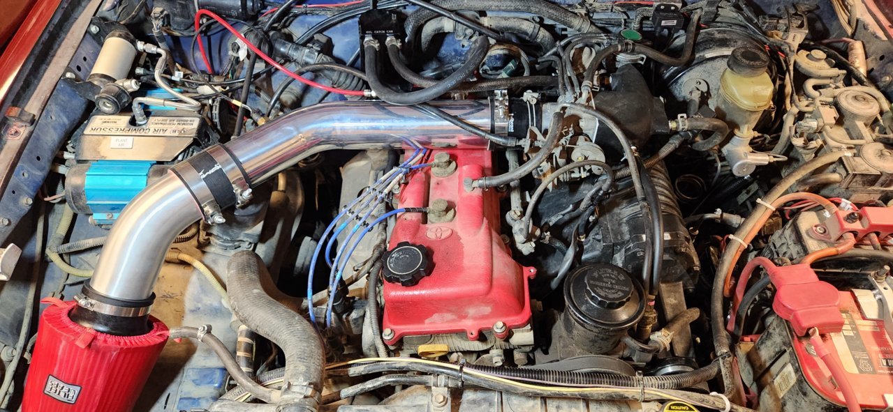

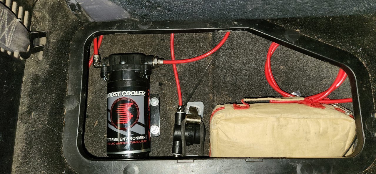

    Installed a water meth system and made my own intake

    Mine use about 5ft of nylon hose, that's it. Super short and simple. No crazy run

    where's your tank mounted

    All in the engine bay
