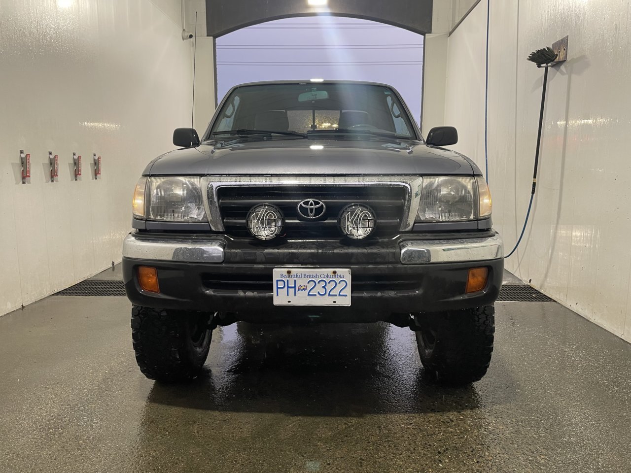

    Replaced the Grill, Front drivers side chrome end cap, headlight, and turn signal.IMG_3522.jpg

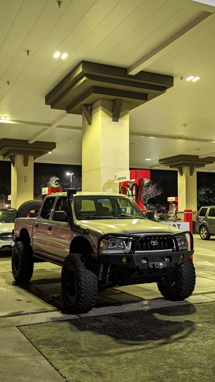

    She's ready for the lakebed! I've still got to pack, but Hammertown Bound on Sunday!

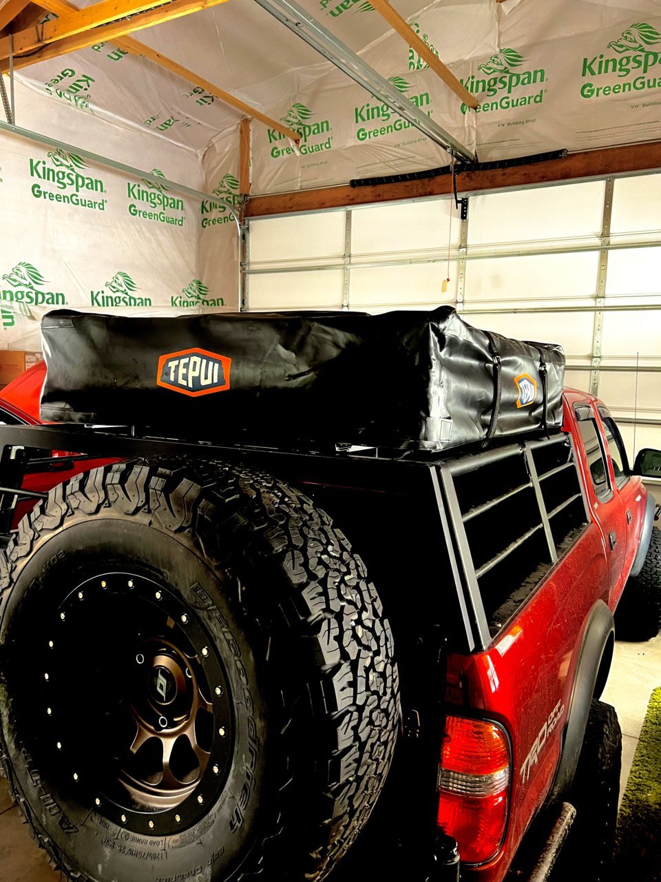

    Slowly rebuilding my burnt empire I scored a new tent at 50% off. Love a good deal. Haven’t been out on the trails for a year or so. I’m way over do!!68F8597D-3868-44A2-8BA4-2D913C3645B2.jpg
