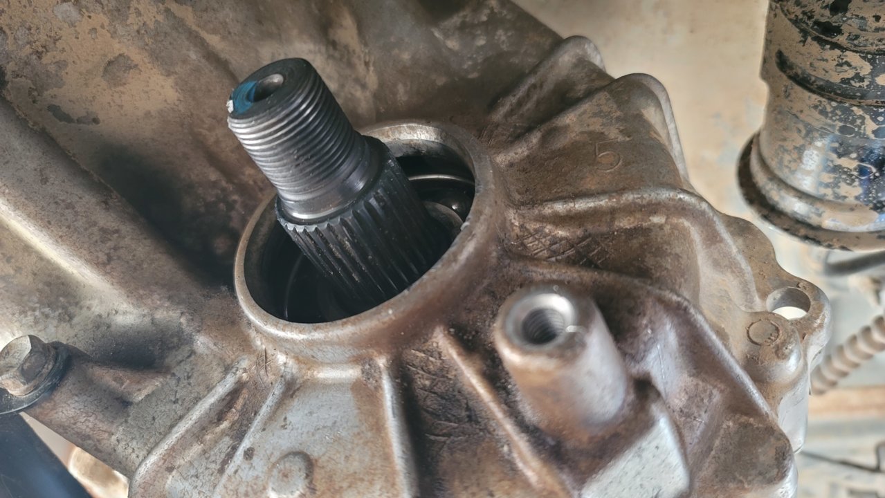

    Front output shaft seal leak fixed.
    Took a couple hours taking my time.
    20230219_115548.jpg 20230219_125523.jpg 20230219_125533.jpg 20230219_131304.jpg 20230219_132605.jpg 20230219_135811.jpg
    Realized I mixed some redline gl5 and gl4 into my tans and now my transfer case as well.
    Anyone know if it will be ok or if it's going to need to be drained and corrected? Oversight on my part sadly. Order this stuff online since noone local carries it.
    EDIT:
    Looks like the transfer case can handle either gl4 (mt-90) or gl5 so mixing it won't be an issue.
    The transmission I will likely drain since I was reading there is something in the gl5 that will mess with the brass in the trans. Its a bran new rebuild so im not going to rush the fluid swap but if the skid comes off ill likely drain it. Back to the pure mt-90 gl4. I'll hang on to the rest of the redline gl5(75w90 for my differentials)
    Anyone have any thoughts or insight?
  18. Feb 19, 2023 at 3:28 PM
    Fantastic11
    Fantastic11 Well-Known Member
    Feb 9, 2021
    #355606
    264
    1997 3.4L 4WD / 1996 3.4L 5-Lug
    GL-5 is supposedly harmful to brass components, but it seems to be somewhat debated over. The FSM says to use GL-4 or GL-5, so it can be confusing. I use GL-4 just to be safe.

  20. Feb 19, 2023 at 3:31 PM
    erice
    erice Well-Known Member
    Nov 9, 2014
    #142008
    1,084
    Eric
    San Diego
    Cool. That kind of confirms what I also read. Edited the post with that info also. :thumbsup:
    Fantastic11[QUOTED] likes this.
