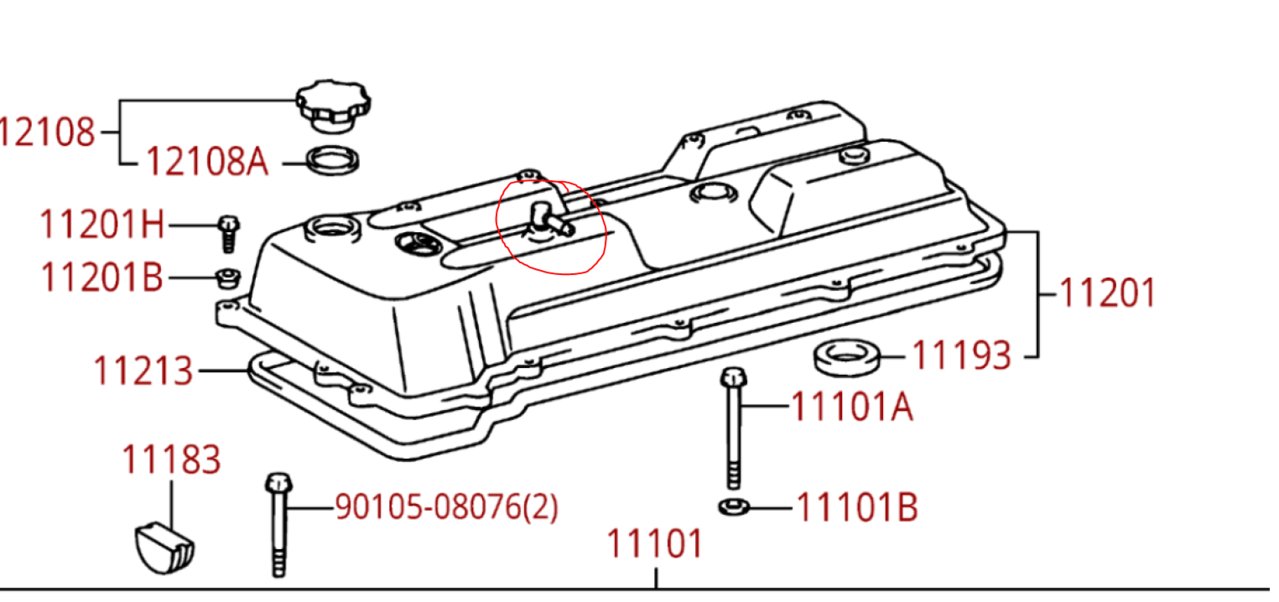

    Got the valve cover back from getting cleaned up... realized I may have messed up with one of the pcv's or whatever it is. Does anyone know what this part is? Can I just plug it and call it a day? Got thrown out and I'd rather not cannibalize it from my current cover.

    that's one of the PCV vents that goes to the throttle body. Never tried taking it off. Not sure how it's attached to the valve cover.
    You could plug it, just make sure the other PCV valve in the rear still works and is plumbed so there is still a vent. Also cap the throttle body side of it.

    They're press in, Radium makes some aftermarket ones but I've never tried them
    http://www.radiumauto.com/10AN-Male-Press-In-Fittings-Toyota-Valve-Covers-P1346.aspx

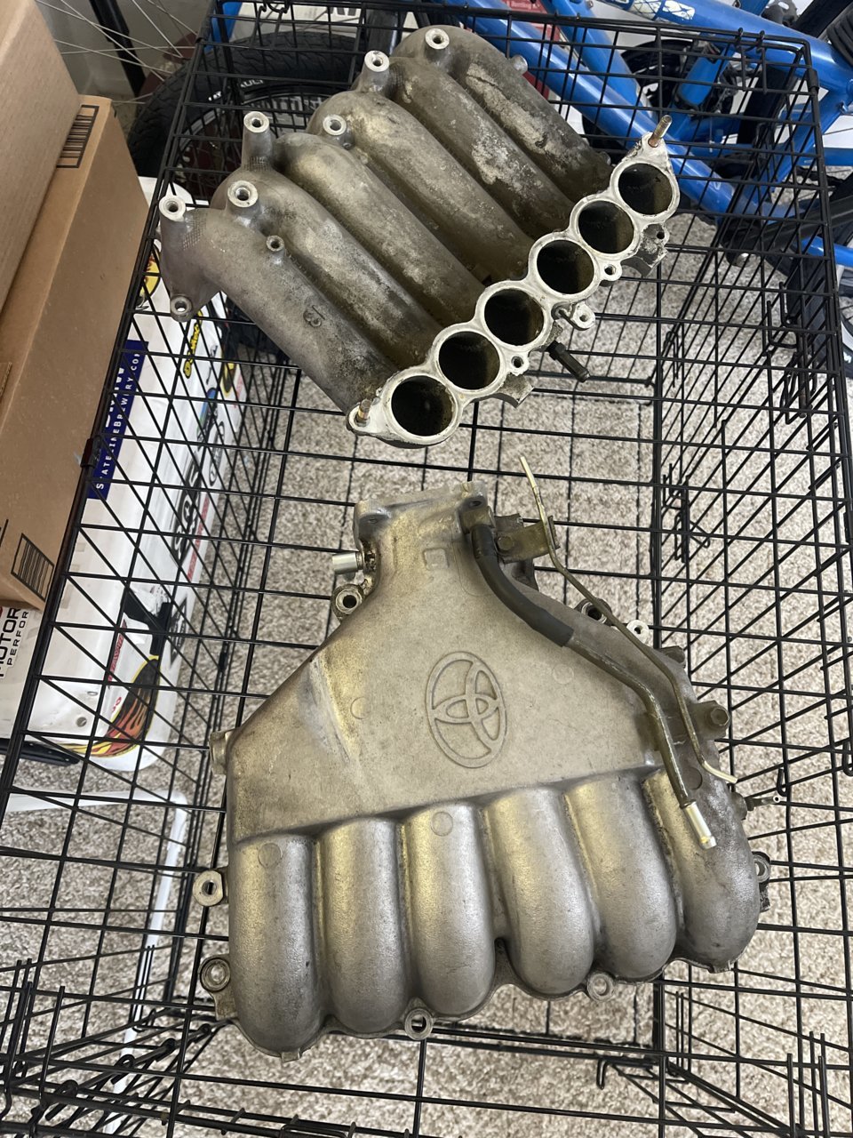

    Picked these up today for dirt cheap. Planning on either painting them some sort of black or maybe micro polish if I can learn how to. Open to ideas too. Whenever I do finish I’ll have some intake plenums up for sale in bst.

    Been thinking about painting intake and valve covers TRD colors

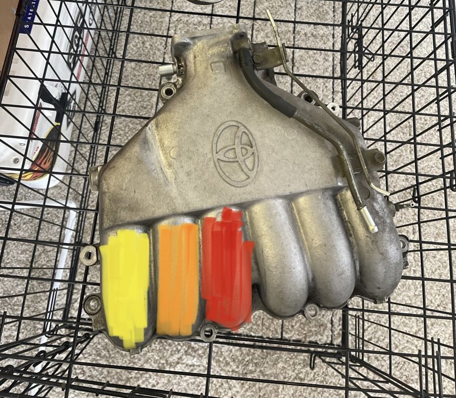

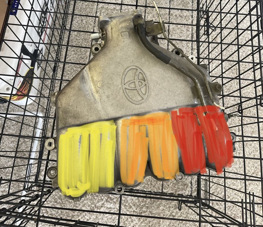

    Something like this? Also I never excelled in arts and crafts..

    1st one with the rest of it white

    You can also just vent the valve cover to atmosphere with a small filter, and then cap the throttle body side.

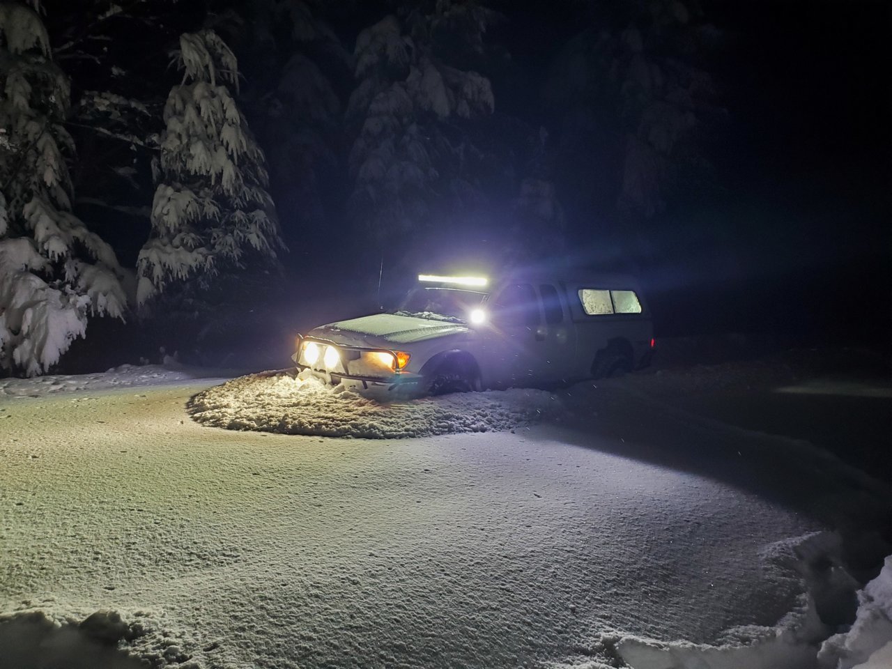

    Pretty fun little day trip last Saturday.
    First, real, shake down of the LT and dual cases. Everything functioned well. And got to spend some time with good friends.
    https://youtu.be/gq9xNy1qOW4

    There's some photos of that already done if you search goggle 5vzfe plenum paint
