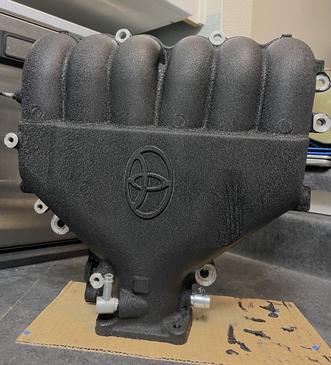

    was that out of a rattle can? looks good.

    That turned out clean af. My man!

    Yup
    Thank you sir!

    looks good!
    link to the rattlecan please

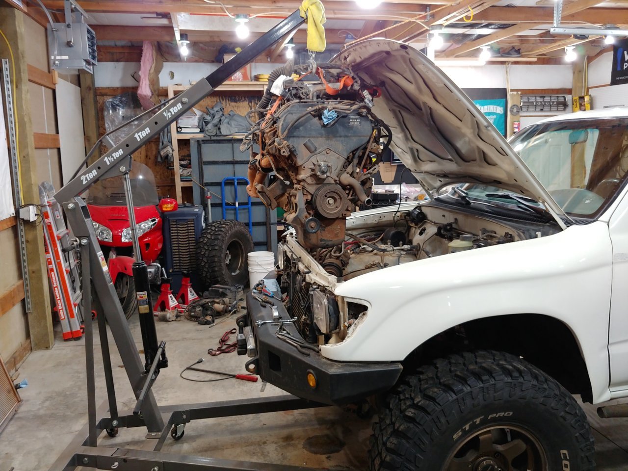

  5. Mar 4, 2023 at 9:09 PM
    Speedytech7
    Feb 20, 2014
    #123587
    58,510
    FCQM+VG Cheney, Washington
    It's less Tacoma and more mod

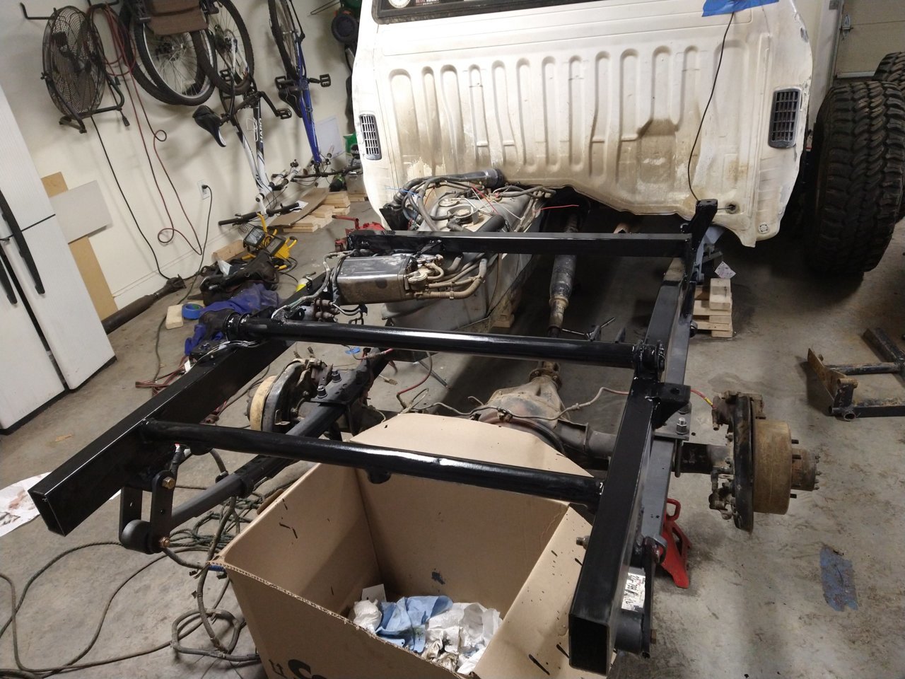

    Yanked the ol engine out for a reseal, turbo drain bung, repaint frame rails, gusset coil buckets and engine mounts, replace diff, and change clutch. She's gonna be nice and fresh soon.

    Thanks! Your closest orielly autozone or Napa

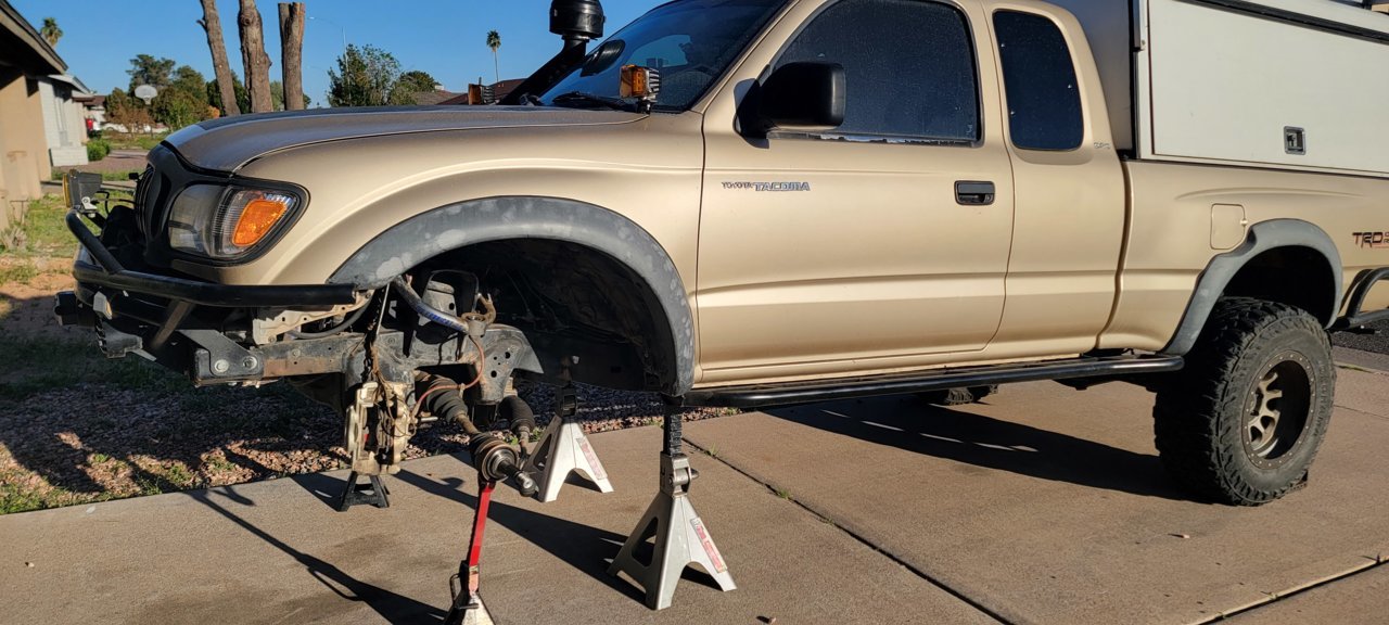

    I asked elsewhere too but....
    Doze anyone happen to know what tap size to use to chase the treads out of the steering knuckle for the lower ball joint bolts?
    Also I painted the frame a bit to cover up some surface rust.
    Before
    and after, many do a second coat.

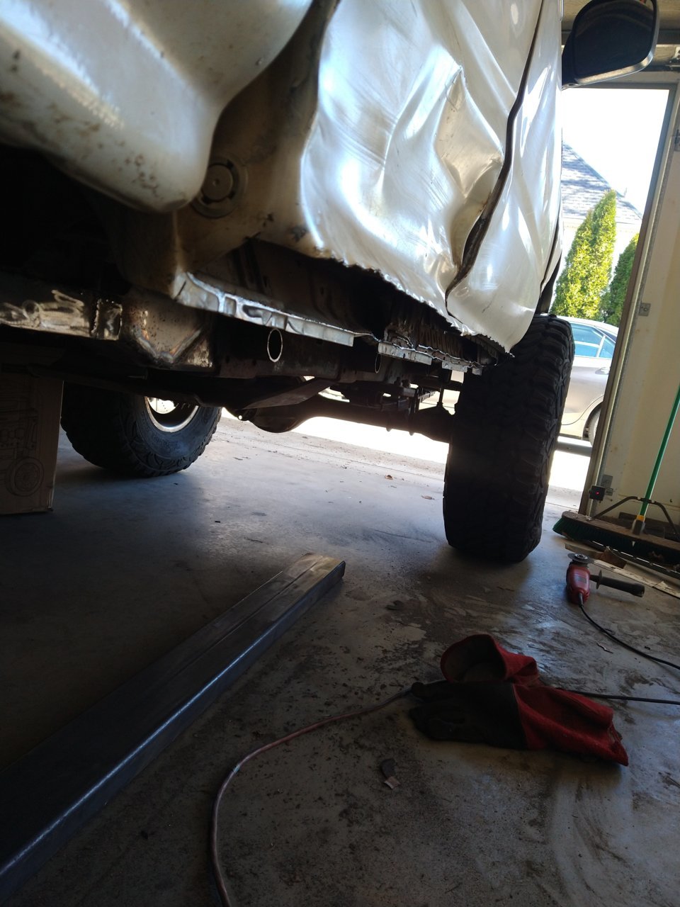

    New sliders today. That's 2x5 x 3/16 box tube welded to the cab.

    M10x1.25

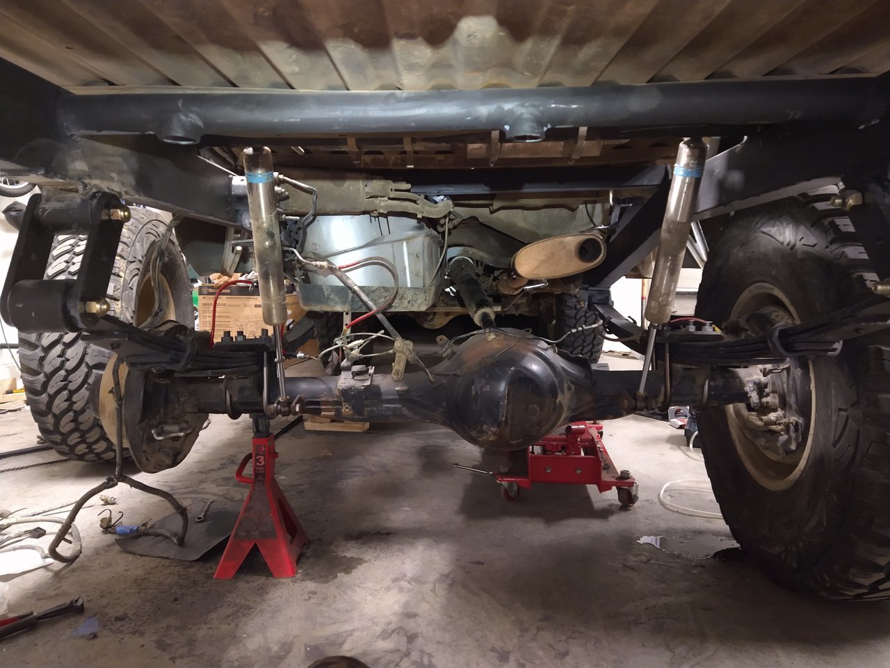

    12" 7100 short bodies inside the frame with the shock tabs at the mid point on the axle:
    They are leaned back about 30* and jammed up against the bed but pretty easy to fit them under there. I was always under the impression that 12s had to go through the bed, but nope.
    The middle crossmember is where my shock mounts are. Granted those are custom frame rails, but they are built to the stock Tacoma frame measurements, it just doesn't do that weird hump but not really over the axle.

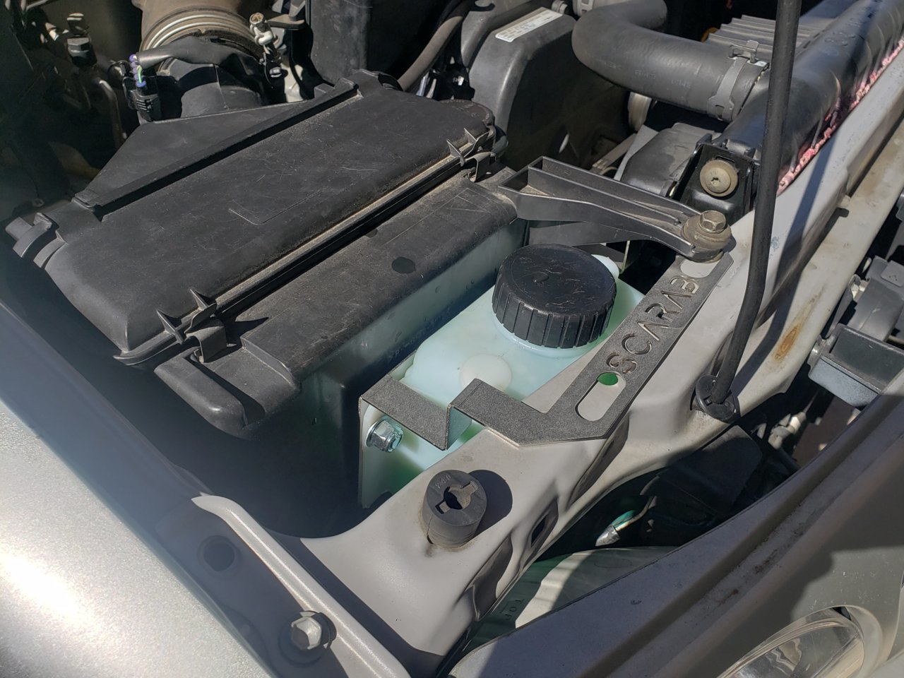

    I can’t really get it to move much further before lifting the other tire off the ground. I’m not sure on my bumpstop height, I’ll have to measure them.

    Yup black. I found the upper and lower plenums for dirt cheap on offerup and they were pretty dirty. Soaked them in the sink with hot water mixed with some dish soap and simple green. Took a wire brush and scotch brite pads to it as well as some leftover engine degreaser. Thoroughly rinsed with hot water then rubbed down with 70% isopropyl alcohol.

    Finished rebuilding my upper control arms. Ran the tap through the holes and had to test fit the new joints.:rasta:
