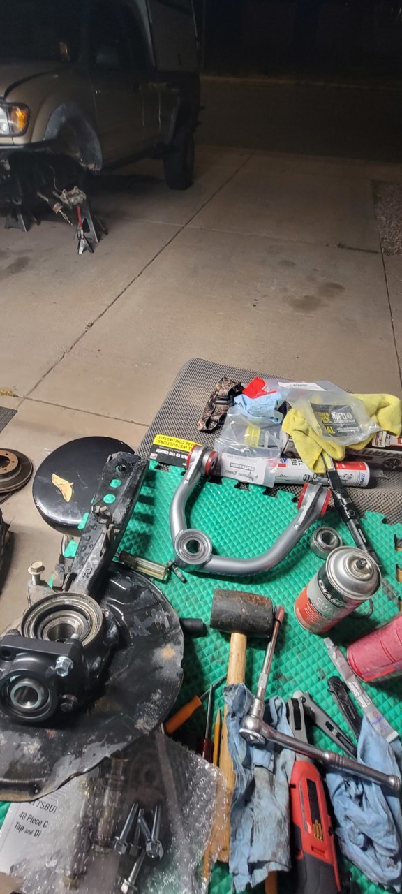

    Finally, I changed out the front brakes on the Taco. I installed Stop Tech slotted rotors, pads, break lines and brake fluid flush. The difference from stock is definitely noticeable, of course. Excellent product and have used Stop Tech on plenty of my cars over the years. Now I can bring the 142hp, (maybe), truck to a stop safely on those high speed runs. This weekend the upgrade is from stock rear drums/shoes to Stop Tech full rear drum/shoes kit!
    Aiming to outbreak GT500's, Hellcats and all exotics.............bottom line is, the breaks are done and off the to-do list.

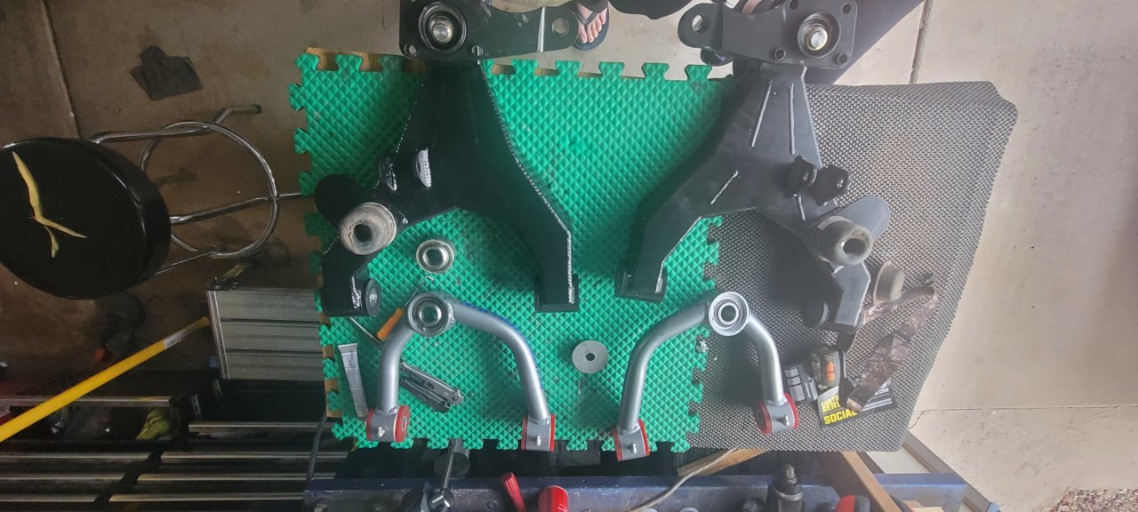

    What lbj replacement is that? Looks super beefy.

    It's less Tacoma and more mod

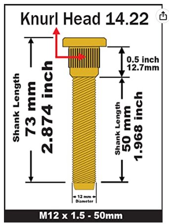

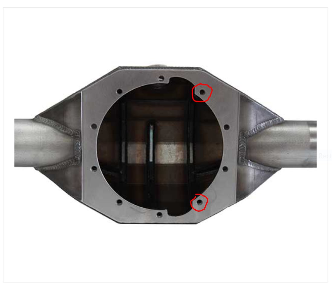

    So... Here's the next item that comes up to make my projects a pain in the ass.
    I swear I cursed with this shit.
    So... here's the problem. I honestly hadn't even given this part much thought until now. I set about sourcing mounting hardware, to mount the third member to the axle housing. I originally assumed it would be threaded for M10 x 1.25 bolts, like Land Cruiser housings are supposed to have. But I found the holes to not be threaded. So, I pulled out some measuring devices to see what I'm working with here. The holes are the same diameter as what is on the 3rd member (allowing an M10 x 1.25 bolt to pass through)
    :frusty:
    Well... this is a problem... Because if it is big enough for an M10 to pass through it, it's too big for an M10 stud to be threaded in to it. (was actually going to use grade 12.9 allen button head bolts from the inside, but either way these holes are too big for M10).
    Ok... so I figure how bout M10 wheel studs. Well, the only M10 wheel studs I can find have a knurl of 10.2... which doesn't press in these holes either (still too small). The knurl needs to be a larger diameter. AND the holes, circled in red, need a minimum of 50mm length bolt due to the 3rd member... the only M10 wheel studs I am finding are about 29mm long. (you'd be surprised at what a pain in the ass it is to find actual dimensions for wheel studs).
    So, I called Ruff Stuff. And of course they don't sell the hardware I need for this. Because of course they started taping these holes for M10 x 1.25.
    Ruff Stuff pointed me to a website that sells the wheel studs in both the lengths I need, And they also happen to have the knurl diameter these holes were drilled for... I called them... And of course they are a Wholesaler and can't sell anything to me. They gave me a number for a vendor they sell to, hopefully they can help.
    If they can't help me:
    - I may need go down to the local Can Am dealer and see what they have for wheel studs (they should have M10, but everything I find for side by side wheel studs has shit for dimensions)
    OR
    - I'm considering M12 to M10 step studs and thread the axle housing to M12 stud. (not sure I'll be able to find the right lengths on these)
    OR
    - I may have to thread the housing to M12 and drill out the holes on the 3rd member to M12 diameter.
    None of these options sound like what I really want to do here.

    Can't use 12.9 Flange head M10 bolts from the inside and tack them? Seen that done with other housings. Other option if the holes aren't too big is to helicoil them for M10

    I have thought about tacking them. I don't think I'd trust a 3rd member riding on Helicoil.
    I'm also pondering welding around M10 bolts, where the knurl of a wheel stud would be, and seeing if my neighbor (a machinist with a lathe) can turn them down to a snug interference fit (essentially making my own wheel studs).

    Helicoil (as long as the material is tapped properly for them) are usually a stronger connection than the base material into just a bolt alone. When I worked for the machine shop we would routinely tap materials for a helicoil instead of the bolt directly just for the extra strength.
    http://crosstools.com.au/helicoil-type-inserts-technical-study-of-strength-and-pullout.html
    But tacking a 12.9 inside probably work just as well here, depends on what kinda work you want to put into it. Can't deny tapping 10 holes into 3/8 plate isn't a small job, especially by hand haha.

    Just a little bit. I think I got the last pair for the moment as there now out of stock.
    They are pretty beffy.

    Actually. Now that I think about it. I think I may have not been picturing this the way you were meaning.
    Helicoiling the axle housing - and then - using a bolt from the back side, may be the easiest fix to this. When you said helicoil, I was picturing studs in the axle housing. The reason I was leary of that is studs already pose a problem with stripping and stretching. I get that helicoil makes a stronger connection, but I was just thinking adding in another layer to that mess is asking for it.
    BUT... If I helicoil and then have the bolt heads on the inside of the housing, That may just be the ticket here.
    For sure... taping in to a 3/8 plate is not my idea of a party.

    What is the size are the holes drilled to on the housing? Going to a larger bolt hole will not hurt and will increase clamping force (with nut) on the 3rd member which is a good thing.
    I'm thinking something like this would work.
    Then the only holes that would need to be tapped are the very top/bottom due to the stud length and not having enough room/interference with the back of the housing. And for those you would just thread in bolts (after tapping) from the diff side.
