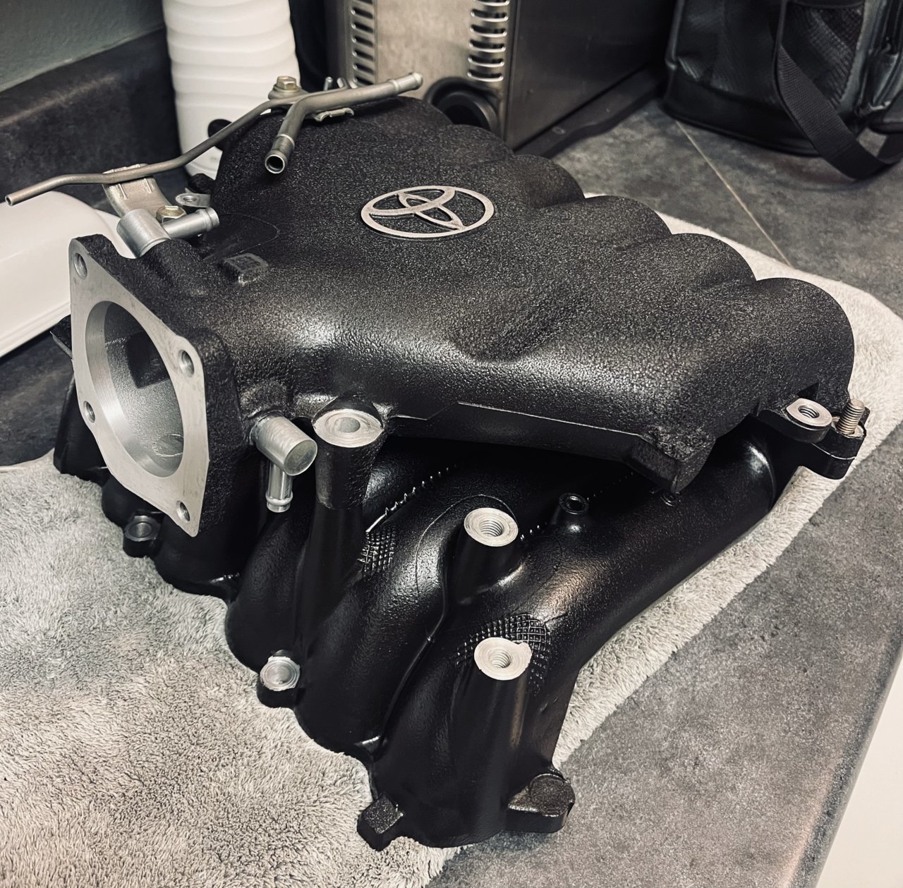

    Finished up. Install Saturday hopefully. I’ll take some sort of paint stripper to get the last little bits of paint on the emblem that the sand block couldn’t get.

    I do have leftover paint lol. I’m almost thinking about doing the same to the plenums that are on my truck now. Maybe keep the ones I did a better job with and sell the other set.

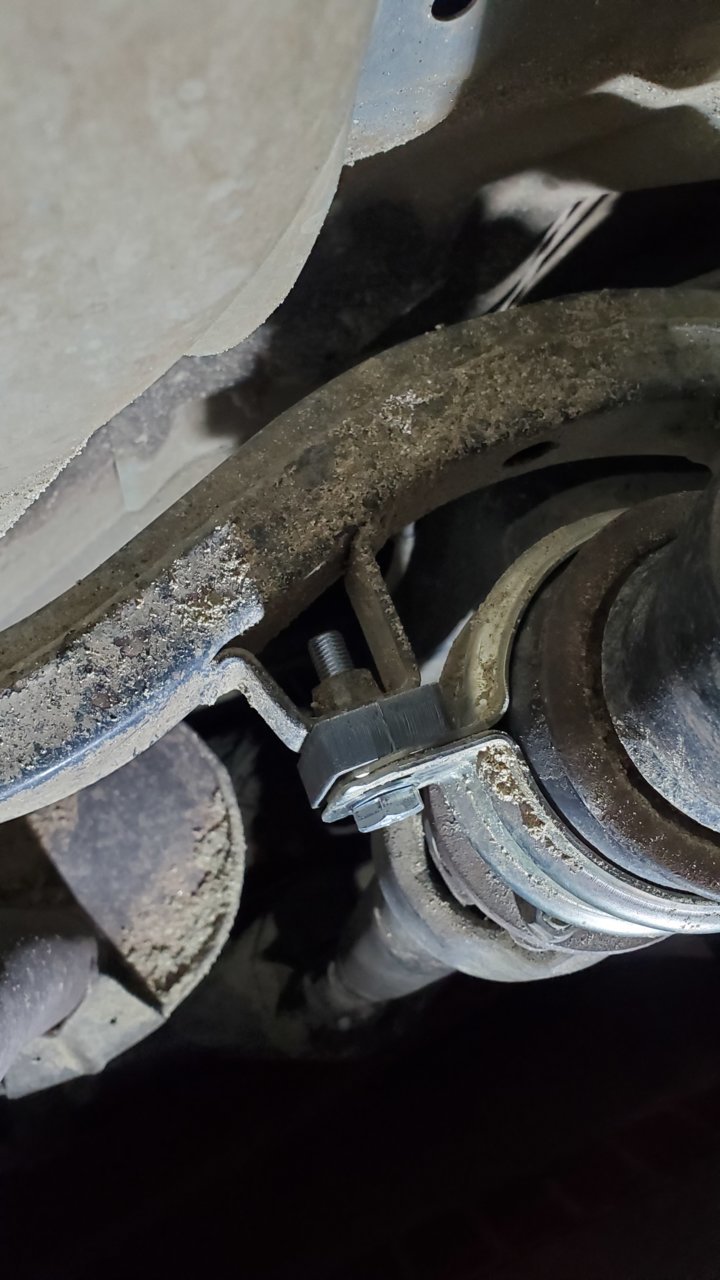

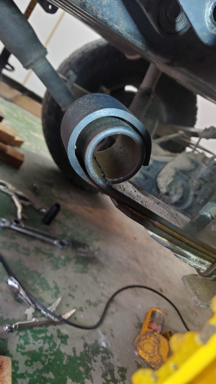

    I changed out the crappy rubber front eye bolt bushings in my dakars. They were already shredded and the vulcanized rubber was delaminating after only 3 years. What a pain in the ass of a job. Thought it would maybe take me a few hours, the bushings ended up fighting me for a day and a half. It does feel as though it has less axle wrap now though and seems like it can't move as much side to side with the poly bushings.
    I also added a carrier bearing drop from trail gear to hopefully reduce some driveline vibes I've been having.
    And I ordered the wrong ARP bolts to swap out for the LBJs, I got the 30mm bolts, but read from @SpikerEng that they don't have enough engagement if you're using the washers, so time to order the correct 35mm ones this time: 673-1004

    The 35 mm bolts would be my first choice too, they have better engagement than the 30 mm bolts. Just be sure to use the ARP washers supplied with the bolts.

    And just to clarify your tests were done without the dust boot? I'm not running one so wanted to be sure. Thanks!

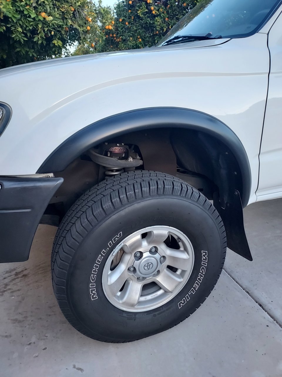

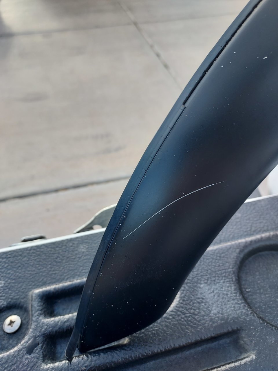

    A few months ago I spilled gas on my rear fender flare and it destroyed the paint. In addition the rubber trim between the flare and the body was rotten and falling apart from age, so I decided it was time to freshen up all four fender flares as part of my 25-year classic plate refresh.
    The flares came off easily, just 5 or 6 screws holding them on. I washed them down with detergent and wet sanded some rough spots with 400-grit and cleaned them up the best I could.

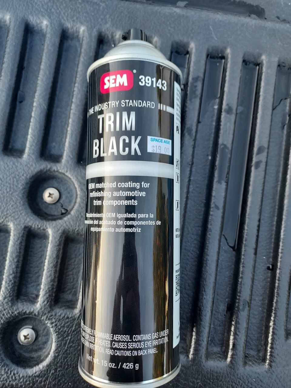

    Hit them with some expensive auto store spray paint. This stuff worked really well in light coats and dried really fast. The finish is exactly like the original. My painting skills aren't great but it looks great to me.

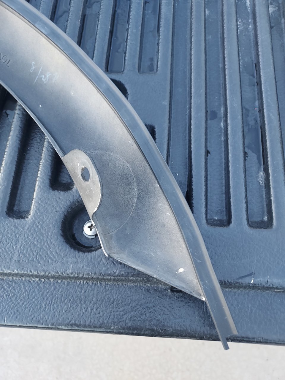

    The OEM gaskets are peel-and-stick, very easy to apply. I hit them with the heat gun for a few seconds on medium heat to soften the adhesive and hopefully get a stronger bond.
    Bolted the flares back up and they're good as new! (Still need to fix that saggy valance)

    What's the part number on the OEM gaskets for the fender flares?

    I have been looking for the same part. This is the closest I could find. I’m not sure why it’s only specific to the rear.
    75696-35020

    1998-2000 Tacoma fender flare pad part numbers:
    Front: 53851-35061
    Right Rear: 61783-35071
    Left Rear: 61783-35091 (has gas door shape)
    Sorry to say, but they're expensive. List is $28 each, I paid about $22 each.

    Great find thank you! The fronts work for me when I use the 02 year filter, but the rear part numbers were nondescript when searching the 02. I’m not sure what changed over the years from the 98-2000. I will probably give them a try nonetheless.
