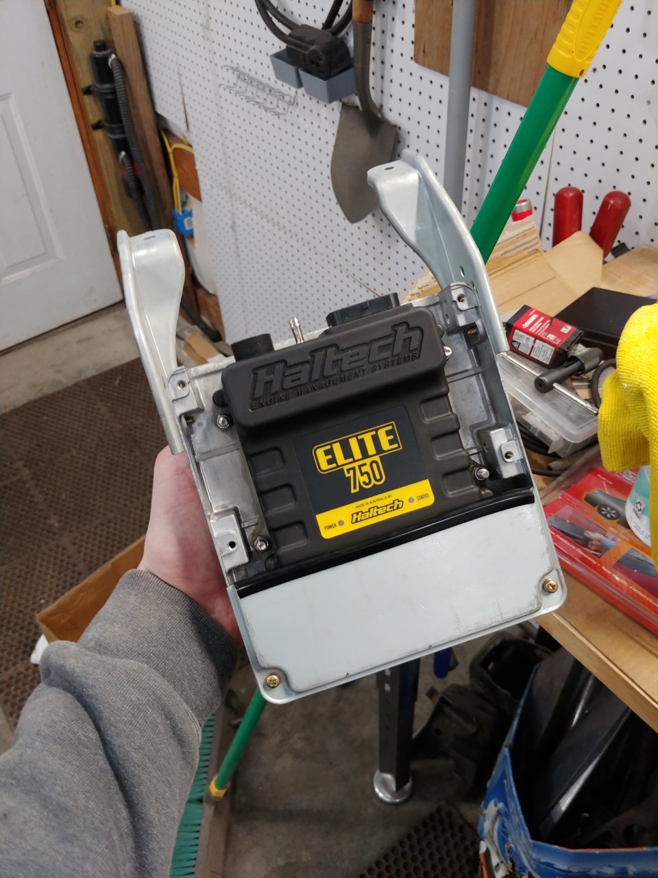

    Nope, can't on a V6 unless you want to use batch fire injection and sacrifice a digital output for another coil pack. They discontinued the 2000 which was perfect for V6 builds, sometime in the future I'll probably upgrade to a Nexus R3

    That's the beauty of the Haltech, just repin the connector and run a different one. Once this setup is proven I'll go for the R3, I'd like to have the PDM in it anyway. In the meantime the 750 along with the ic-7 dash display as an I/O expander is going to be plenty and get the job done.

    Can't take credit for that one haha, Dave from Haltech AU even says, there no downside to starting small and working up. They have guides to repin your connector to the dual connector style and he says there will always be someone on their forums or the Facebook group that wants to buy your used Elite 550/750. It's as simple as loading your old tune into the new computer and changing the wire allocations and it will run like it did before.
    I've looked at some of the other dashes and none have caught my eye much besides the classic RacePack. But the Haltech ic-7 when used with a Haltech ECU has some benefits being an I/O expander too. It's like having a dual connector ECU model if you have the 750, you get more sensor inputs.

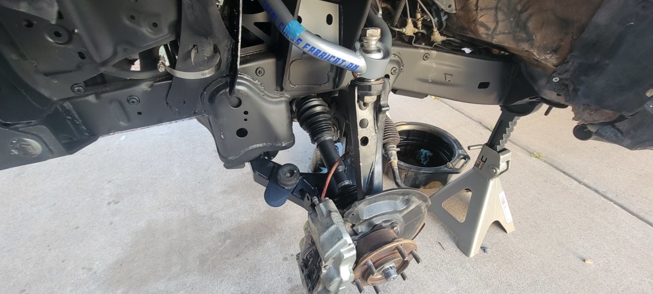

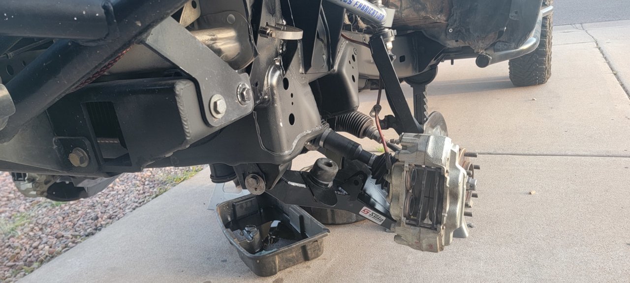

    It was just some light surface rust. So I just washed it and painted over the top with some rustlum black primer with rust prevention.
    Also this is were I left off last.
    Just need to put the coilovers in and torque everything down. But I'm working the next couple days so this is how it's gonna sit unfortunately.
    And... durobumps.com sent me some new updated front bumps, as I may have put the hurt on my old one's. I'll post some pics later, but what a stand up company!!
