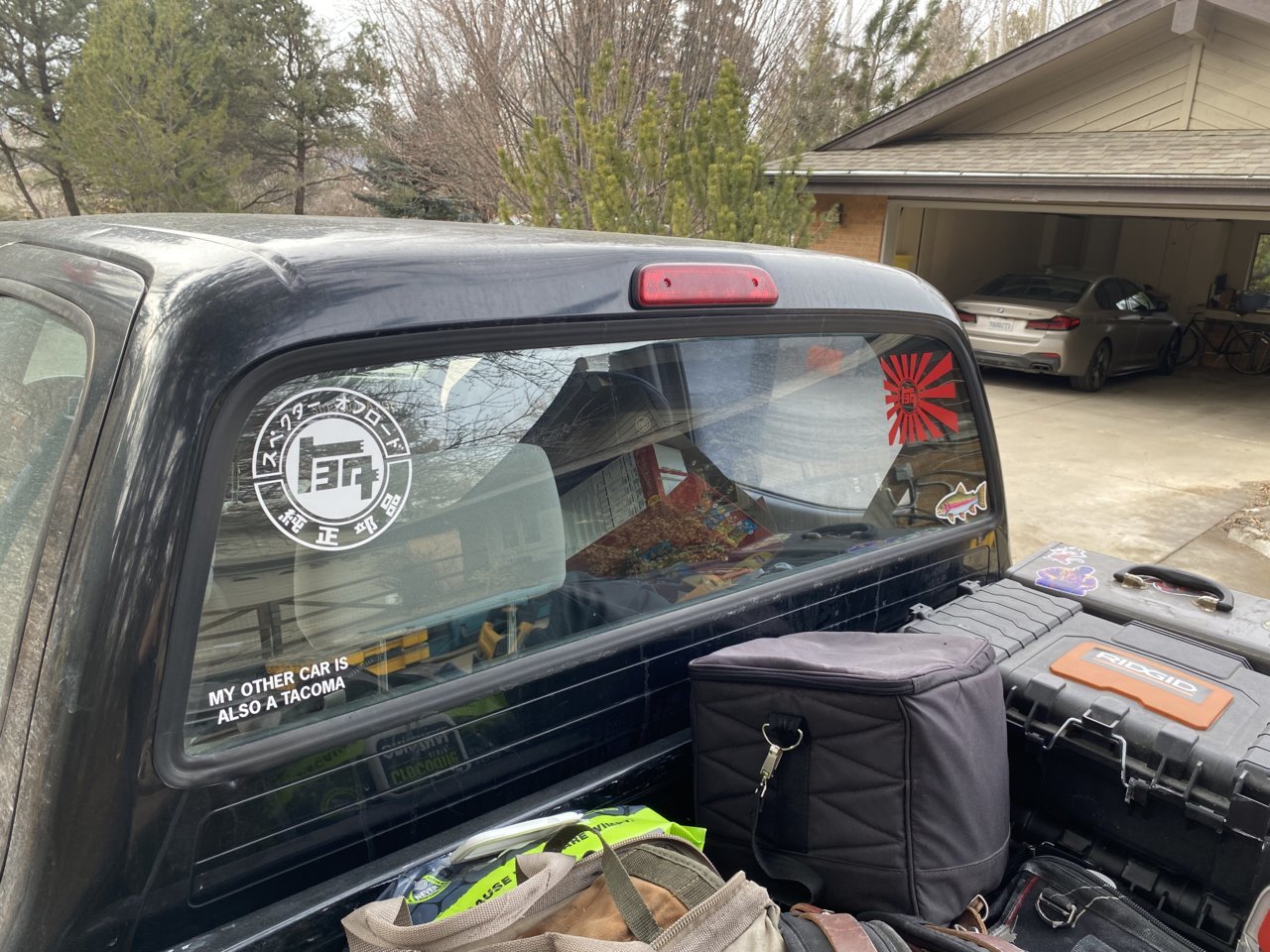

    02B65A26-2C82-4FA3-BB64-39A06C3ABD96.jpg Needed a sticker refresh

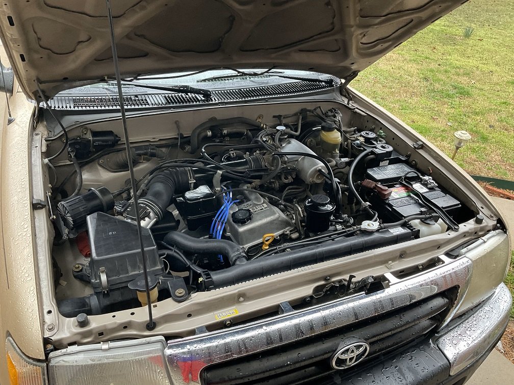

    Finished well overdue maintenance. When we talk about “original”, I’m pretty sure some of the fluids and the spark plugs were original from when this truck was built. Runs great, still needs a few tweaks.

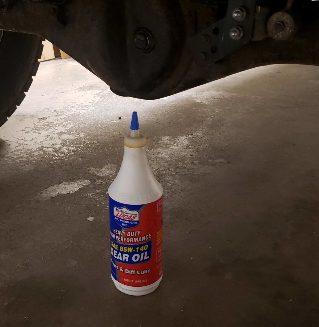

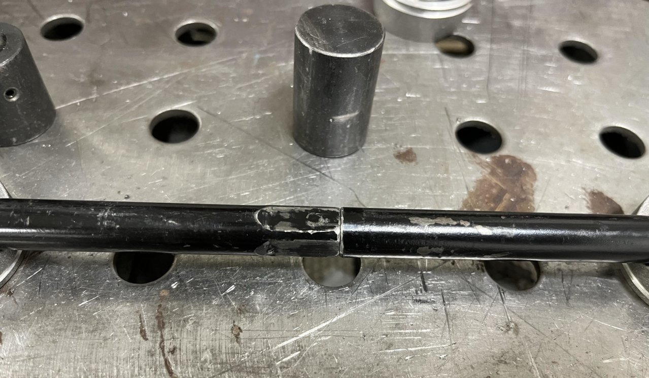

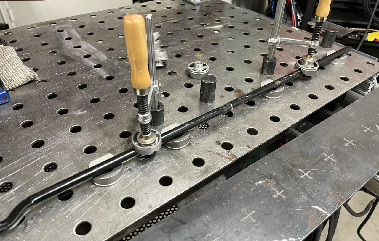

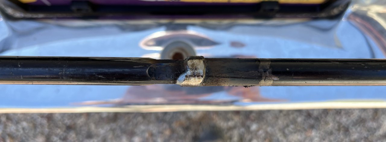

    World's smallest project for the 1Gen.
    I wanted to drop the spare wheel and struggled to push the 3-part factory tool through the rear opening to engage the winch that hold the wheel up to the frame. The joint between the first and the middle part is so thick it wouldn't fit in the small hole under the tail gate / over the bumper. So I cut off the thick connection (the female part) and welded the pieces together. Now I can easily reach the spare wheel's winch.

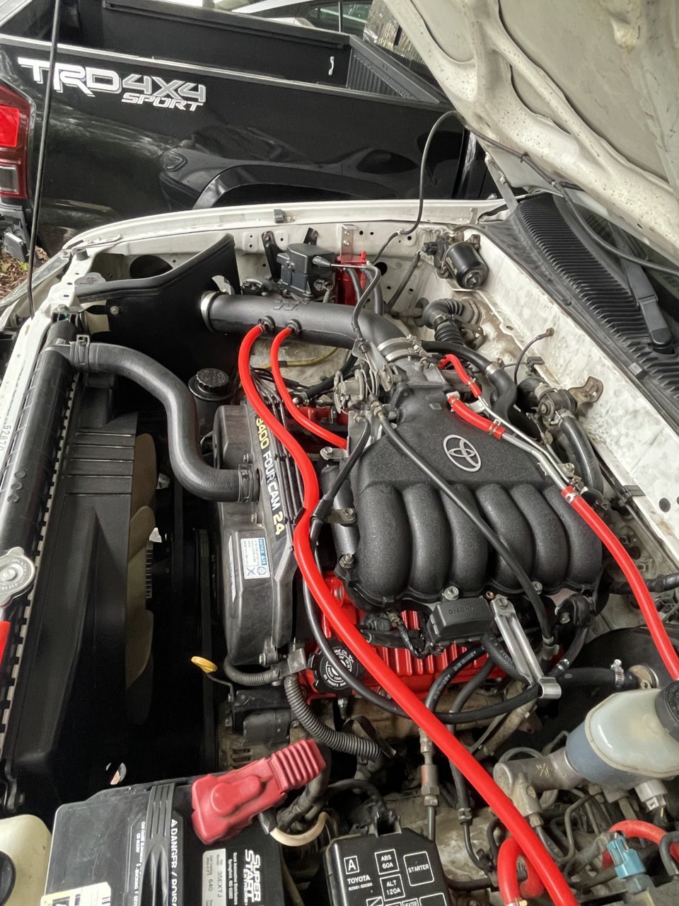

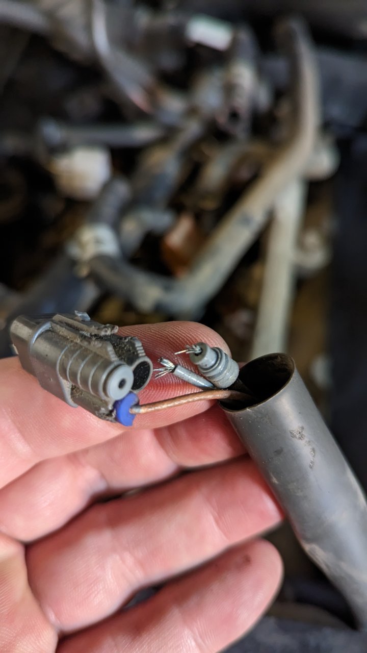

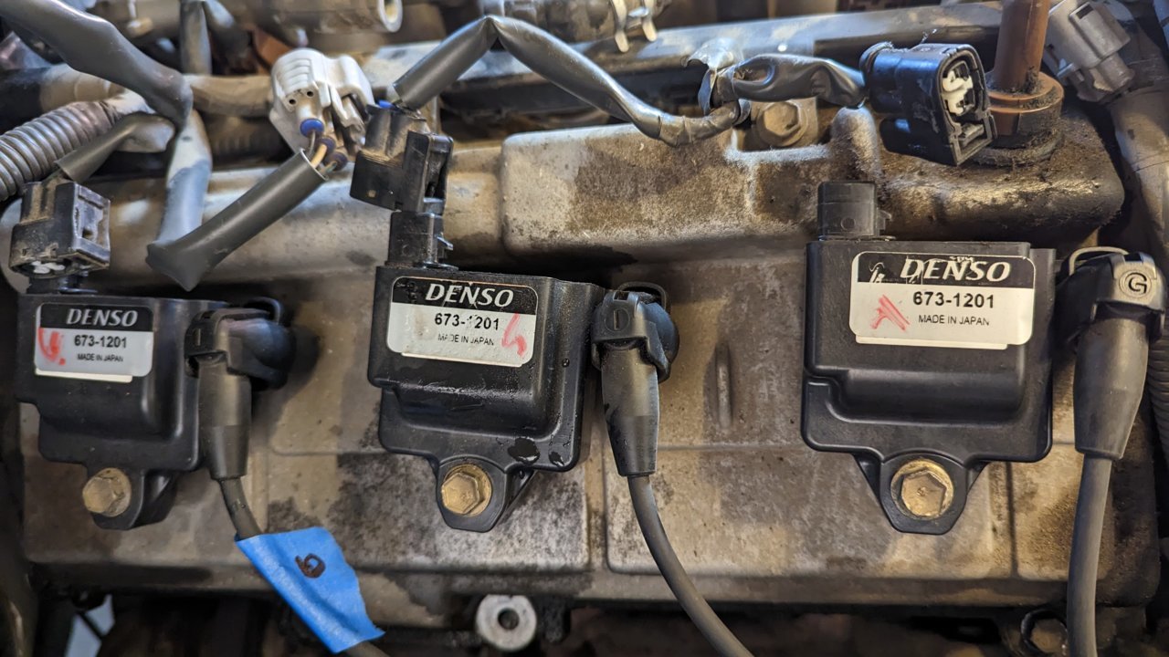

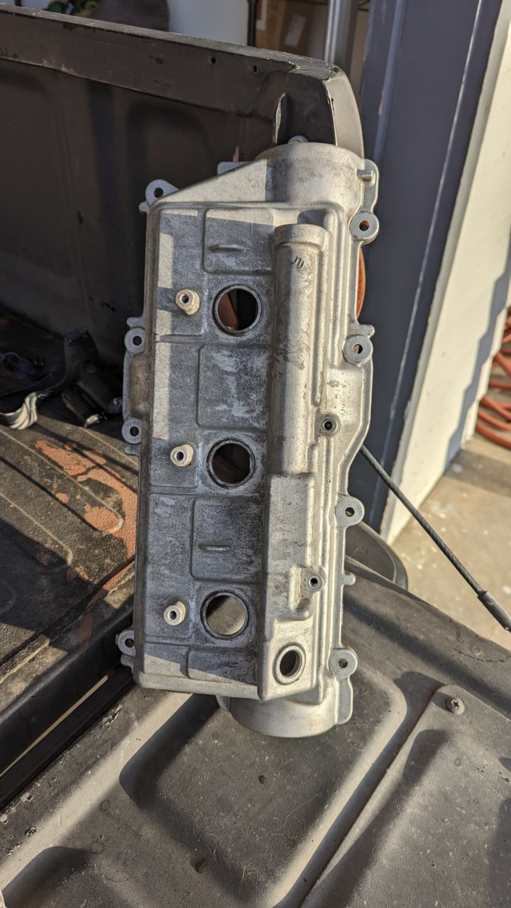

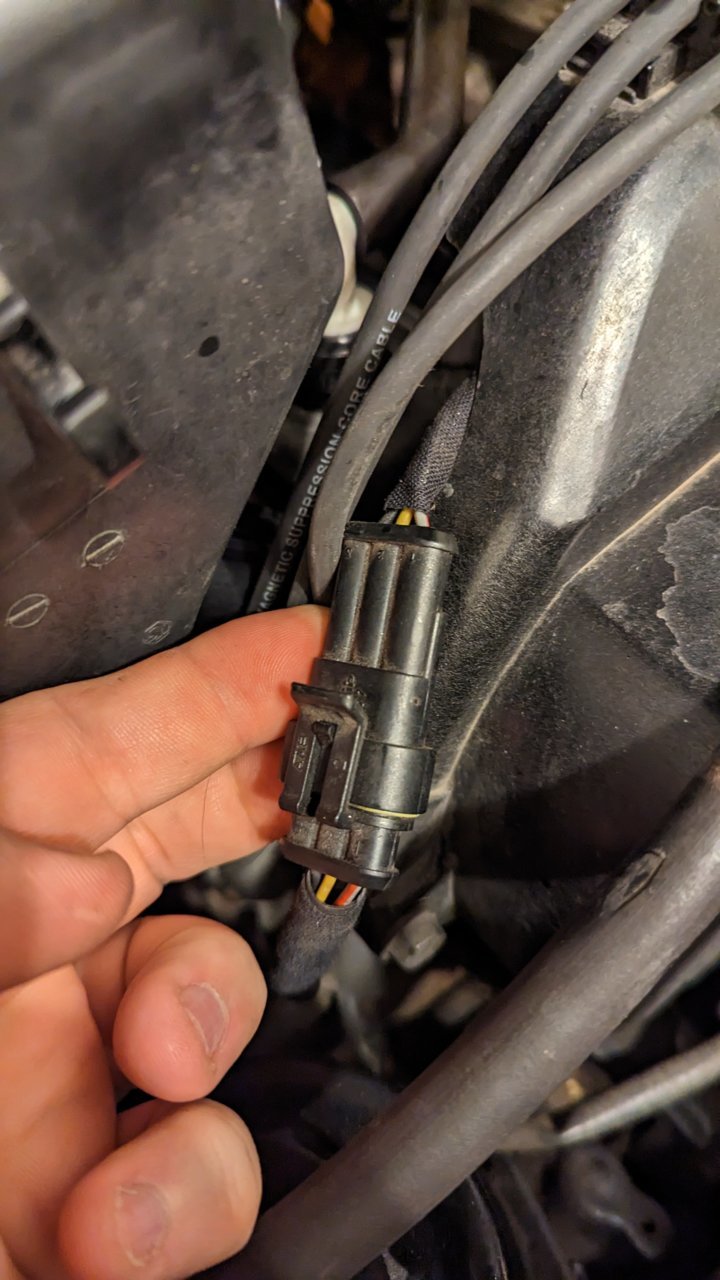

    Changed my valve cover and throttle body gaskets, replaced the half moon seals, and the cam bolts. First time doing it, so took much longer than I thought. Ripped the knock sensor apart so stripped it down and added the tail light harness off my buddies Ducati.
    Some before and after pics of the valve covers themselves as well as the broken knock sensor wire and the Ducati fix.
    Was a good weekend.
