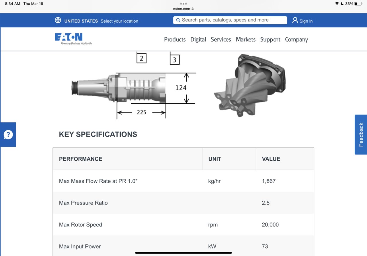

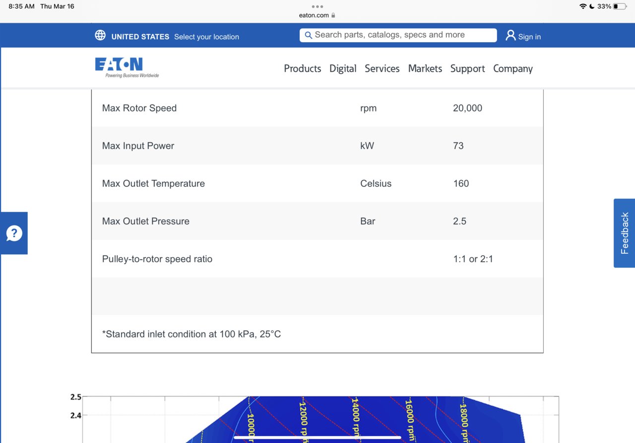

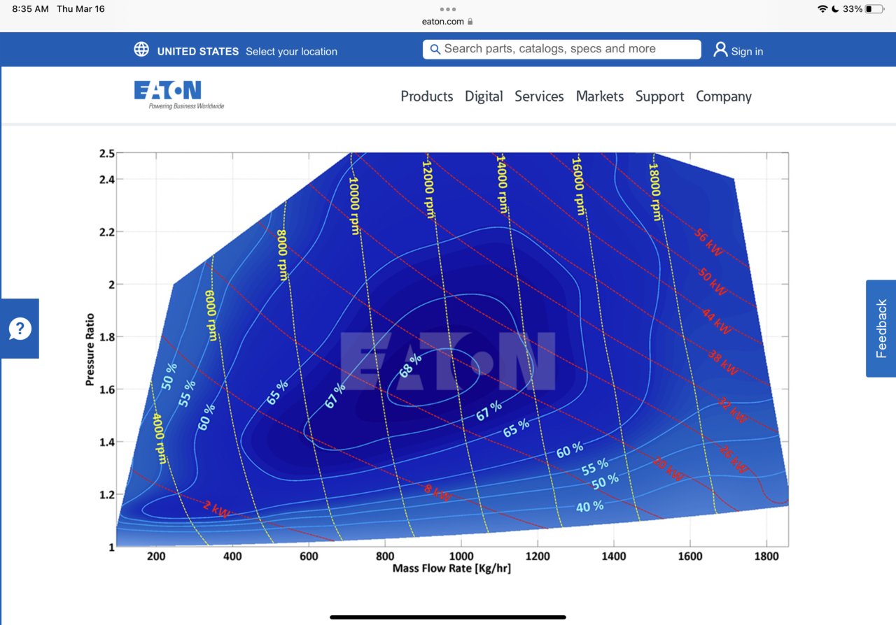

    Ok, good to know, I would like to get close to the 325hp mark but more importantly the higher torque number is what I want.
    I’ve seen other turbo setups and 325hp seems to be the safe spot before special clutches are needed and probably more general wear comes into play with the added power above that number. At my current power level let say 280hp 305 torque the stock components can handle this without any issues and I want to stay in that safe window (daily driver) if possible.
    As you said the parasite loss and improved volumetric efficiency of a 180 rotor twist compared to the current 60 degree will be a lot.
    Can you explain this graph from the Eaton website on the output of the tvs1320? I know it is rated at 20k but we will never see those numbers on the 3.4.
    I don’t understand this graph.
    Is the 68 percent number the most efficient air flow at 12,000rpms?
    Pressure ratio axis? What is this meaning?
    KW meaning? Power to run the supercharger? 1 KW=1.3 hp,
    Meaning at 12,000rpms it’s using 26hp to run the supercharger which seems like a small amount?

    It's kinda like a turbo compressor map, I'm not a fan of that graph you posted cause the units are in BAR, kilowatt, and kg/hr. Very non american units haha. The vertical axis is the output pressure from the supercharger. 1 bar is atmosphere 14.5psi, that's why it is at the bottom, if that graph was in US units it would just be 0psi. That graph is telling you the supercharger is at its most efficient (around 68% efficient) generating 9.43psi of boost spinning around 12k rpm, efficiency stays on pretty decent climbing from there actually, this SC is a lot less wasteful than the old design.

    thanks
    Using 20KW = 26hp to run the supercharger at 12k? 1kw=1.3hp?
    Old supercharger is like 60hp I thought I saw someone post somewhere?
    is that right?

    Yeah at 12k it looks like it would be using 15-16kw (20-21.75hp) to turn it, you can see where it becomes less and less efficient to spin it faster by the parasitic losses incurred. After about 14k it becomes worthless for making power since you're using so much to spin it. But still like I said earlier it's pretty efficient at 9.5psi and the original supercharger was more at home around 6 so that's a pretty big improvement. Whether that's a $3800 improvement or not is up to you.

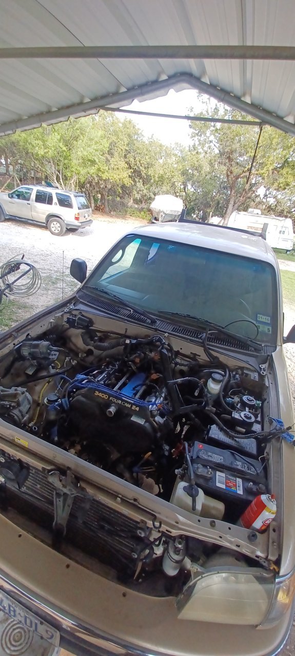

    I got the pig mated. My new to me engine and my mature transmission or together for hopefully a long and happy relationship.

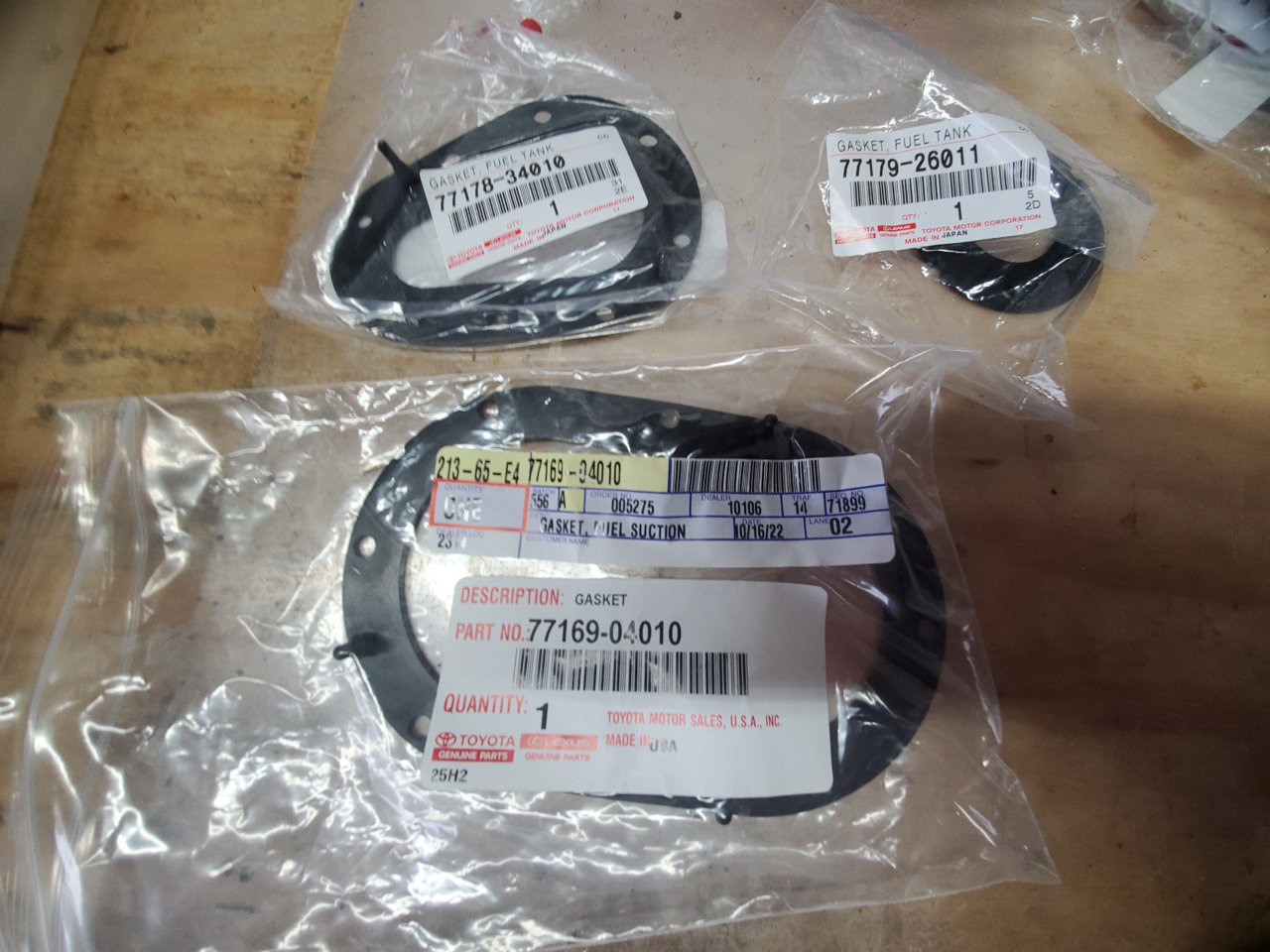

    The gaskets on the top of the gas tank, maybe the fuel pump depending on the age/mileage of the one you have in there. Worth checking the condition of the hoses in the evap system, some of those can be replaced with generic fuel line which is pretty cheap.

    I second this. I would replace any seals and lines while you are there. Most of them are pretty cheap from Toyota. I don't have the evap under the bed on my truck, but I did these 3 on my tank when I had my bed off:

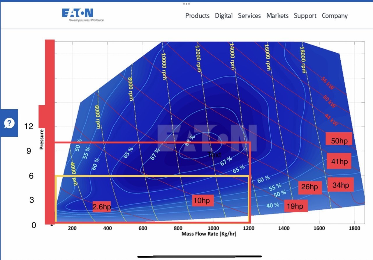

    Ok, so I converted it over to USA numbers so that I can understand more with a 6 pound boost window and a 10 pound boost window and rounded the numbers.
    “IF” I did it correctly it makes a lot more sense,
    Looks like it only needs 10-15hp to run the supercharger in the 6 pound boost area which is huge win!

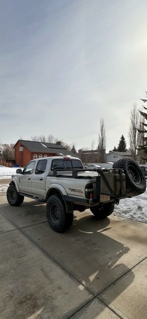

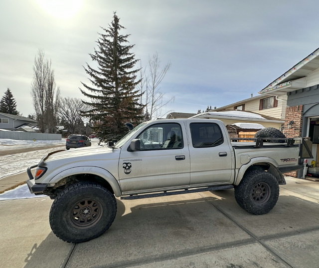

    Yanked the canopy off. Bikini season is here! Mounted up some Kbvoodoo bed bars that I’ve had for a while.
