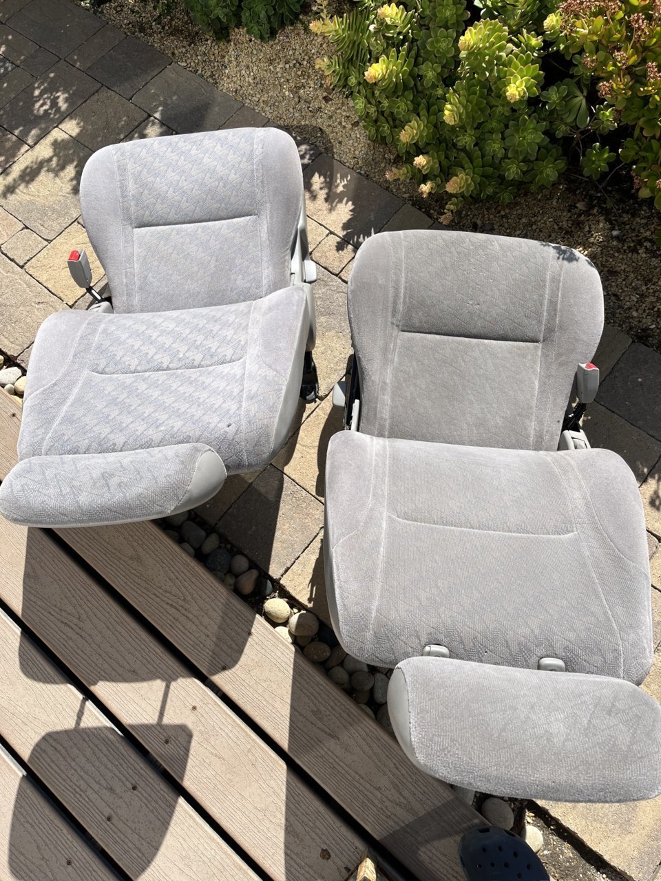

    got a steam cleaner and did the seats before (R) and after (L)

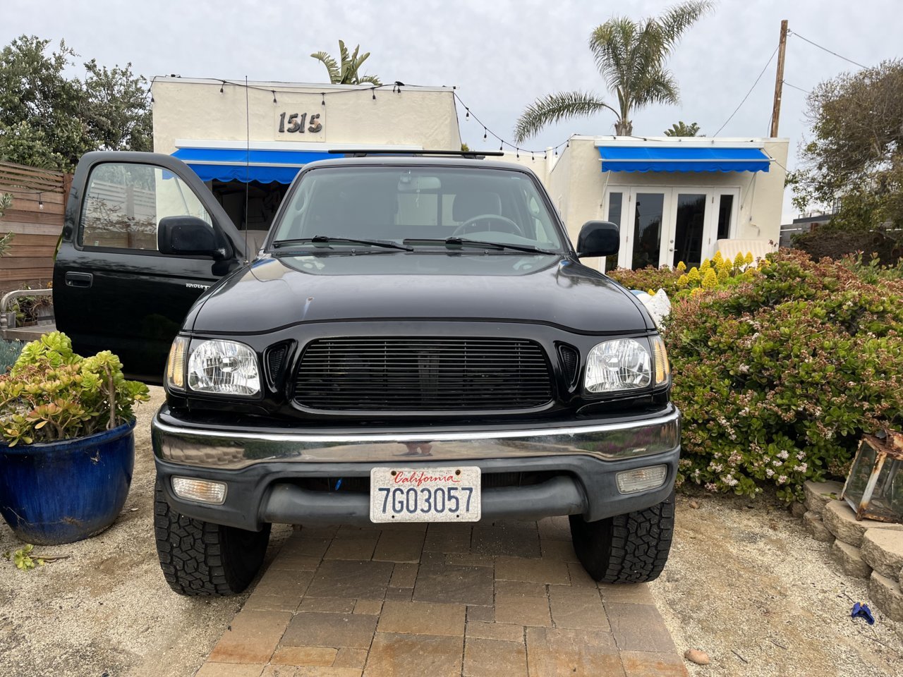

    picked up a new (to me) grille and side marker lights for a whole new look (previously had the chrome stock grille)

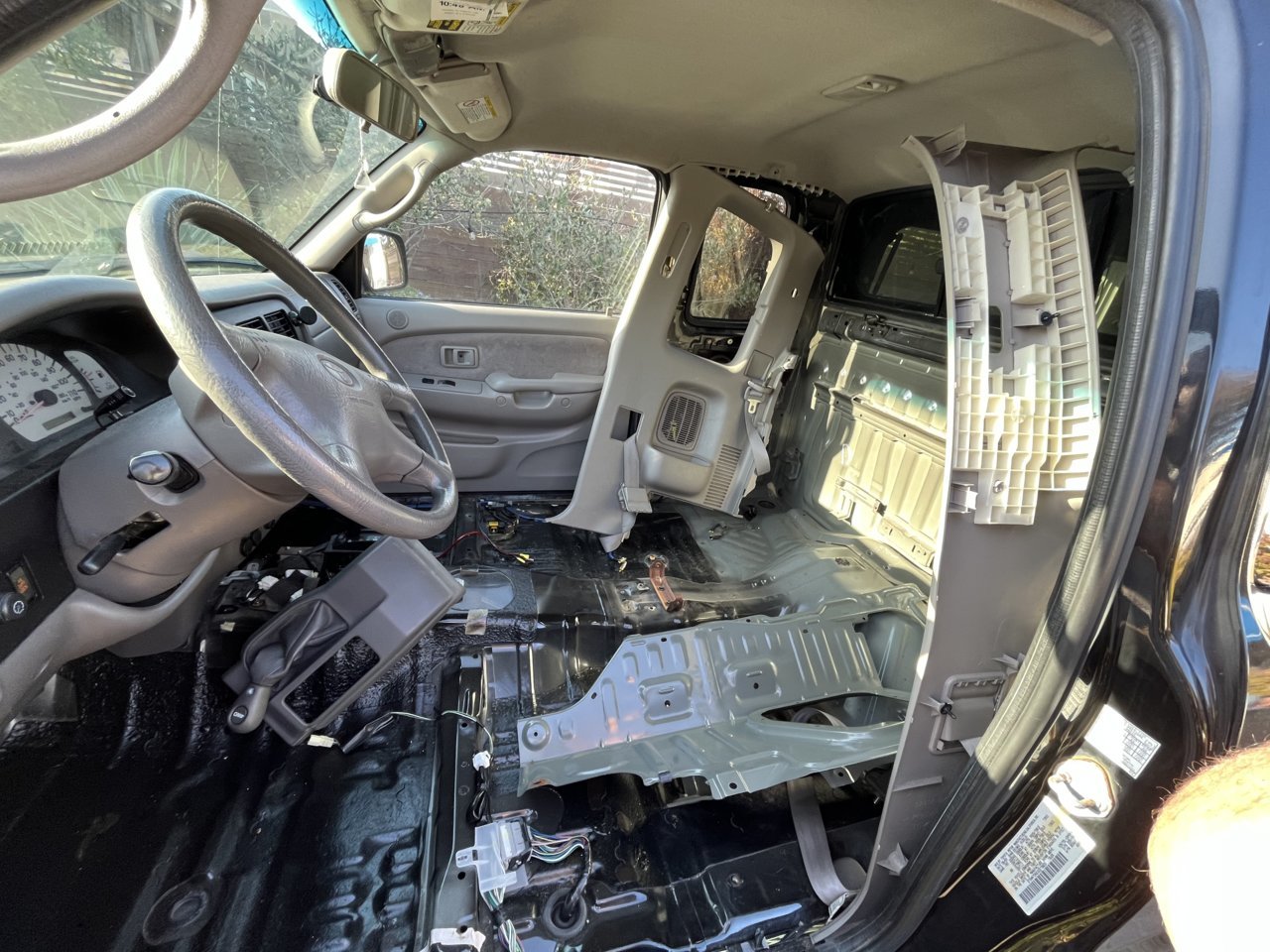

    aaaand tore out all the interior, and cleaning it up (so much dirt and dust after 20 years) sound deadening in progress and will hopefully have a chance to finish it up this week

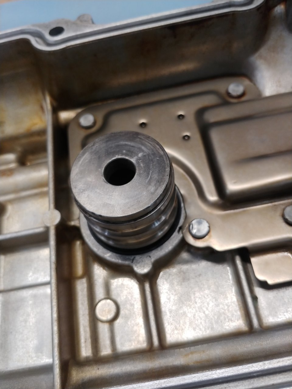

    For anyone that's wondering. A 5VZ timing belt idler pulley center makes a perfect seal driver for spark plug tube seals. It has a perfect register cut in the edge of it for catching the edge of the seal and driving it in straight. Thanks @turbodb for leaving this old one in my scrap metal box.

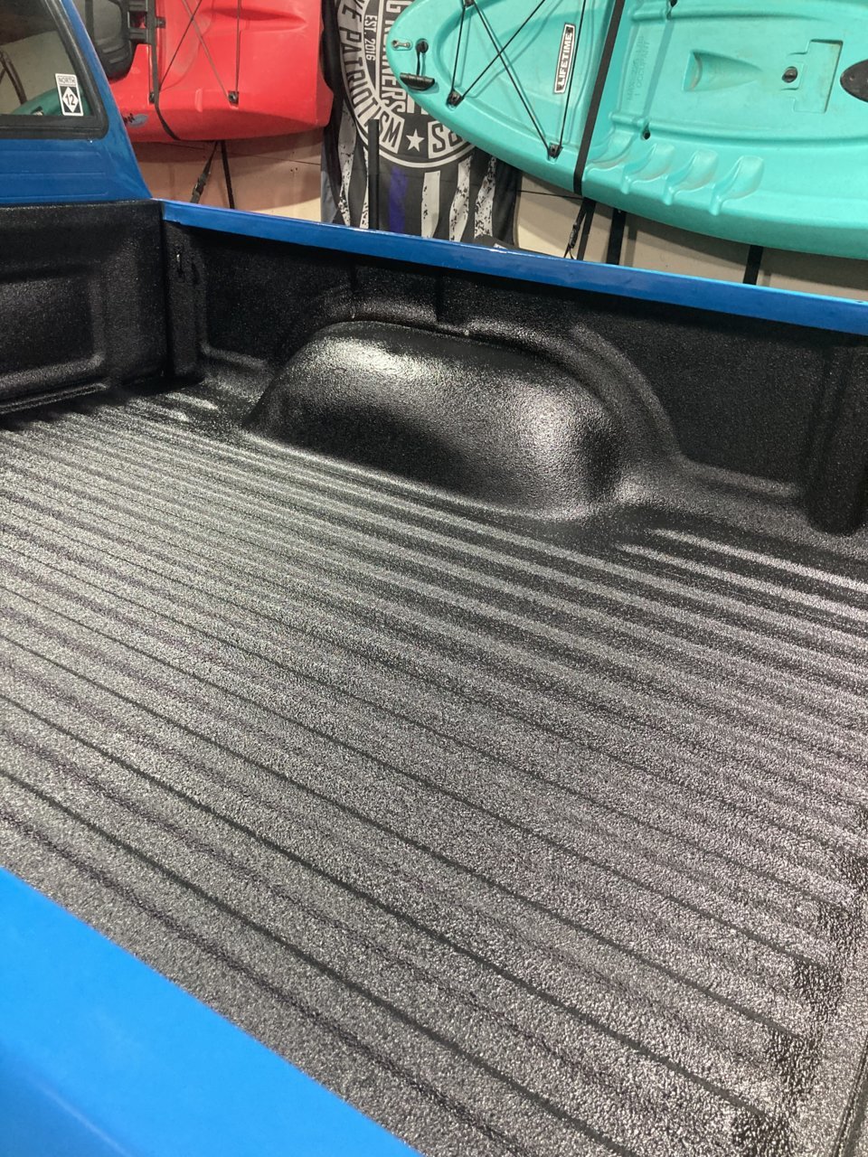

    DAC29633-2148-4EF1-B4EB-AF788C7F40B2.jpg Sprayed Raptor Liner in the bed. Finally got rid of all the surface rust and scratches.

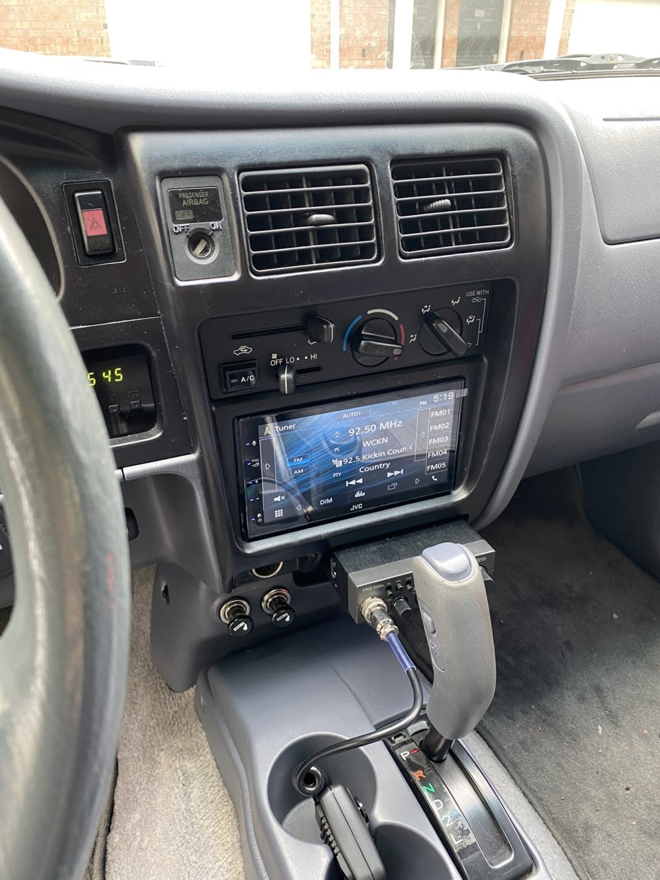

    After wiring up front/side/rear off-road lights tackled some interior stuff. New double-din radio and threw the cb into the ash tray slot. Went smoothly everything fit in great, much better than expected. Really happy with how the radio looks and functions.

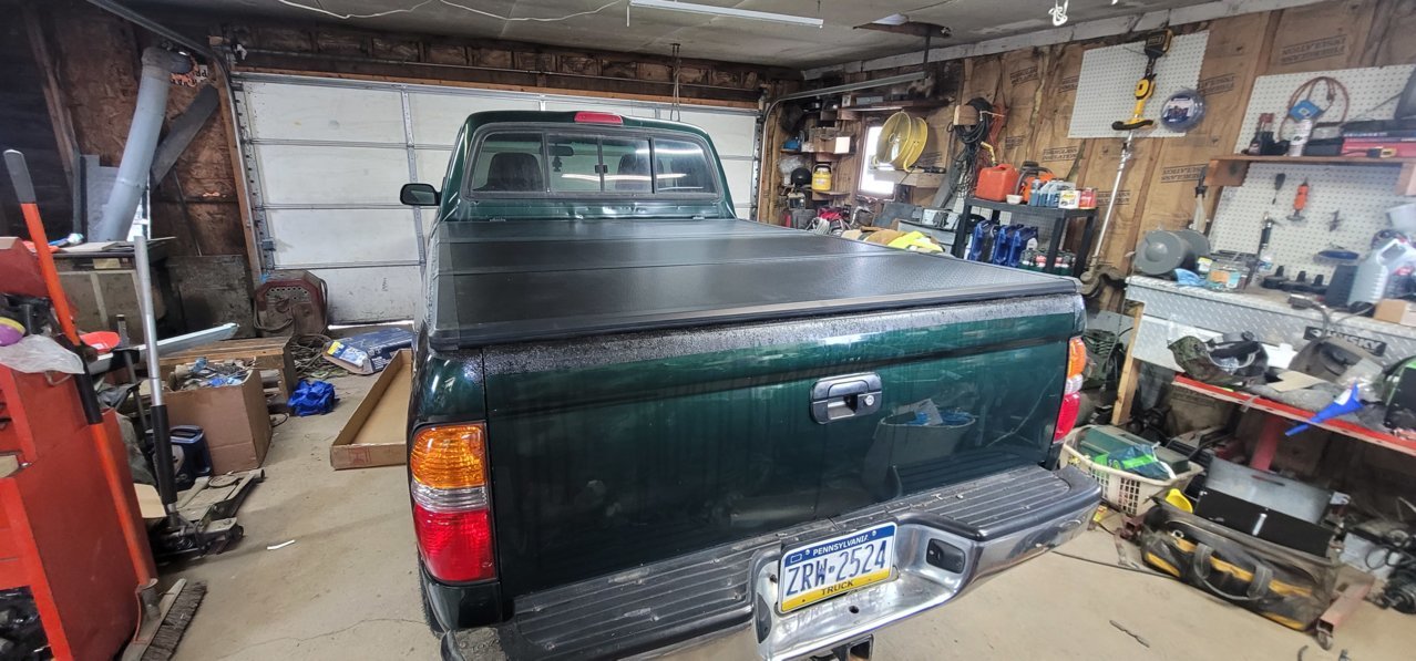

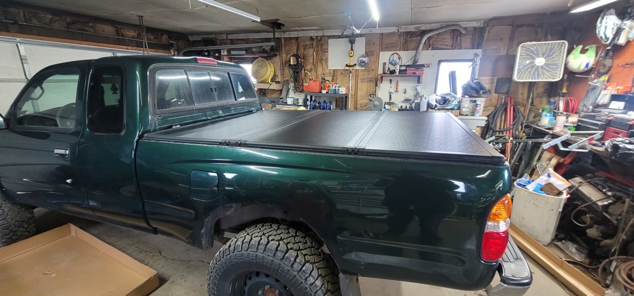

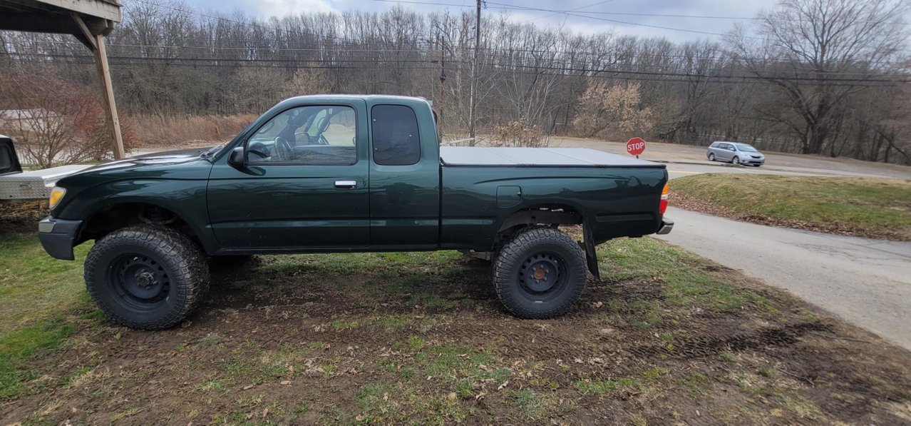

    Took off my pap cap and installed this DNA hard tri fold and a pop lock for the tailgate for as cheap as this was im very impressed with the quality 20230319_135532.jpg 20230319_140822.jpg

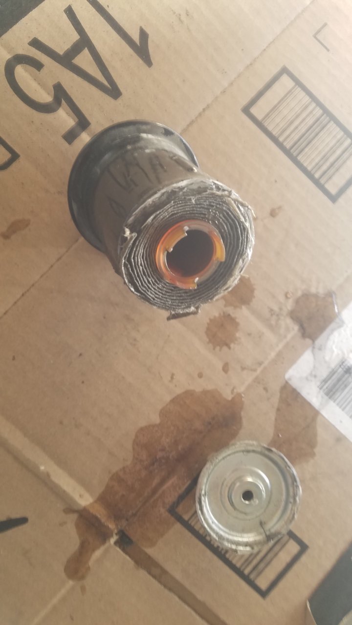

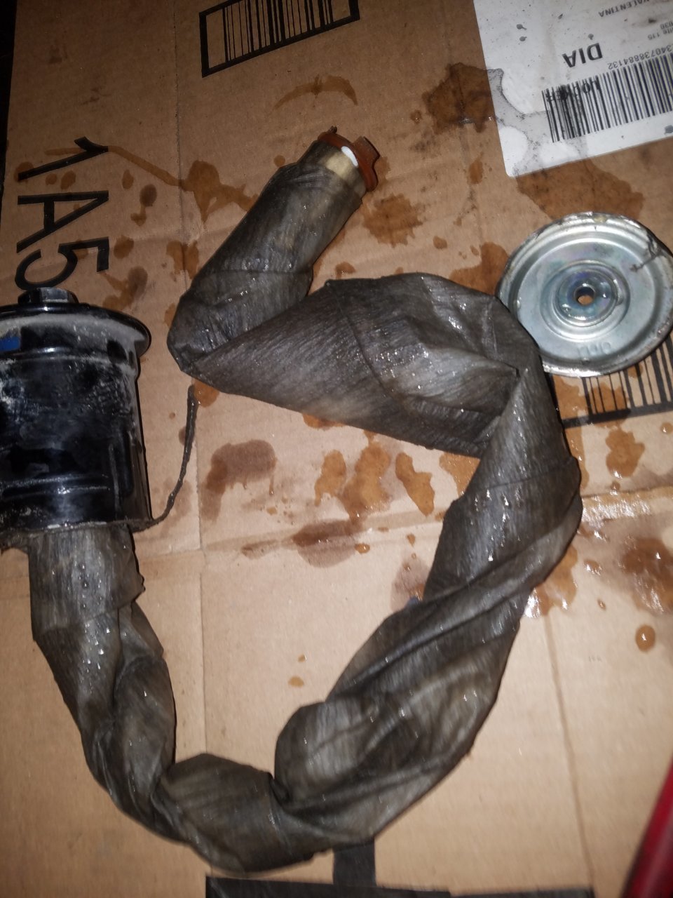

    I used to run mine till 100k,
    Now I shoot for 50k after opening up mine for curiosity at 90k
