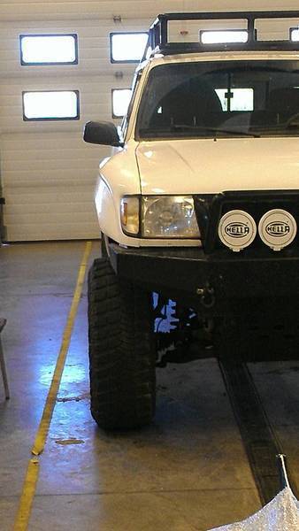

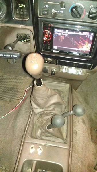

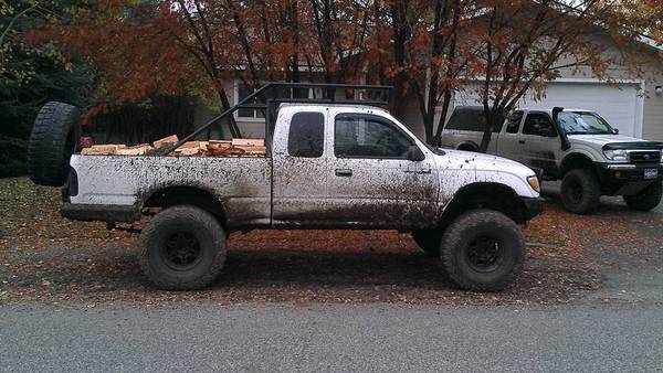

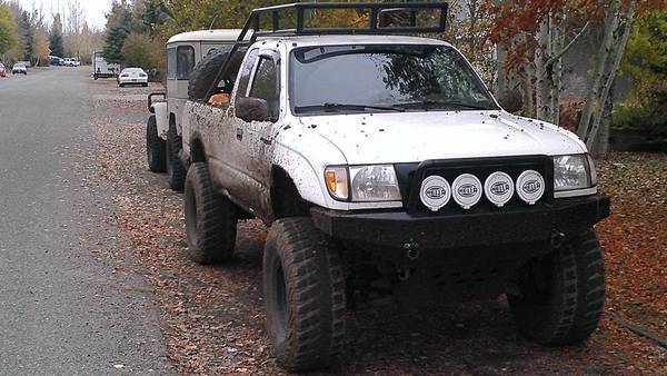

    I installed a short throw shifter and twin sticks. Also installed fiberglass fenders and helped a buddy get some firewood.

    How hard was the twin stick to install?? i am really considering one now..

    Thanks man. The glass is actually from Perry's fab n fiber. I'm really happy with it. I only had to sand one spot and the rest fit really well.
    The twin sticks weren't too bad, but I've taken out my transfer case a couple of times so that's pretty easy. Splitting the case was also pretty easy. It sucks though because you only remove one little piece and put it all back together. Installing them after you modify the case is simple too. Overall its a really time consuming job though but imo it will be worth it in the long run.

    you have to tub the fire wall. Usually about 1.5'' or more out of stock fenders. He has fiberglass fender though so they have a lot more cut out already.

    When I had stock front fenders I cut two inches out all the way around, but now I have fiberglass fenders with just a couple inches cut out of the back and blended into the curve. I also pounded back the firewall. The rear isn't cut at all and I have very little rubbing when its flexed.
