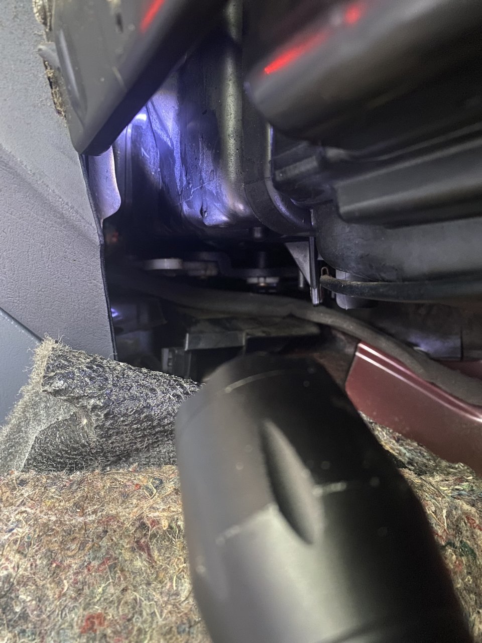

    #268083

  3. Mar 27, 2023 at 7:24 PM
    Rhodes
    Rhodes Well-Known Member
    Jan 16, 2021
    #353000
    380
    Edmonton
    01 Dbl Cab
    Installed a newly acquired sunroof shade. So glad to never have to search that part number again on the interwebs lol.
