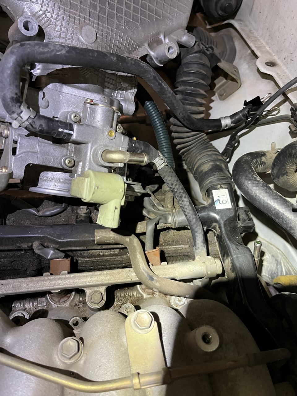

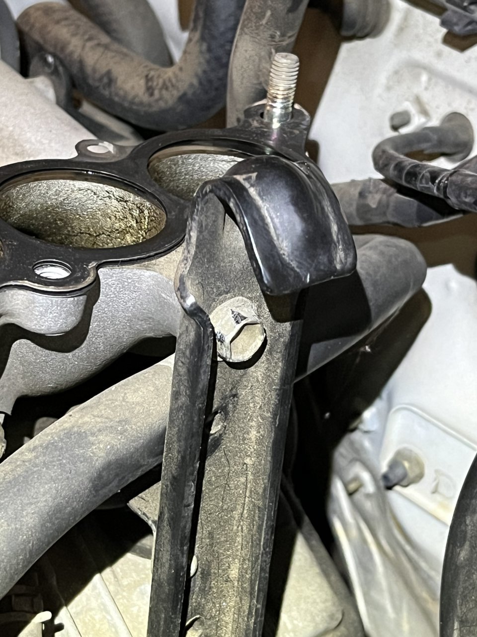

    What worked for me first was grabbing the hose with needlenose pliers and just trying to muscle the hose up and down (don't even try to remove it) just to break it's seal. Once that has broken loose a screwdriver can typically easily push it off.
    Remove the lower bolt on the motor to take the plenum off with the bracket. You'll at least be able to then get at it from off the truck. From there an extractor socket or welding a nut to the top of the bolt head should be easily doable.

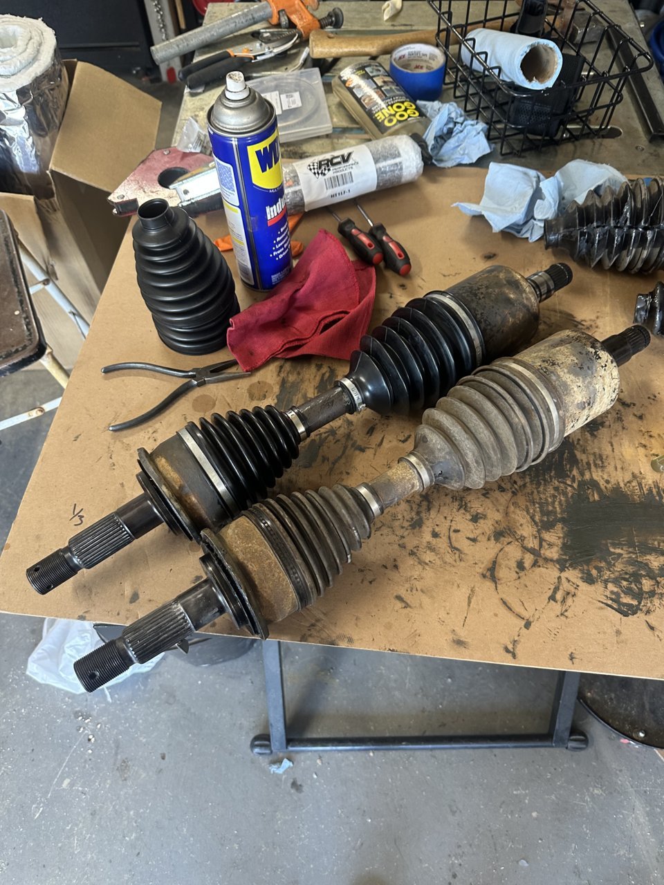

    Rebooted and regreased one of my RCVs on my lunch. I was having a click in the front end while I was in 4wd. Swapped my oem cvs in and it fixed the problem. I had both the outer boot straps break on the RCVs right after I got them last year and I just re strapped it but apparently that wasn’t a good enough fix. There still seemed to be a good amount of grease but either way I’m hoping this fixes the problem. 0C8384CA-9E43-41DE-B755-00DFED58AC26.jpg

    Was able to use an extractor socket to get out the stripped bolt, thanks y'all.
    Reassembling the valve covers and when tightening the bolts to 56 in/lbs per FSM my new torque wrench just...never clicked and I've overtightened one bolt to the point that the head and the washer sheared off...how bad is that and what is my recourse here? Nervous to do anything more now considering the torque wrench clearly didn't engage at all

    I'm gonna test the torque wrench on a lug nut and if it works proceed for now. Gonna call a mechanic for a quote on what to to do with the sheared bolt afterwards, I def don't have the tools for that

    Can you take the valve cover back off, might be able to get some vise grips on the bolt. Also I like to get all the bolts started and tight then hit it with a torque wrench.

    I did all 8 hand tight and then was going with the torque wrench. Guess I could have overtightened by hand here?
    I'll remove the valve cover again and see if I can get the bolt out. What should I look for on the valve cover, is there a chance I've cracked it?
    Need to look up what size bolts these are but if anyone knows quickly or where in the FSM it would be that'd be much appreciated

    People have cracked their covers before, but you might have just been unlucky because the last guy that did them stretched the bolt. Hard to tell. Hopefully no cracks though, if you did manage to crack it used valve covers are plentiful at least.

    Managed to get the bolt out with some pliers after removing the valve cover, thanks for the help everyone.

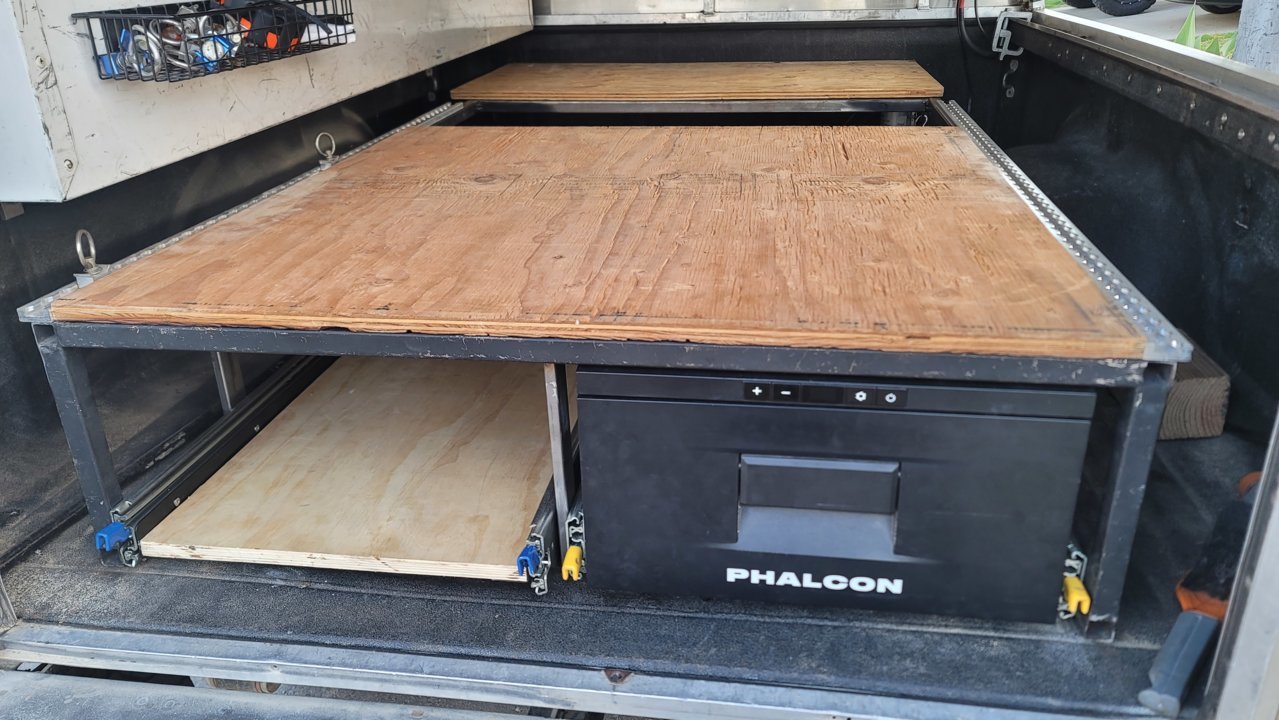

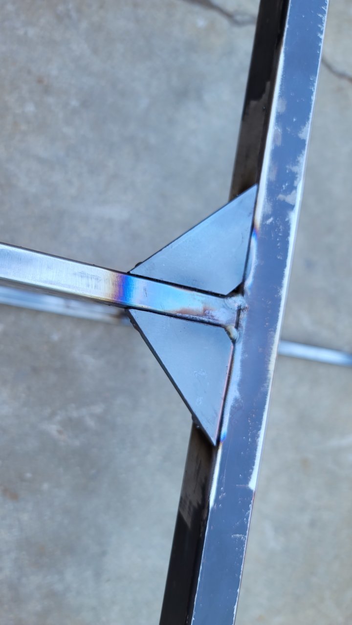

    Slides are in... finally!

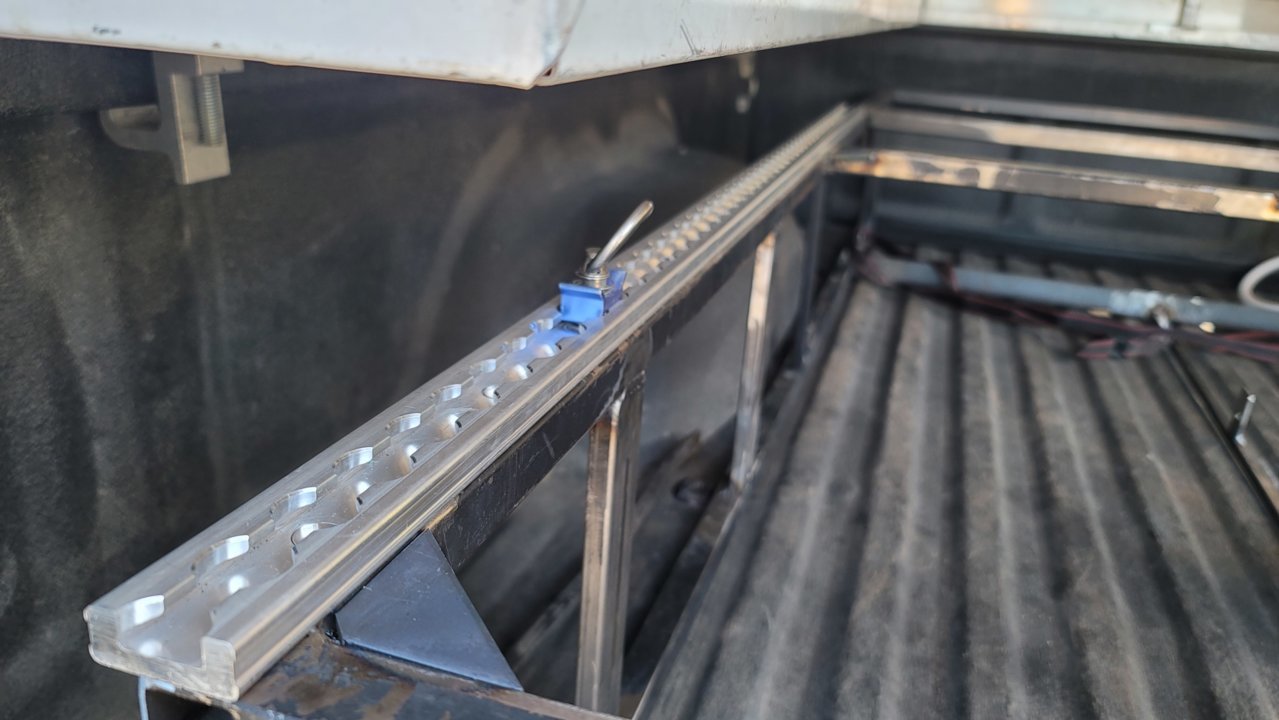

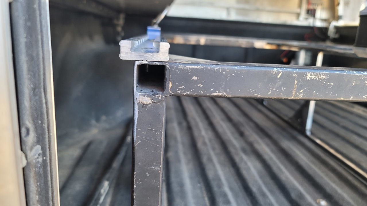

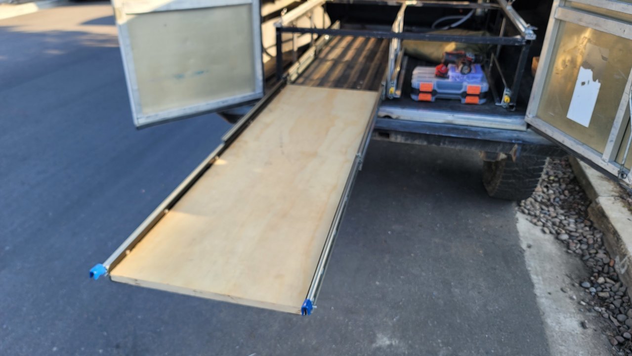

    Drilled and tapped (only broke one) L track. Not sure I'll be putting enough load on it to warrant a bolt and nut through the 1" square... but we shall see. Version 5.0 (I think. Lost track how many iterations of this frame have taken place)
    Threw the fridge on slides also to have an extra table but to also be able to remove it easily. Can't wait to build the kitchen out on the left. Need to take it for a test run ro see how and where I like things.
    Angle hot roll stainless 3/16 rivets to the 52" slides Aluminum angle for the fridge slide using 1/4 inch aluminum rivets and then sheet metal screws on the bottom through existing holes (should hold up)
    New 3/16 tabs also for the top corners and middle to support the platform. The l track took over the lip it use to sit on.
    Now to digure out how to fasten all the top plates and where the water port will live. Lots of little things but they make such a big difference when out.
    I estimate the setup to be over 100# at this point... dry :turtleride: thought about wood but then I couldn't teach myself how to weld. Been a super fun and useful project.
    20230409_163959.jpg 20230409_164018.jpg 20230410_175645.jpg 20230410_181510.jpg 20230408_153614.jpg
