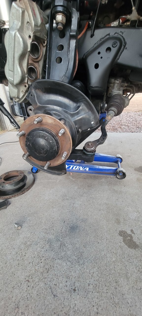

    Yeah, you're right. I just looked at TC call for it to be run that way.
    Wonder if it would make sense to swap tie rods side to side. :notsure:

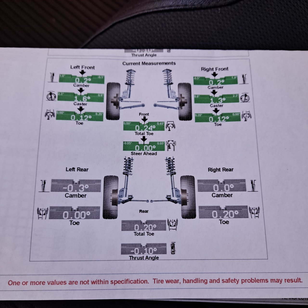

    I swiped them off of my old icons.
    I believe it is the driver's side. Although I'd done some stupid stuff before.
    To help keep it from hitting the dust sheild?I I think I might have a spare I could throw up there and see.
    It wasn't a issue tell I got the alignment. I don't know if it was because I didn't drive it far or if it was because of all the caster put in it.

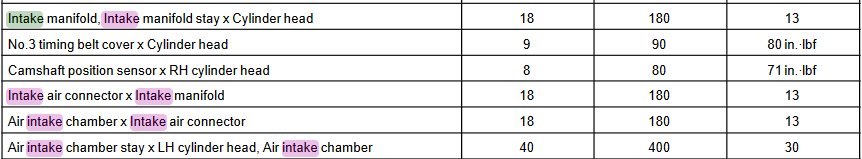

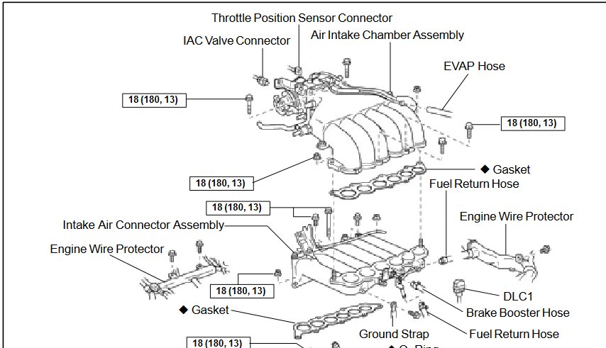

    looking through the FSM and I'm having trouble locating torque specs for the lower plenum fasteners (long middle, 2 star bolts, and 2 nuts at front and rear) and same for the upper plenum. I looked in FSM service specs and can't see it in Engine Mechanical, standard bolt torque specs, nor in the repair manual for those. Where does the FSM specify the lower/upper plenum torques?

    Looking through the FSM it seems like what I've been calling the lower/upper plenum is referred to as the air intake assembly. If that's correct, I'm not sure how to interpret the torque specs in the chart below. It should be 13 ft-lbs for everything but the air intake chamber stay x LH cylinder head, Air intake chamber. Is that the long bolt that goes through the lower plenum?

    Found it, posting here for anyone searching later. The 5VZ-FE upper plenum and lower plenum torque specs are in the photo below (13 ft lbs for all fasteners on the lower plenum and upper plenum):

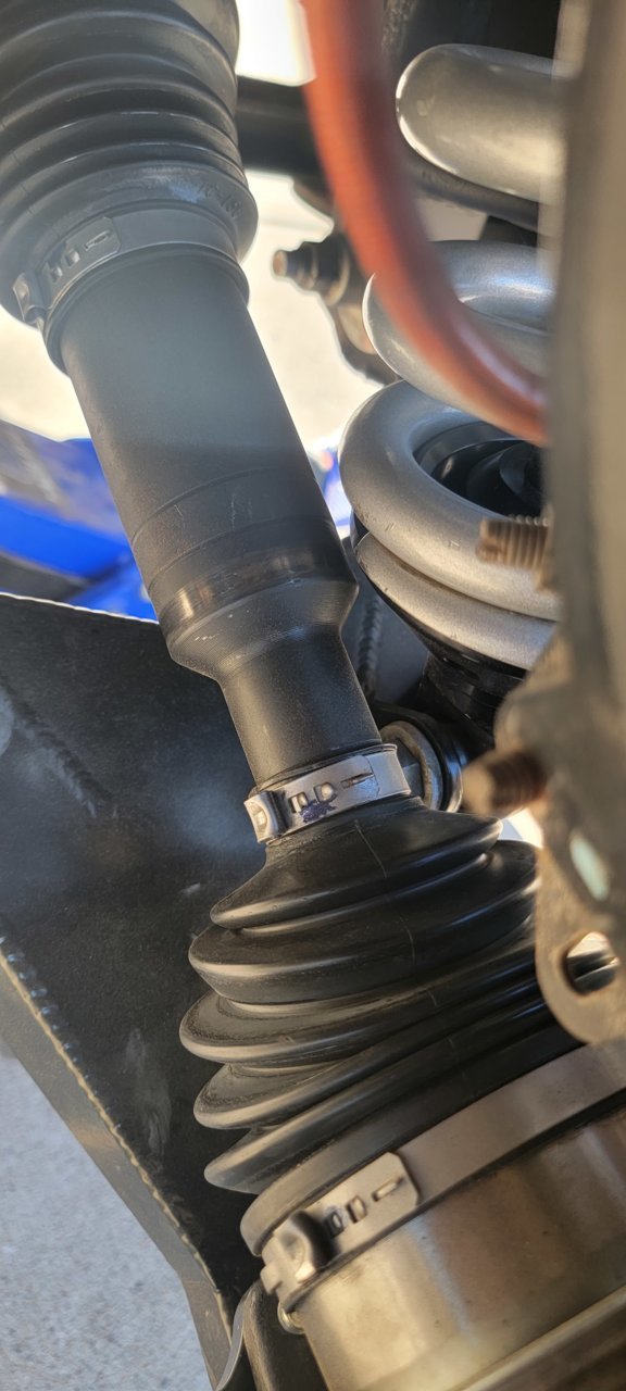

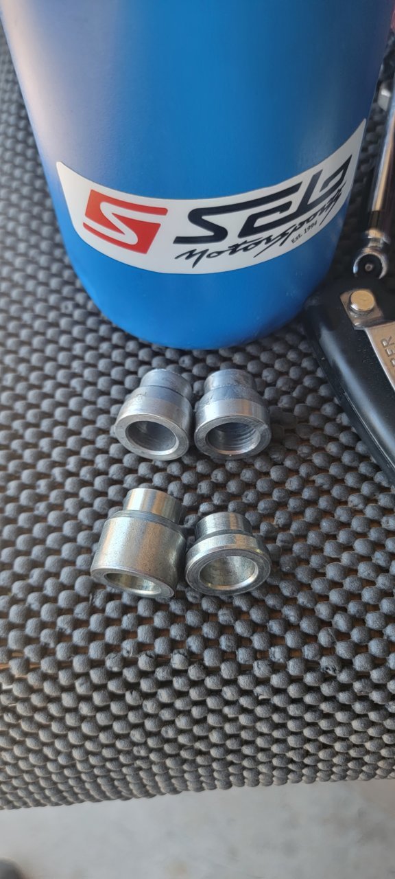

    You want the FOX ones because they are offset. It was def a little more difficult to install initially with the o-rings but some channel locks squeezing the whole setup before trying to install helped a lot.

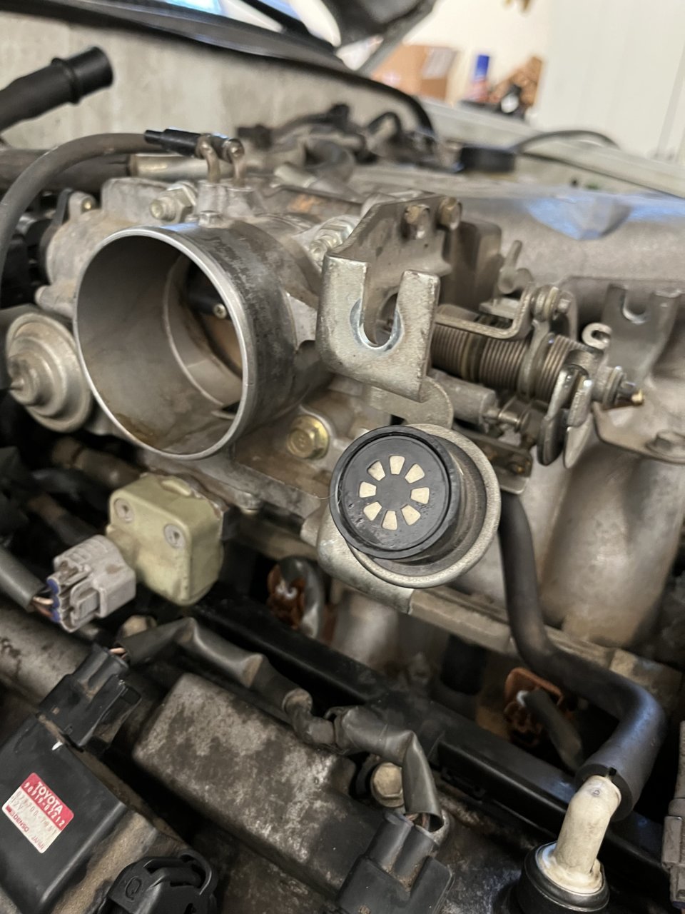

    Okay last question, pretty much done with reassembly but the cap to this circular component of the throttle body fell off into the engine bay and I haven't been able to find it. Hoping when I back out of the garage it knocks loose but if not I can search underneath (don't want to in the garage right now since some fuel spilled onto the floor). Am I able to start the car without this or will I risk some sort of sensor error?

    Yeah that's just a throttle dashpot, it's not hooked to vacuum

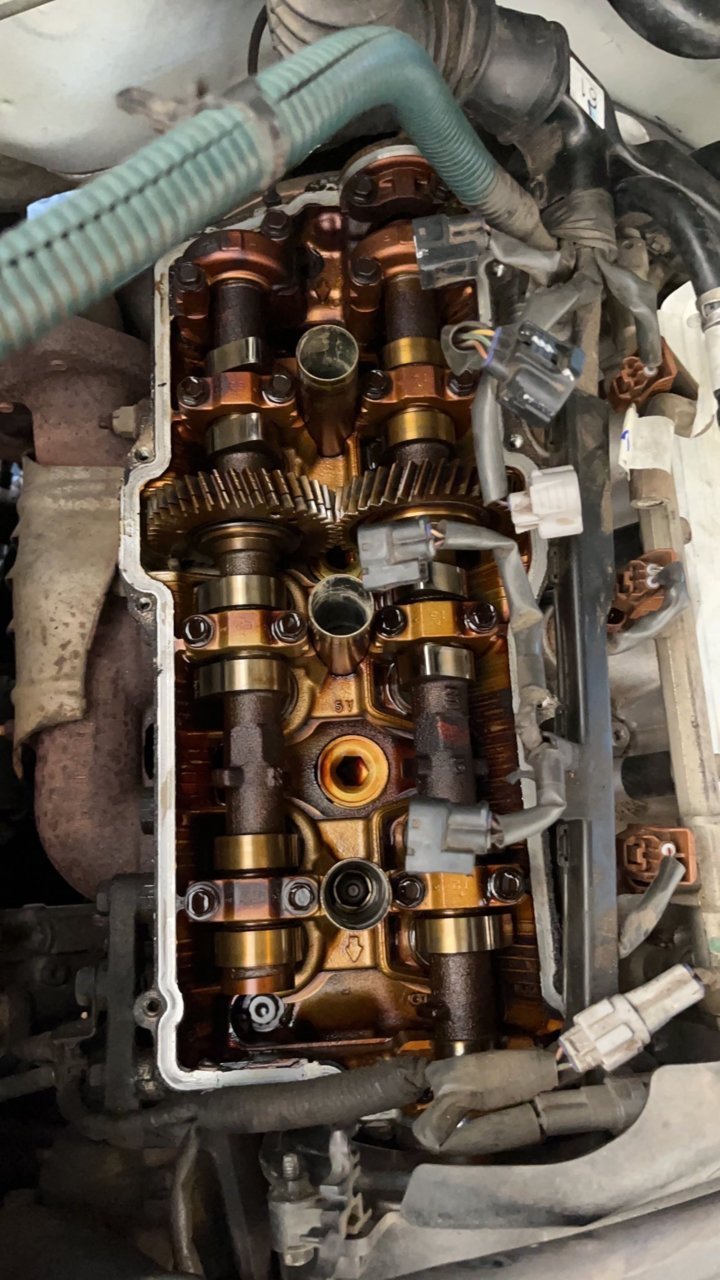

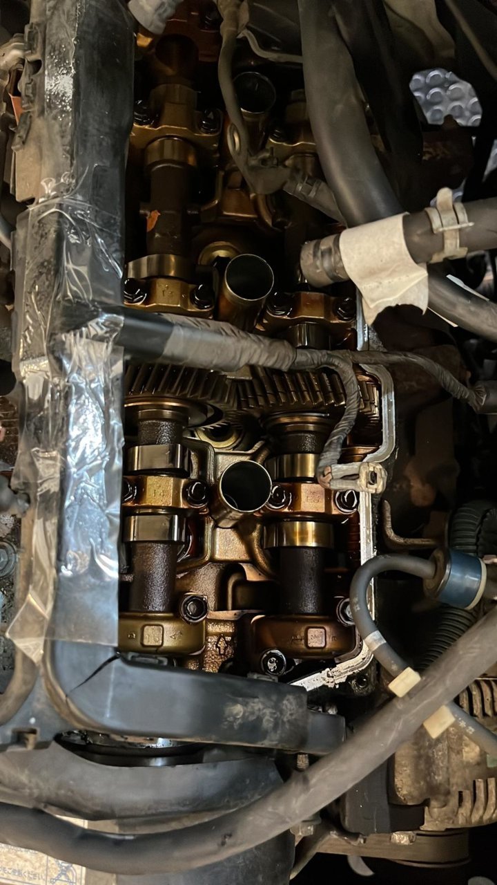

    Thanks for the help y'all, speedytech especially. Replaced the battery and it turned over without problems. Finished the valve cover gasket replacement, here's some pics of the engine
