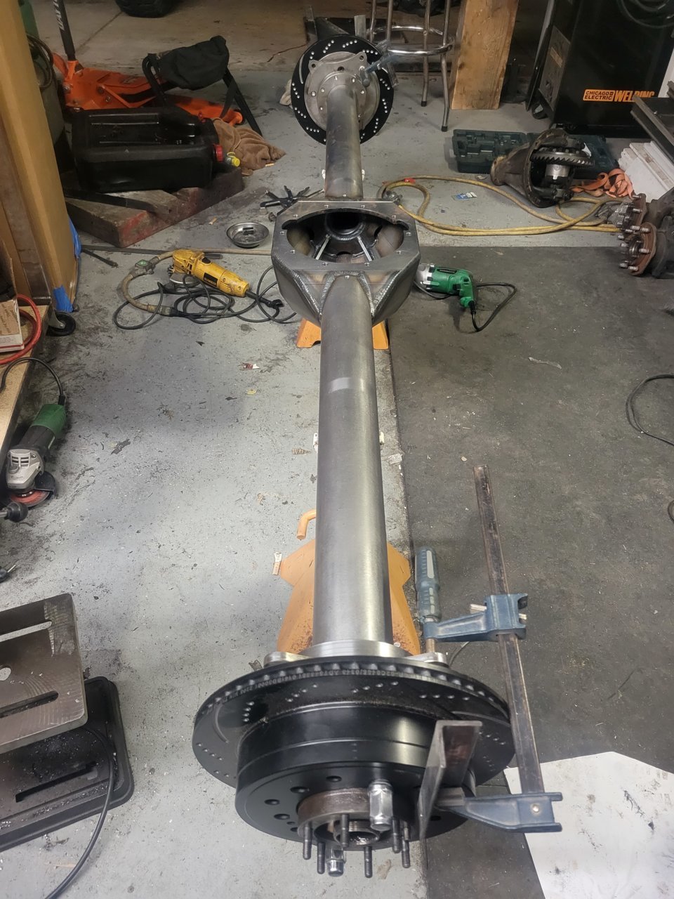

    @MattJakobs stopped by. We got some work done on his knuckles. Which left me with a set of spindles for the rear axle. Score! Thanks Matt :thumbsup:
    The spindles allowed me to mock up the housing, to find out what length I'm sitting at now, so I know how much to cut the housing.
    Housing gives me 81 inch from WSM to WSM. Which means I'll be taking 15 inches off to get to 66.
    My front, at ride height is 67 3/8. I'd like to be just about 1 inch narrower for the rear axle.

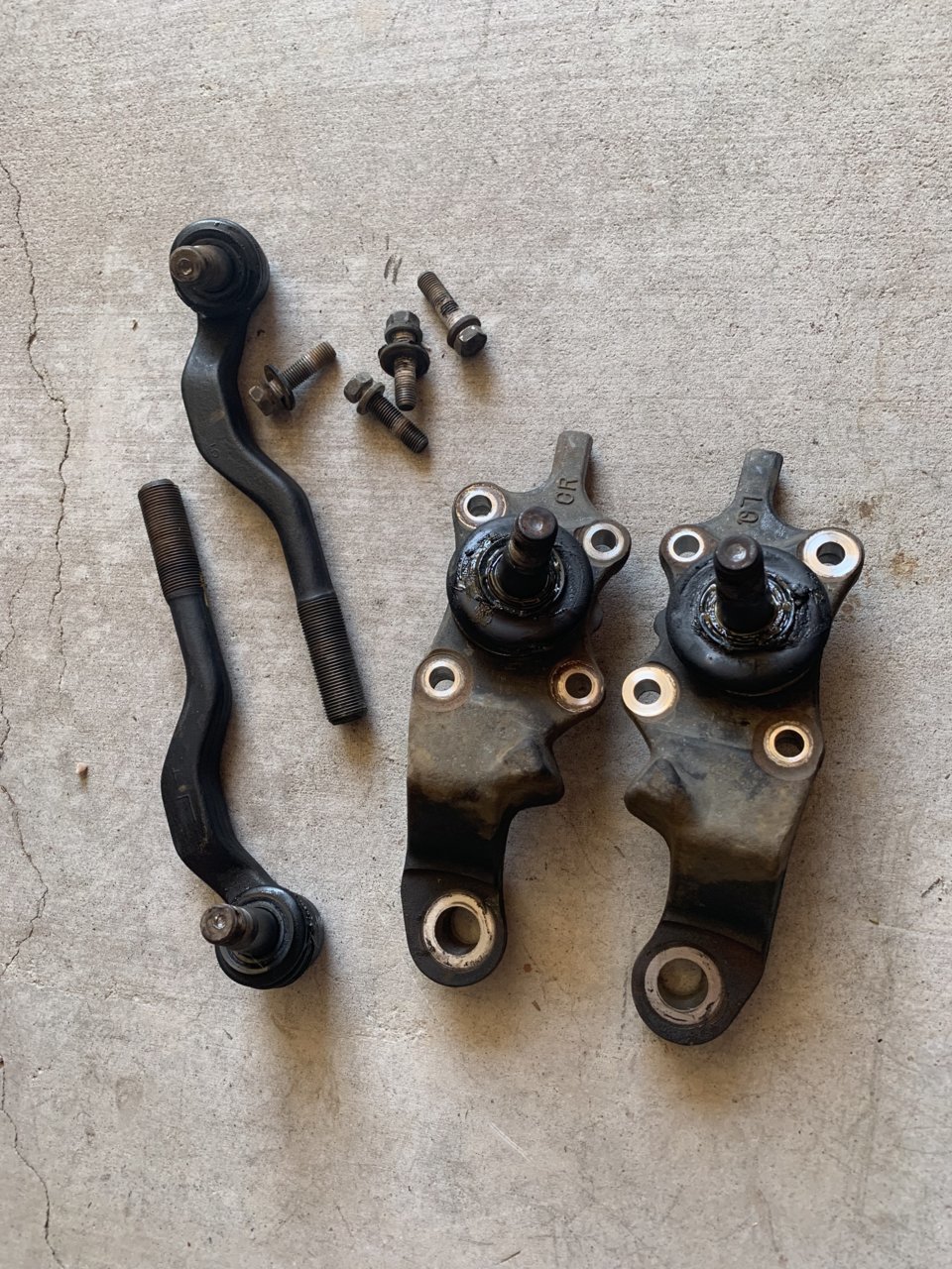

    Lower ball joints and tie rods are done. I need to get an alignment very soon though. Steering wheel is at 11 o’clock, but the poly bushings took a lot of slop out of the steering.

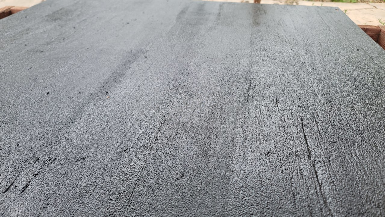

    Electrical switch panel mounted. Can't weld aluminum so... rivets! Need to sort where all the switches and gauges will go before I drill a ton of holes in it.
    Platform panels finished. Painted them with some HF bedliner today. Did about 3 coats. Figure it's an experiment so we will see how it turns out. I like it so far. Goose gear does something similar with Baltic birch and some other liner I'm sure.

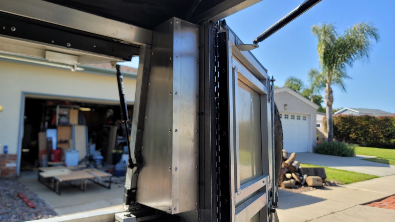

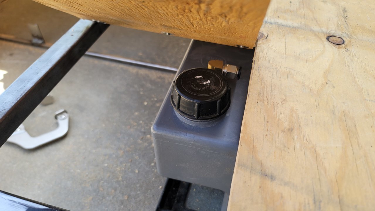

    finished the water port mount to open up the side section of the bed. 20230415_120227.jpg
    Made a little handle out of some stainless plate.
    Stainless T nuts and hardware all fasten the hinges and handle for a secure setup that can be serviced if need be.
