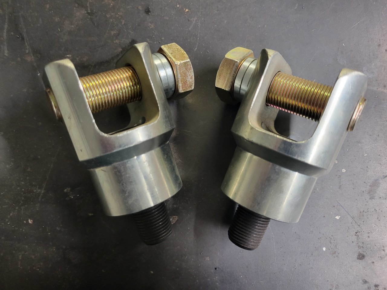

    How much were those steering clevis’?
  2. Apr 21, 2023 at 5:14 PM
    El Taco Diablo
    El Taco Diablo Professional Pinstriper
    Nov 6, 2017
    #235223
    13,979
    Matt - KN6DZP
    Hughson, CA
    Impulse Red DC, 5vz-fe, 4wd swap, LT, dual case, F/R locked
    Just 3 tons of fun!!!
    $175

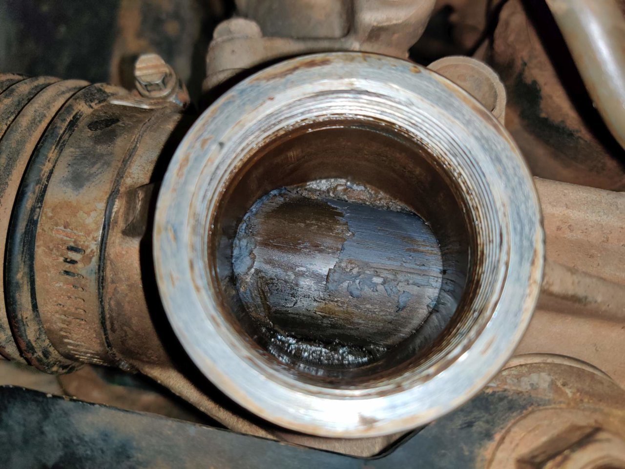

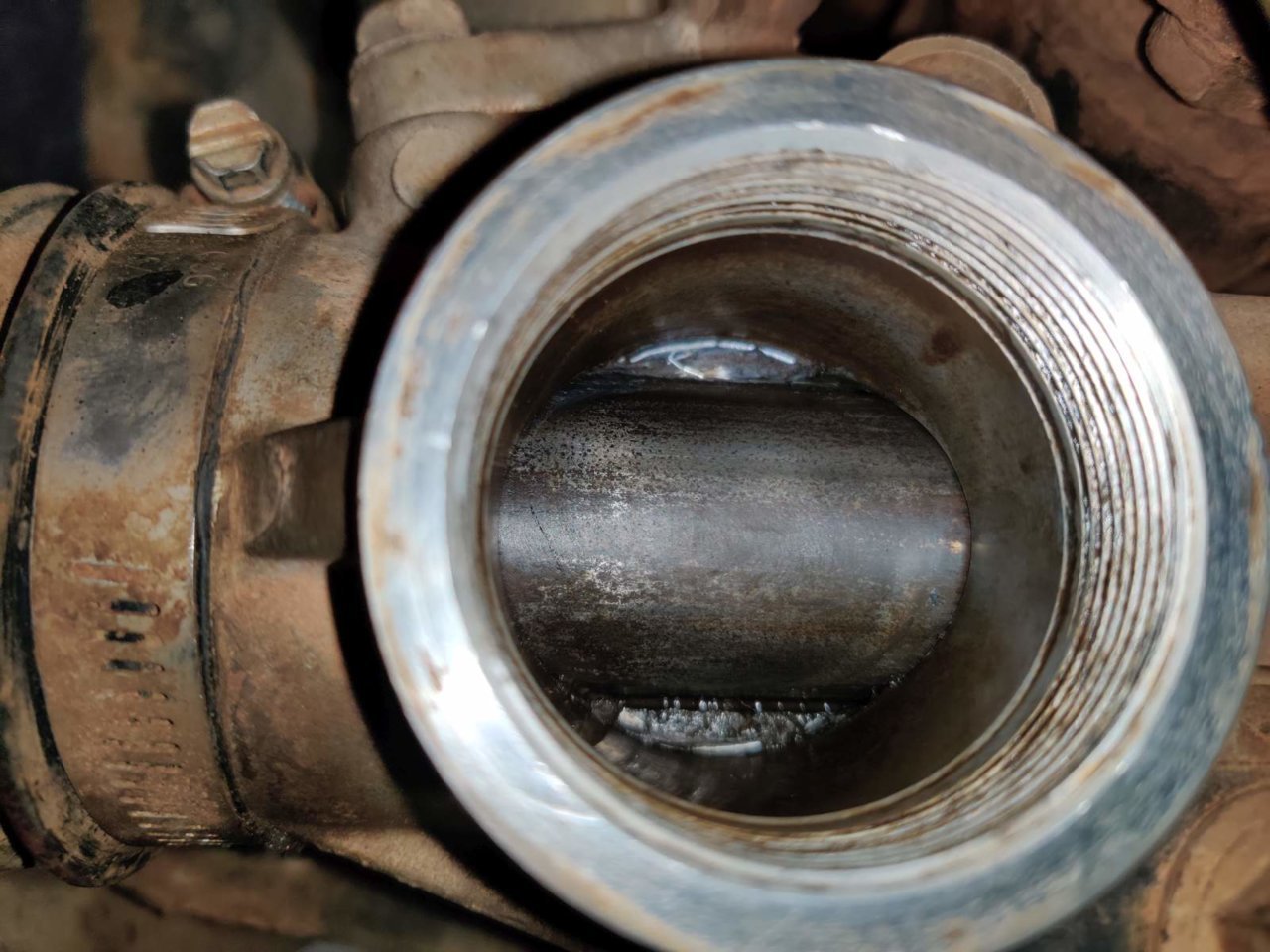

    For the ongoing effort to track down some noise/clunk/itre movement on the drivers side of my steering rack, I first tried adding some torque to the rack guide nut. It did work to eliminate the the clunk and vertical movement but it changed how the steering felt. A bit stiffer and it did not want to return to center on its own.
    So yesterday I tore into to rack to replace the rack guide. I am not sure what to make of what I found. The grease in there was in pretty bad shape.
    I was expecting some damage to the original guide, but after cleaning it up, it does not seem damaged.
    Old and new rack guide.
    Even though the old rack guide cleaned up pretty nice, I did not reuse it.
    Internals of the rack cleaned up as much as possible.
    I got as much of that old grody grease out of there. Then repacked it with some fresh grease and reassembled.
    The FSM calls for 18 ft.lbs of torque, then back off 19° of a rotation of the nut. This is a challenge since that torque is hardly any torque at all. I ended up not doing the -19° thing.
    Steering is now very smooth and quiet and returns to center as it should. Time will tell if this is a permanent fix or not. I know that @Dan8906 got this far and it did not fix his situation

    I’m glad it worked out so far for you, my grease did not look that bad at all, but I took the same approach, cleaned out as much as possible and re greased with no luck.

    Isn't your rack fairly new too? Like didn't you replace at some point?

    Yeah, relatively new. Replaced it 5 years ago. It now has ~65K on it. Not that much considering the one it came with went 175K.
