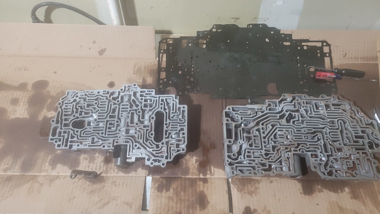

    Well I :censored::censored::censored: flubbed... I went to take the test drive this morning and had no reverse to get out of the garage... only forward motion in any position... went back to review my pictures I took and seen/recalled that I forgot to position the shift linkage pin into the place. :jpow:
    Dropped it all, was able to loosen the VB bolts all enough without taken them completely out and slid the pin into place like it should be... buttoned back up again now and waiting for FIPG to cure before refilling fluids again and seeing what the 2nds attempt has in store..

    All fixed, she can go backwards again now! First impression of the Trans go kit are good, going to take some getting used to the shift behavior but all in all I like it! (Truck setting)

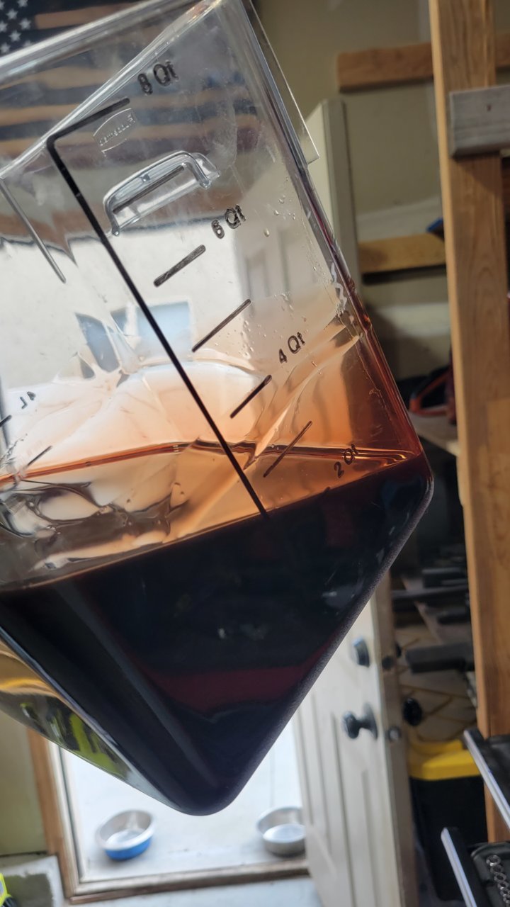

    Also, can't trust anyone with maintenance apparently! Prior to this Trans Go install I had a Toyota dealership flush the transmission some ~30k ago maybe....(chasing what turned out to actually be a bad ignition coil that hadn't thrown a code yet) but now fast forward to that Trans go install...4 quarts were drained during this process (twice due to my boneheadness), but I have so far put 6 quarts back in and I am still roughly a quart+ low at running operating temp! So been running around 3-4 quarts low of a 12 quart system...:smack:

    12 quarts? I think I put about 6 quarts in my tranny last and I read a little high on the dip stick when it’s hot

    The system is actually somewhere between 12 and 13 quarts. But you really can't drain more than about 6.

    There's really a lot of room for errors in the amount of fluid that can run in the system.
    I've ran a couple quarts low, and a couple quarts high over the course of the 400,000 on the truck. I've put 150 or so K on this trans since it was installed with the 4wd swap with shift kit. It had around 150K on it before I got it.
    I'vr replaced the radiator and forgotten to refill the trans (around a quart low). I've refilled it and misread the dipstick (ended up over a quart high).
    I think the dipstick is more of a suggestion really lol.

    haha for sure! It ended up only being about 2.5 total low after I went and picked up more ATF. I assume previously, I would have had issues arise if running that low was causing a problem but I constantly have an eye on Torque App and with my Trans cooler very rarely do I see temps above 180 unless I am loaded and pushing it hard. Hell, tonight just to get to operating temps I had to load it up while stomping on the brakes to get it above 158* and take measurements

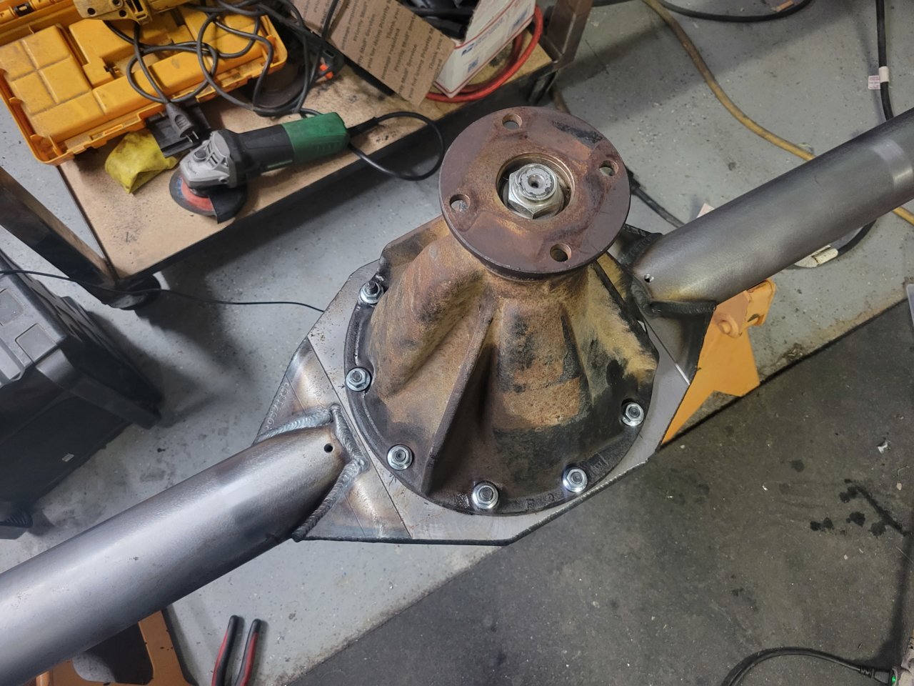

    Getting closer.
