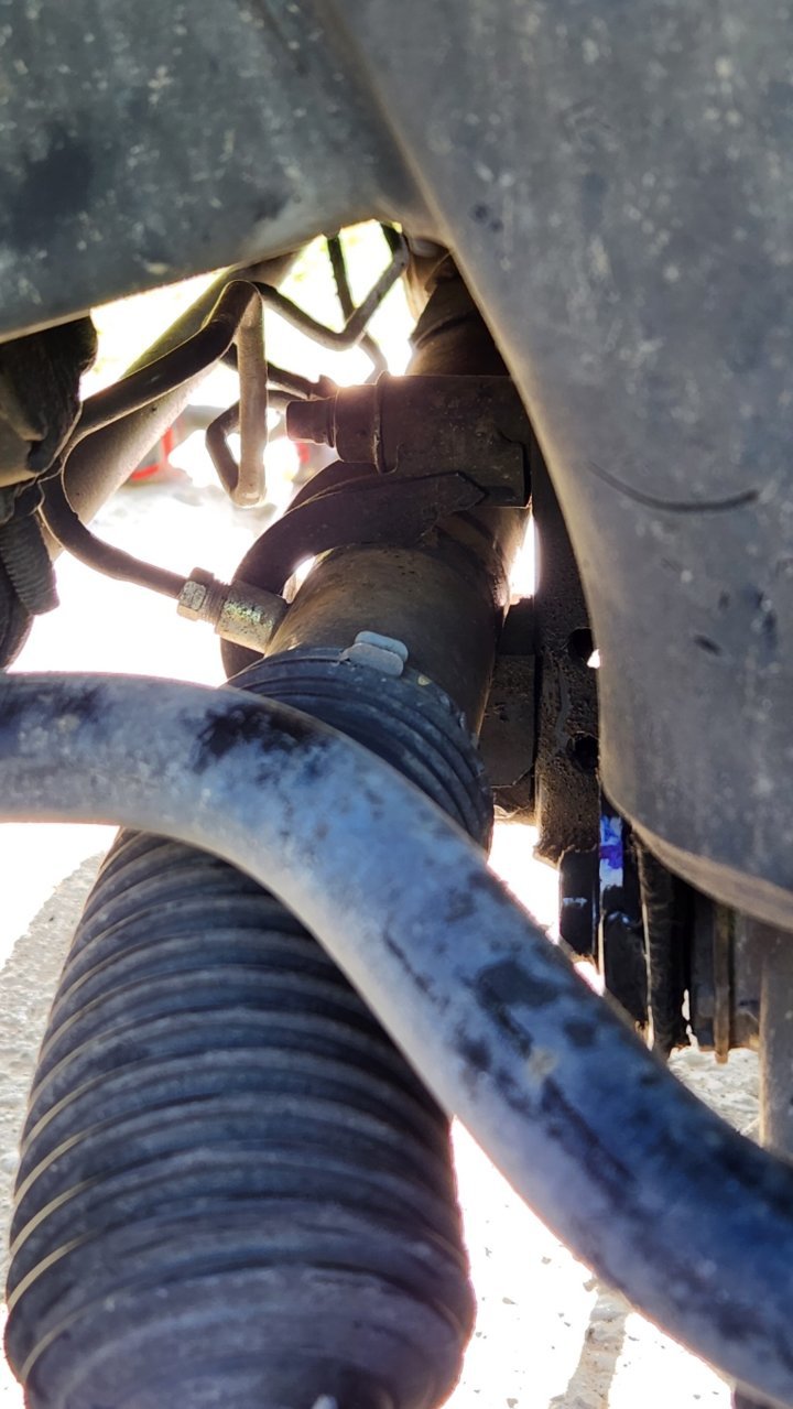

    Yep. Parts ordered.

    Don’t know what you ordered but the total chaos bushings tend to work the best. I’d highly recommend them over any of the other options

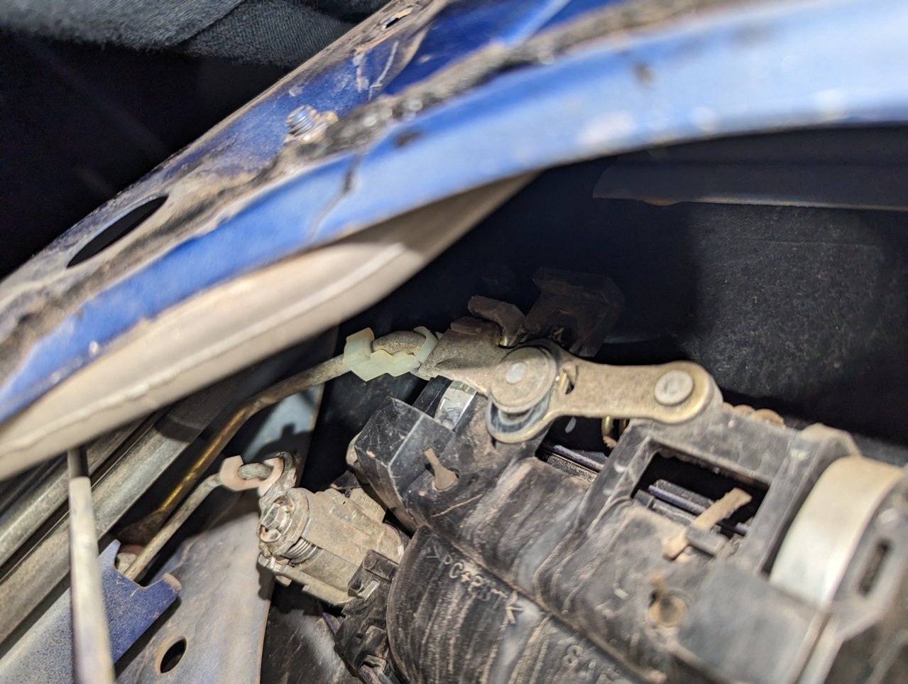

    Today I went to put a new speaker in my driver door and discovered my window door track was busted. My window has always made a ton of noise when rolled down any amount and that was the cause... I welded that up, installed 2 sheets of Killmat inside the door, and finally mounted up my new Kenwood 6.5" speaker. I also discovered my door handle is starting to crack so I'm waiting to put the door card back on til that shows up. It's the little things huh :laughing:

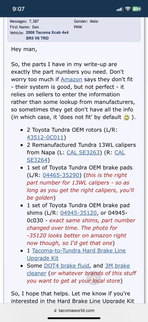

    This page has a great step-by-step guide (with pics) on the upgrade, as well as links to all the parts needed (at varying price points). OEM is best for the pads, but for the calipers you shouldn't pay the premium. Get them from your local parts store (ideally) or Amazon, which will give a lifetime warranty in case you ever need to replace them. And don't forget the upgraded lines, they make a big difference with the larger calipers.
    Step-by-Step Tundra Brake Upgrade

    The metal ones are nice and I haven't broken the handle itself but every couple of years I still need to buy a cheap handle. The clip for the rod that actuates the latch breaks and I replace it with the one off the cheap handle :homer:

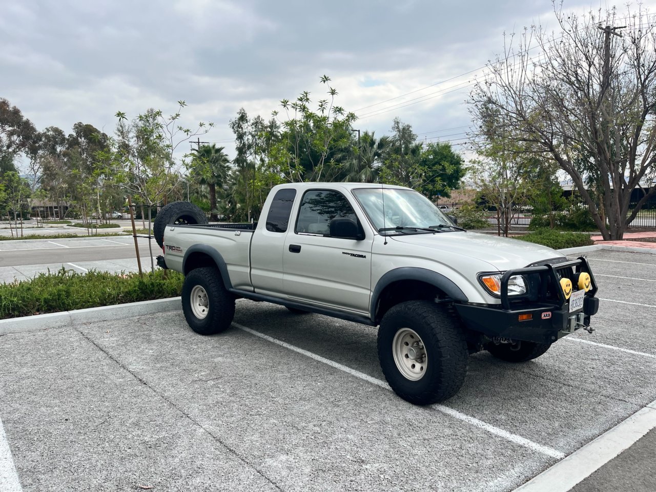

    Finally took my taco in to get detailed, came out way better than I thought it would.
