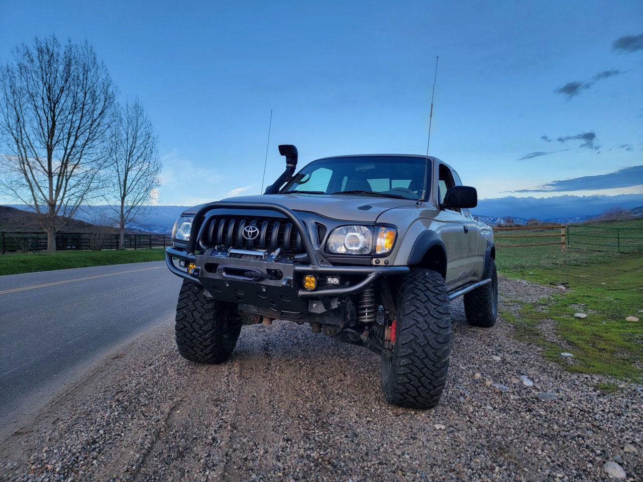

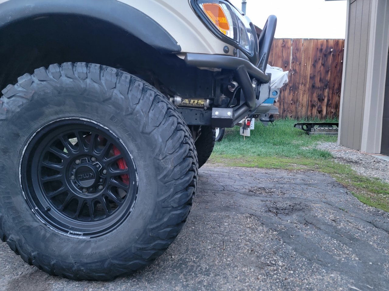

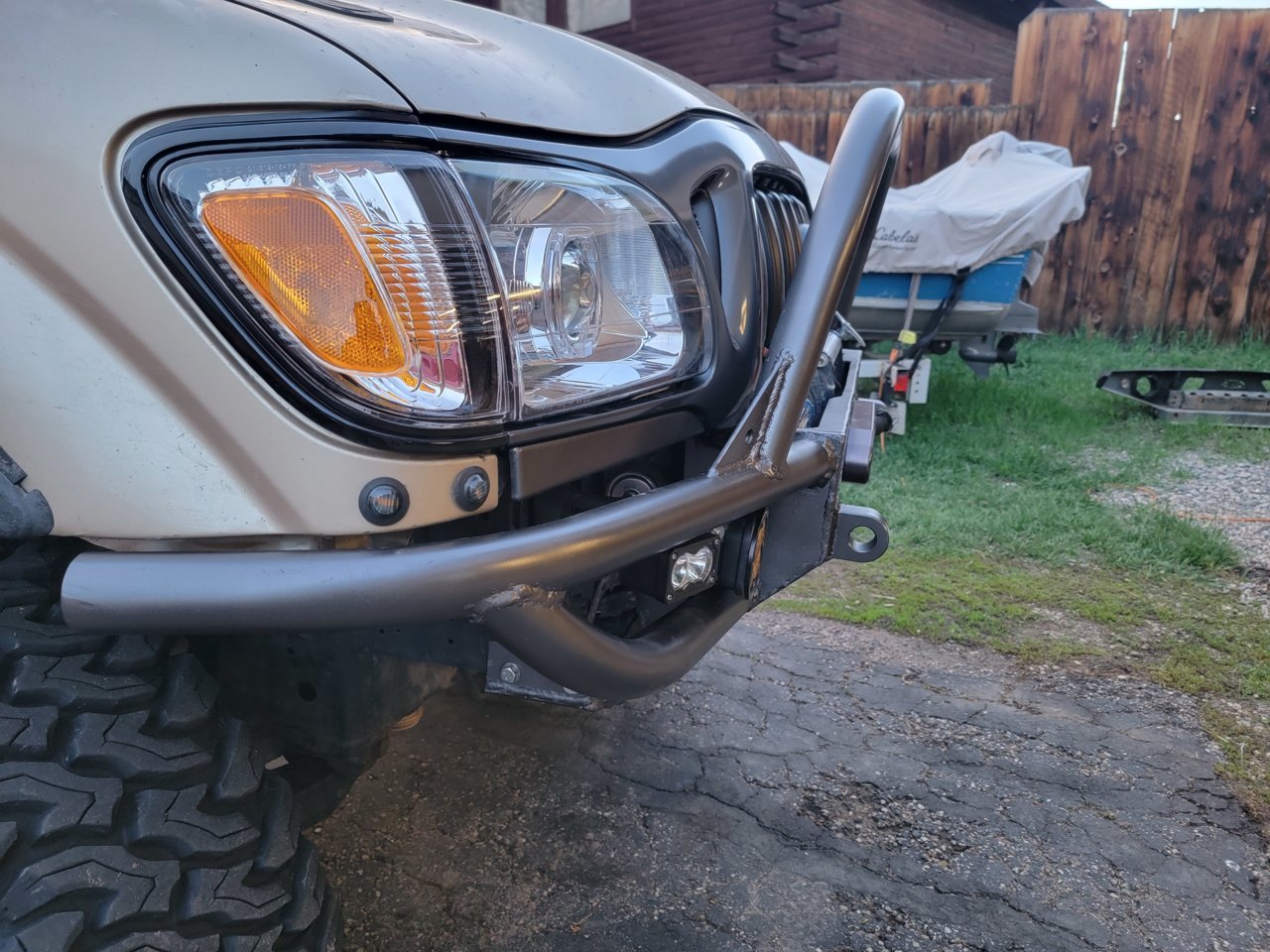

    Lots of dust and custom dents, Check Build
    Yeah, I have waaay too many hours into this. For some reason it was much more difficult for me than the rear bumper I made for the 2nd gen.
    But it looks sweet, and kept it as tight as possible. I definitely improved the approach angle, which was my main goal. Especially with the shorter radiator. Now to build a new skid to match...

    yeah bumpers are no joke. Doing Mikes didn't make me want to make another haha
    Reminds me alot of Timmy's bumper he made though, he also was able to keep it really tight like that and did the hybrid thing.

    Did you fab this up yourself or go with a DIY kit? Looks sickk

    Made from scratch. :welder:

    Thanks!
    If I charged enough to make it worth my time, it would be a very, very expensive bumper.
    Needless to say, I'm not about to get in the bumper business. :rofl:
    They'll fit, but have a little less offset. Might want to run spacers, especially if you're running larger tires.

    They fit! You may need spacers depending on tire size. To clear the sidewall on the UCA with 12.5" wides I am running 1.5" spacers. With Loctite and torqued to 80ft/lb the spacers have never been a problem
