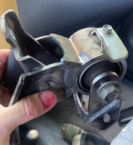

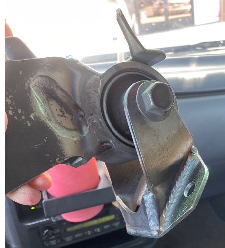

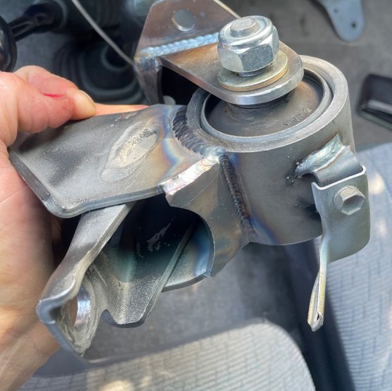

    I made some motor mounts for my 5VZ 2 weeks ago. I was sick of breaking the OE ones, but refuse to put poly on my truck because I've had poly in the past and cant stand the vibration, so I thought a bit outside the box and made these. IMO this is the ultimate, they cant separate and break, yet you still get the dampening of factory rubber bushings. It does vibrate VERY slightly more than OE, but I'll take the tradeoff. The motor moves FAR FAR less than the OE mounts too.

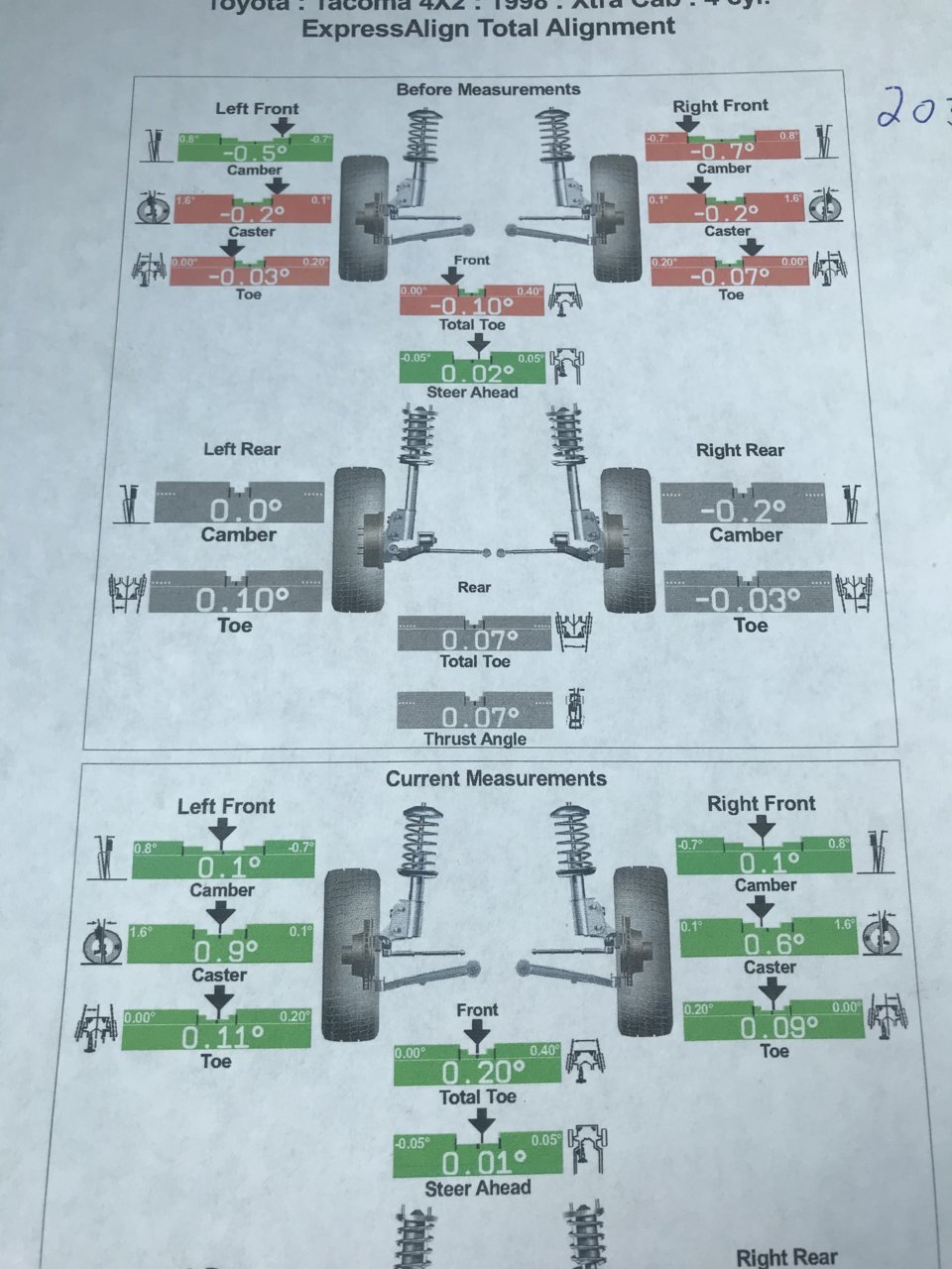

    After replacing 90% of the front suspension on my 1998 SR5, I got it aligned. Tracks perfect now!

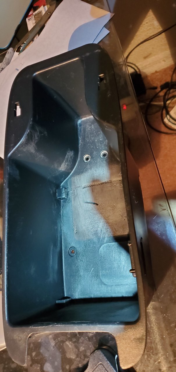

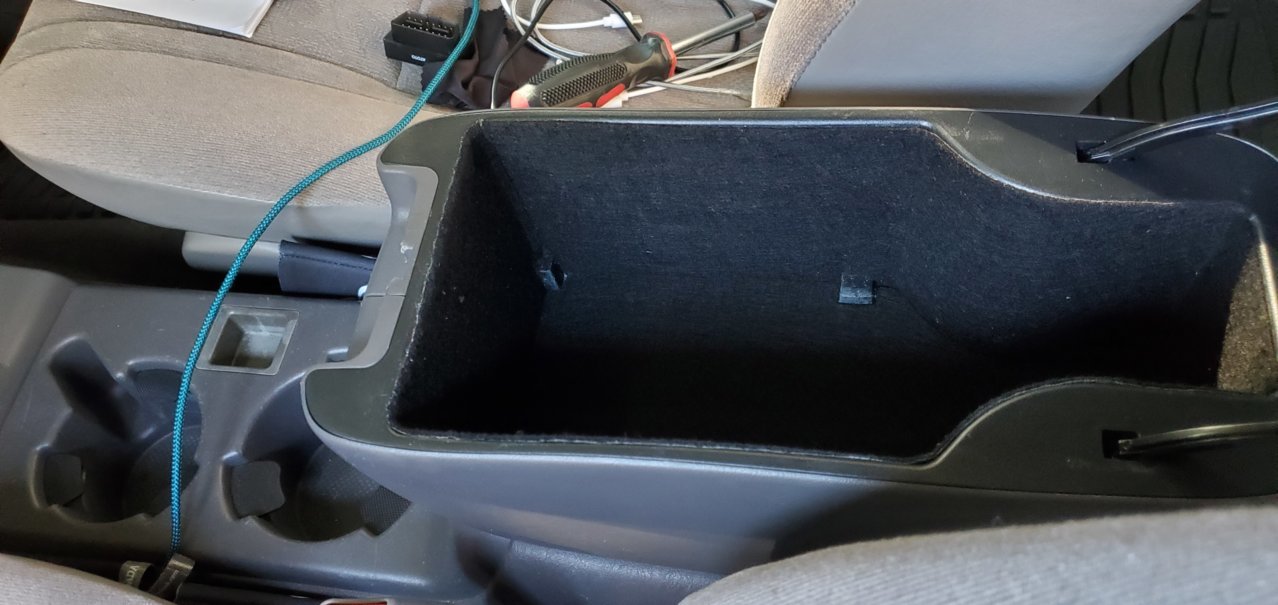

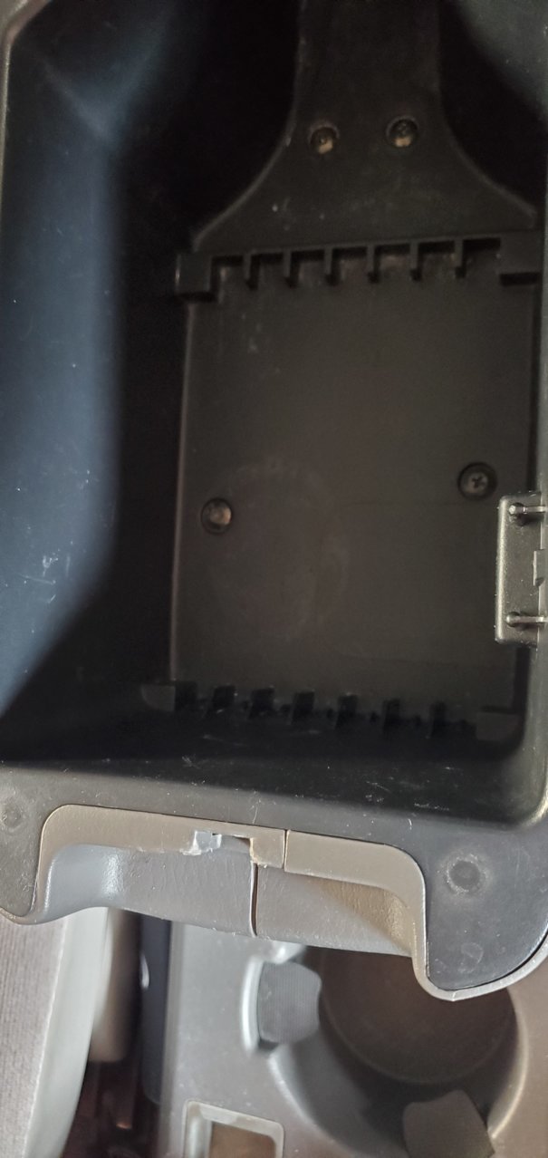

    Since I can't play CD's any longer with my Atoto S8 decided I was out of excuses for not making the center console more functional. Removed the slots and lined the inside with felt
