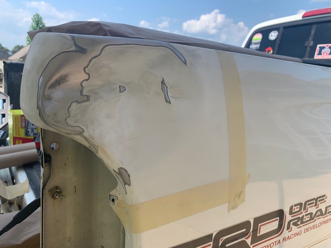

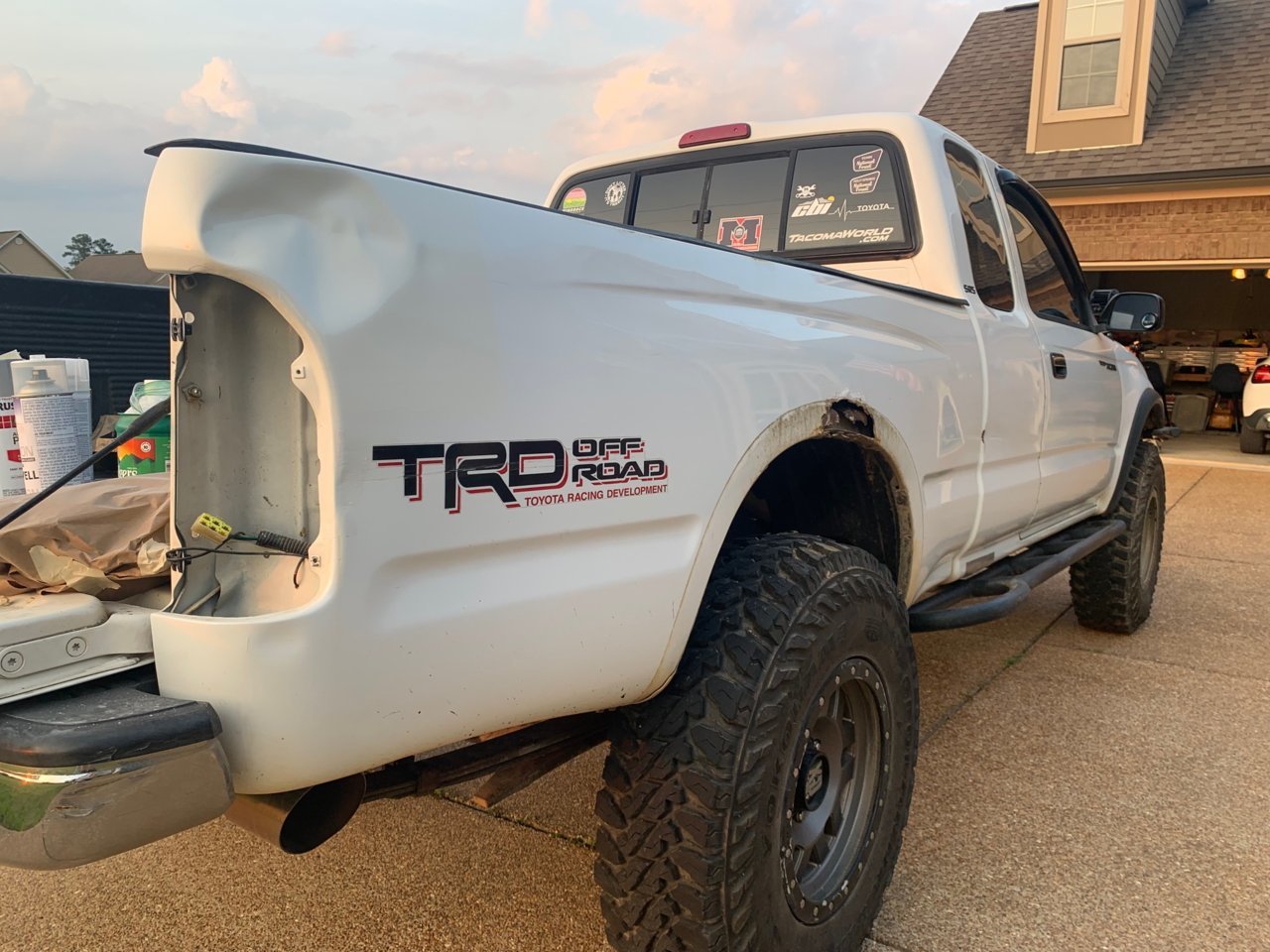

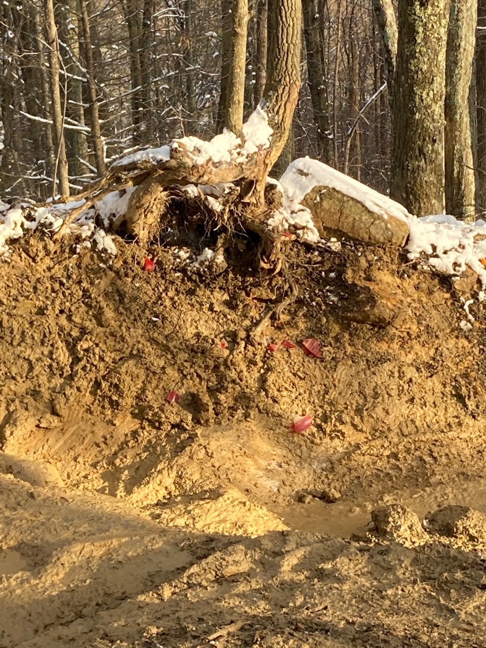

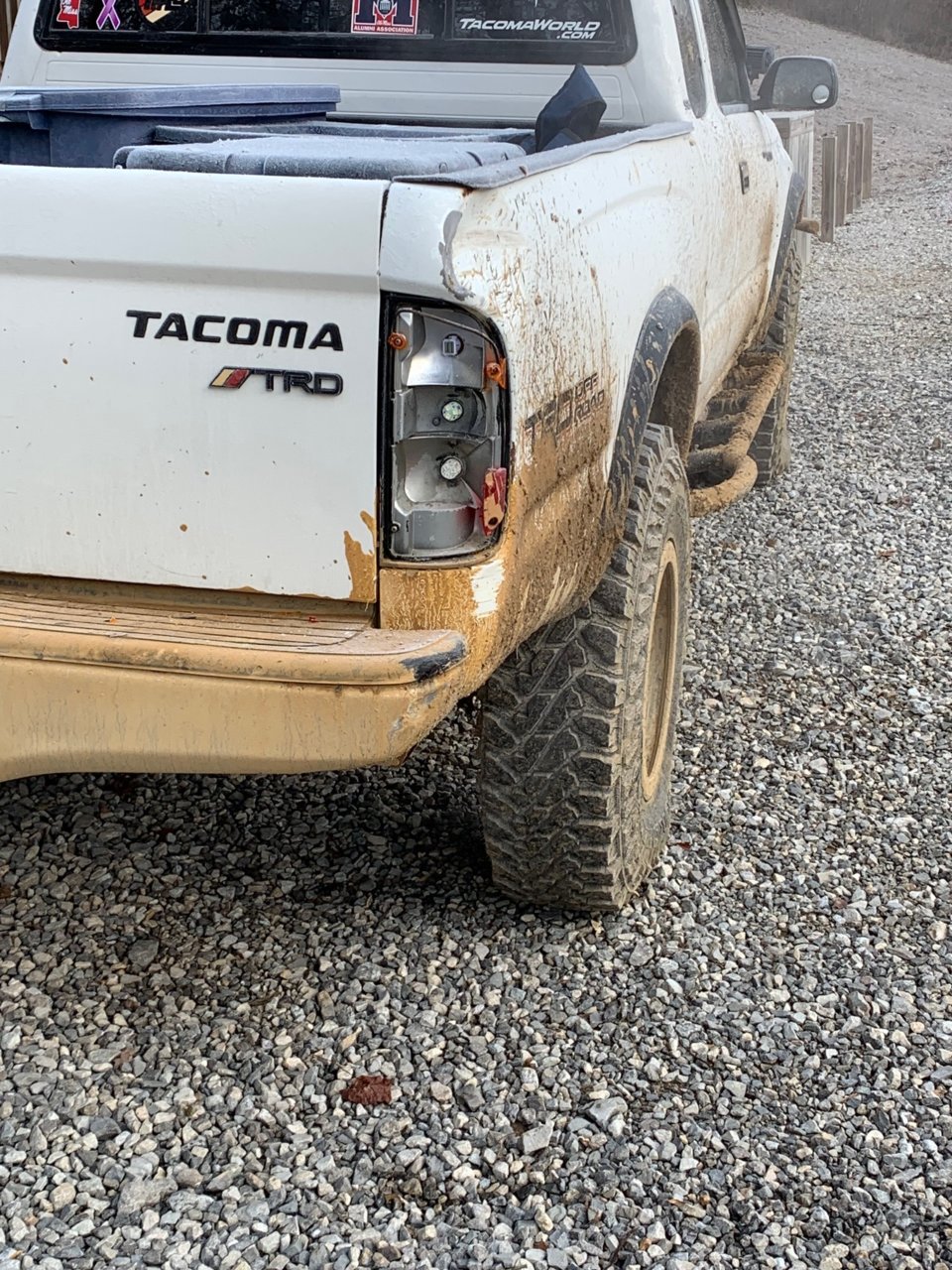

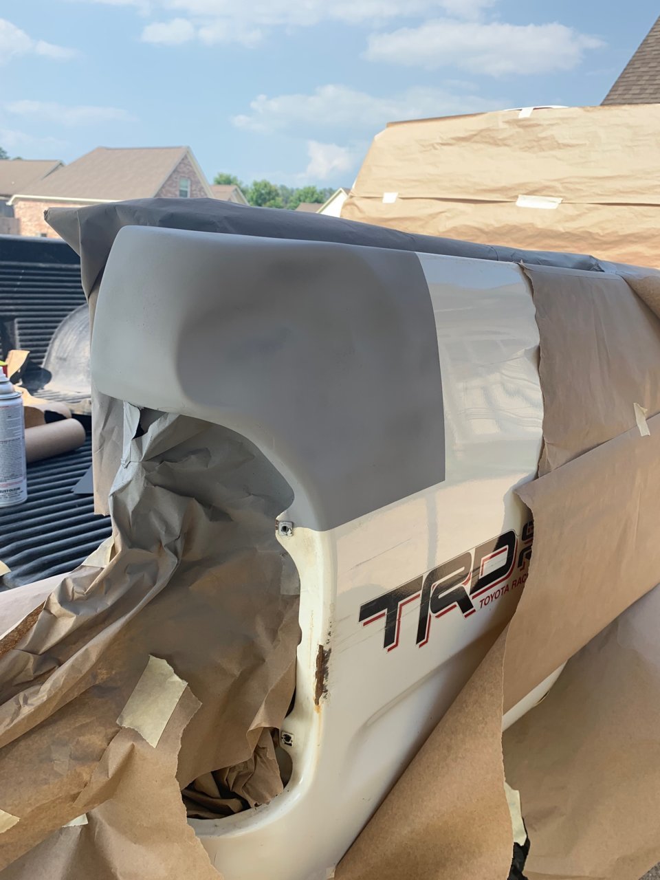

    Got this nasty dent in the bed at Windrock Park in January. Was climbing a muddy ledge and slid over and whacked the root of a tree. Busted my tail light too as seen in the first two pics. Tried to get the dent out, and I could have used a slide hammer to get better results (and I may do that in the future) but it's a tough one since its on a corner. Decided it wasn't worth it to pay someone hundreds to remove it so I just painted it. Color matched paint (056 natural white- the best white Toyota ever made). Came out alright, I think the factory paint has been bleached after 24 years, so not perfect, but looks like a factory dent:D
    Please don't mind the fender rust... Another project another time...IMG_0767_Original.jpg IMG_3083.jpg IMG_3786.jpg IMG_3787.jpg IMG_3788.jpg

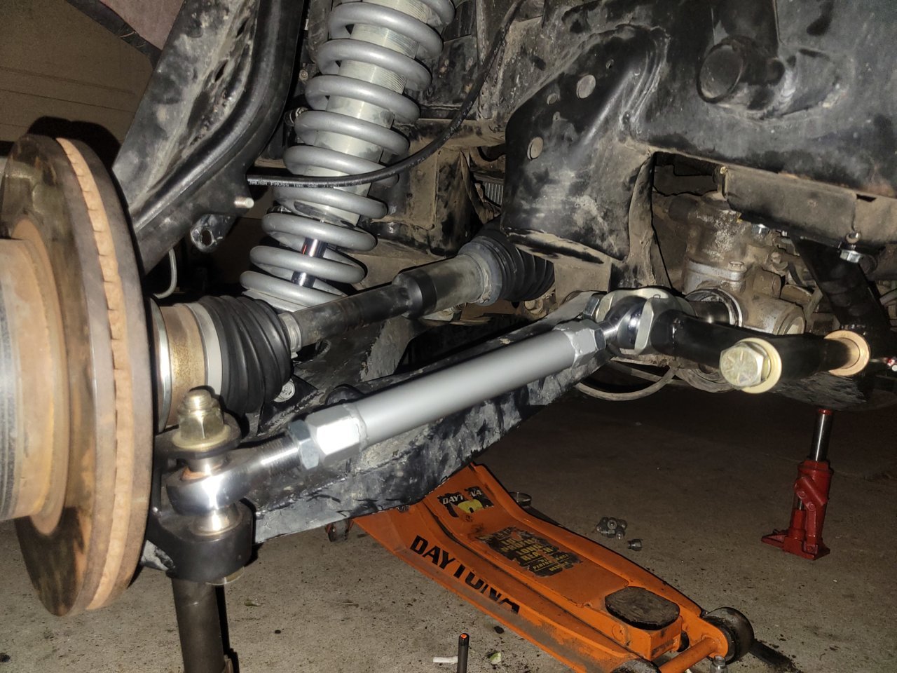

    @Michael05
    It'll look like this when he's done

    You should try and fit a football up in that spot and inflate it to push out the dent some.

    Yeah I thought of that. There's a wall inside of there that kind of angles. Can't get anything in there

    Ah okay gotcha. What’s the advantage of using heim joints over the normal ones and (because I plan on doing the TC lower uniball in the future too) is it better to get the heim version and get the heim steering arms just all at once?

    heim steering is a lot stronger than the stock tie rods. It's good for if you wheel your truck pretty hard, otherwise there's no real benefit to heim steering on-road.

    Yeah, as Ian said, stronger steering is better if you wheel hard, otherwise, I'd still to factory TREs. Fortunately Total Chaos does make a version that adapts to the factory tie rod ends. Biggest con for most however is that the rack and rack mounts become the next week point. Eventually I'll get around to building a rack saver like @El Taco Diablo did so I take as much stress of the rack and mount as I can, but that's another project for another day.
