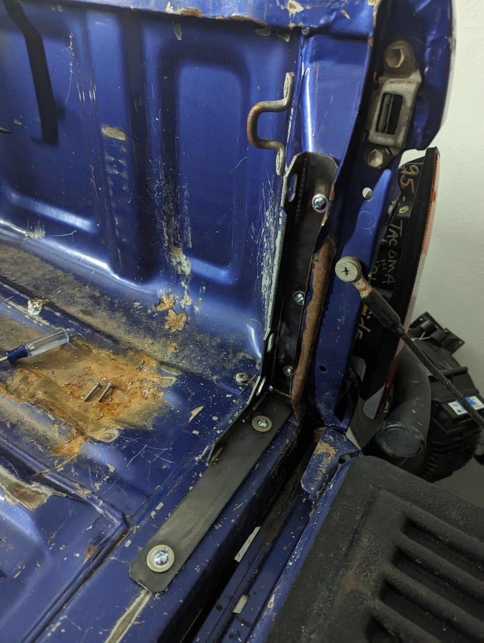

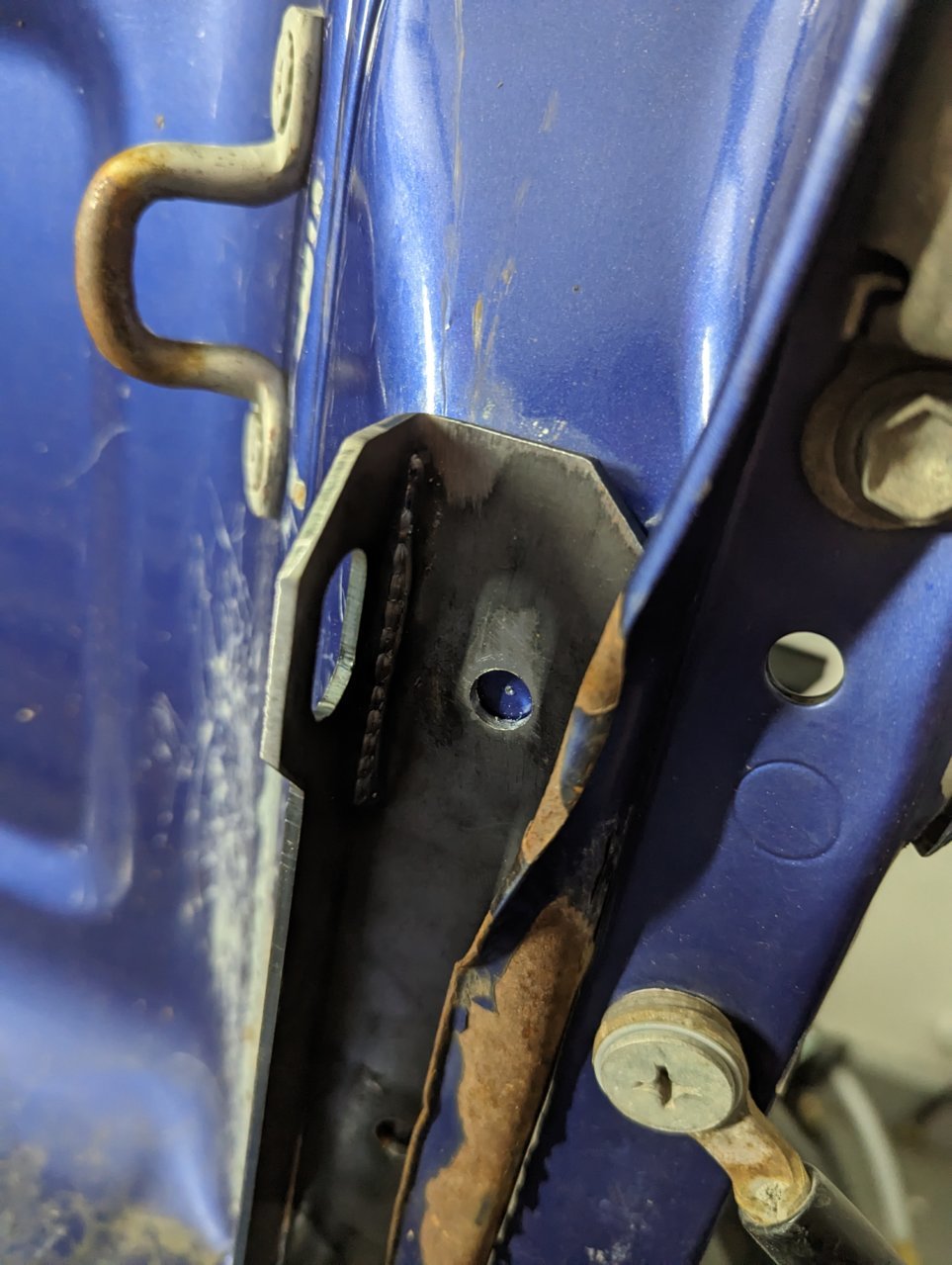

  1. May 31, 2023 at 7:35 AM
    Kwikvette
    Feb 27, 2019
    #284735
    80,958
    Fresno County
    4 run, 2 don't
    Sounds good

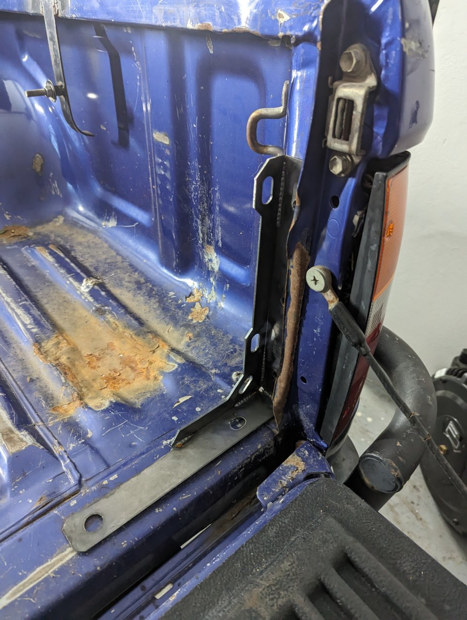

    Thinking of making one in 10 gauge and maybe have the bracing go farther along the bottom. Unsure if it'll be considered strong enough though.

    a better test candidate would be someone with a bed that doesn't look like a 20 yr old tuna can :luvya:

    The hopes and dreams that hold that bed together just need a little extra support :laughing:

    Haters can't tell me I didn't use my truck :luvya:
    Yeahhhh I plan to cap the bed rails with angle iron and tie that into the bed floor in the corners... Someday :laughing:

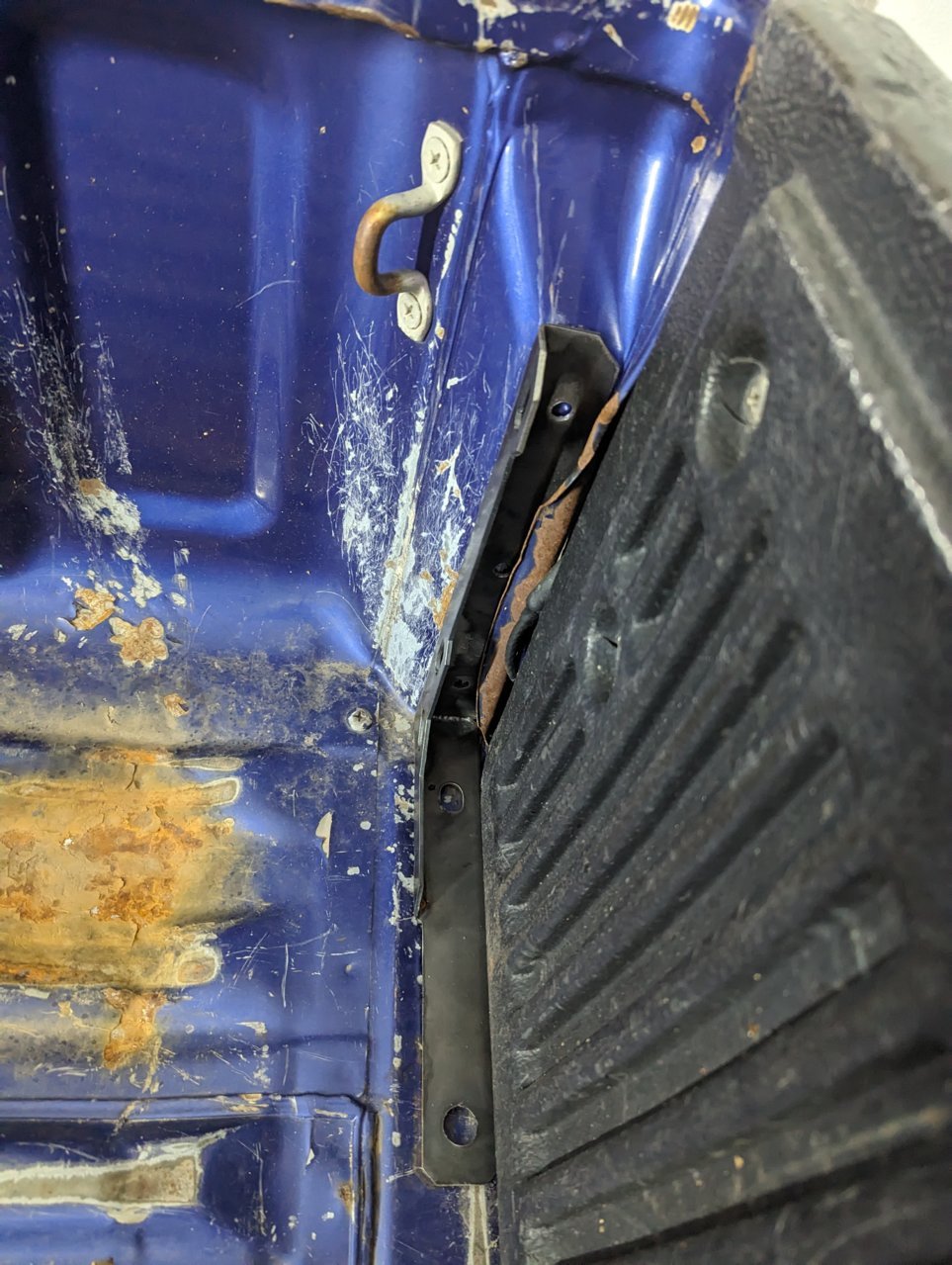

  5. May 31, 2023 at 9:00 AM
    m3bassman
    m3bassman Well-Known Member
    Jan 16, 2011
    #49376
    17,138
    Green truck
    What about the back side behind the tail light? When I built mine out of angle iron I also used so scrap 1/8" thick plate to put on the back side to distribute the load and prevent the thin sheet metal from pulling away with the stiffener. I'm sure some fender washers would do the same trick.
    BrownMike and Kwikvette like this.

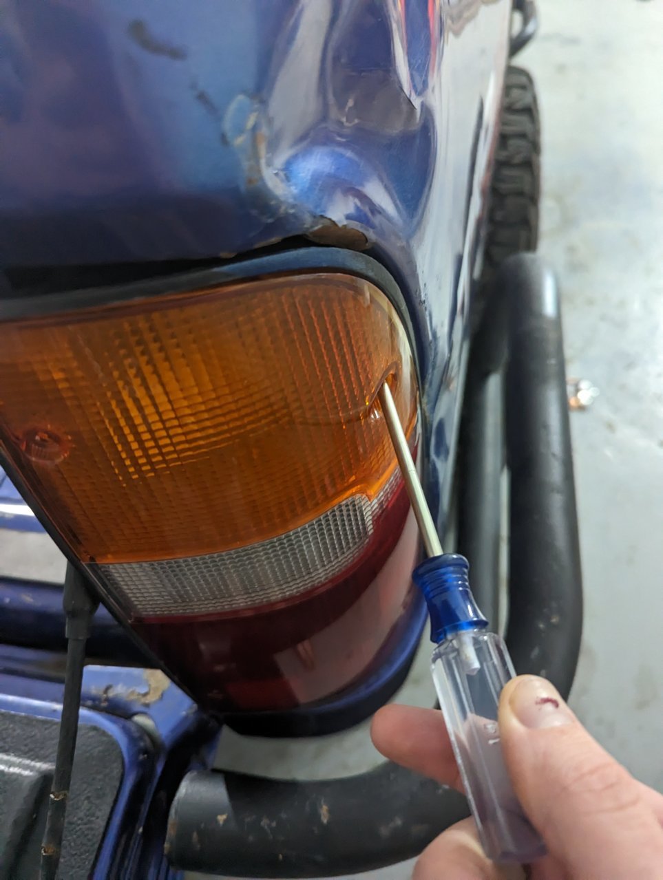

  6. May 31, 2023 at 9:13 AM
    Parkvisitor
    Parkvisitor Do you know midnight?
    May 27, 2019
    #294502
    2,350
    Juan
    So Cal
    It’s a truck
    stuff
    would some kind of metal plate, bar under the bed be a good idea?
  7. May 31, 2023 at 9:13 AM
    Wulf
    Wulf no brain just damage
    Jan 30, 2015
    #147523
    61,598
    rock raisin
    Yes, I would recommend adding angle iron across the bottom to tie both sides together
    That's a good call out, the metal is 2 or 3 layers there but adding more material on the backside would up the rigidity
  8. May 31, 2023 at 9:14 AM
    betterbuckleup
    betterbuckleup Well-Known Member
    Jun 26, 2017
    #222483
    4,771
    Ian
    Concord, CA
    2000 Tacoma SC 2.7 4x4 5spd
    i feel like you would have to have some serious weight on the bedsides to have the sheet metal pull away from a brace like that.
    If you fender washers, that should be good enough for supporting the load back there
  9. May 31, 2023 at 9:20 AM
    Kwikvette
    Feb 27, 2019
    #284735
    80,958
    Fresno County
    4 run, 2 don't
    That's a great idea; I can just cut some out and pre-drill them if someone wants to opt for that.
    Guess the real question is, is the area behind the light housing flat? Or would this only be for the bottom?
  10. May 31, 2023 at 9:22 AM
    Parkvisitor
    May 27, 2019
    #294502
    2,350
    Juan
    So Cal
    It’s a truck
    stuff
    is the bottom of the bed open to the backside of the tail lights? I don’t remember
  11. May 31, 2023 at 9:24 AM
    Kwikvette
    Feb 27, 2019
    #284735
    80,958
    Fresno County
    4 run, 2 don't
    I don't have a Tacoma to say.
    Maybe if you get bored one day you could check yours out?
    Large washers would help as mentioned. I just thought it was a great idea to add a support plate, and see what type of clearance is needed for said plate.
  12. May 31, 2023 at 9:28 AM
    Wulf
    Jan 30, 2015
    #147523
    61,598
    rock raisin
    It's not entirely flat, I will have to take measurements and pics -- the bottom hole on the vertical support needs to move a little bit
    Kwikvette[QUOTED] likes this.
  13. May 31, 2023 at 9:30 AM
    Kwikvette
    Feb 27, 2019
    #284735
    80,958
    Fresno County
    4 run, 2 don't
    Forgot to mention, don't paint the set you've got.
    Final revisions (holes in the same place since you already drilled yours) will be applied to the set I send you once you've given me your thoughts and opinions.

  15. May 31, 2023 at 9:47 AM
    m3bassman
    Jan 16, 2011
    #49376
    17,138
    Green truck
    Yes, or fender washers too. It may be over kill but I figured you do it once and not have to worry about it.
    My concern was that it's not a lot of contact area for the hardware and it would be a bigger headache of the sheet metal started to pull way. Not sure if it is a real issue but might as well make it a non-issue. At the time I had a 100# tire hanging off a tire gate so I had a lot more concern of the material pulling away.
    If you have a RTT with a rack it can push the bedsides out over time on rough roads. Peace of mind for me was ensuring that it stayed rigid, not to mention it doesn't take much time or material to add it. I also at one time had a tire gate that was hanging off the back that put a LOT of force on the corner of the bed.
    It's flat enough. I didn't mention it but I did the same thing on the bottomed side of the bed.

    Front end of the bed needs to be reinforced as well if you're carrying weight on the rails and bouncing around in dirt a lot.
  18. May 31, 2023 at 5:43 PM
    Parkvisitor
    May 27, 2019
    #294502
    2,350
    Juan
    So Cal
    It’s a truck
    stuff
    please elaborate where reinforcements are needed.
