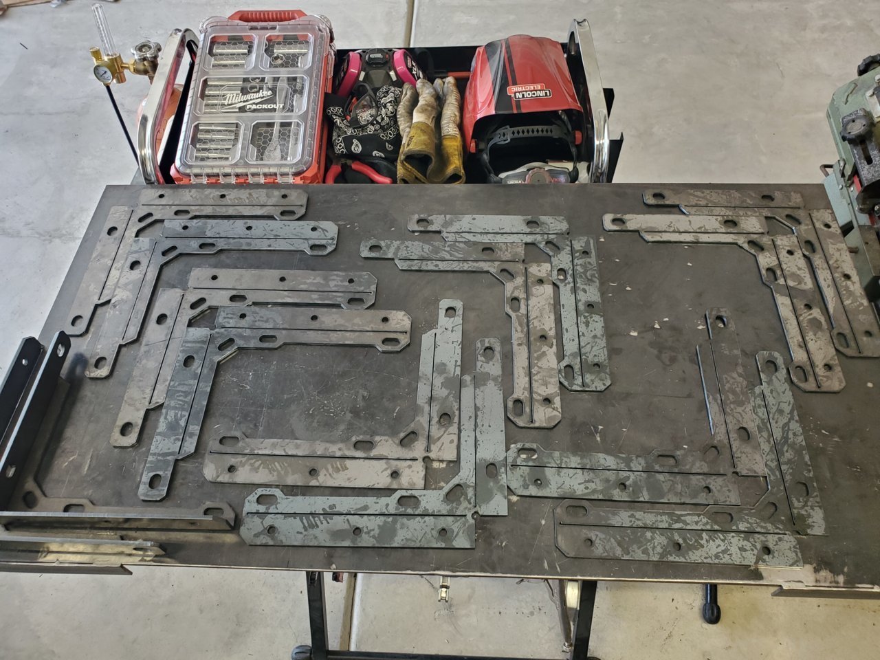

  2. Jun 2, 2023 at 1:43 PM
    Kwikvette
    Feb 27, 2019
    #284735
    82,916
    Fresno County
    4 run, 2 don't
    Made more in case another 1st Genner needs a set or two:anonymous:
    1 x 3/16" unspoken for and 2x 10 gauge unspoken for.
    Will be welding and cleaning them up in the next day or two; just kind of slow taking care of a newborn :burp:
    unstpible and Tour991 like this.

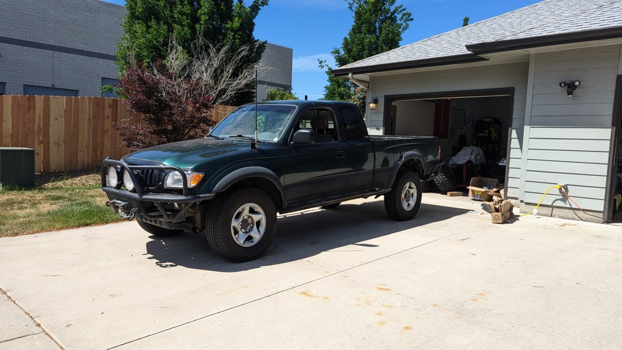

  16. Jun 2, 2023 at 11:01 PM
    m3bassman
    m3bassman Well-Known Member
    Jan 16, 2011
    #49376
    17,138
    Green truck
    Because we are in the pursuit of speed! The small tire will help at the drag strip to improve on our 16.6 @ 85mph we had with the 2.2" pulley and 35s. The LS engine I'm building should be good for 400 hp before I throw nitrous at it, which should get us into the 13s. Yes, I am LS swapping the Tacoma and hope to breach 100 mph in the quarter. As far as I've seen, that hasn't been done with a 4x4 Tacoma, ever. Before that engine goes in I want to see how much I can muster out of the 5vz with the supercharger. We have a few months to go but I recommend following the thread below as I work my way through this iteration of the green truck.
    https://www.tacomaworld.com/threads/ls-swapping-a-4x4-tacoma-chasing-100mph.801870/
    I told my wife we would be ditching the 35s for good but I'm not sold now. Kinda want to keep them around for DD duty and the stockers for track duty. I don't feel a huge difference in the seat but if the times are there I may stick to the smaller rubber.

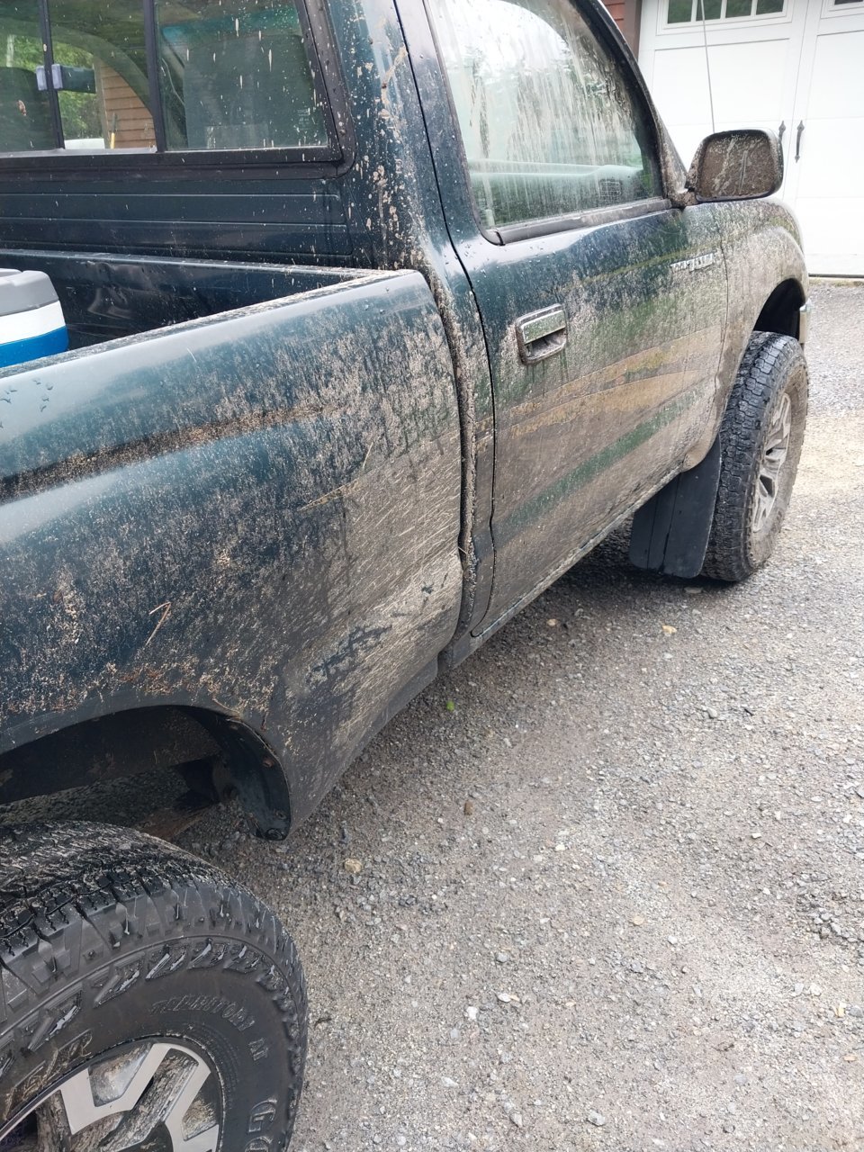

  17. Jun 3, 2023 at 9:28 AM
    1grntaco
    1grntaco Well-Known Member
    Apr 23, 2023
    #423095
    80
    Sean
    1995 rg cab 2.7 4x4
    First time on the trail, overall very pleased. Needs better tires for the trail, but not bad20230603_103545.jpg
    jubei, Phessor, Tour991 and 2 others like this.

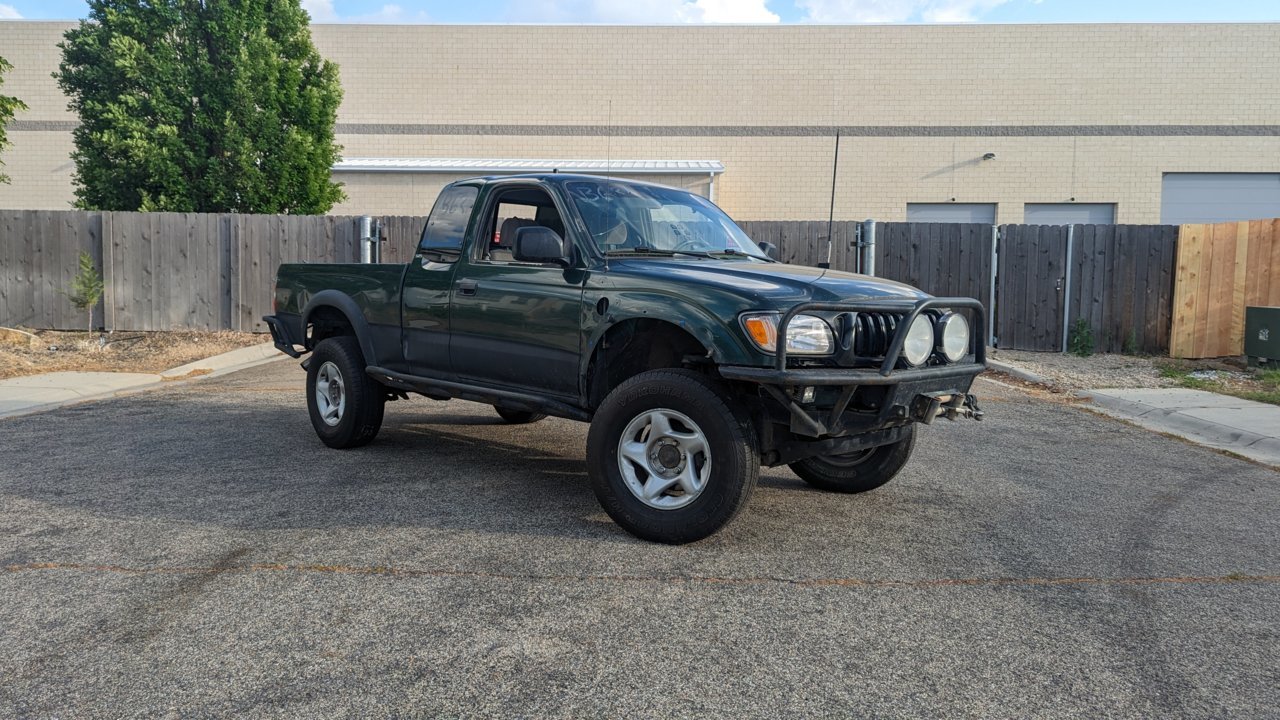

  18. Jun 3, 2023 at 12:01 PM
    m3bassman
    Jan 16, 2011
    #49376
    17,138
    Green truck
    Got the truck back on stock suspension. I want to go a bit lower, especially in the rear but I think this is a good improvement. Rear also needs softened as it's way to stiff but overall it's coming along.
    Rear shocks were well sized to the studs, lots of wd and prying wasn't getting far so I used the 15k winch on the van to pursue them. Sometimes my genius knows not bounds.
    Kevins60, unstpible and Phessor like this.

  20. Jun 3, 2023 at 5:40 PM
    Kwikvette
    Feb 27, 2019
    #284735
    82,916
    Fresno County
    4 run, 2 don't
    I really need a 1st Gen near me...shit would take me like 1-2 mins for dimensions
    Got @Wulf set ready to go almost
