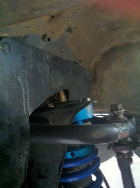

    Finaly got my UCA's put on

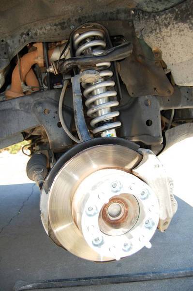

    Finished installing my allpro expos, billie 5150s, SS brake line, and 1.5" wheel spacers.:yay: Once I bleed the brake lines in the morning, I'll be able to drive her again!!!!! :D
    Allpro wheel spacers
    Old vs. new :D
    Got some u-bolts from a local shop that specializes in semi-truck suspensions! lol. $36 for 4 7 1/2" u-bolts and it only took the guy 10 min to make.
    During the install... only had one leaf pack on and no shocks yet...
    Didn't get a final picture yet, because i left the tires off so I could bleed the lines easier in the morning...

    Nice man glad to see you got the Expos i hope you got the 10.5" travel shocks. And seeing those jack stands sitting on 2x4's makes me cringe :eek:
    Take a trip to Harbor Freight and pick up some 6 ton jack stands.

    X 10000000. Cheap insurance for your life and your truck's life. You need 6 tonners to reach the frame rails safely on most any suspension/wheel task. Even then, I get nervous about the asymetrical surface on the underside of the frame rails at the support points, which don't fit the top of the jackstands very well. I triple-check them every time before I get under the truck.

    :eek: yeah.... I know... lol Some 6 ton stands would've saved me time too, since I had to cut up all the wood and then set them up *perfectly* so they wouldn't get me injured/killed.
    I got the 10"... That's what Jason recommended and they seem to be doing okay... I didn't know they had a 10.5"... =\ I'm getting about 6" of exposed stem on each side.. but of course the leaves should settle a little lower so *hopefully*, it'll go down a little.

    Yeah my bad I mean 10" that's about what I have exposed about 5 3/4th"

    Ok cool. Yeah, right now the passenger is at 6 3/8" and the driver side is right at 5 3/4". They're different because I used the original mounting points.... probably should've gotten a longer one for the passenger side, but oh well.

    Just change the mounting points /\ :D

    Yeah, I was going to say it is probably easier to relocate the mounting points.

    I wanted too!! but I don't know how to weld...... :(
