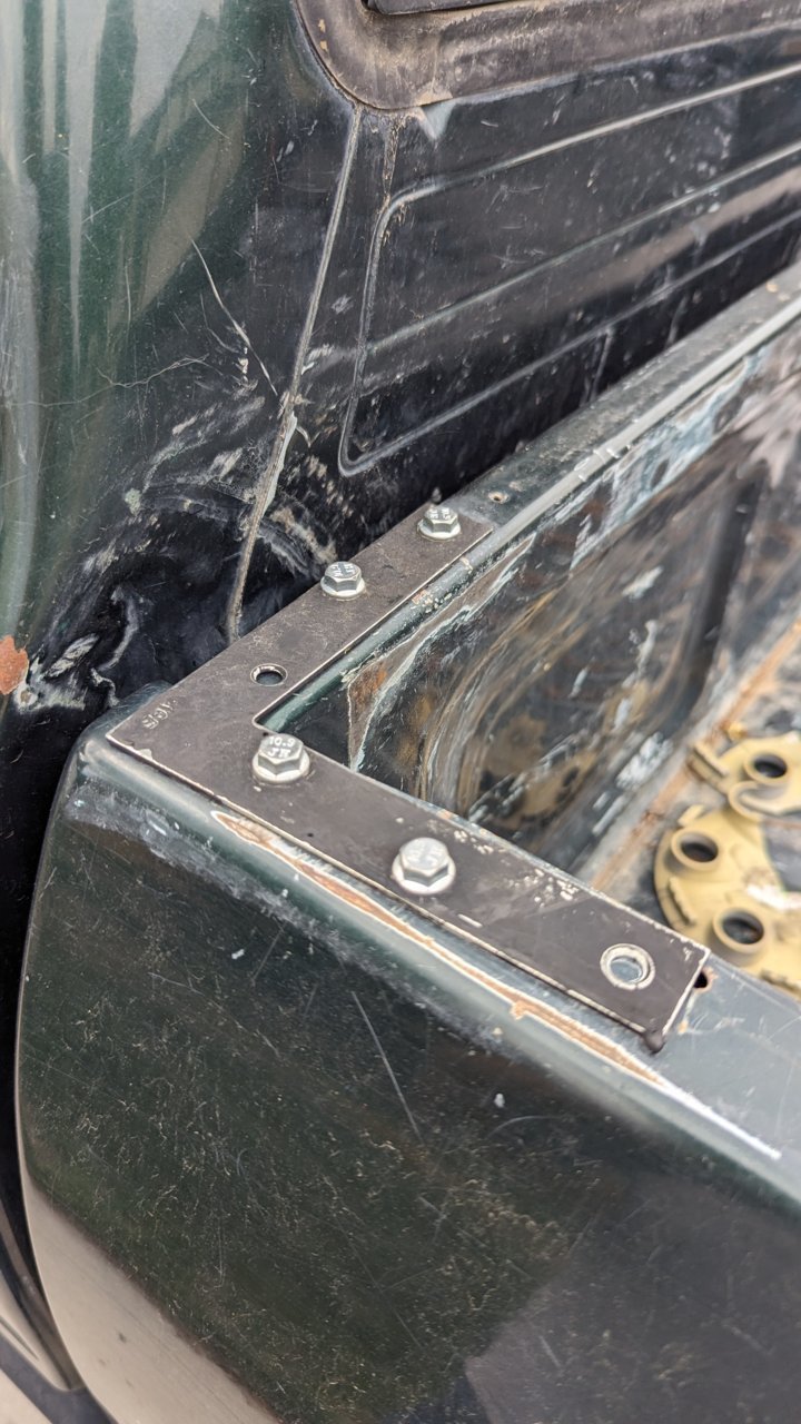

    Do you want the measurements of the ACE hardware L brackets I used or of the bed itself?

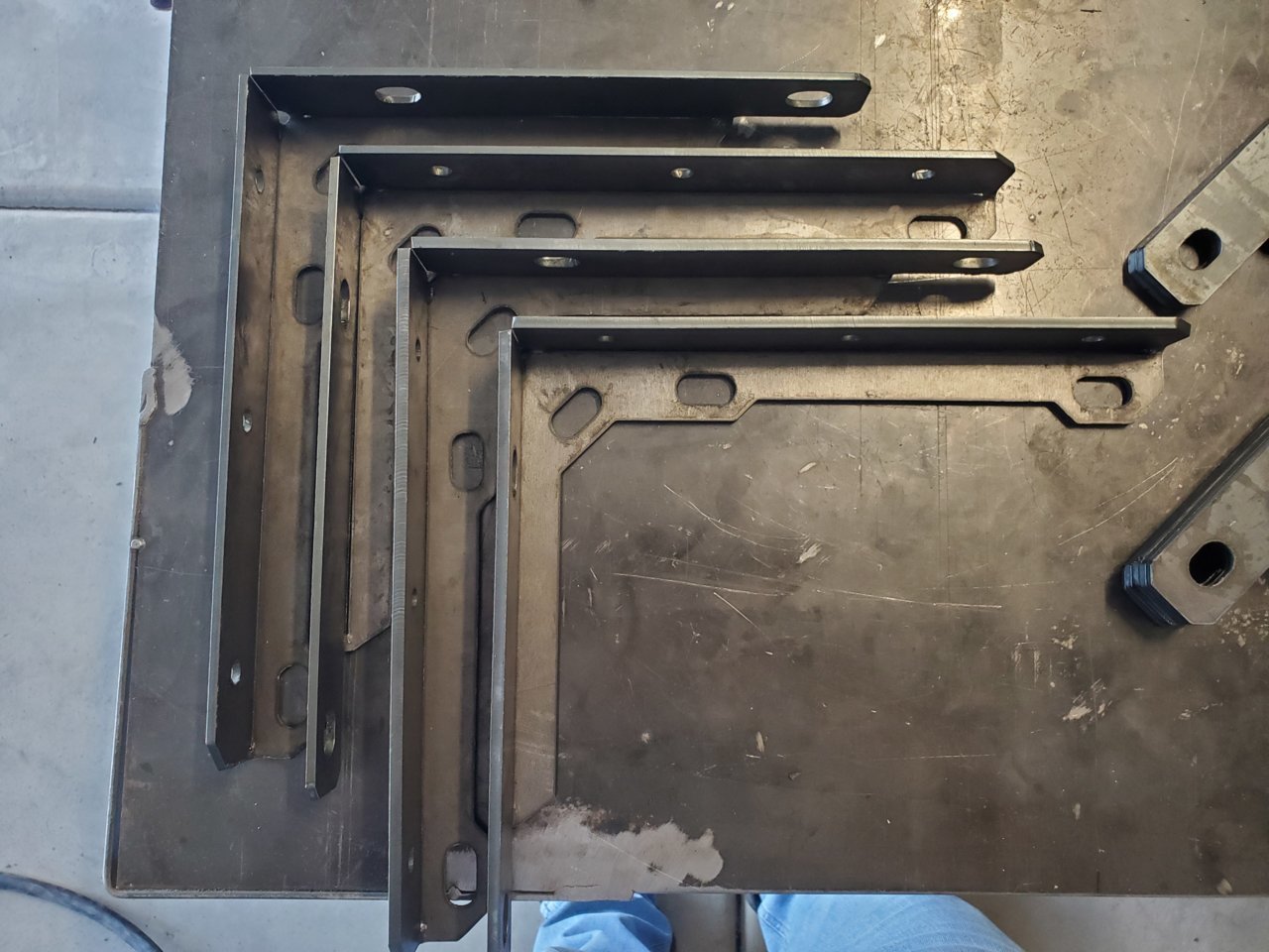

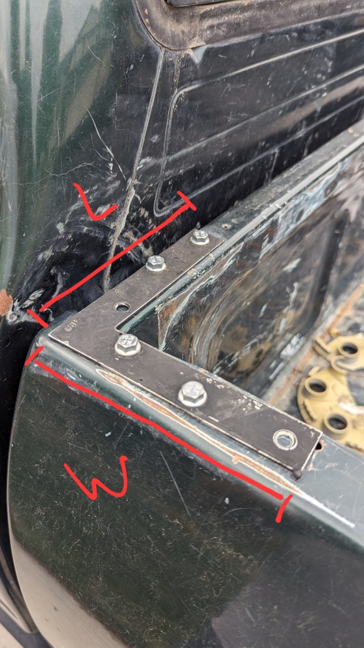

    Just the outer dimensions L x W and width of said steel.
    Also, did you drill that bolt on the top side offset for any specific reason? Something in the way?
    I'd want to predrill holes and make the L out of the same thickness the bed stiffeners are since there's plenty of left over steel on my large sheet.

    I'll get you some tomorrow (can't find my tapes after last weekends fence project). I can tell you the hole pattern was based on the predrilled holes on the L brackets. Nothing in the way, just some self tapping tex screws and called it a day. Plenty of stiffness for my uses.

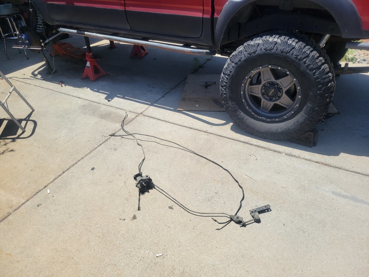

    Step 1 done

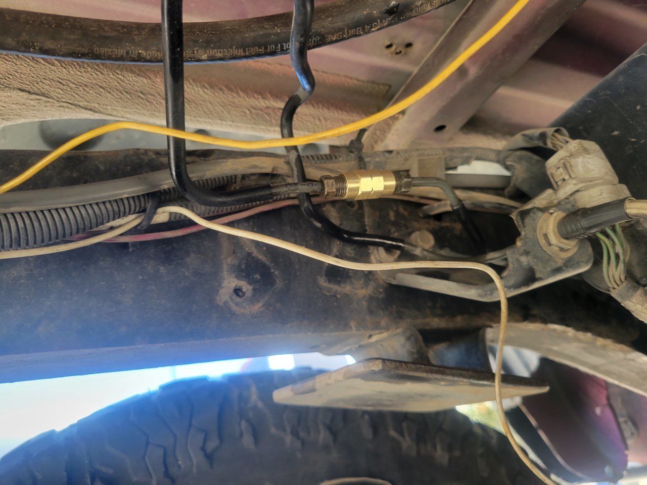

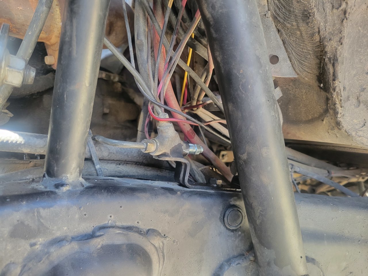

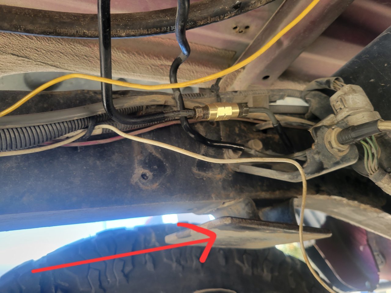

    Ok, so I plug the return line fitting with a bleeder screw.
    For right now, I just used a union fitting to attach the rear pressure line with the line that was coming off the LSPV to the hard line/soft line connection. (mostly to just stop the leaking while I work on the rest of this in the back)

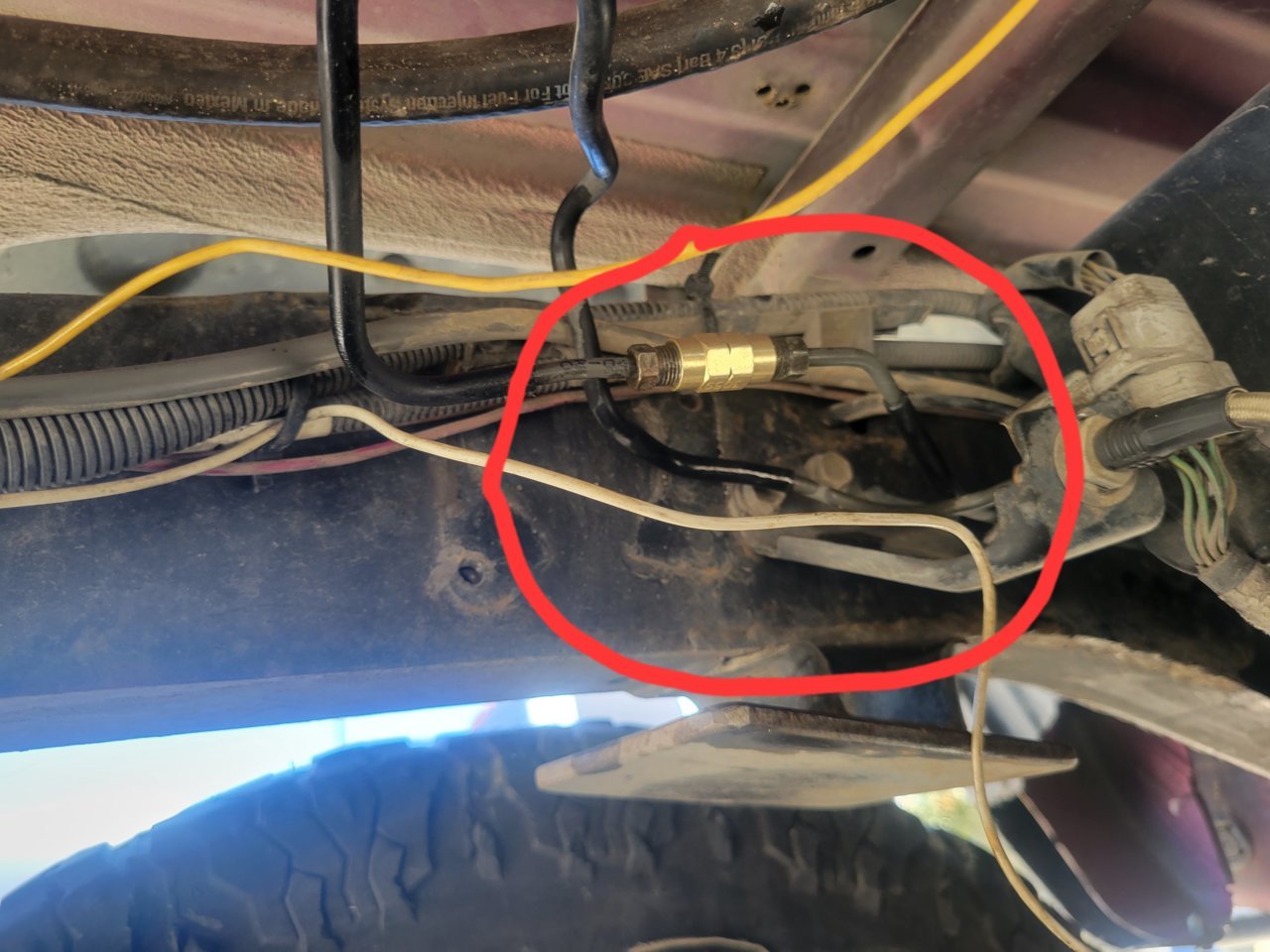

    I need to get this whole area of the frame cleared, for the next project I'll be working on.
    So I'll need to relocate the hardline/softline bracket.

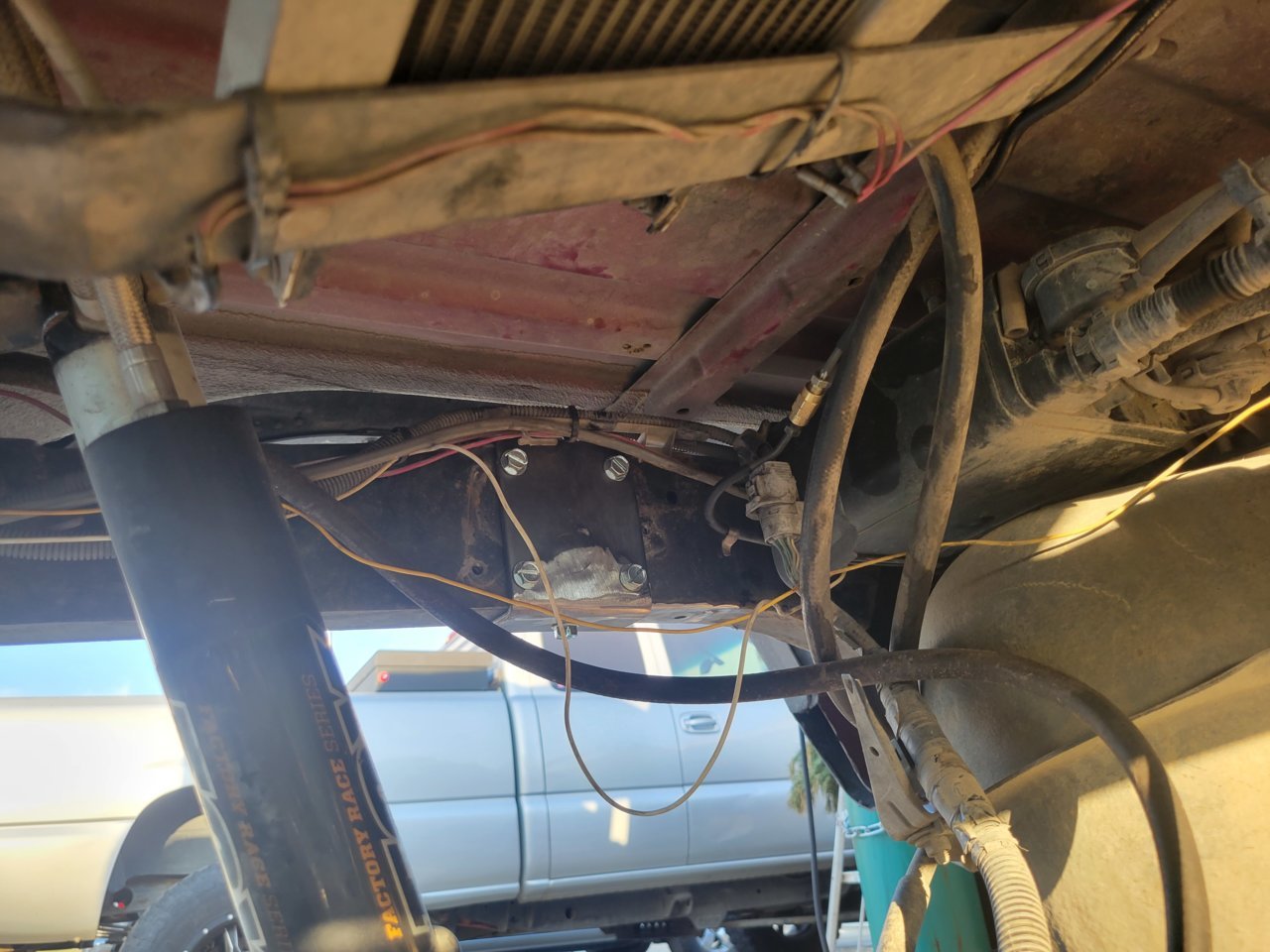

    As we can see, the stock bumps are a bit squished.
    Upgraded rear bump stops is the next project. We'll see how that goes, when I get there.
    I must have hit some pretty big curbs at the mall or something. :notsure:

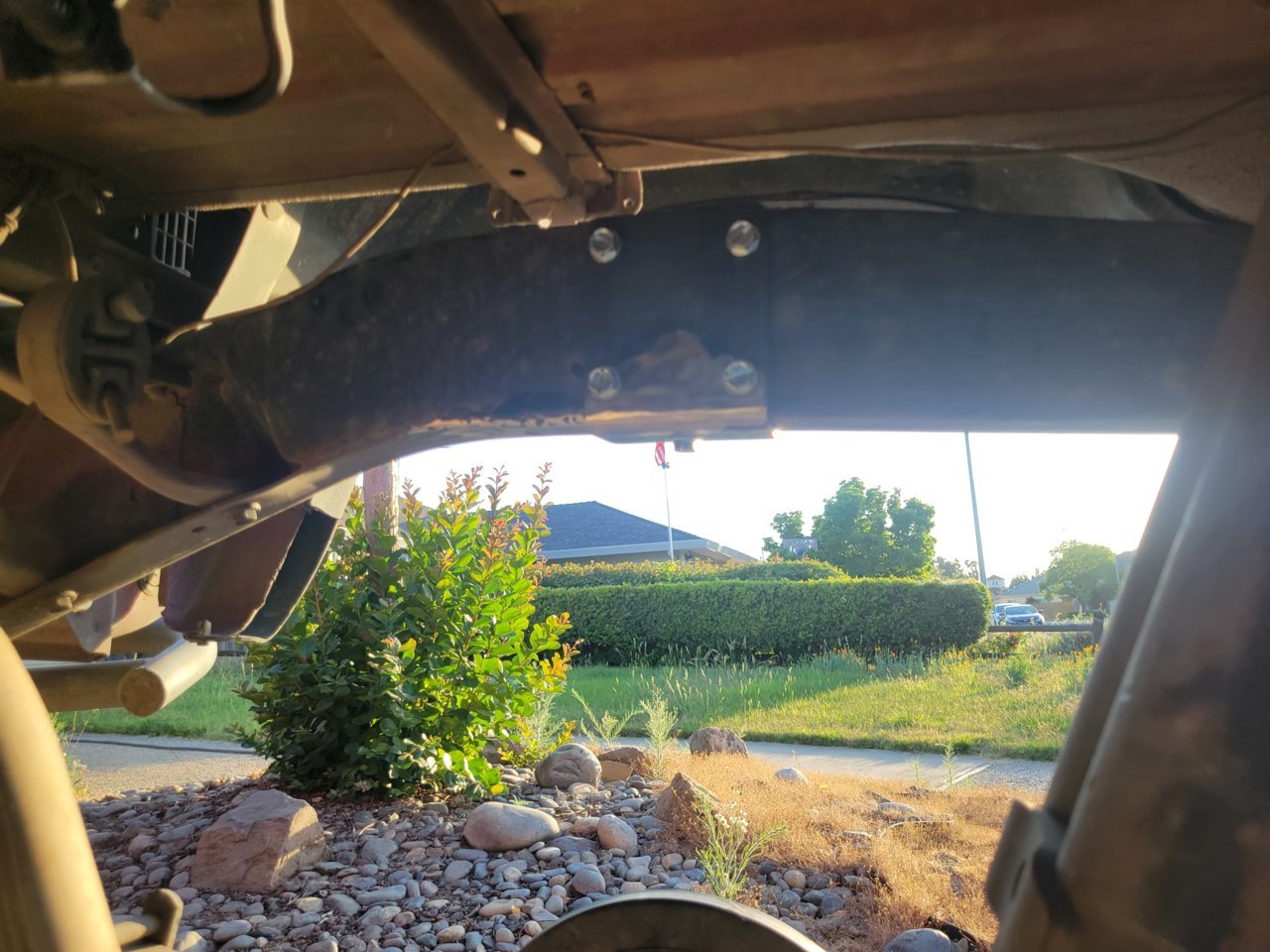

    Old bump pads are gone. New bases for the hydrobumps are bolted in place.

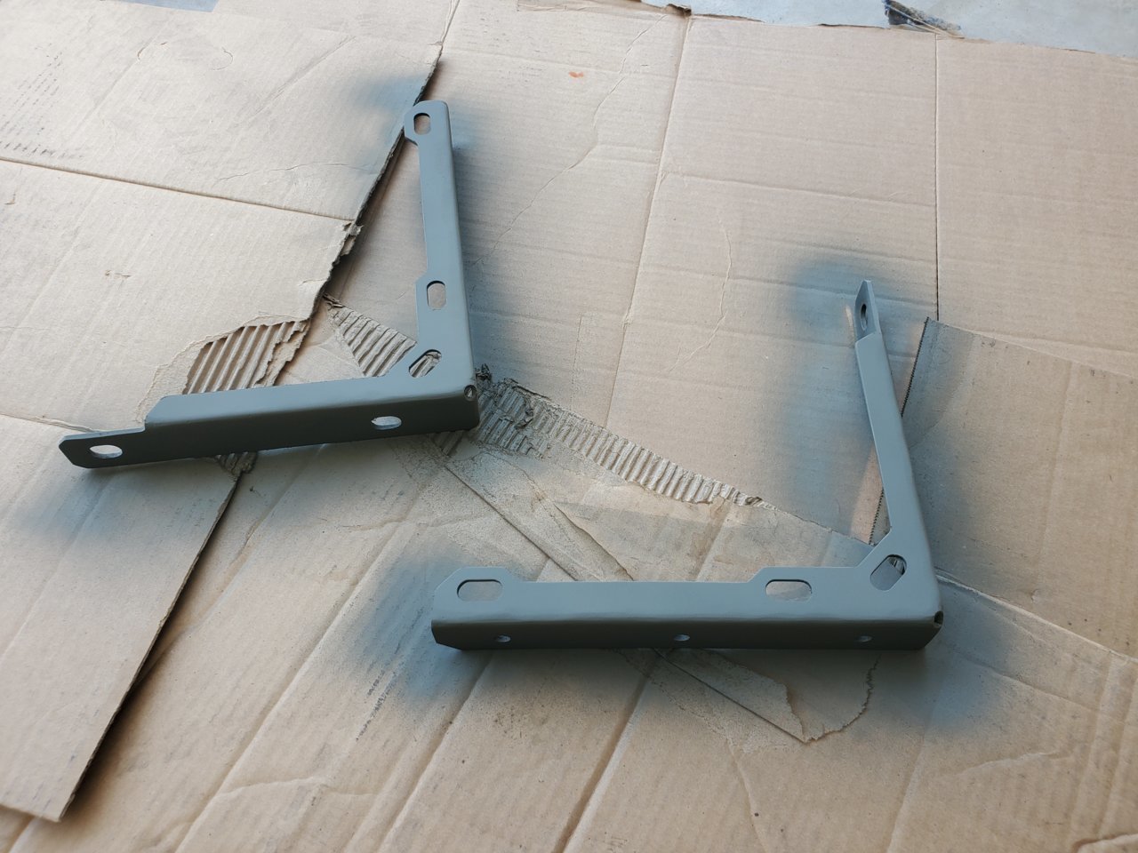

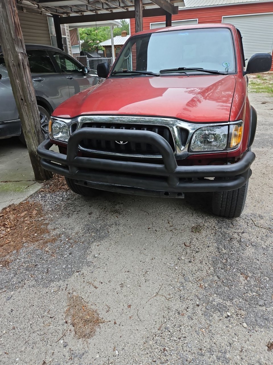

    Dodge Dakota bumper on my 2002 Tacoma S-Runner extra cab. Custom homemade brackets.
    Wulf and Pyrifera like this.

    I went ahead and left the main bumper bar for additional deer stoping power, so i had to factor that in for my mounts.
