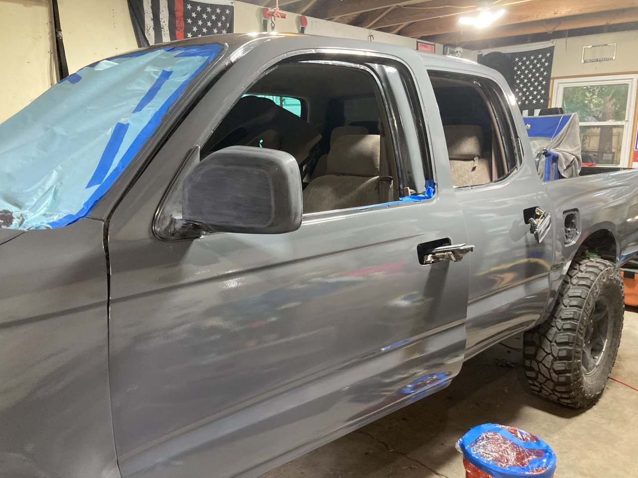

    @K-DubTaco looks great. Did you prime, basecoat, clear coat. I was pricing paint out and it seemed like it was gonna cost me $800-$1000. What did you use for paint? It came out looking great!

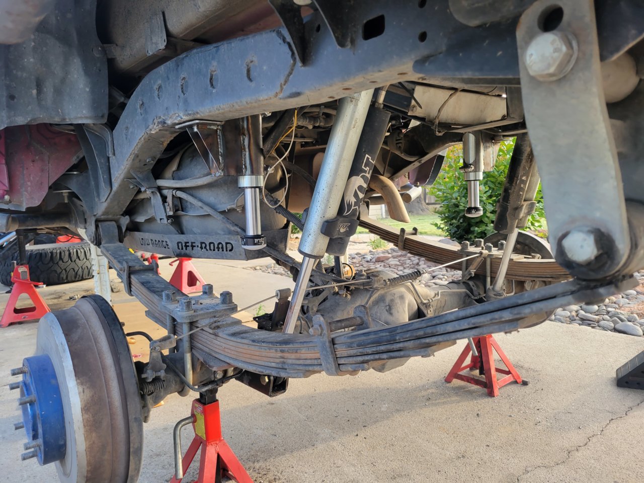

    Makin some progress

    yes give the details!!! I am going to be doing a garage paint job soon! Was going to just rattle can it and maybe wet sand or whatever… maybe a cheap HF spray gun is in order…

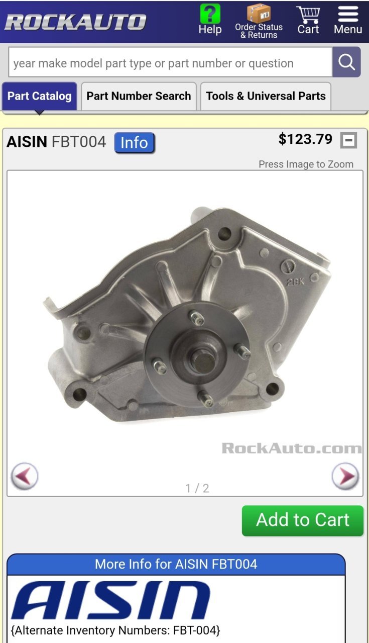

    Anyone have recommendations for replacing just the fan pulley bracket on a 3.4? Mine is wobbling and I believe is the source of the bearing noise I'm hearing.
    I can't seem to find the bracket by itself, it's always bundled with the fan clutch and outer pulleys, and around $600.
    Prefer not to use Amazon if possible

    When I replaced mine, I got it from RockAuto. It was OEM (Aisin)
    ***Edit... just looked, they still have them.

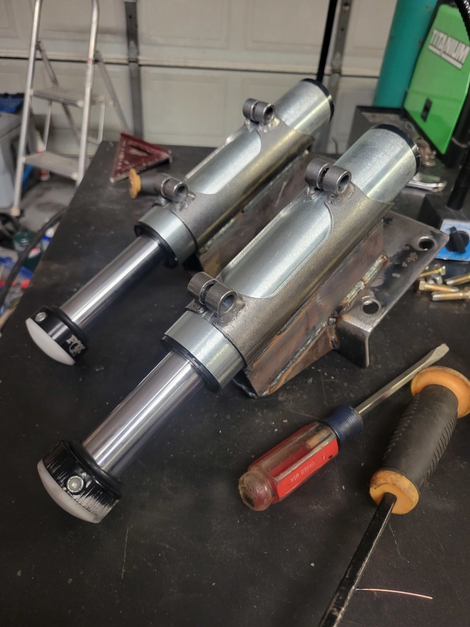

    Hydrobumps are in...
    Measurements for the pieces for the strike pads are sent to @Kwikvette
    Now we let his magic laser table do some shit.

    Thanks! Exactly what I was looking for

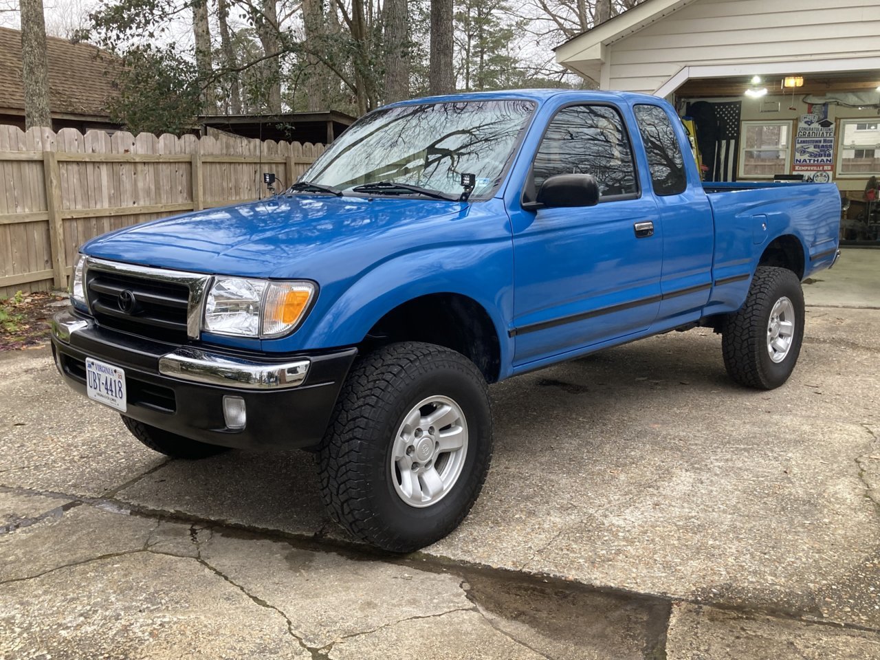

    It’s actually rolled on Rustoleum from Lowe’s. I read several posts and an article in Hot Rod Magazine about painting cars this way. I did my 98 back in December. I get compliments and questions about it all the time. It takes longer to paint it that way, but the results are pretty awesome. There’s no clear coat. It’s an oil based acrylic paint. I’ve seen up to 7 year follow ups and the paint is still just as shiny. After you let it cure for a week or so, you buff it with McGuires compound, then polish it. After that it’s just slapping some wax on it. I’ve had people tell me it looks like a $4,000-$5,000 paint job.Here’s my 98.

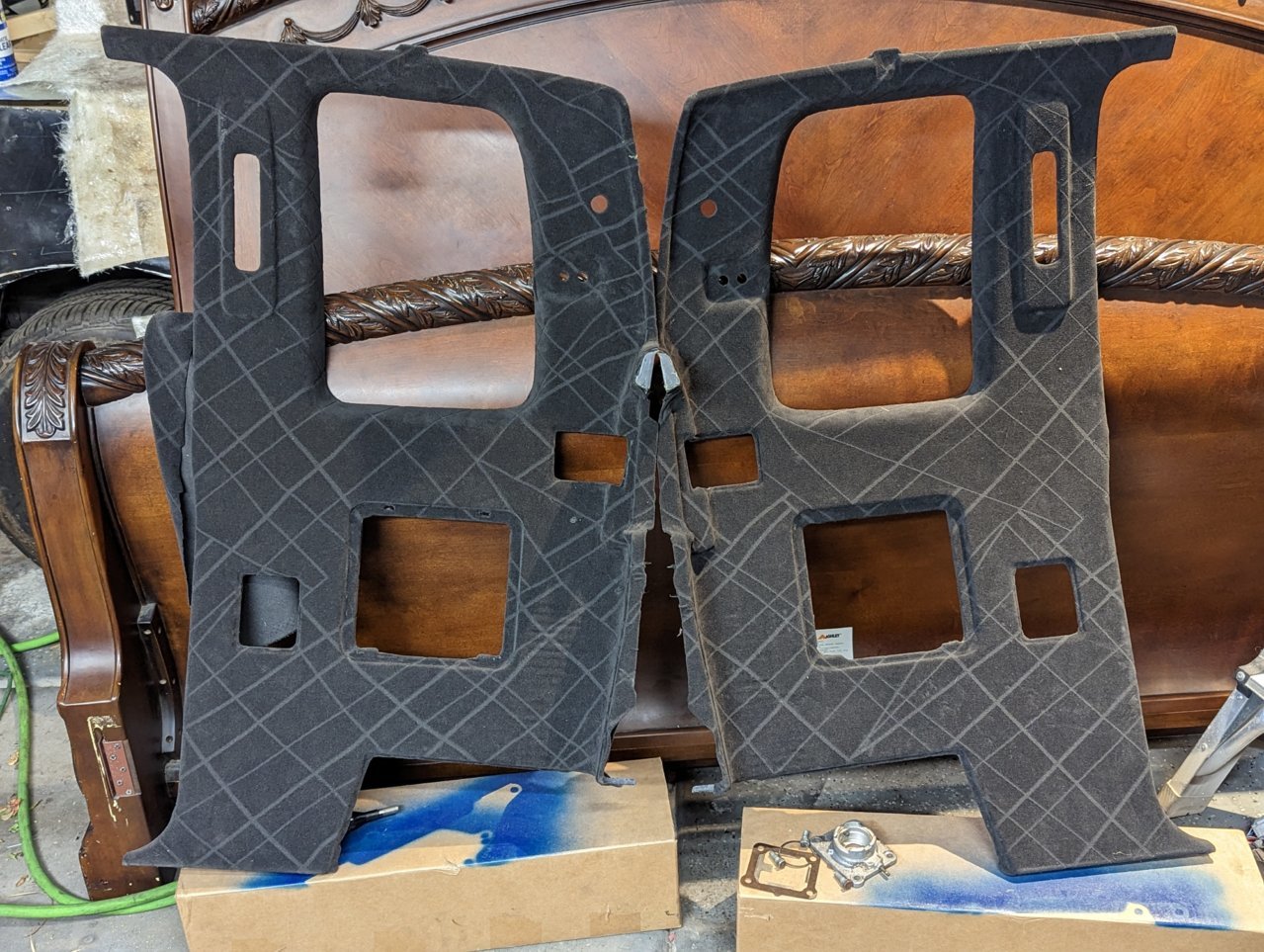

    Little upholstery

    Did you get replacement retainers? I tried to find them when I removed mine and could never figure out the part number

    Which retainers? I haven't had these in for a while but nothing broke on the way out that I remember

    might go this route. But not to worried about the dents. Im sure it will make shit harder to paint tho

    Dang that looks great man, both trucks!!! I’m sold! I was going to rattle can my hood, fenders and bedsides but this looks epic! Do you know the product name and/or have a link to a write up etc?

    If you live anywhere remotely sunny, don't do it. 5-year lifespan

    Oh really! SoCal is pretty sunny. Guess back to rattle can special!

    Well.. rattle can is rustoleum too
    I did mine with a Harbor freight gravity feed in college using the Rustoleum "professional" quarts. Looked great the first few years, but was a constant headache taking care of it and it eventually faded pretty bad. A shop dripped brake fluid on it, and it stripped in those places completely.
