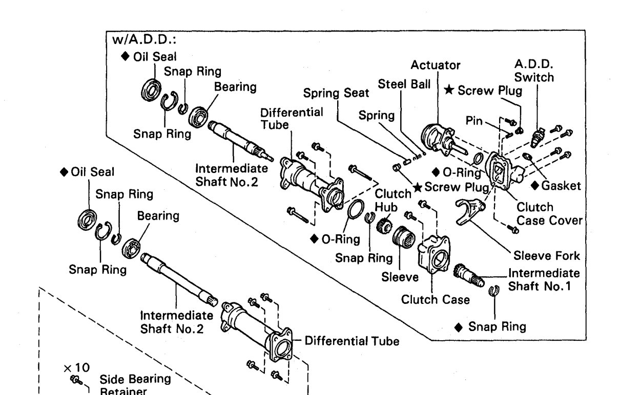

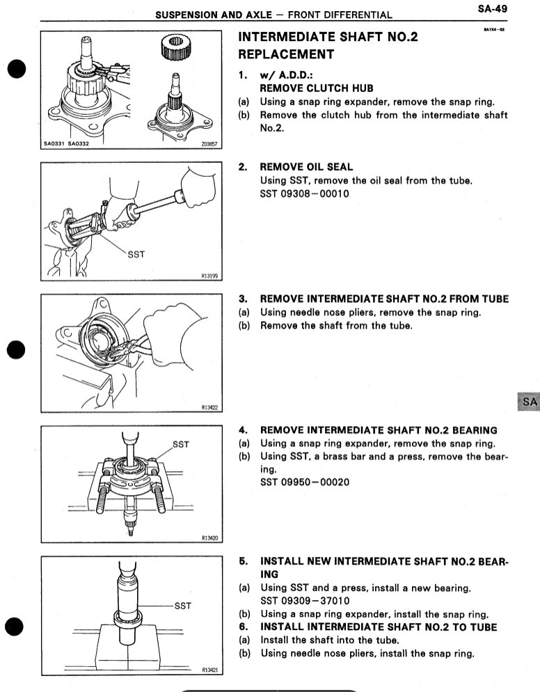

    Does anyone have the pages of the FSM that include servicing the bearing in a non ADD front diff tube? Looks like remove the outer c clip, press the shaft out with the bearing, then remove the inner c clip, and press the bearing off the shaft but I would like to confirm.

    Don't forget a new seal too!

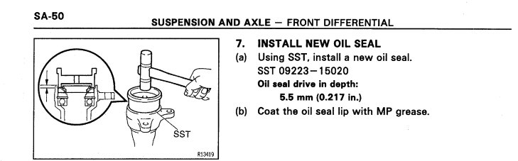

    here you go boo
    step 6 is mysteriously missing but it shouldn't be too hard to figure out :D

    :cheers: Knew this thread would have my back. And don't worru @Kwikvette already got the seal. :thumbsup:

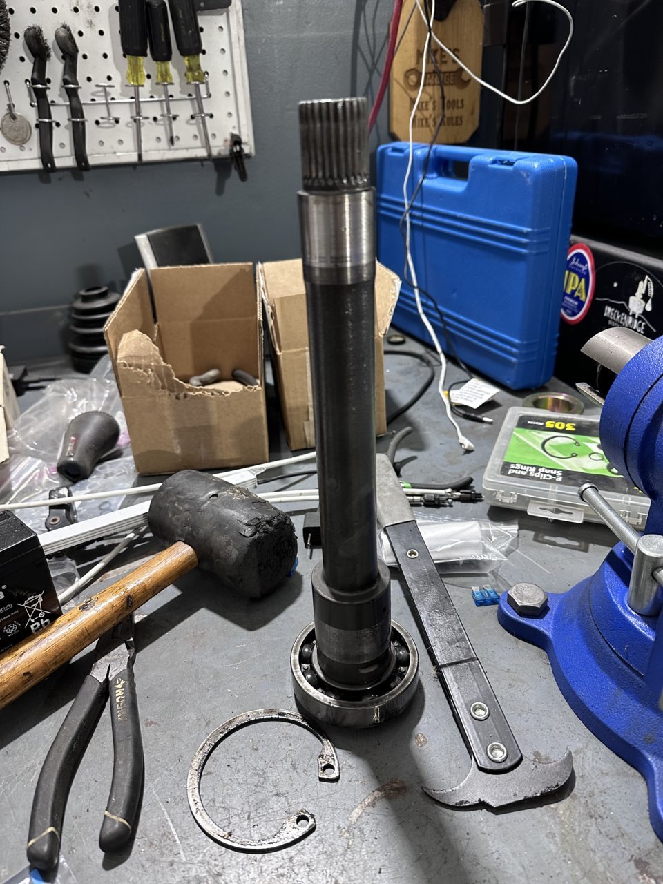

    Gonna pull the bearing and try to get it cryo treated.

    Hmmmmm cryo sounds good. it should hold up to a lot of abuse. It would be cool if there were chromo replacements but I'm guessing it would cost $750 or more for a single one off from RCV or Moser

    Yeah I feel like removing the play from the ADD system is a huge step towards strength, especially if shock loaded. Add this and heavier duty CV's if I LT and I think 37's are attainable on IFS reliably. Obviously can't drive it like SAS bouncing over shit but for the slow technical crawling I do it will work I think.
