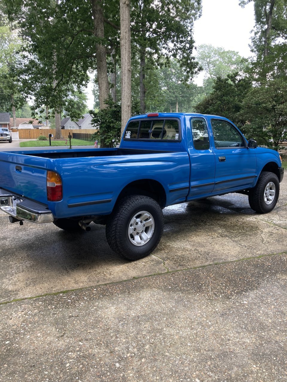

    IMG_0914.jpg Gave it a much needed bath.

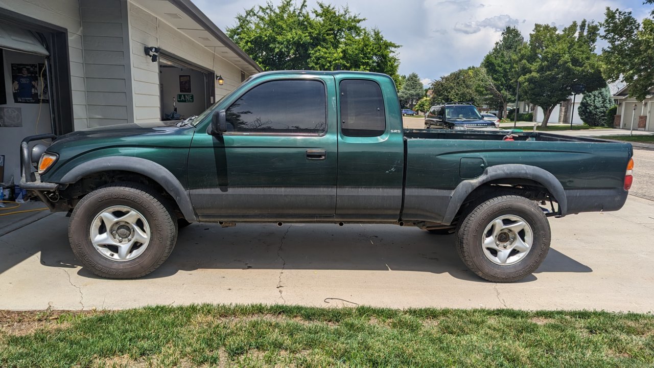

    Pulled another leaf out of the pack, lowered the rear better but axlewrap is a thing. For now the ride is better and it's actually driveable. It's coming along! Traction bars next and then it will be ready for its heart of Chevy thunder.

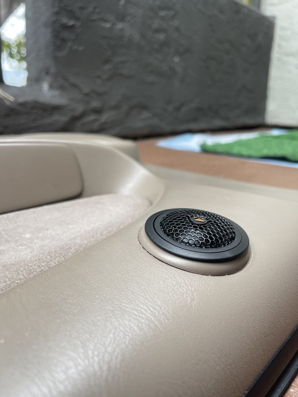

    Figured out my tweeter situation. Dremel into oem tweeter cover. Kicker tweeter threads into it.

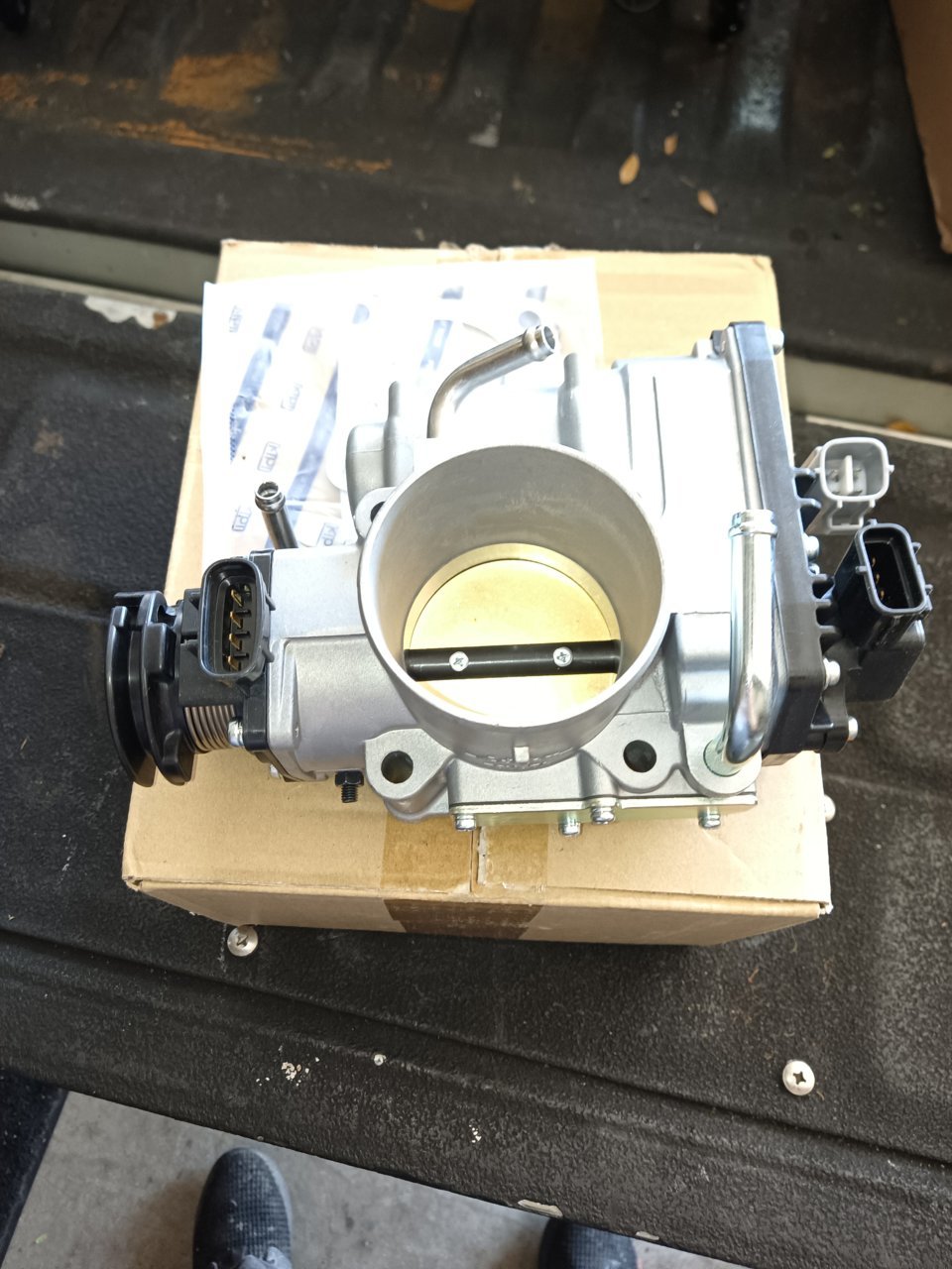

    I took my truck out to Pismo this past Saturday and threw a p2111 code. Going to try a new TPS and clean the TB… next will be bite bullet and get new TB. Is that an off brand or OEM Denso or Aisan?

    Aisan brand

    Thanks. I looked up right after and already have one in my cart. Hoping the TPS and a cleaning of TB solves it… one can hope

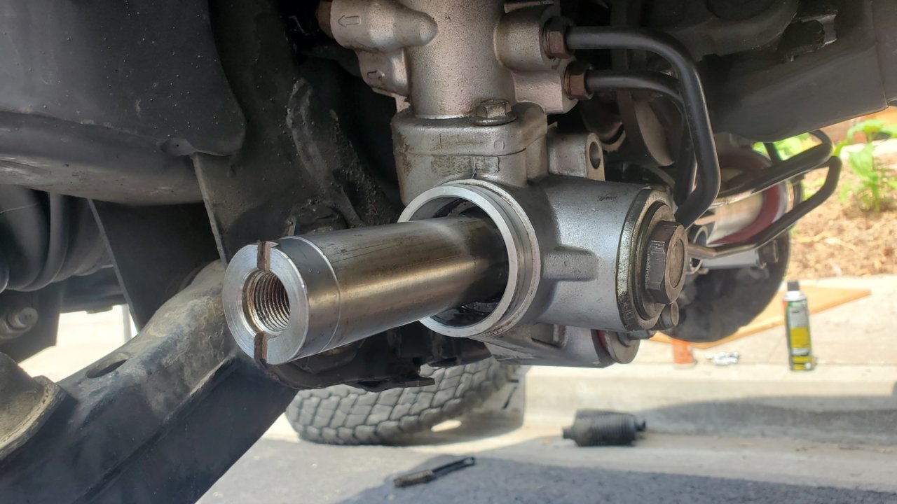

    I changed my inner tie rods trying to track down my wandering steering issues. There was a 1/2" play where the back of the tires could move towards each other and away, constantly changing toe can't be good...
    Also, there's strangely no machined surface to support the inside of the rack when removing or installing the tie rods on this aftermarket rack. Oh well.
    But unfortunately that didn't yield great results even though it did way better on the freeway. I still had some looseness.
    That lead me to investigate the steering shaft, I pulled it out and my original tac weld hadn't held up to a few years of offroading. Now with a bit more experience welding and a longer weld, I'm hoping it will hold for the foreseeable future.
    That fixed all my symptoms. Steering is direct and feels as nimble as a lifted 1st gen should

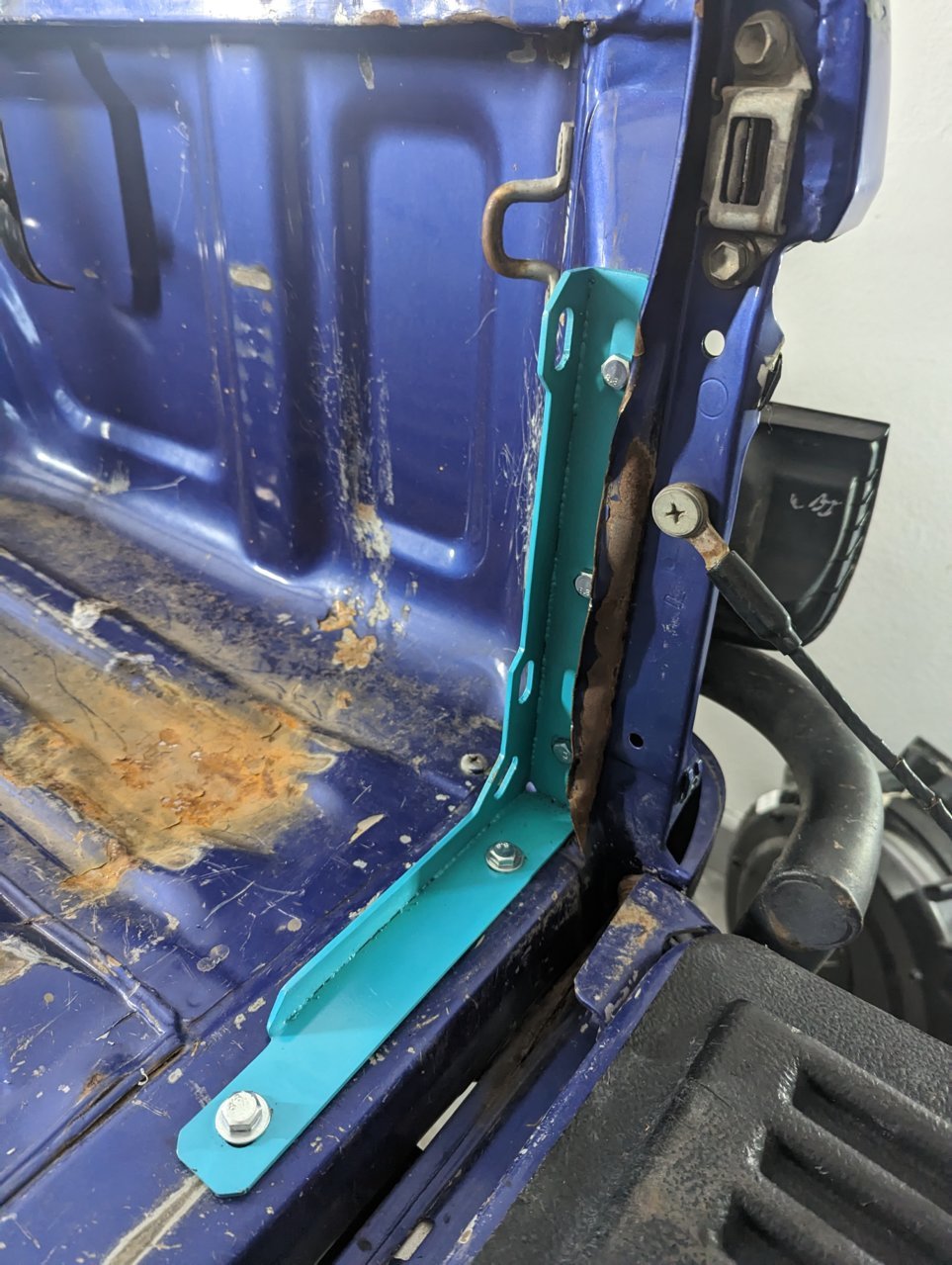

    Installed the pass side bed stiffener from KwikFab. I didn't realize how much I could flex the bed by pushing/pulling on the corner above the taillight with my body weight before this

    That color is sexy, I love that I bought that can :laughing:

    M10 bolts all around?
    What length bolts?
