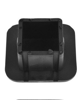

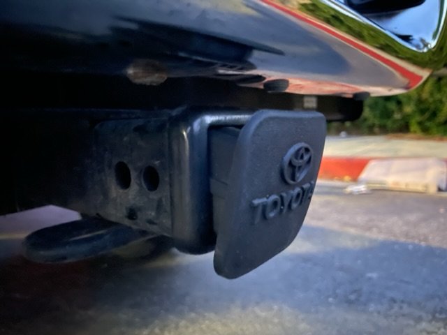

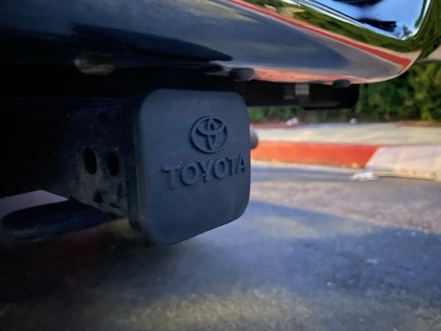

    I hate to ask, but does anyone have ideas for how to thicken the OEM trailer hitch receiver plug so that it stays firmly in the receiver? The hitch measures 2 1/8” and the OEM plug appears to be designed for a 2” hitch. So it goes in but it’s not firmly in there. Was thinking of 1) some adhesive or magnetic tape on the inside lip of the plug or 2) stapling rubber washers or something on the edges of the plug to make it thicker.

    Try a couple wraps of duct tape?

    I remember seeing somewhere, someone took a block of wood to put inside the cover and expand the sides out so that its a tighter fit. Probably would take a little bit of trial-and-error, but no sticky residue to deal with.

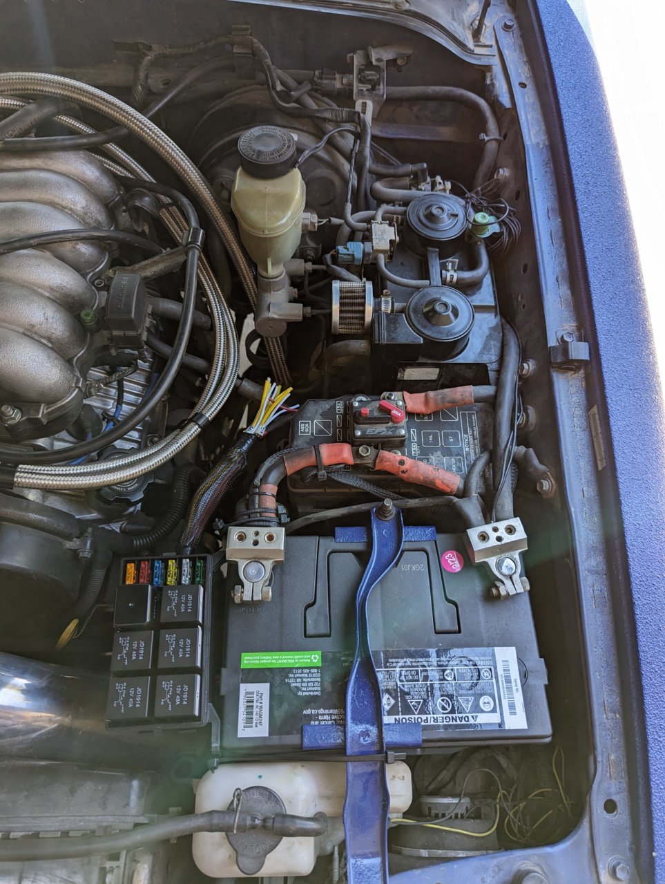

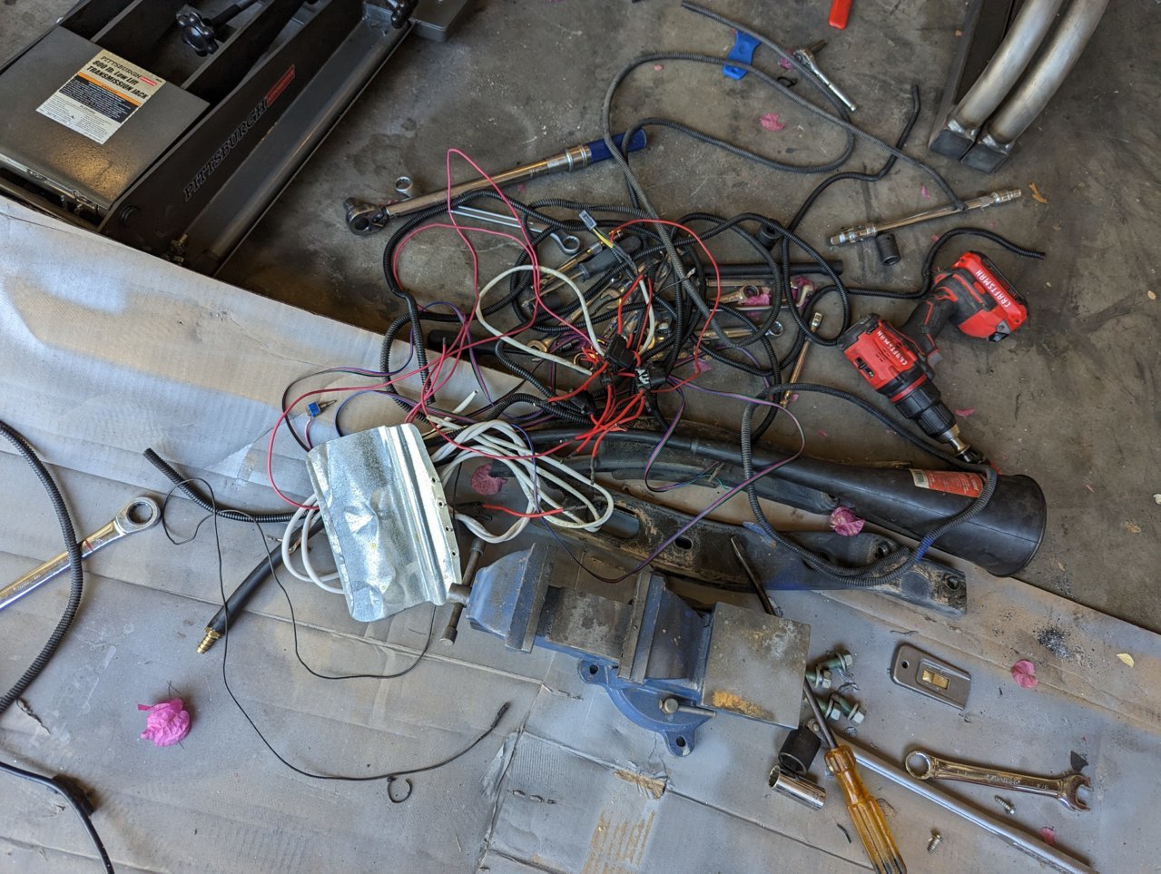

    Pulled the rats nest of old wiring of days gone by out and putting in a quaint little relay box instead

    maybe some foam weather stripping wrapped around it to hold it more snugly?

    Put a plastic rivet in each side?

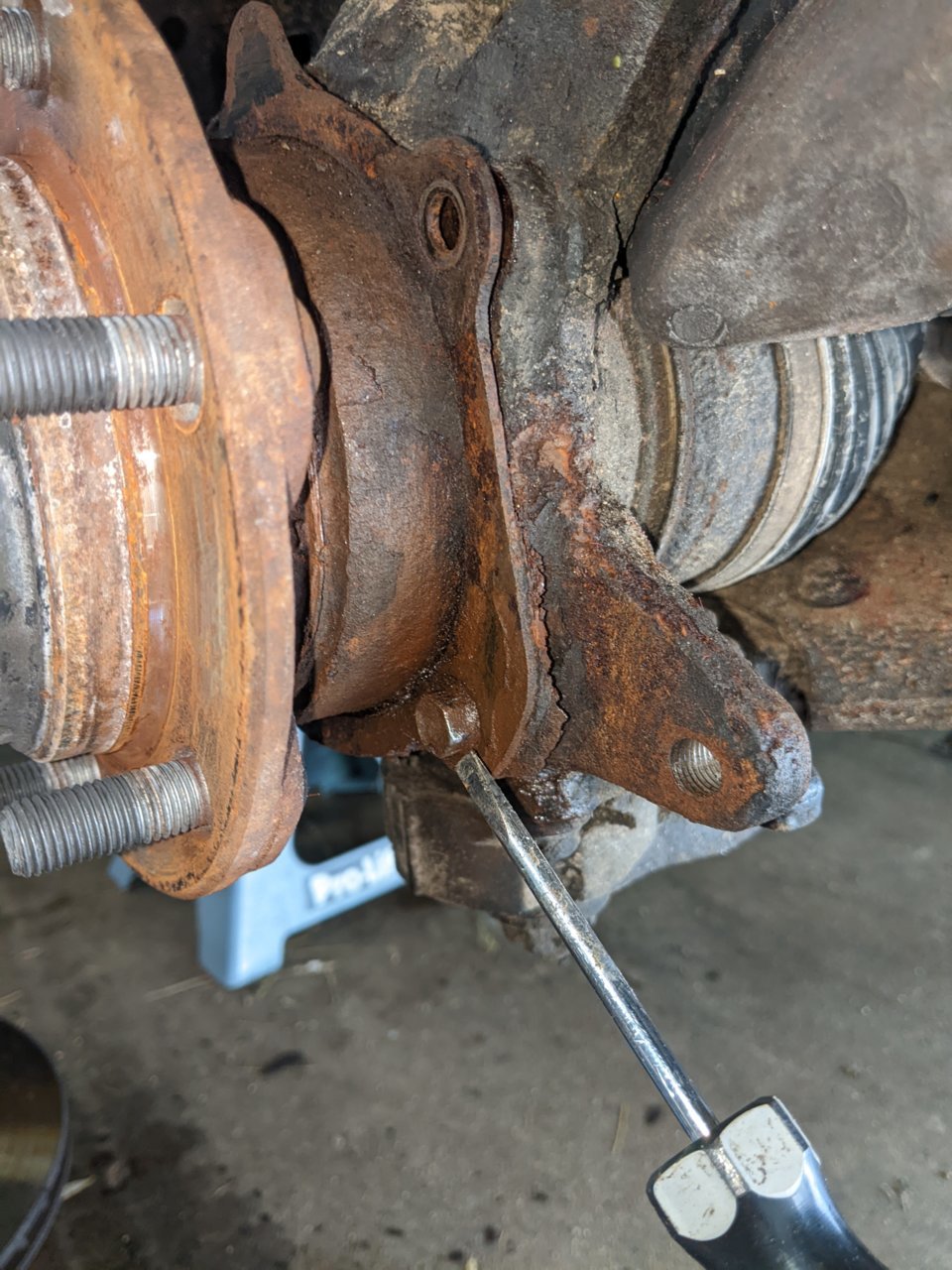

    Anyone know if I can use heat to free up this bolt? Danger of damaging anything in that area?

    I'd use some heat for sure, even a little propane torch should help, heat up the back side of the material a bit

    Thanks Speedy. That did the trick.
