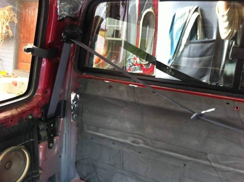

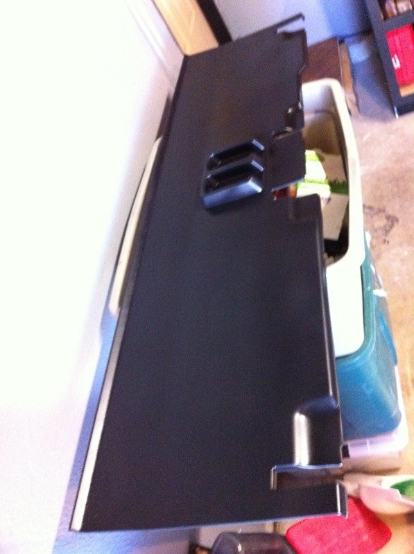

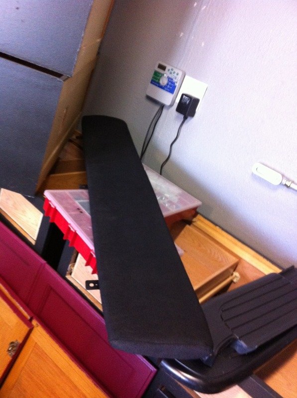

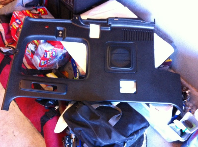

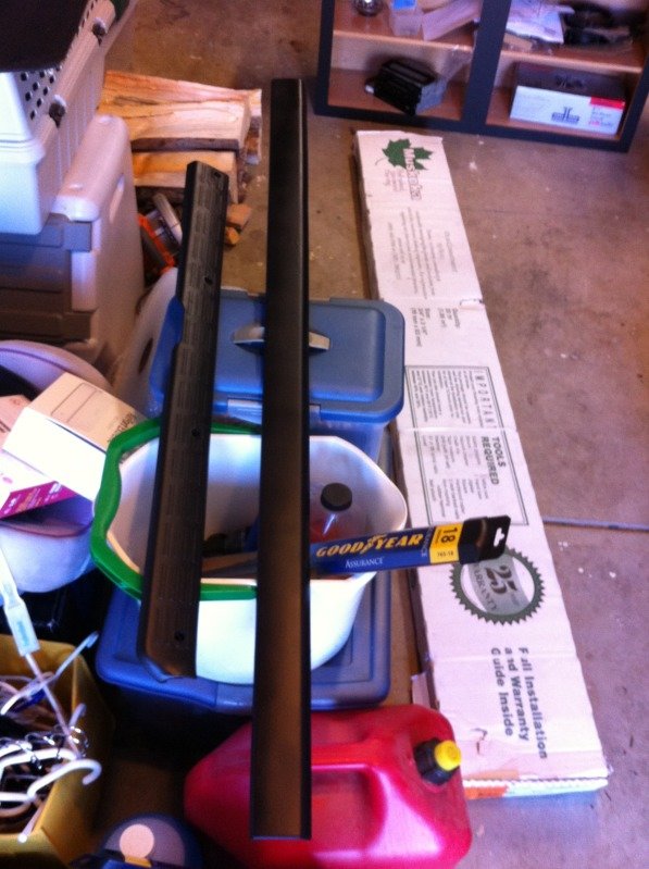

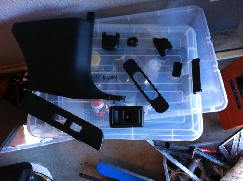

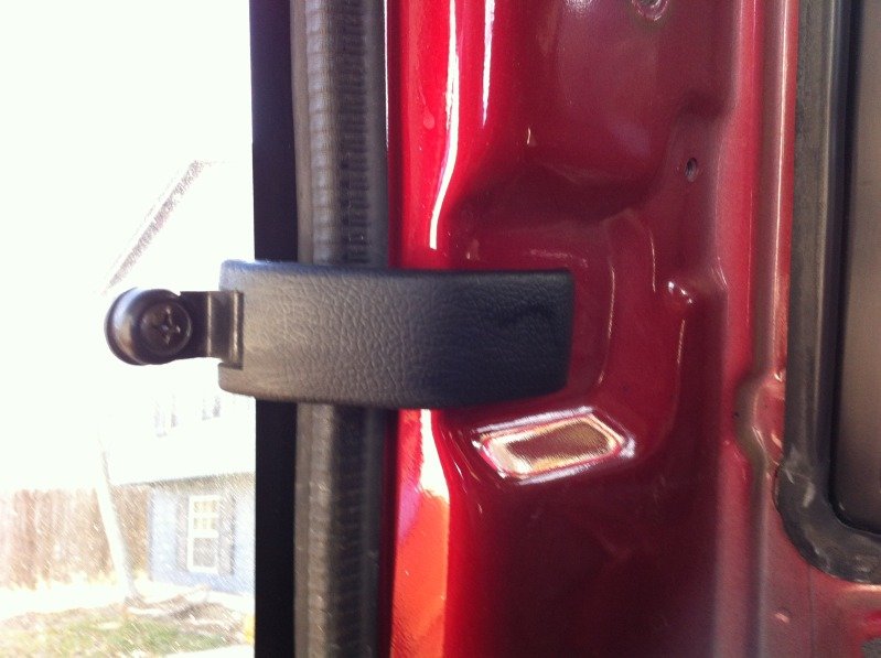

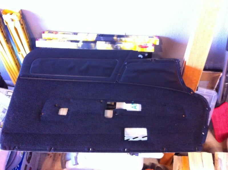

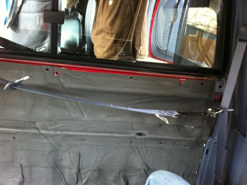

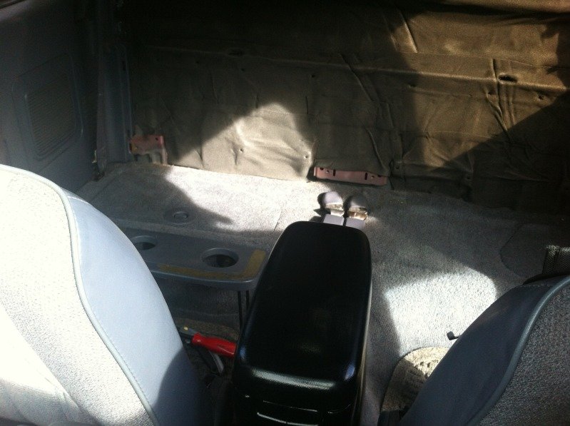

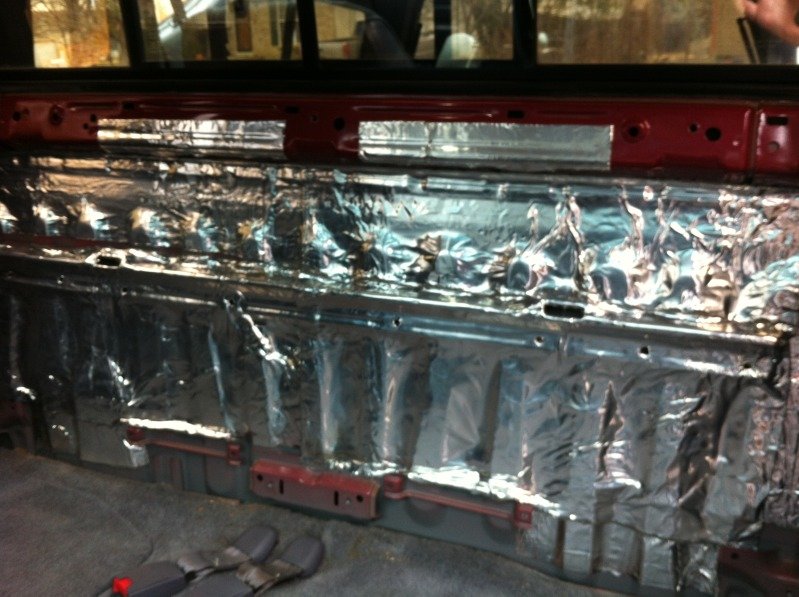

    So I'm in the process of sound deadening my truck as best I can for $150 + my time.
    While I was at it, I figured I might as well continue the process of changing my interior from that god awful fairy gray to flat black.
    BXT II Raammat:
    Ensolite:

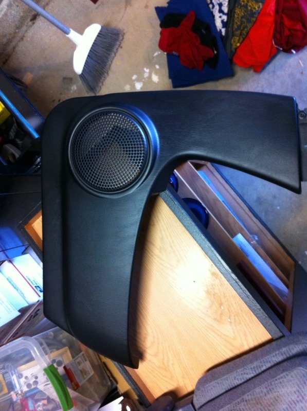

    Passenger side door panel... just the vinyl and fabric (used vinyl/fabric dye on it, turned out great. Those wrinkles went away once fully dried):
    Other vinyl pieces (used the dye again) - that large piece on bottom is hard plastic... used the plastic paint on it:

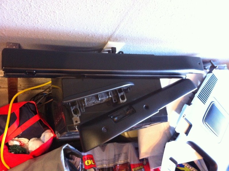

    All the hard plastic pieces, kick panel, etc :
    Rear fabric pad thing:
    Rear quarter panel trim:

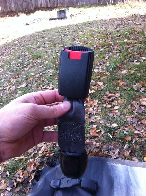

    Rear seat belt receiver:
    Now comes the fun part... all the pieces that can't be removed:
    (the latched wasn't fully dried yet, hence that "smear" - it looks great now):

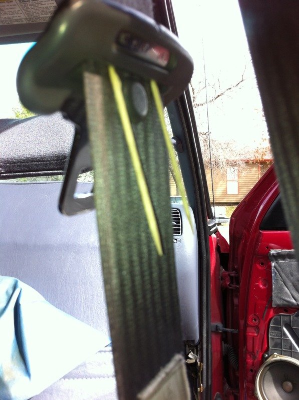

    Now here's a genius, in a completely retarded kind of way, move... how to paint the seat belt trim panels and seat belt pull handles without getting any on the seat belts themselves:
    And of course, the toothpick method is key also:
    Now, onto the driver's side...

    I did buy it from Rick ^
    And it's that small kit that he has up there... can't remember how much BXT II it is, but it's 3 yards of Ensolite. That should be enough to do an extra cab: rear wall, both doors, and some left over for the kick panel and possibly parts of the firewall.
    Truthfully, I'll probably have to order half of that as I went over board in some spots and would like to do the rear quarter areas now that the trim panel is off.

    This spring I am replacing my carpet. At that time I might do my floor.
    Speaking with Rick, who has won competitions with his 96 Tacoma, he says you only get minimal gains from doing the floor... which happens to be a very expensive endeavor. If you are an insane audiophile, or entering your truck in competitions, then go for it. Otherwise its not worth it.
    The noisiest part of our trucks, by far, are the rear walls.
    I just looked at my order and it is this:
    1 pack of BXT II (20 sheets, 37.5 sq feet)
    1 running yard of Ensolite (42 sq feet)
    I'll probably order 5 more sheets of BXT II which are $4.45 per sheet. That should allow me to do the entire rear cubbies and strategic parts of my rear quarters.
