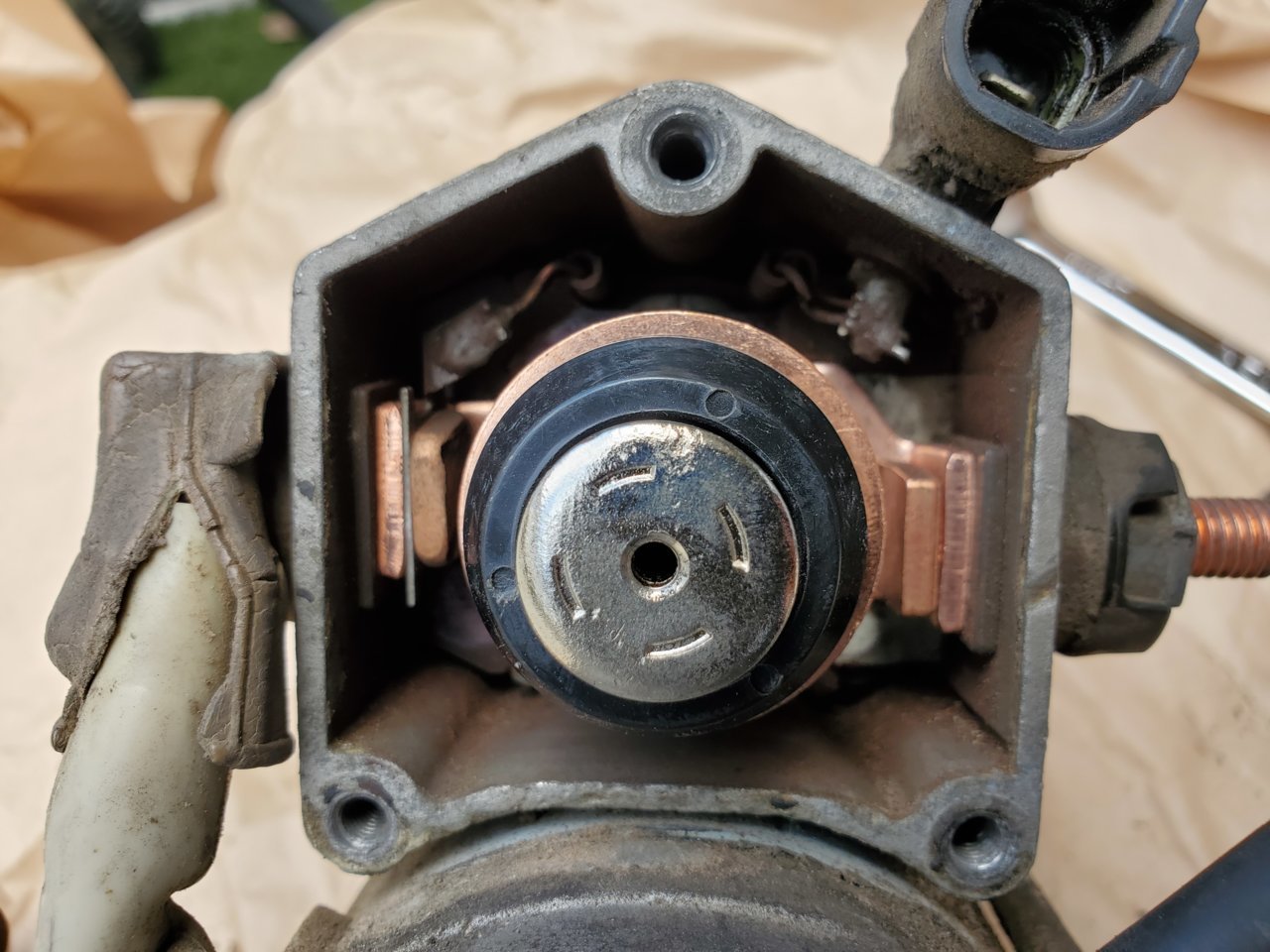

    Cali, so no rust here either.

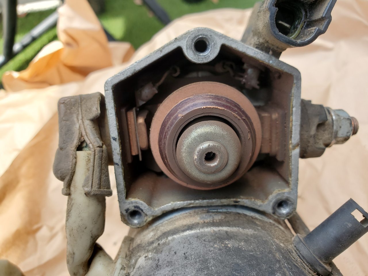

    Was aware of the transmission dipstick tube removal; I've pulled the pan on both my A340s before.
    The brake line bracket I had read about as well to pull through the wheel well.
    Undoing those and the harness/plug took all but 5-10 minutes tops.
    The tricky part was the multiple extensions I used to go over the crossmember to ensure I went straight forward with my socket (to remove the 2 bolts holding the starter). I did not want to risk rounding off these bolts.
    Top bolt, only 2 extensions -
    Bottom bolt, several more -
    Once undone, dip the starter towards the rear and downward, then pull up and out through the wheel well.
    Super cheap to rebuild -
    Even faster to reinstall.

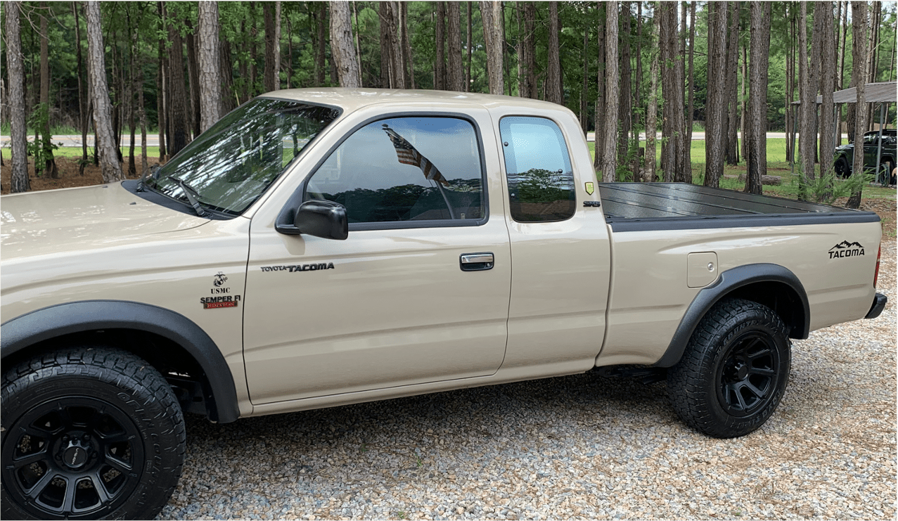

    They make a backflip for 1st gens?
  6. Jul 24, 2023 at 9:24 AM
    Jabba53e
    Jabba53e Member
    Jul 16, 2023
    #429035
    5
    1998 5 Lug Tacoma, 2.4L 2WD
    2" Lift/Leveling kid, Repainted to Quicksand Beige, Replaced the 60/40 Bench seats to bucket

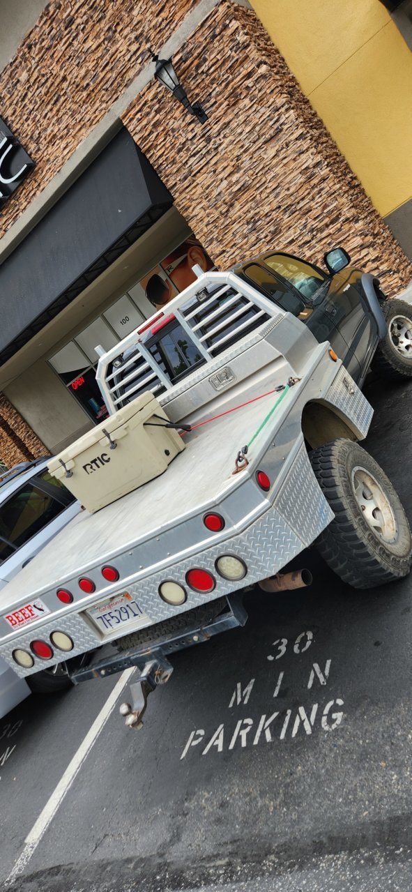

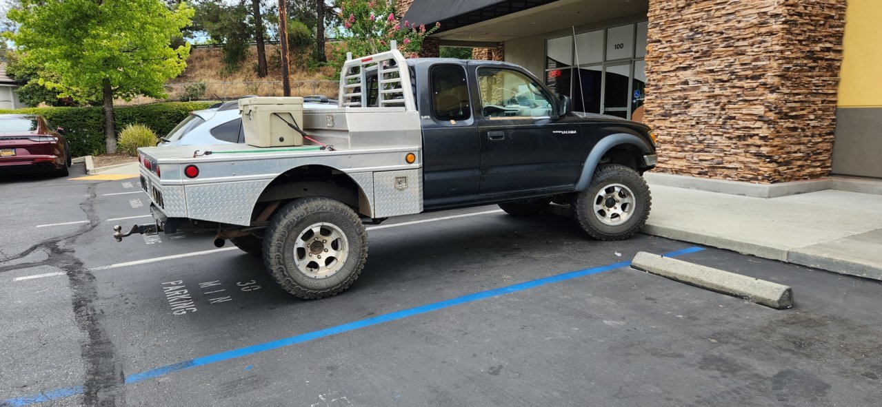

    Probably the coolest flatbed I've seen on a 1st gen

    That receiver looks sketchy

    It's less Tacoma and more mod
    It's the Curt universal one. Probably fine for what a Tacoma can handle

    Are those method nv 305’s?

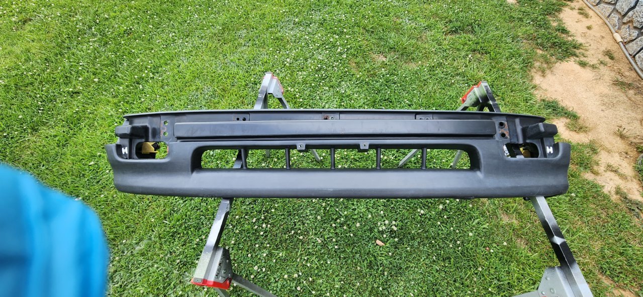

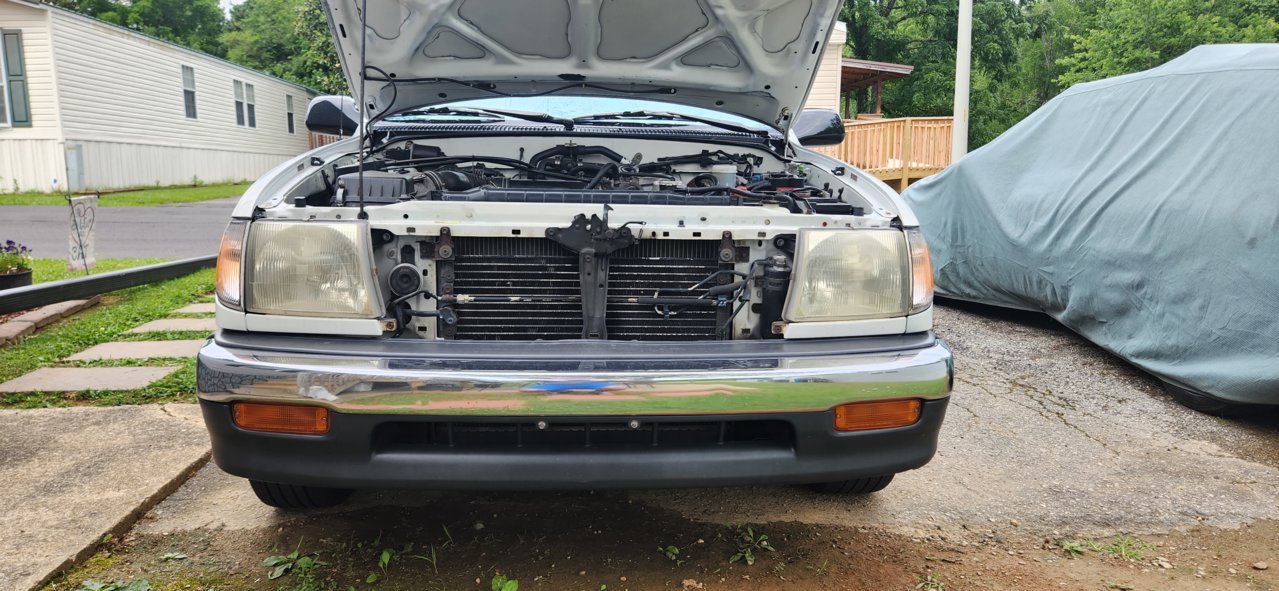

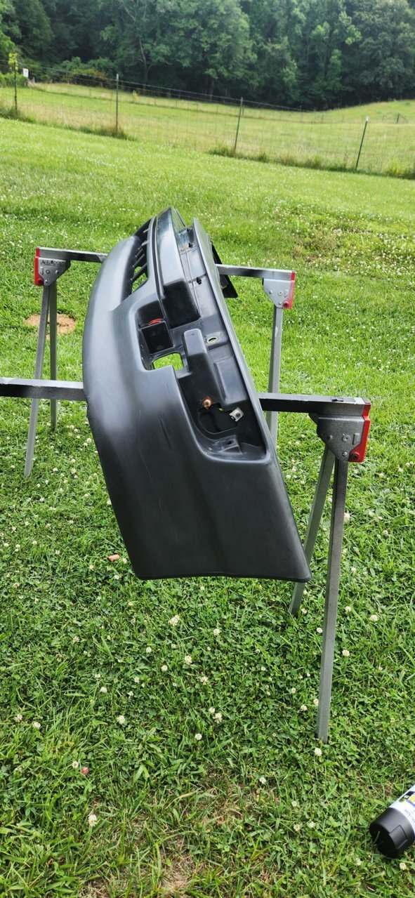

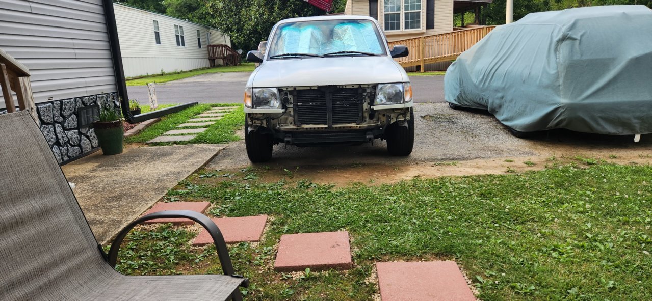

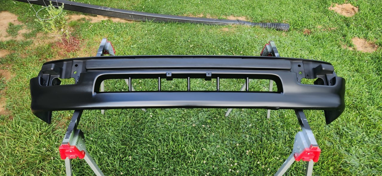

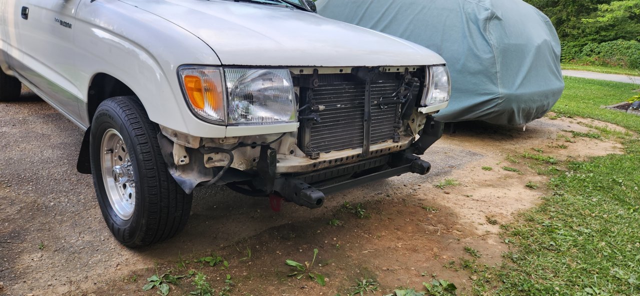

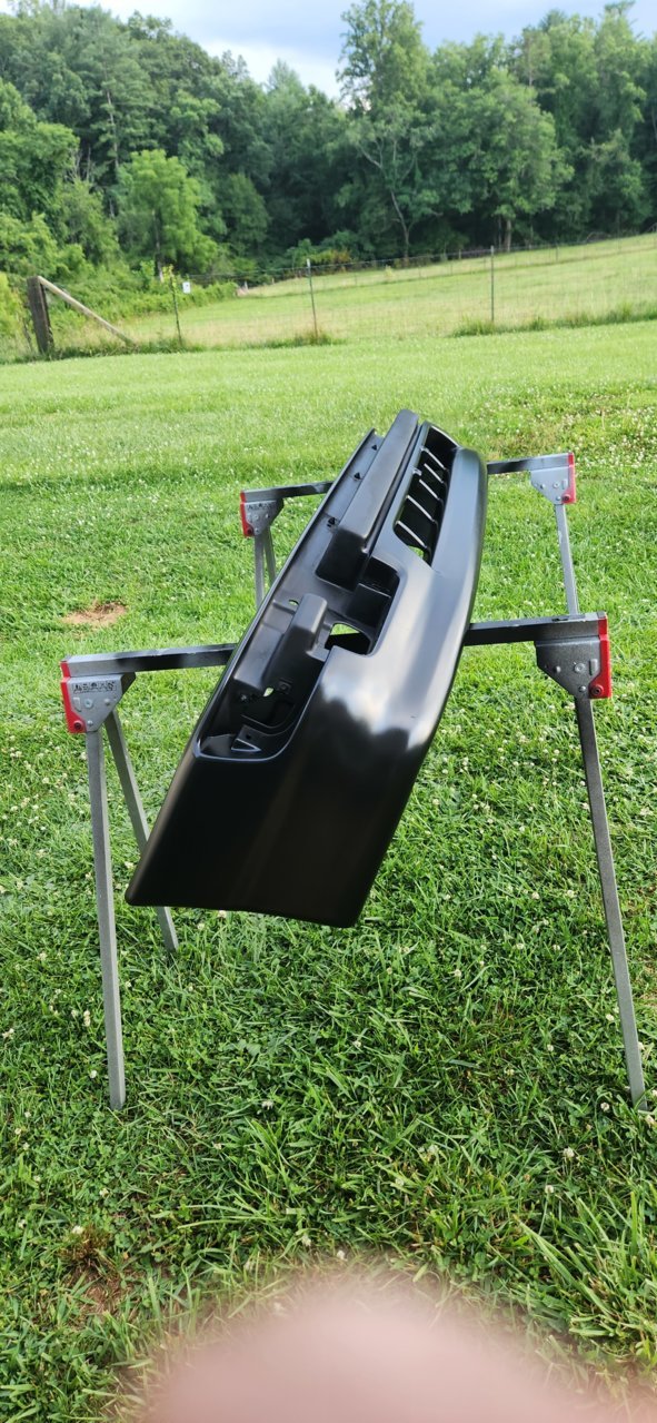

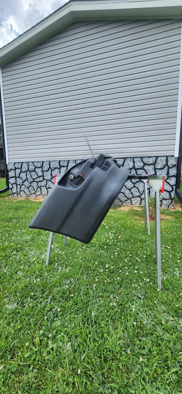

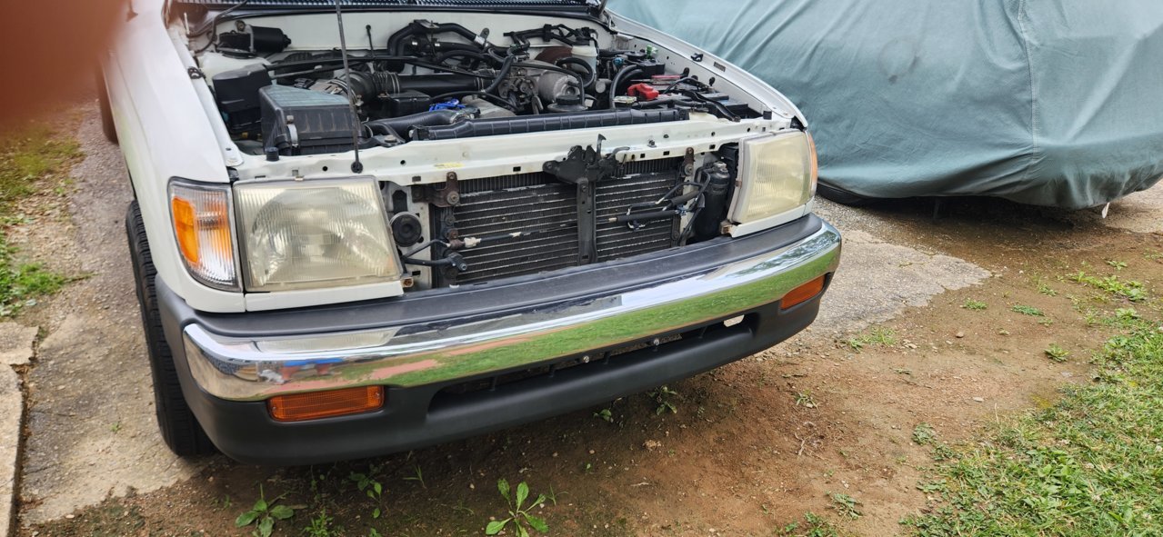

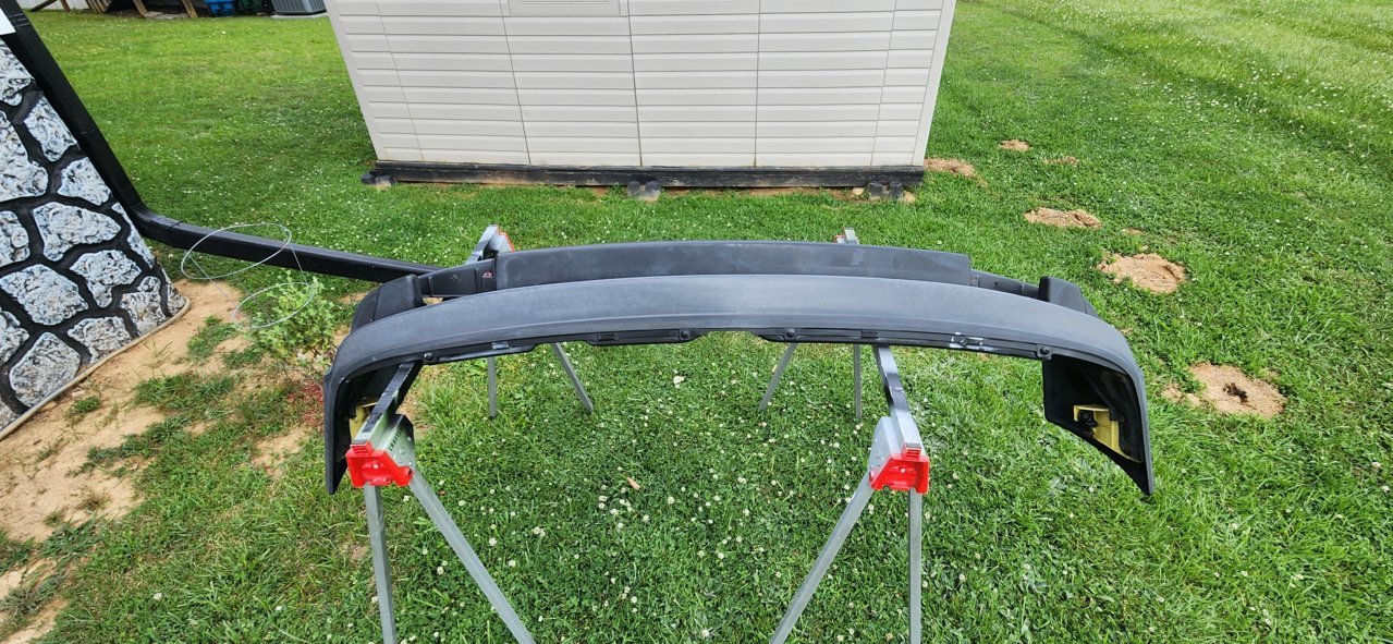

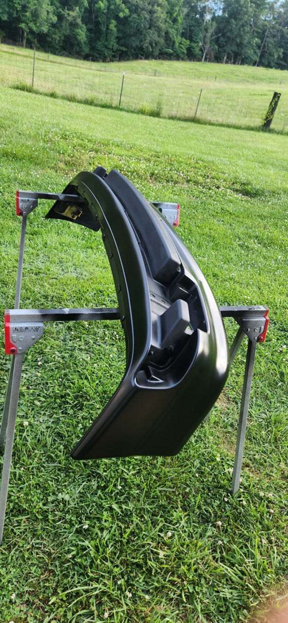

    Taking advantage of the summer and doing a front end refresh in and amongst other maintainence items.
    Did an oil change and over the past week I replaced the original cataracted headlights with new ones (love the difference that made!) refinished the headlight filler pieces inside and out, replaced the dinged and rusty chrome bumper filler, (not a great fit but not awful and looks way better IMO,) and cleaned, prepped, primed and painted the faded to grey, no amount of Armor-All will restore it bumper cover back to matte black. New grille is on order to replace the plastic-chrome-peeling original and should be here tomorrow or Wednesday.
    Reassembled pics forthcoming.

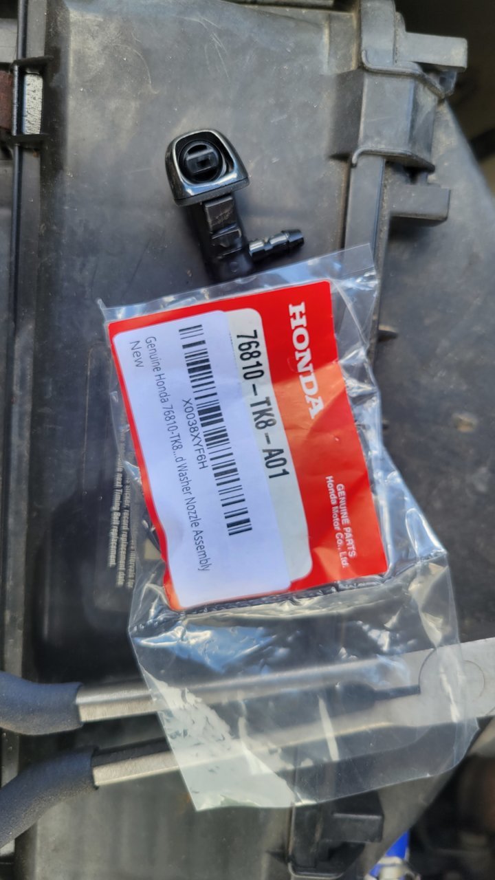

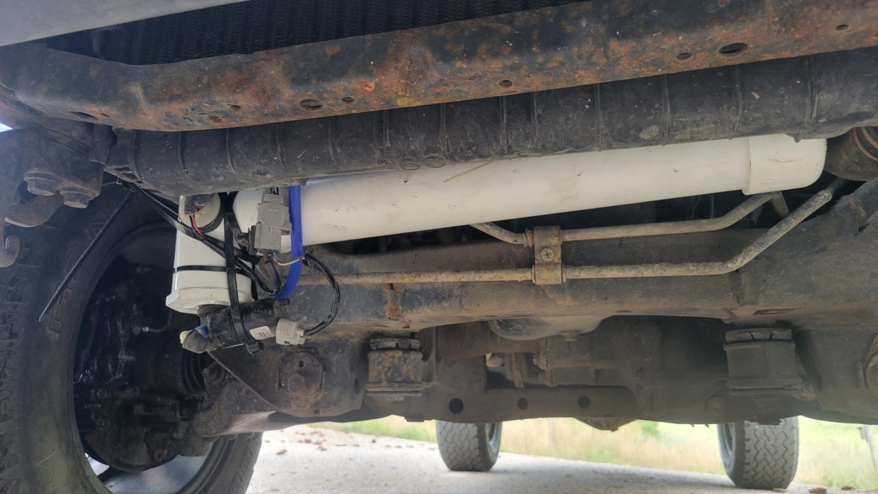

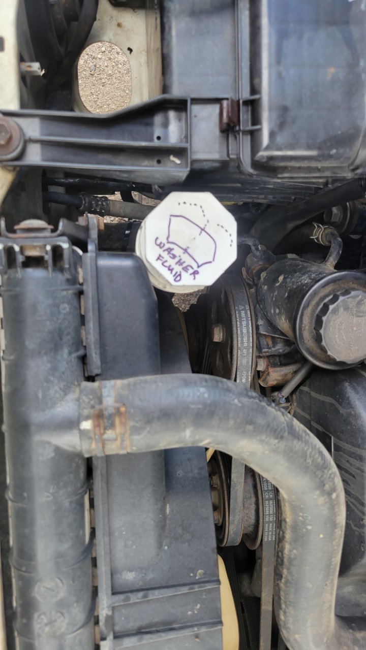

    Replaced / relocated busted wiper fluid reservoir in preparation for aftermarket bumper
    Thanks for the nice writeup Blackdawg
    https://www.tacomaworld.com/threads...trail-rig-and-bs.159436/page-385#post-8802626
    Replaced spray nozzles with drop in fan spread adjustable Honda nozzles

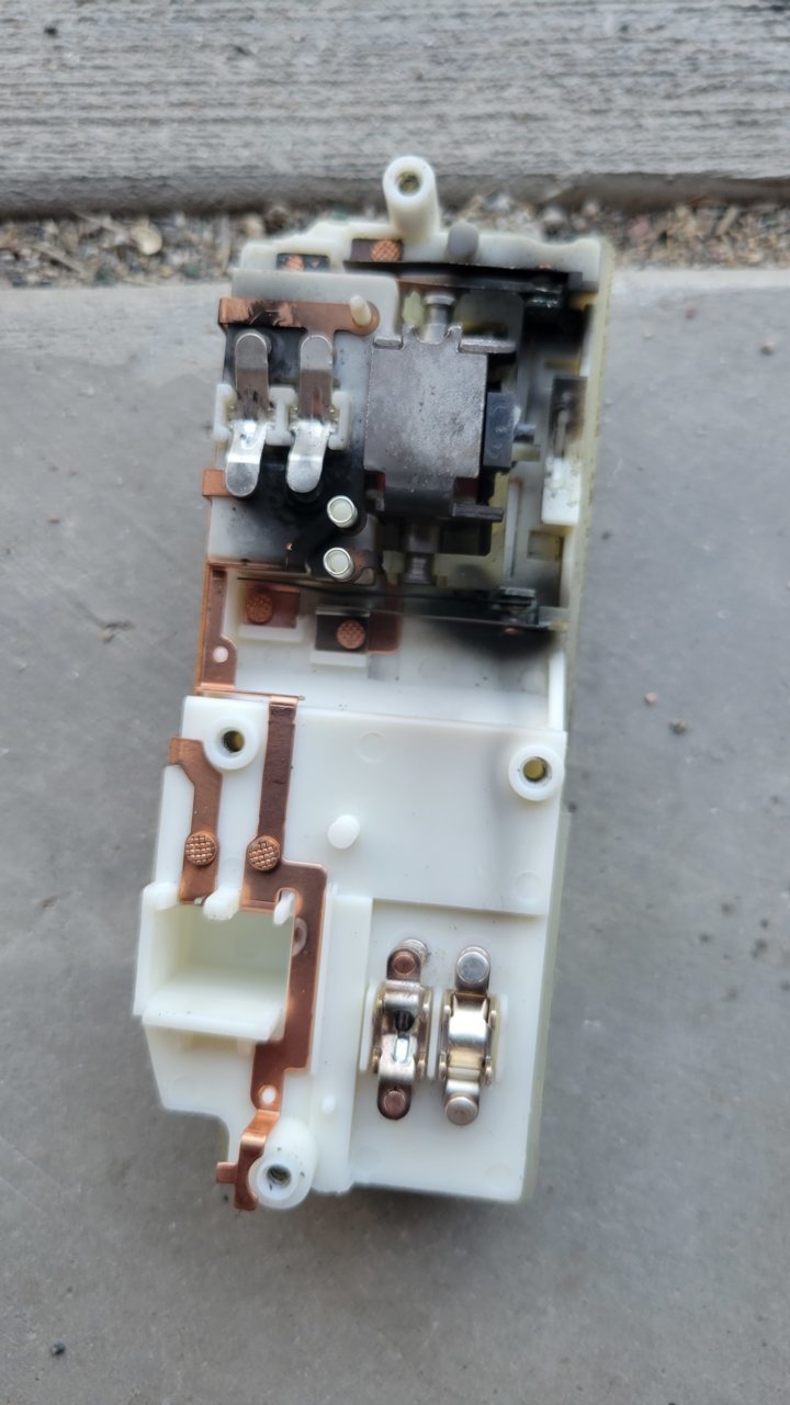

    Cleaned contacts on master switch for intermittent driver window issues. Lots of small parts in this thing.... go slow and take photos!

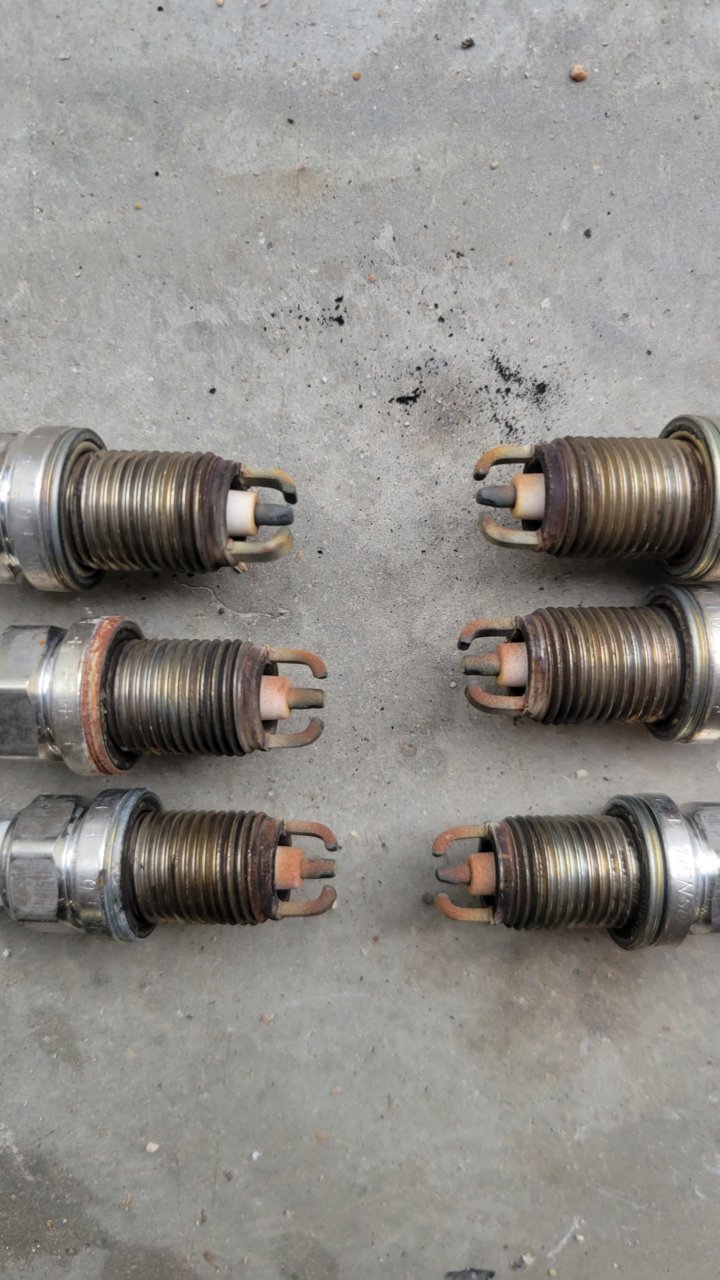

    New Plugs and wires. Driver side electrodes showed more wear than passenger side

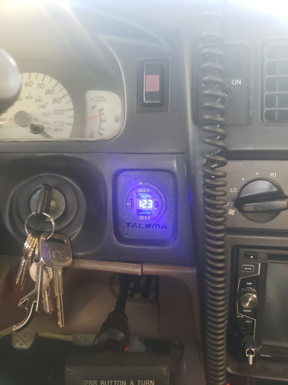

    out with clock, in with charger..

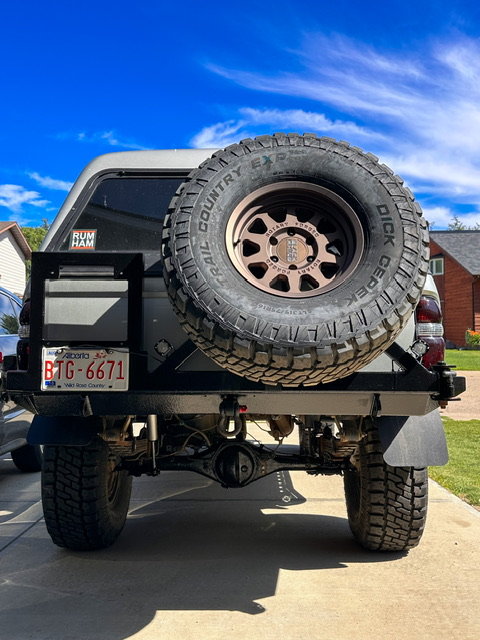

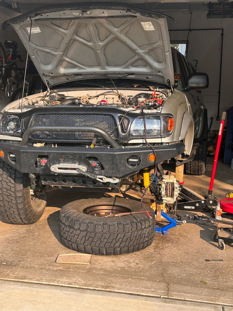

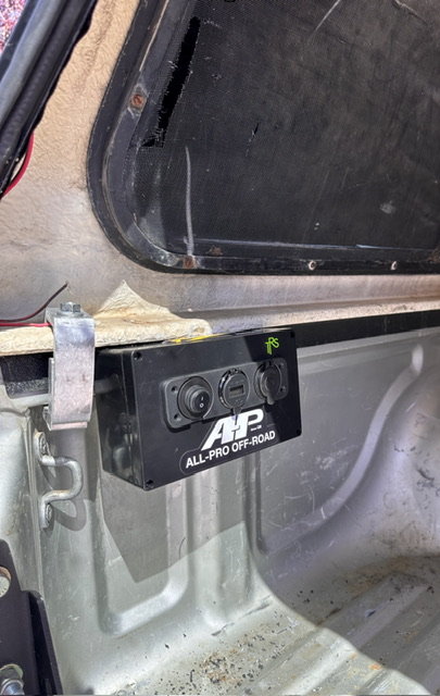

    Finished up a ton of work. Spc’s, lbj’s, por15’d the rear axle and bumper. Diffs fluid change. Mounted some S1’s on the rear bumper. Blacked out the canopy side glass with vinyl, and then ran power to the bed of the truck for my cooler.. ready for 3.5 weeks ripping through the Kootenays up to the Shuswaps, and then up to the BC/ Alaska border along the coast. Can’t wait!

    Is it just me or the block of wood on the jack is a bit sketch? I don't see a safety jack?

    What you don’t see, is my jack stand firmly planted on the frame lol. I moved the floorjack in with the board and pumped it up to just barely tag the slider. I’m paranoid of jackstands so I wanted a ‘secondary’.
    Then the scissor jack was holding up my hub while I was fumbling around lookin for stuff, and taking a picture lol.

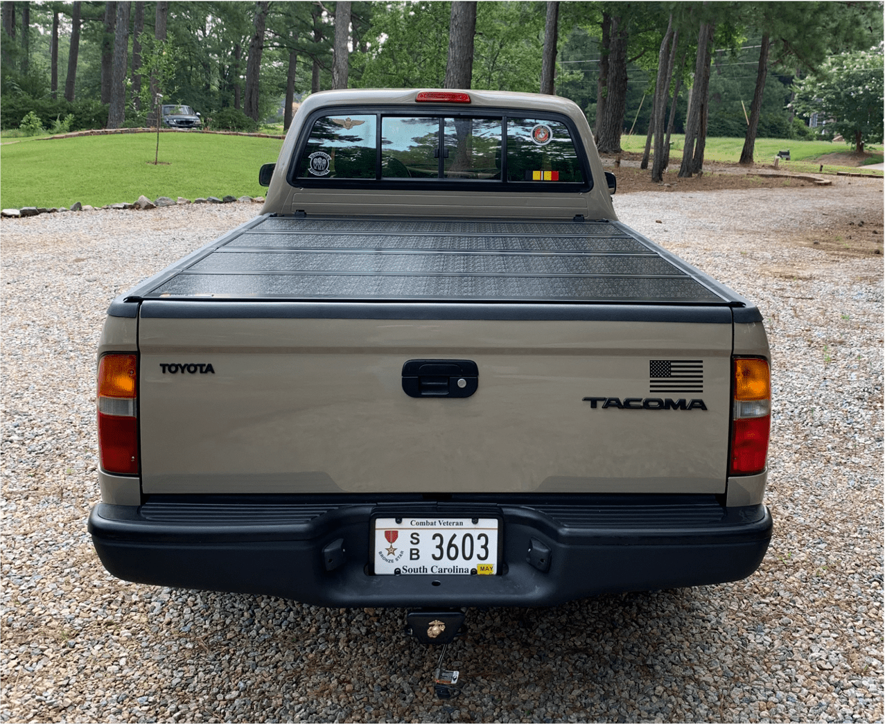

    Finished (for now) pics:
