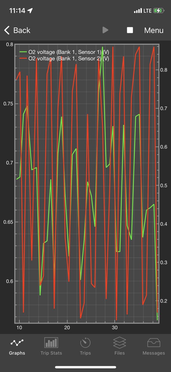

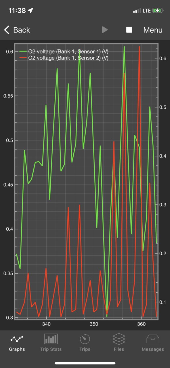

    Been chasing down a few things. Recently added the LCE header (it's pretty cool), new Denso O2 sensors and new fuel injectors from Motorwest. None of which helped fuel trims or the p0420 code... didn't really think it would.
    I'm leaning towards a leak between the cat and the rear o2 but can't tell for sure yet. Any thoughts?

    I chased one for a while and it was a vacuum leak.

    I am hearing what sounds like a hiss from somewhere near the EGR... will be yanking the throttle body off again soon and probably swap all the hoses there just to see.

    If you can get someone to hold an oven mitt or some rags on the tail pipe to build a little pressure you will find your exhaust leak real quick.

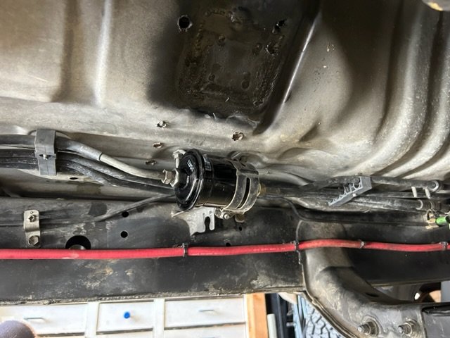

    Changed out fuel filter and wouldn’t you know had a lil drip from front side or outlet side. I checked to make sure threaded right, it was. Tightened down and leaked. Gave the extra effort as hard as could and stopped leak… but it literally only turned an extra 1/1000th o_O
    good to go or??? Thoughts lol

    If it's not leaking it's good. Those flares are hard to get to seal

    it was stupid! Don’t remember being like this with last truck.

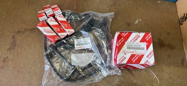

    I can actual play what I did today! I did fuel filter, as noted a few post back. Just finished plugs and wires. Had to be originals as half were NGK/Denso. What a bitch with engine cage for drivers rear!!!!

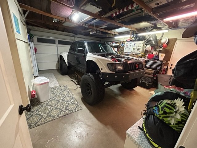

    Finally tucked in garage now as well! :headbang:
