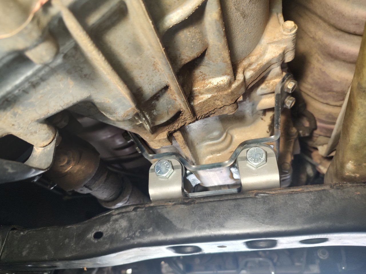

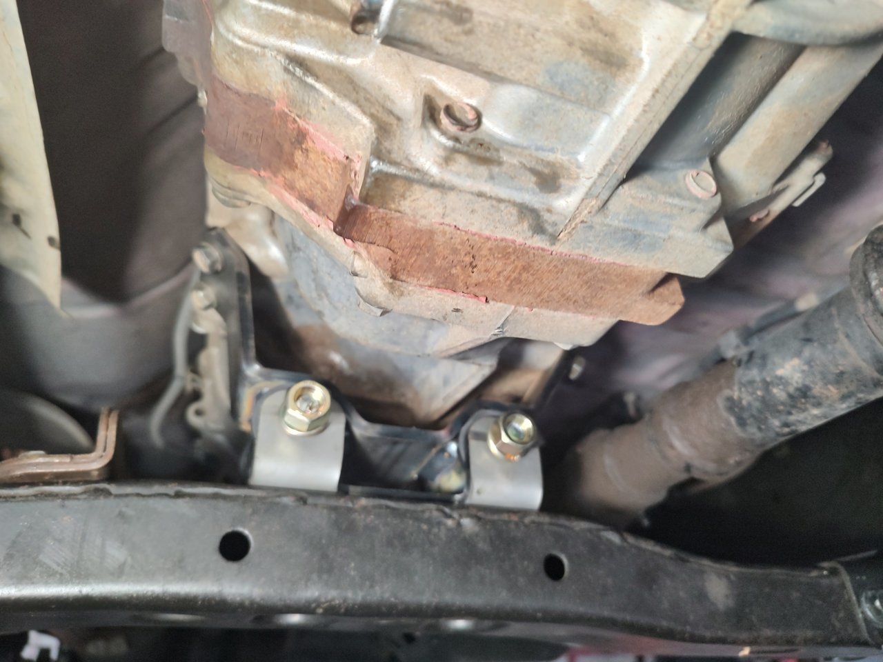

    Transmission back on, transfer case as well. LCE dual comp with a freshly surfaced flywheel in. Parts delays stopping me from going further
    tomorrow start on valve cover gaskets and the timing belt
