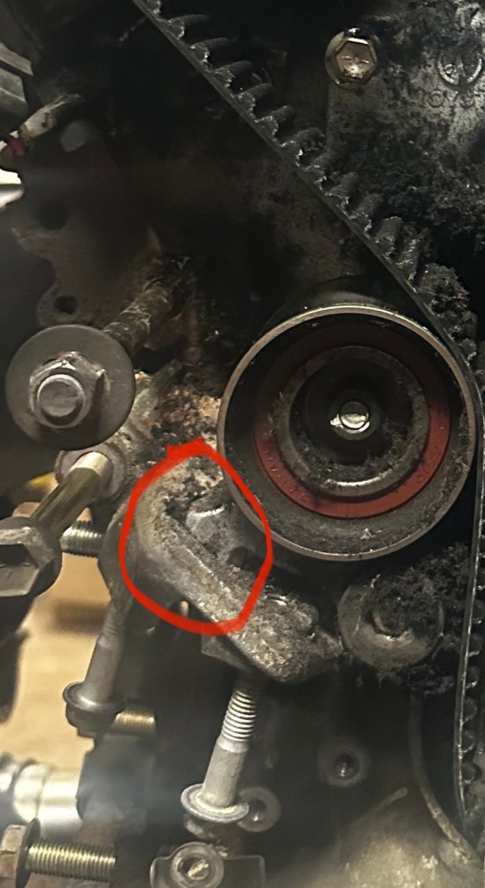

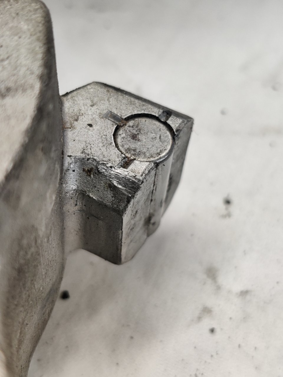

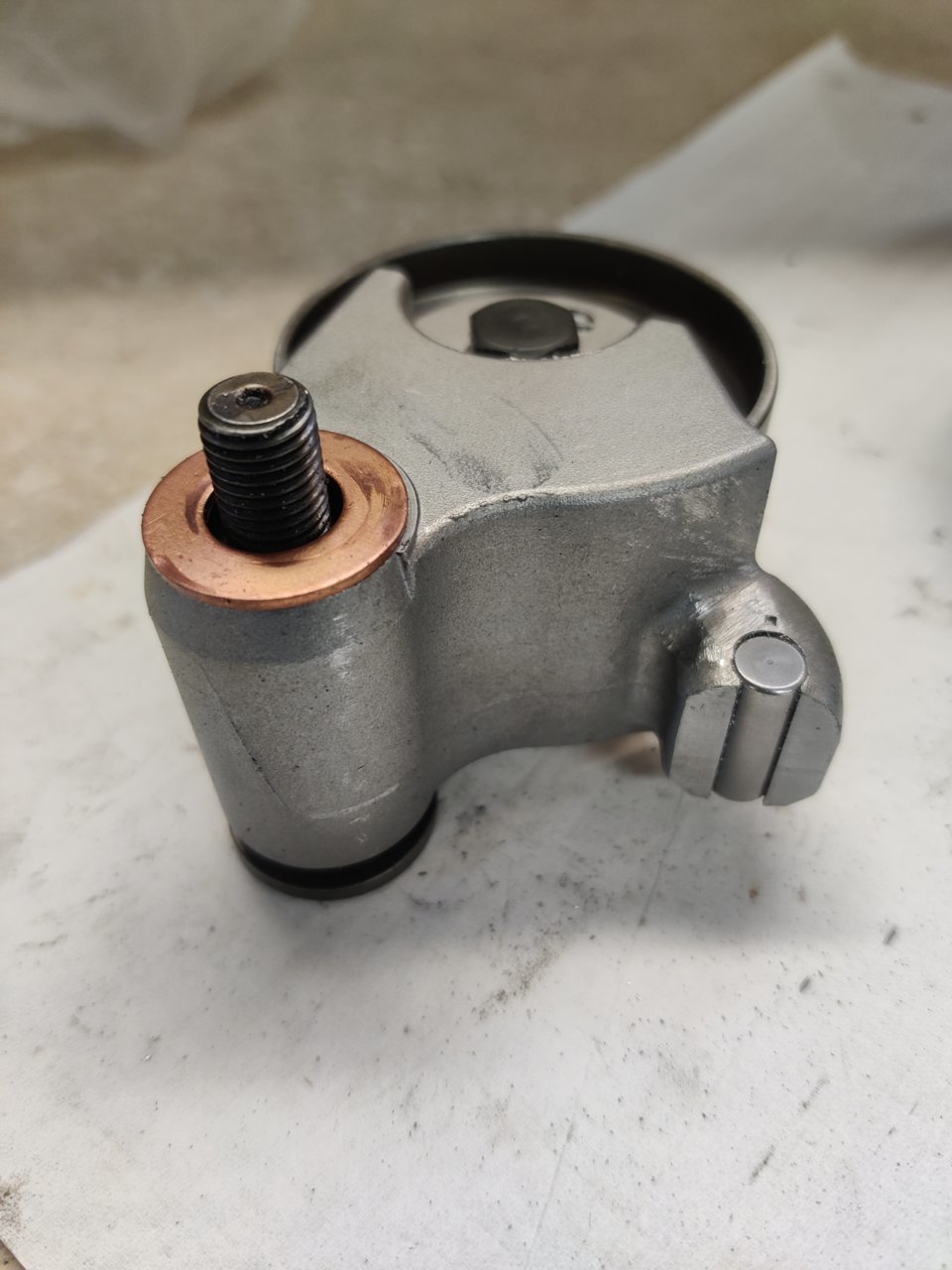

    CX Racing Turbo kit. TransGo shift kit. All Pro Apex bumper and skids. Smittybilt XRC 9.5 winch. All Pro Upper control arm's. Bilstein 6112's with 600lb coils. Eimkeith's lower control arm reinforcement plates. Perry Parts bump stops. All Pro spindle gussets and alignment cam tabs. All Pro standard 3" leaf springs. Bilstein 5125's rear. Extended rear brake lines. Rear diff breather relocation. MagnaFlow catback with resonator. Bluetooth stereo. Memphis 6x9 door speakers. Diode Dynamics SS3 Pro Amber fog lights. Single piece headlights. aftermarket grille. Anzo taillights. LED 3rd brake light. 4runner sunglass holder and dome lights. Master Tailgaters rear view mirror with 3 directional cameras, G shock sensors, and anti theft system. Honda windshield washer nozzles. Stubby antenna. Scan Guage II. 2nd Gen Snowflake wheels powder coated black. Cooper Discoverer ST Maxx 235-75/16 Denso 210-0461 105 amp alternator. Speedytech7's big wire harness upgrade. Aeromotive 340 fuel pump. Haltech Elite 2500. Tacomaworld sticker. Tundra brakes with Adventure Taco's hardline kit
    I know @Speedytech7 already told me that the timing belt tensioner pulley shouldn't be low enough to touch the oil pump house but it's still stuck in my head.
    @Empty_Lord hope you don't mine me snagging a screenshot of your photo but it was perfect for what I wanted to see
    When I pulled my Tensioner pulley the piston part (not sure what to call it exactly ) was rubbing on the block side of the cylinder wall. I wouldn't think twice about it but the new Tentioner pulley rubbed the exact same way in a new oil pump until I used a copper washer to create a small gap and I filed the Tentioner piston down a little bit.
    The other reason it keeps nagging the back of my mind was seeing timmy have issues with stripping the pulling bult in the timing belt video. It made me wonder if a similar bind is what caused it to be cross threaded to start with.
    Probably way over thinking this still but I just want to see if anyone else has the same wear marks for the tensioner pulley.
    I'll do my best not to bring this up again:deadhorse:

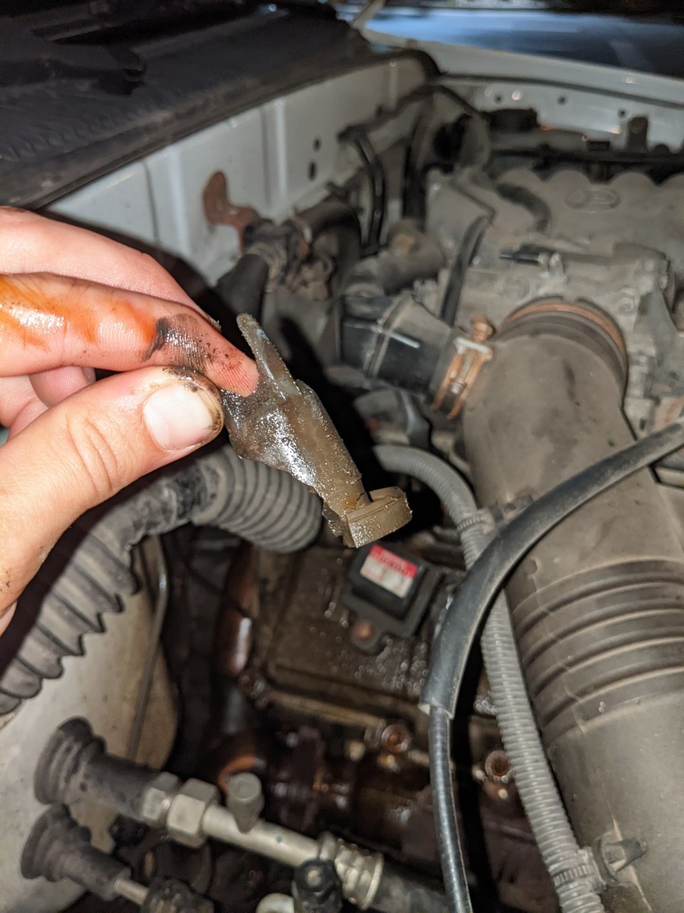

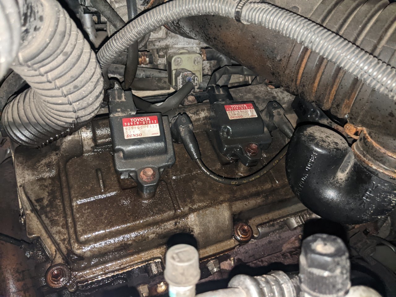

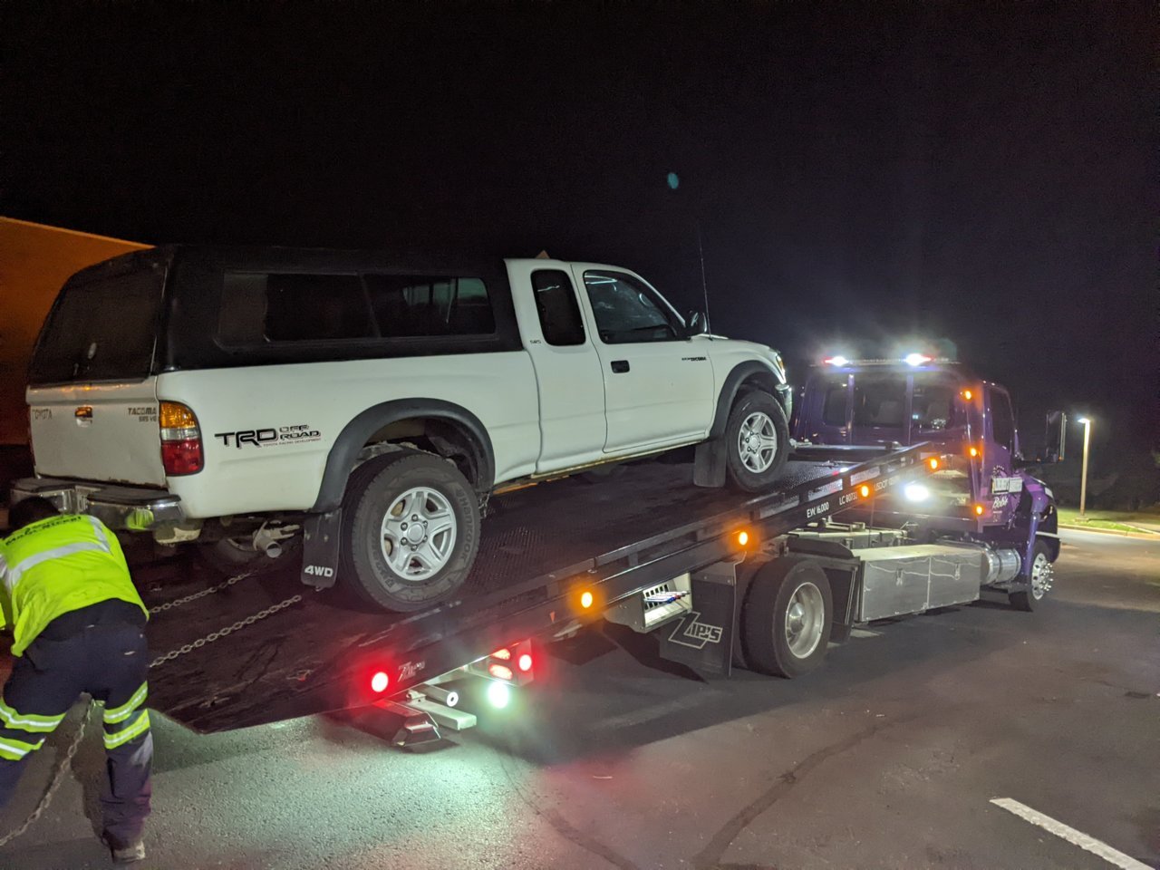

    Got it towed. Spitting oil out of passenger side tube seal. One of the coil packs was loose and I pulled out a chunk of the rubber from that coil pack. Making some knocking sounds. Misfiring the past two days. Oh and of course I'm hundreds of miles from home. Pray for me :annoyed:
