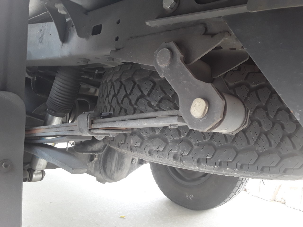

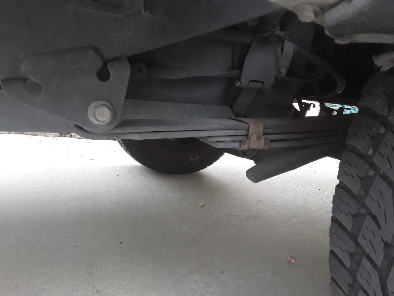

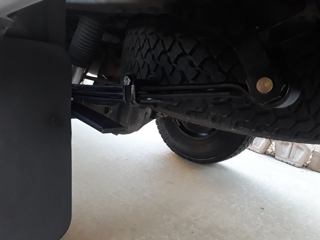

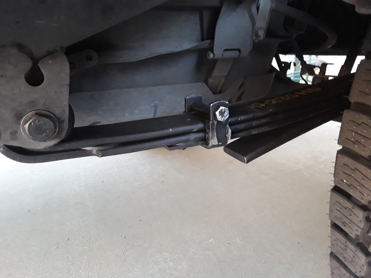

    FINALLY replaced the old, original springs on my girl. It was long overdue.
    As you can see, the old, original set was really worn out.
    The new set, General Springs Heavy Duty, is already a huge improvement.

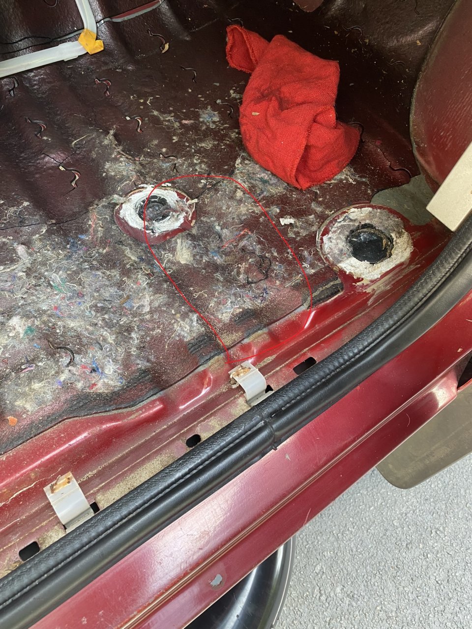

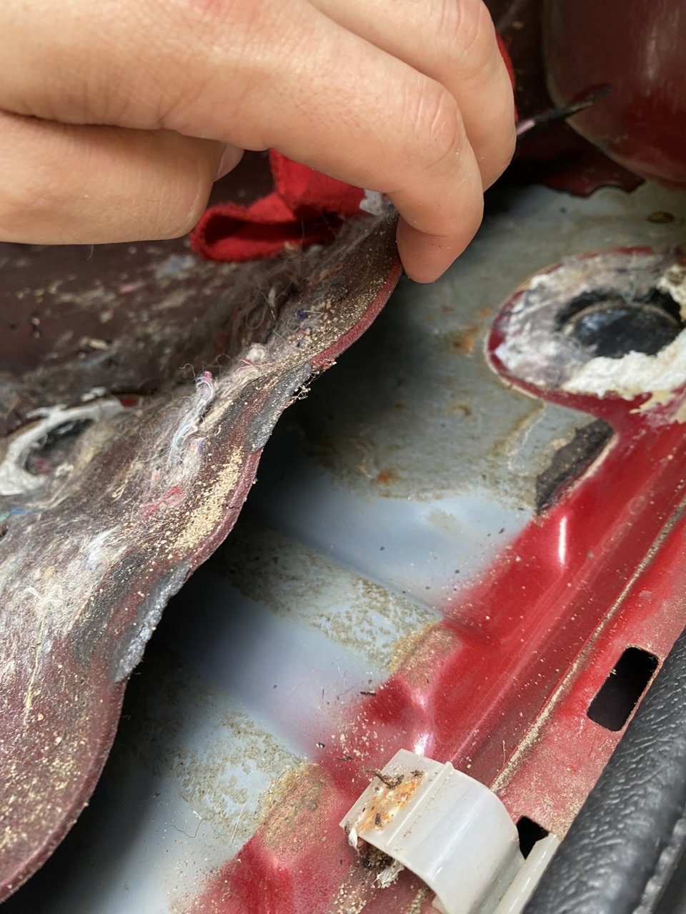

    Got some rain last night, got some water inside this morning. Only near this plug but the truck sat through the rain. Water was completely concentrated to under this heat shield thing and only in that circled spot. Pulled the flat part of the weatherstrip and noticed water sat under it too but only on the outside of the truck. She's gonna get the hose against the passenger door later today I'm thinking it is coming from that area. Everything forward and backward of that spot is bone dry.
    Any ideas?

    I know trucks after 1997 had some sealing issues under the windshield cowl cover, where the wiper linkages are and it appears exactly as the leak you're describing here does, pooling near that floor grommet.
    Here's the TSB explaining it

    That TSB was what I was fearing doing some research before, I'm not seeing any traces of water except at that area but the hose will tell all hopefully. Looks like a really fun job if that's the case...

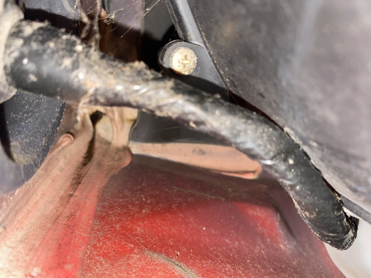

    Sure showed itself quick... thought it was the wiring harness grommet but its coming way up top in the corner. Looks like it'll be a fun time! Good thing I'm going to the shop to get the driveshaft rebuilt next week, might see what they want to do this as well.
